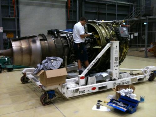

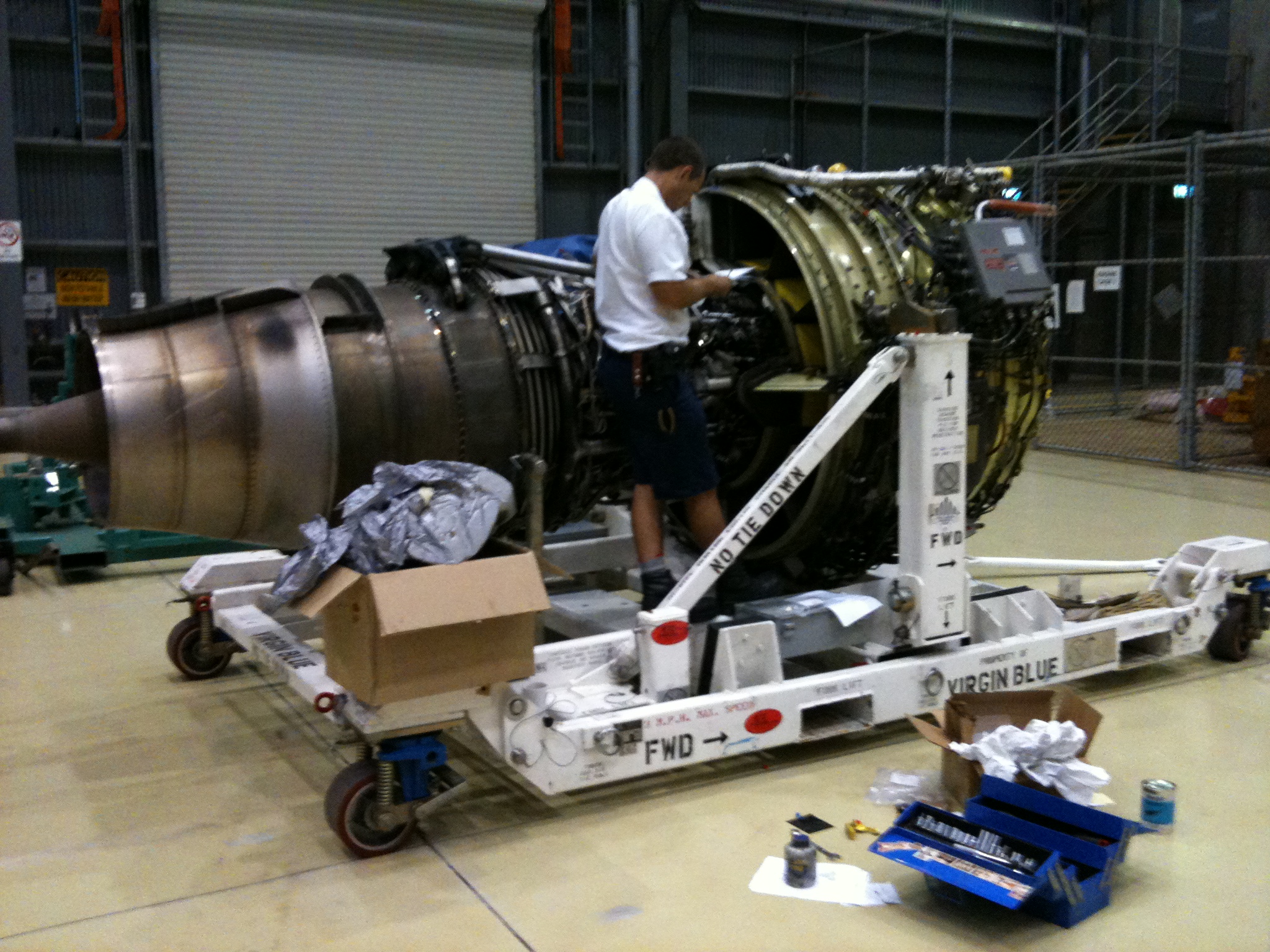

Thoroughly pistol whipped by the gas turbine, even more so in the reliability stakes. They'll run on pretty much anything that can burn and be introduced to the combustor continuously. They've been run on diesel, alcohol, vegetable oil, hydrogen and even coal! I'm surprised that no ones really had a proper go (that I'm aware of) at developing a modern production car powered by one. The Chrysler turbine car was built in the 60's, material technologies have come a long way since then.
