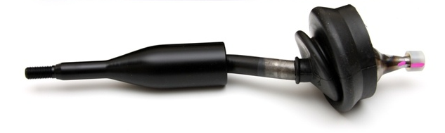

irokin Posted May 1, 2012 Author Report Posted May 1, 2012 Good news for tall people. After a tip off from my mechanic that it might fit with a bushing change, I've found the R34 GT-T gear stick is a direct fit in the FS5W71C (SR20) gearbox. The shifter has a kink which sets it back about 3-4cm. For me it took the shifter from "a bit of a reach" to something "acceptable". Fits with all the trim like a standard one. Quote
