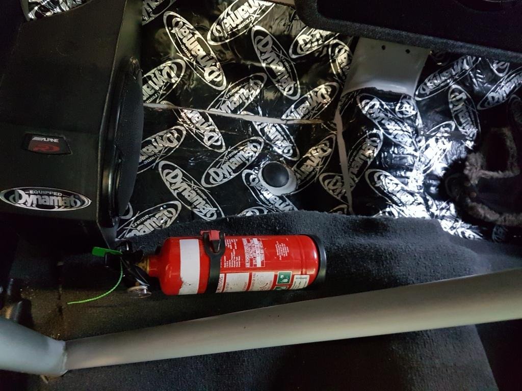

I also put some more dynamat in the hatch.

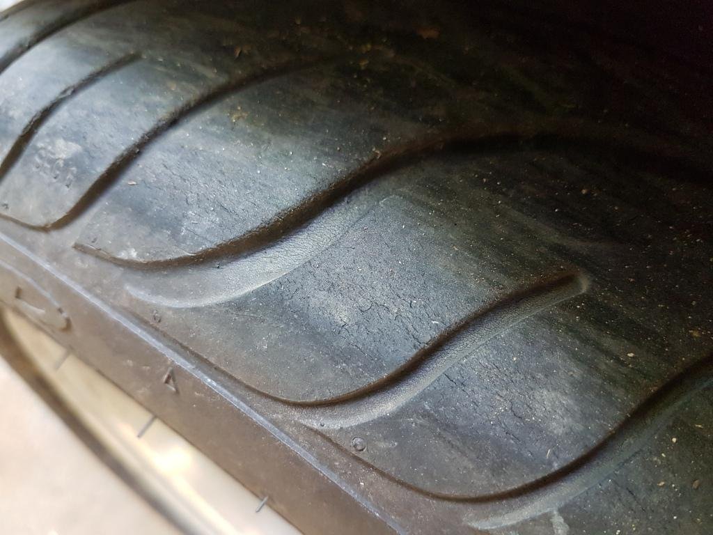

Took a half hour drive in the pouring rain yesterday.  Tyres are great in the wet unless you introduce too much sideways g force and right foot.  However pulling off the lights is quite easy, even with all the torque, while everything else creeps off you can get away like its dry in a straight line.
