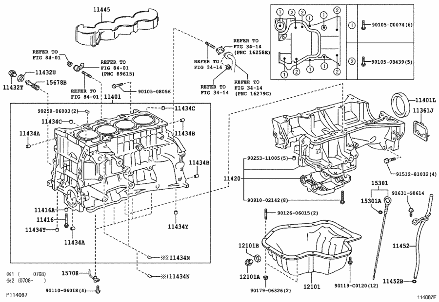

I can totally see this being The Next Big Thing. It's like an SR20 but (dare I say it?) better. Be interesting to see how they tolerate revs, fair old stroke on them. Might not be an issue? There's guys taking SR22VETs (91mm stroke) to well over 9000rpm now.
Have they got a crank girdle? Full counter forged crank at least :) should be good for some serious power.
Once these get some RWD development under their belts I'm sure they'll become one hell of a potent engine.
Kinda sorta not really? Nothing a solid chunk of aluminium and a CNC couldn't fix.
Open deck might be more of a concern. Could get interesting up around the 500-600hp mark. SRs start ovaling standard cylinder liners around there. Offset crank might help though?
can anyone explain to me what the deal is with the offset crank?
time for someone to make one of those "block gaurds" that the honda boys love so much
I think the idea is that the conrod is pushing at less of an angle through the power stroke so that there's less side loadings on the (unsupported) cylinder walls.
