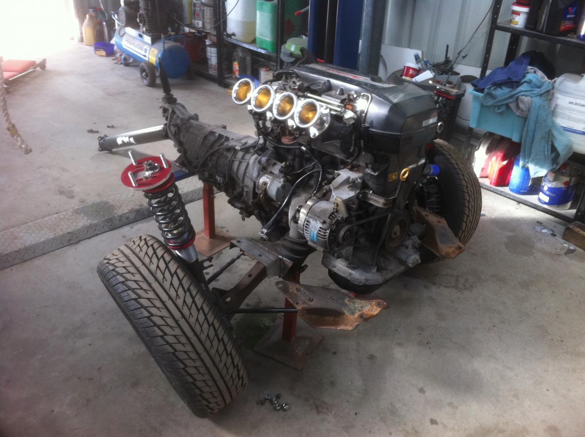

Finally got it started tonight, had some dramas with a fuel blockage inside the pump body but once it was cleared, she fired straight away. Still heaps to do but what great sound to my ears... More videos and info to come...... For now I'm heading to bed to dream about fangin round in her :)

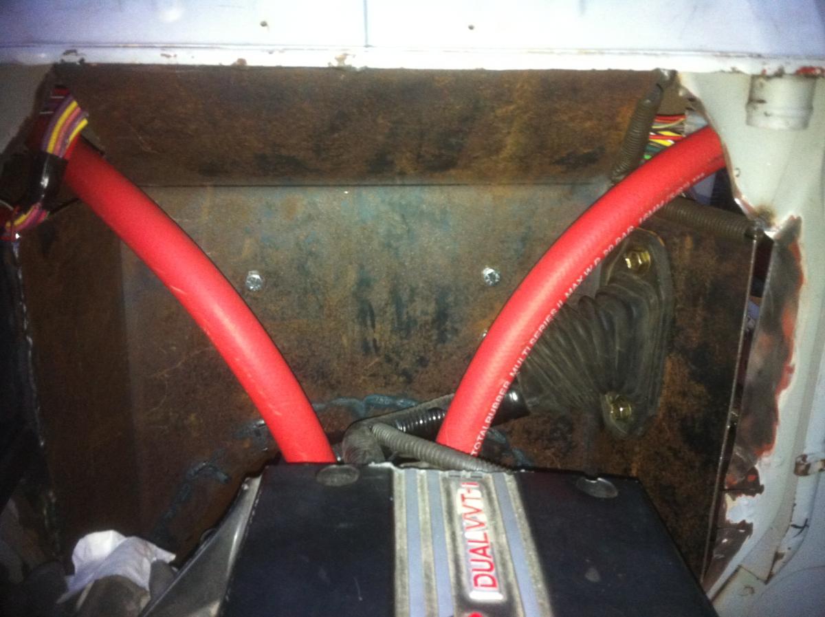

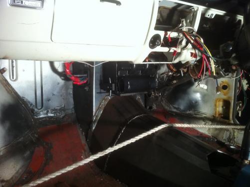

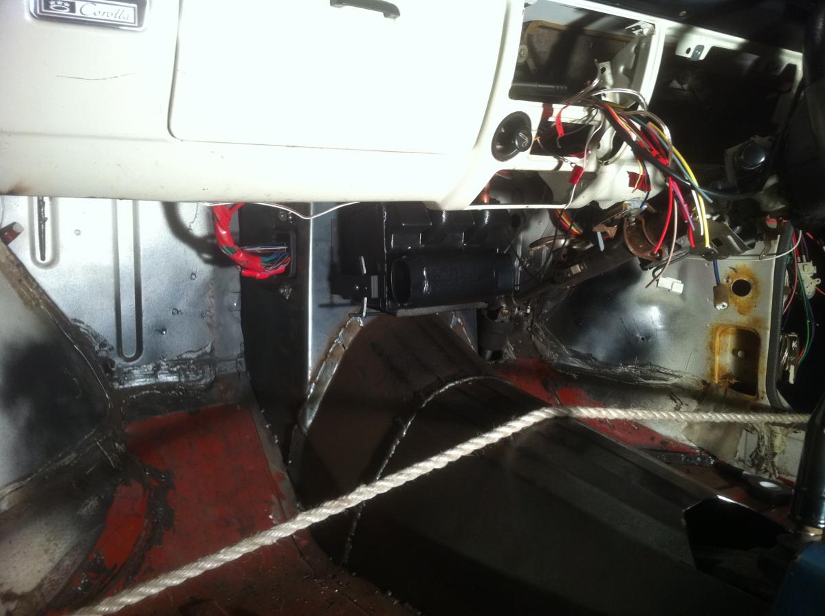

Well I proceeded to install my Vintage Air heater/demister unit last night. It fits nicely under the dash with only millimetres to spare :)
As you can see here the core is visible from inside the car, I'm not sure if i will make a sheetmetal cover that hides this or just leave it exposed??? What is everyones thoughts???

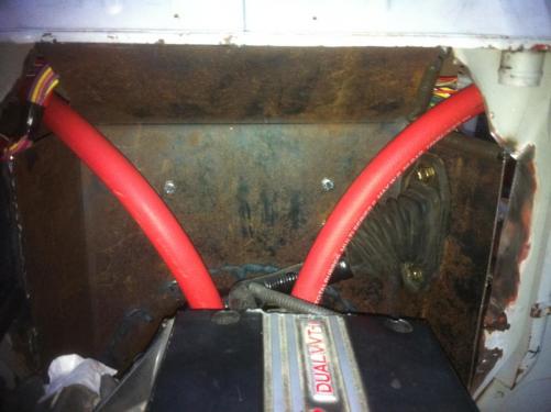

I'll get some more photos of the hose routing this arvo and post them tonight. Fingers crossed it all fits in there and nothing fouls i.e. wiper arms, glove box etc. LOL
I have run the heater hoses through the gaps at the top of the firewall as this aids routing the hoses under the dash and minimises the risk of kinking the hoses.

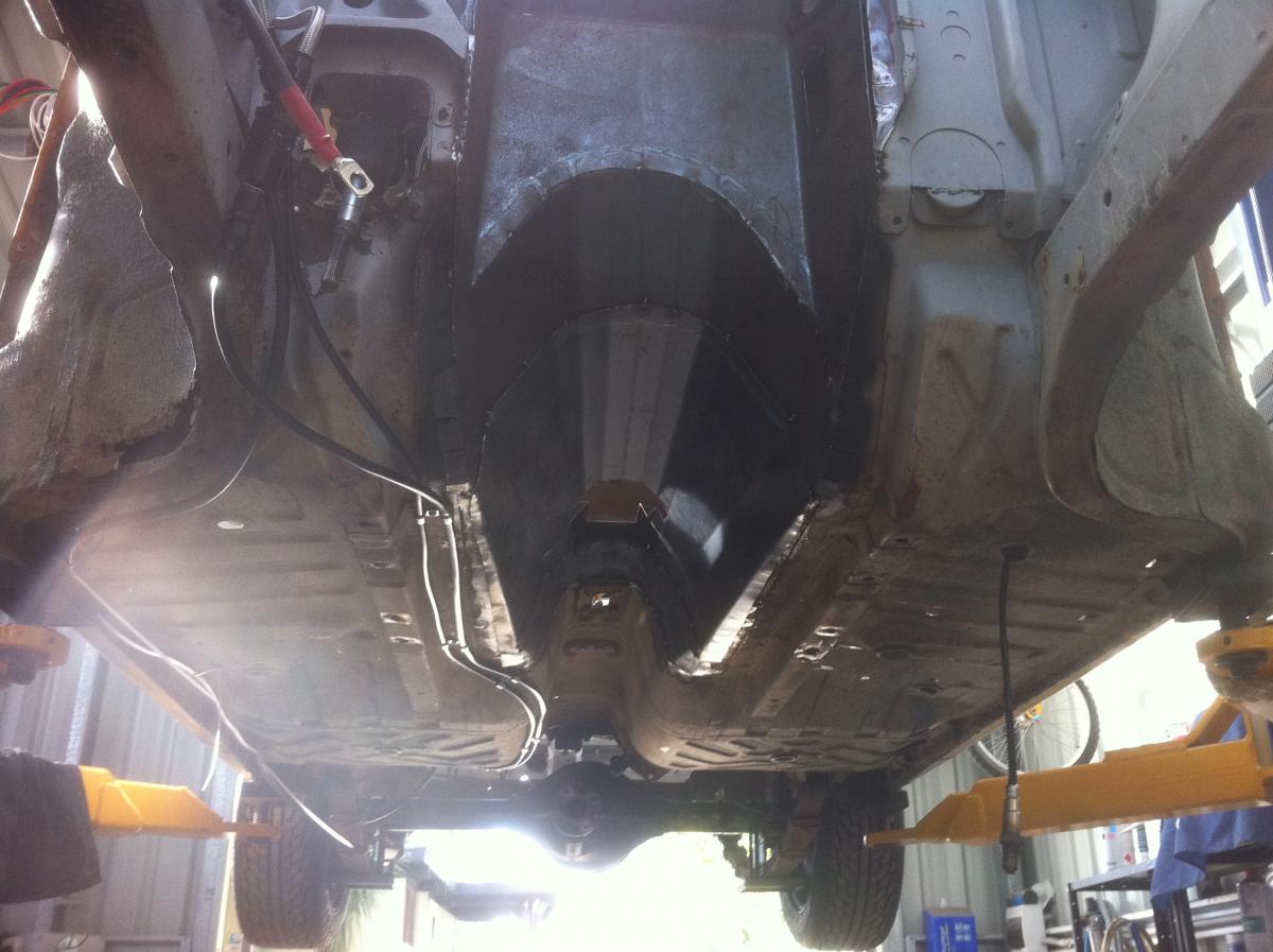

Here is a photo showing the fuel line routing, I tried to keep it tucked up in the tunnel as much as possible and close to the rail to minimise anything flinging up off the road and damaging it.

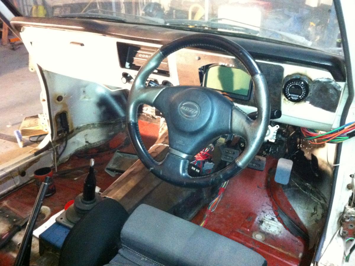

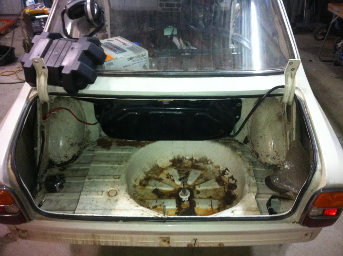

Yeah Autofill I've been slowly making progress on the beast. The wiring is nearly done, its been a massive job but well worth the results. Things are coming along with the new boot floor going back at the moment and the dash getting sorted. I still need to wire in the brake switch, alarm and central locking, run brake and clutch lines, get front and rear swaybars made and mount the rear shocks.
Whats that steering column out of?
