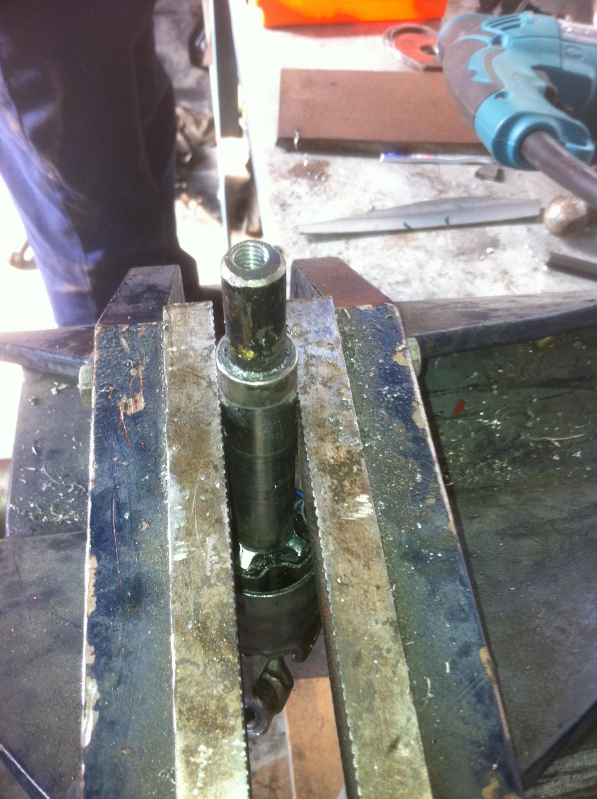

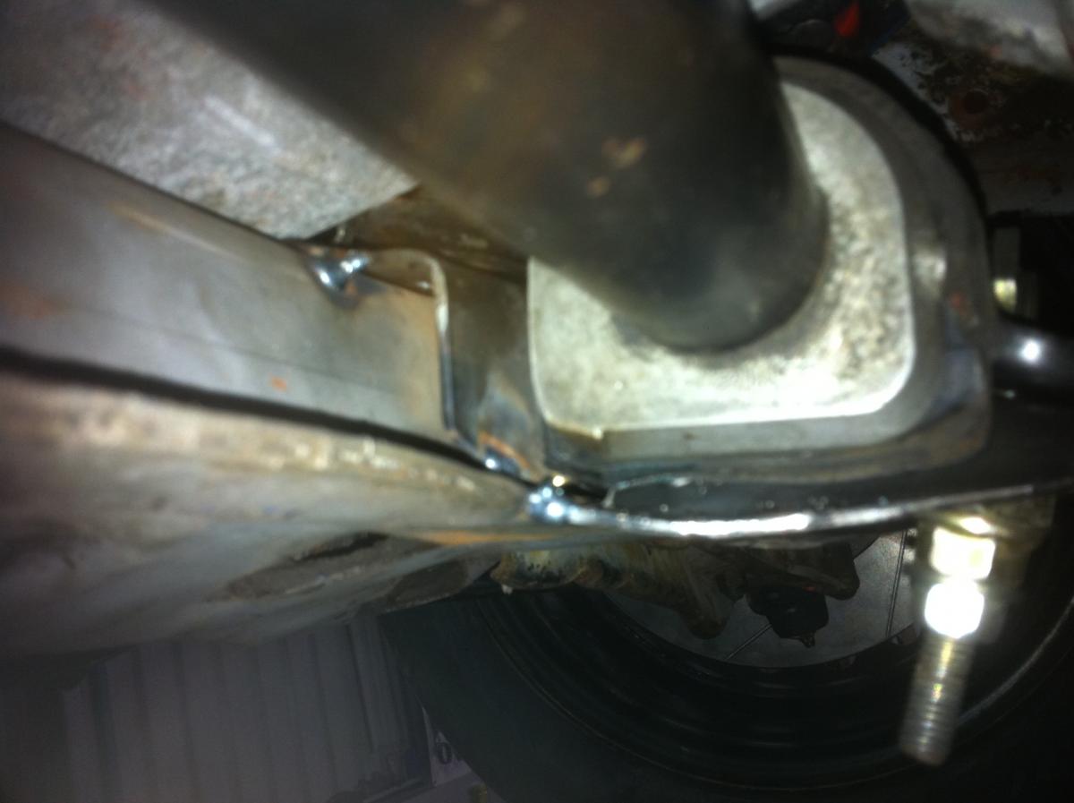

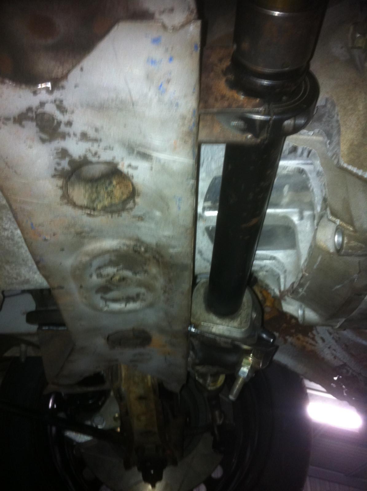

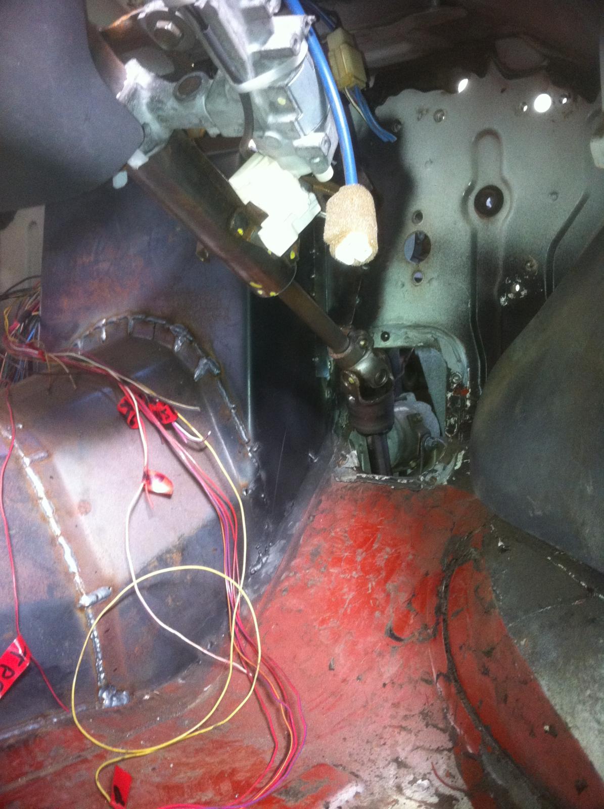

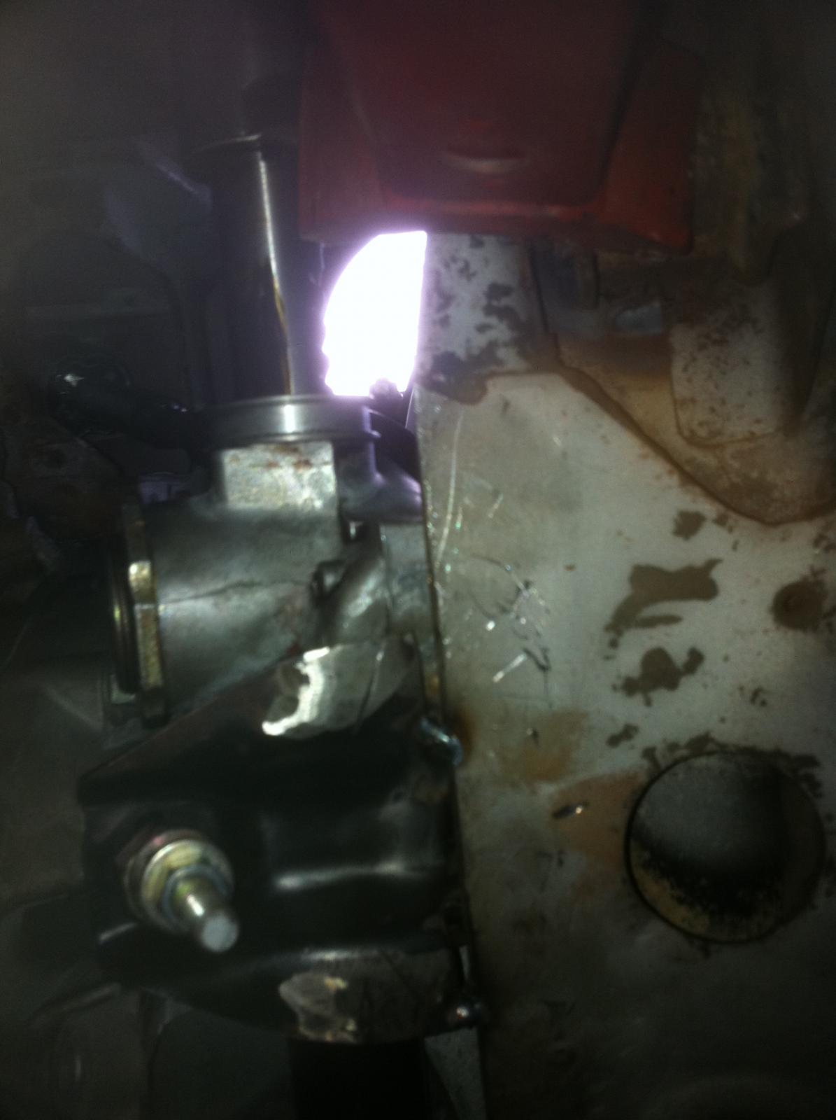

Made some more progress today, pretty stoked with how things fell together. My mate Muzz came round and we got the steering rack in and tie rods pretty well sorted.

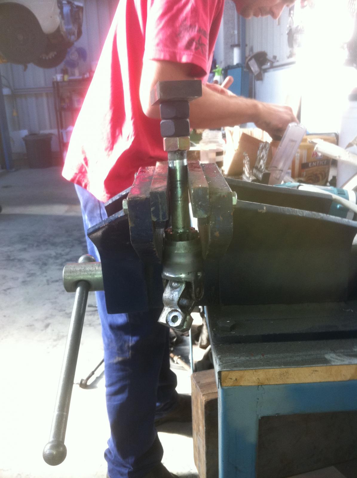

I used the intermediate rod from the Altezza along with the column. I had to shorten the intermediate rod to 70mm extending from the main body. So we cut the splined end off and tapped a thread in it, then screwed it out using a bolt and series of nuts that the shaft slid up the middle of and BAM!!!! its was out. We then cut the remaining shaft down to a 100mm in length and inserted it into main part and welded.
post-10705-0-16132300-1338797795_thumb.jpg post-10705-0-36515200-1338797724_thumb.jpg post-10705-0-28376600-1338797652_thumb.jpg

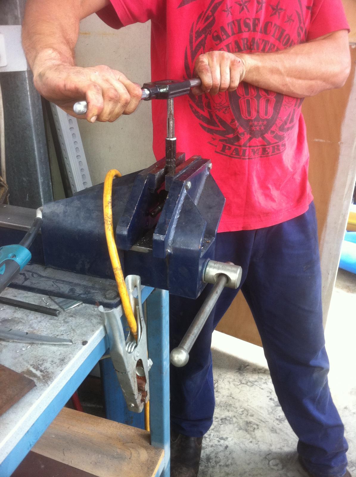

We then shortened the tie rod ends by cutting them down and tapping a thread into the tubed end. It probably need ends about 30-40mm shorter than KE70 but I can sort that out a bit later on.
post-10705-0-48861200-1338797395_thumb.jpg post-10705-0-22571100-1338797517_thumb.jpg post-10705-0-59165900-1338797591_thumb.jpg
We managed to use the KE70 D/Side mounting bracket to ensure the pressed end doesn't come loose so pretty happy that fits. We followed Rob KE25 thread instructions (http://www.toymods.o...ell-my-car.html) So hopefully it all pans out well and suits the front geometry :)

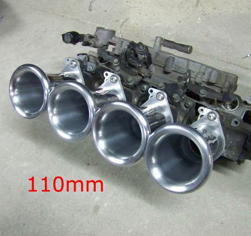

I've also decided to use Sam Q's velocity stacks in probably 70mm length. I would prefer to run 110mm stacks but they will fowl on the firewall.

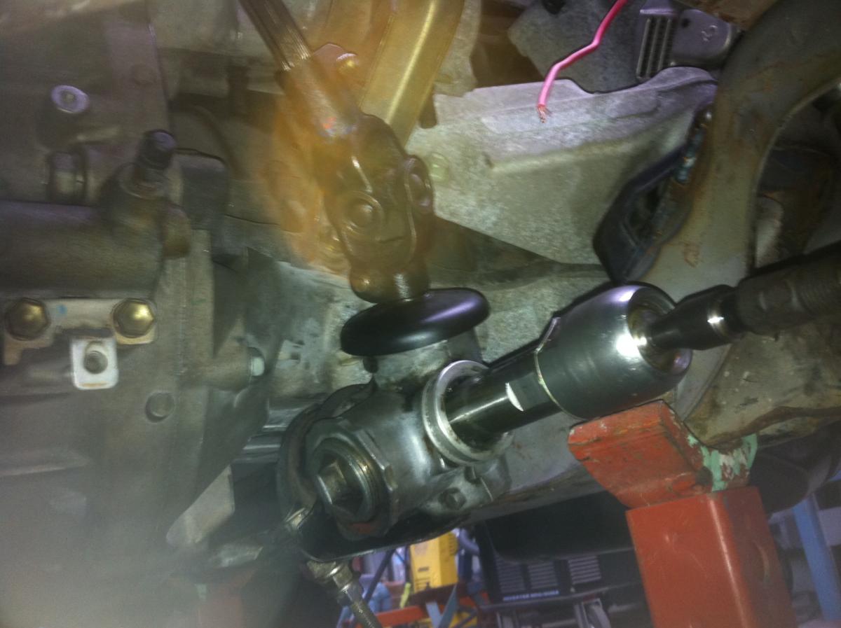

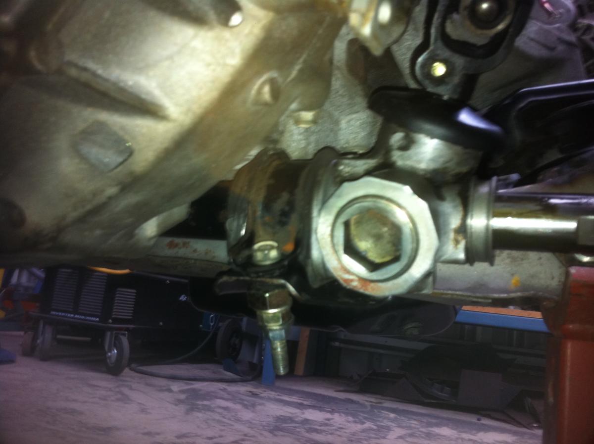

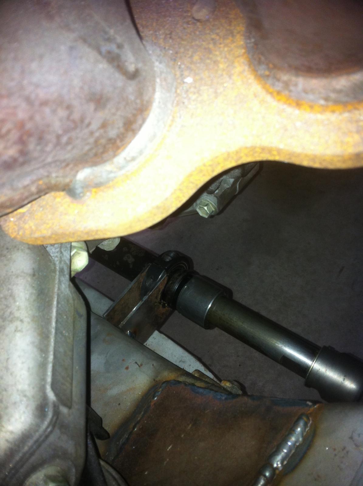

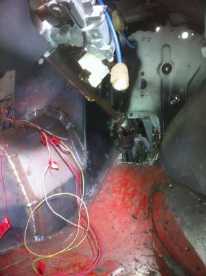

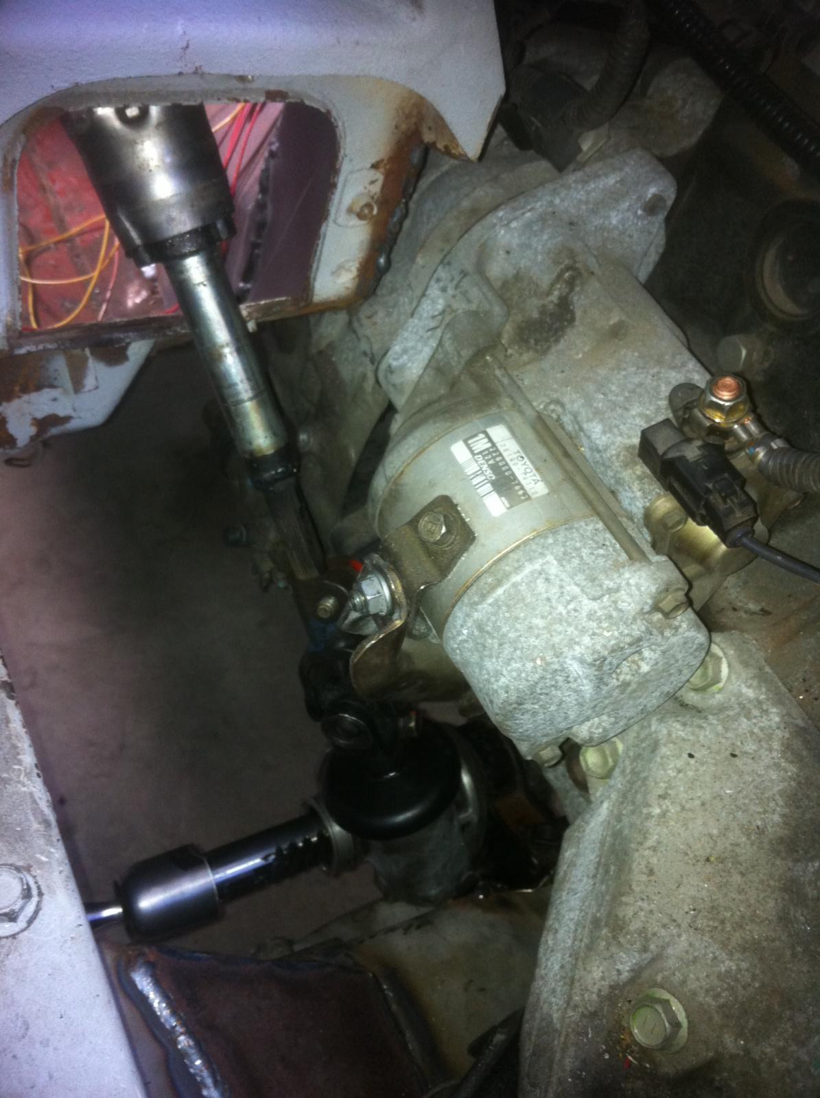

So peeps heres some more photos of the rack setup. Hopefully these photos shed some light on the install.
post-10705-0-02622900-1339019199_thumb.jpg post-10705-0-97301800-1339019202_thumb.jpg
post-10705-0-96305600-1339019211_thumb.jpg post-10705-0-46592900-1339019215_thumb.jpg
post-10705-0-18196700-1339019219_thumb.jpg post-10705-0-67615900-1339019222_thumb.jpg
I am probably going to shorten the rack by about 30-40mm as full lock scrubs the rear of the inner guards. This will also help with the 3 full turns lock to lock. I'm hoping it will come down to about 2.5 full turns :)

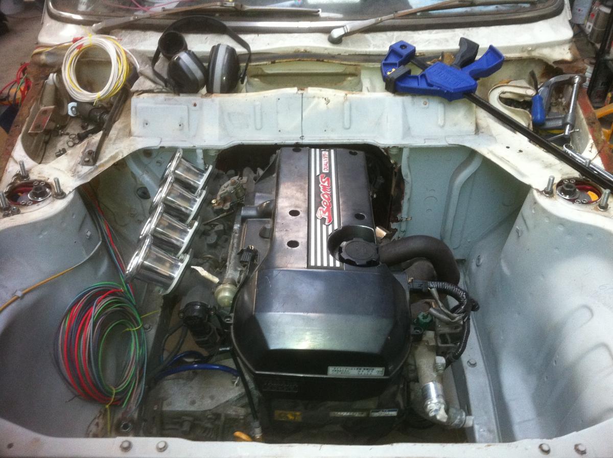

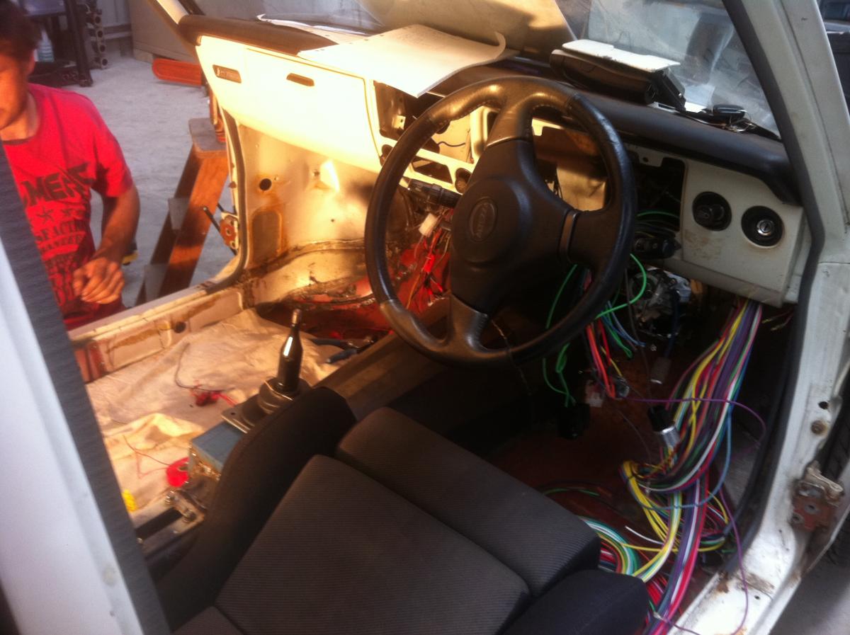

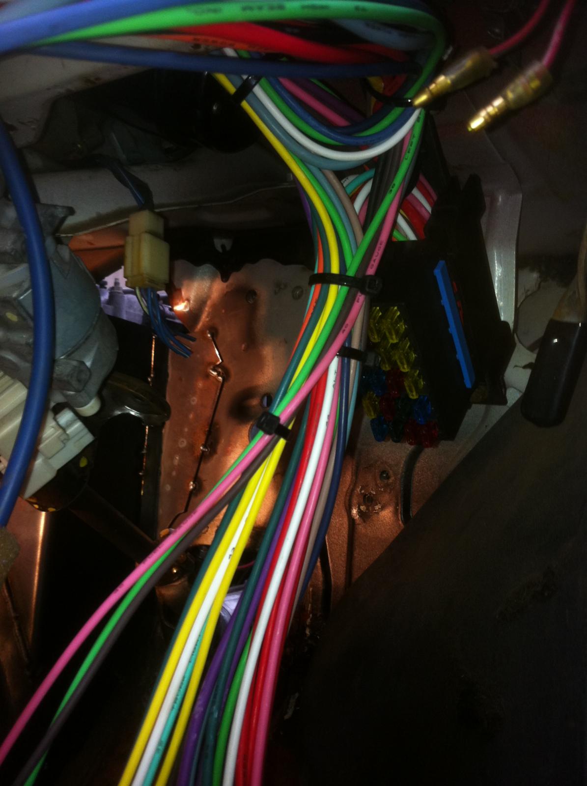

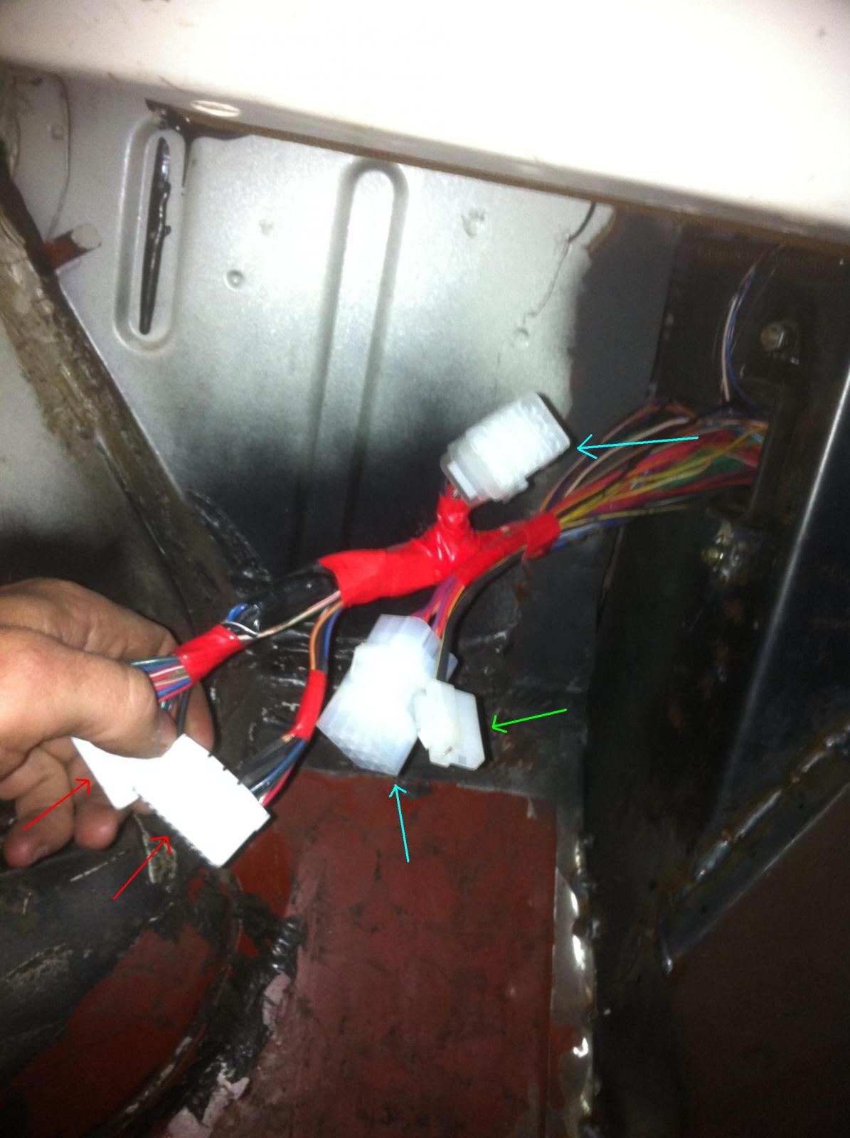

I've also made a fair dent in the wiring harness thanks to my mate Muzz :) The following is the plug arrangement between the ECU and body harness. We set the car up so that the motor can be removed by unplugging the motor harness from the ECU harness and out she comes. This will make maintenance a million times easier in the future.
The red arrows show the ECU plugs, the light blue show the body harness plugs and the fluro green shows the starter solenoid wire.
This photo is how the wiring is basically layed out throughout the front of the car.
This is the fuse block re-mounted where the original fuse block was located.

Jordain,
Shortening the rack is quite simple in the end. I only need to shorten the actual rack not the housing. It is a matter of removing the rack piece that the rack ends screw into and machining the desired amount off and re-tapping the thread. It will allow the missus or anyone else to drive it without scrubbing :)

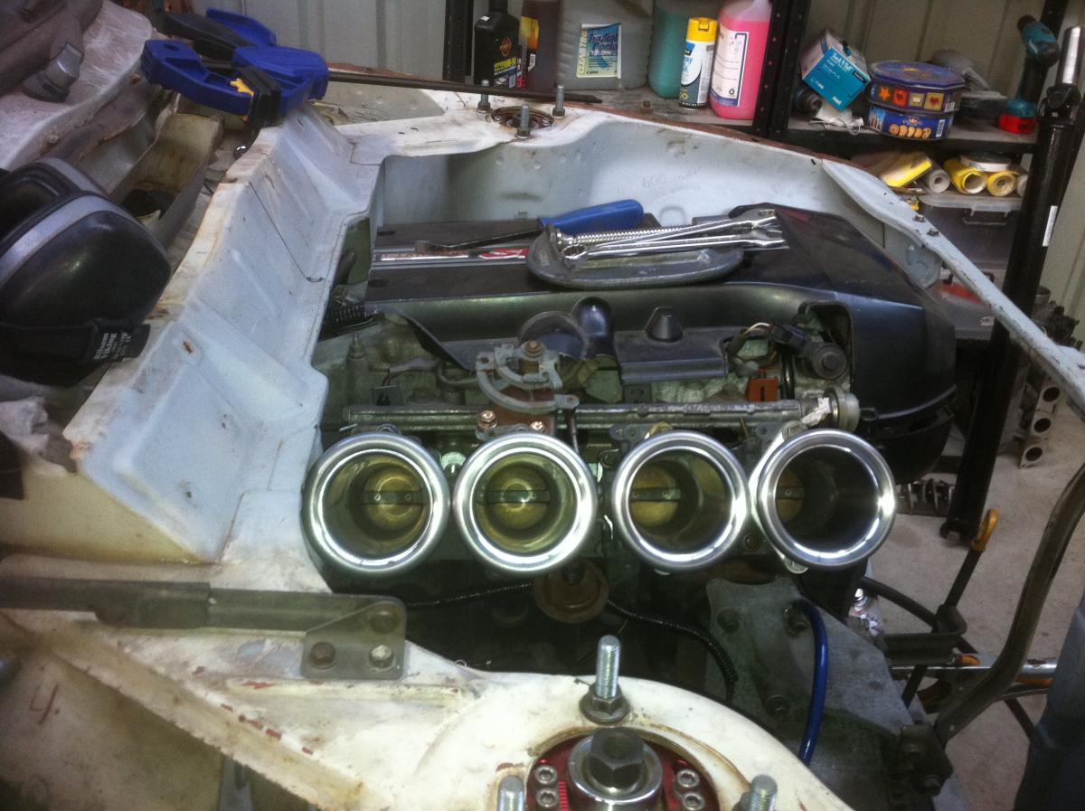

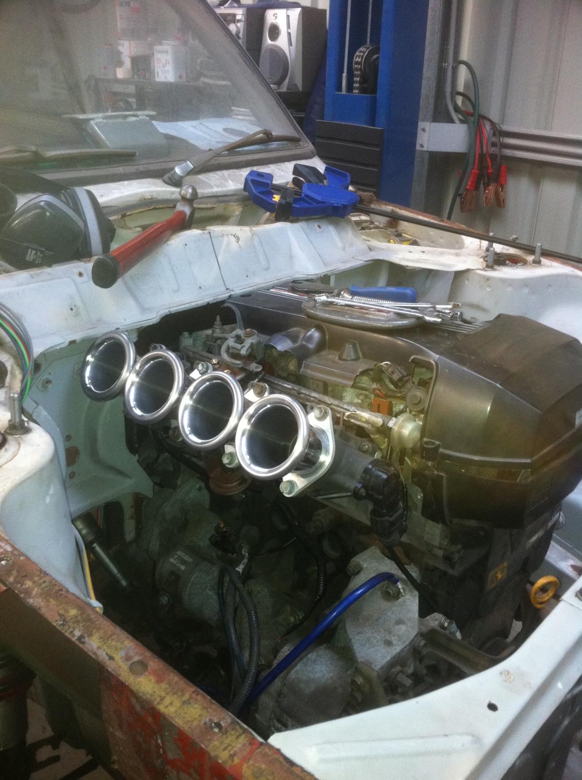

So I got my velocity stacks yesterday in the mail from Sam-Q (toymods or Sam-q engineering). I am totally stoked with the fitment, perfect blend on the internal joins between stack and throttle body. Also the mounting brackets come press fitted to the stack for easy install.
I decided to go with 70mm long stacks as it suited the configuration as seen in the photos. If I went any longer they would have fouled on the firewall and made more work for me.

So things are moving along nicely with the ECU harness and body harness nearly sorted its onto making the dash panel so I can mount my LCD display and 02 sensor display.
