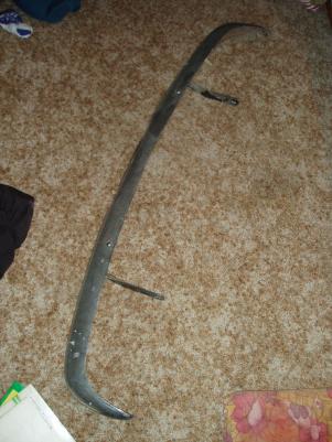

Put on a new front bumper, though it's not perfectly straight and giving me the willies.

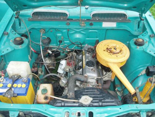

Drove him for a while, all good, then started having heating problems because the thermostat got clogged with rusty water, then the temp started fluctuating like mad. Got it looked at and he slightly blew a head gasket.
With Uni assignments over, had some time with a mate to fix him up, so what we did was:
~ New headgasket
~ New airfilter
~ New oil
~ Cleaned a lot of snotty crappy oil out of the rocker cover
~ New thermostat and gasket
~ New manifold gasket
~ Flushed cooling system a few times then new coolant
~ Topped up brake fluid (almost empty haha)
So we got him all started and he started, idled and revved but there were two problems
~ A lot of white 'smoke', though it was dark and cold tonight. Thought maybe it was water in the exhaust as the manifold sat off for a while and its been wet lately.. Hopefully, going to wait until daytime tomorrow and let it idle for 15 minutes or so and watch.
~ More of a problem, there's a lot of space when I'm pushing down the accelerator before it starts to rev, and once it started to rev it only has about 30-40mm left, and when its 'full throttle' it doesn't rev as high as it used to and splutters and dies. The part of the cable that is in that folded rubber sheath thing seemed kind of slack, but I'm pretty sure we didn't muck around with anything, just disconnected the accelerator cable and choke cable from the carb.

Did you do the timing after you did the headgasket?
No we didn't, I don't have that much experience but my mate does, and he didn't mention it.
By hand it revs so well now though, it used to take a while to pick up revs just in neutral, but now it's way more responsive.
The accelerator pedal is kinda loose and flappy too, not springing back much etc, I'm thinking the accelerator cable just needs adjusting, I just don't know how to do it.
All good now, my mate attached the accelerator cable to the same part as the choke haha, so silly

Went to look at a 4k out of a 55 today, everything fan to fly, except for fan haha. Looked a little grotty, but didn't use oil or water and never skipped a beat apparently! Going to give it a clean up then drop it in :) maybe work it a little while it's out, putting a cam in will be a lot easier when it's out, and getting some compression going! But yeah paying $100 :) pretty happy
Okay so the head in the 3k is cracked :( so we've put in the 4k, using the manifolds and carb from the 3k as my exhaust wouldn't fit up to the manifold (when I get extractors and exhaust I'll swap it all over), and got it started and managed to baby it home, but having a few troubles.
~ although when it goes well it goes SO well and has SO much more torque (feels like normal car woo) 60% of the time when I accelerate it starts to splutter about 2500 - 3000rpm, sometimes I can push through it, others it just dies and makes almost zero noise until BANG backfire. The accelerator and choke cables are now on different angles as the rocker cover mounting for them is in a different position now and aren't aiming straight to the carb anymore, that could affect it?
~ The alternator wont charge the battery, as the one plug has three metal bits (name escapes me) and the other only has 1, but they connected up so we thought we'd try anyway. Didn't work haha.
~ The temp guage wire had to be extended because the male part was on the right side of the thermostat housing on the 4k instead of the left, so we extended it by soldering in some speaker wire, but the temp is either cold as a rock or above the highest point, even when the engine is cold and not running.
Any help? Cheers, Toby
Edited by Nostalgia
For the temp gauge you need to use the temp.sender from the 3k as it is the right one for the car.
Hope that helps fix it
Hey, which bit is the sender? The part of the termostat, or just the wiring?
EDIT: just did the research, didn't think there'd be much info on such a part. Thanks :) I might get a new sender, I'll see if Repco has them. If not I'll just swap it over. Thanks mate!
Edited by Nostalgia
