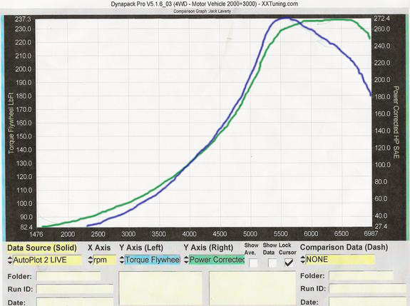

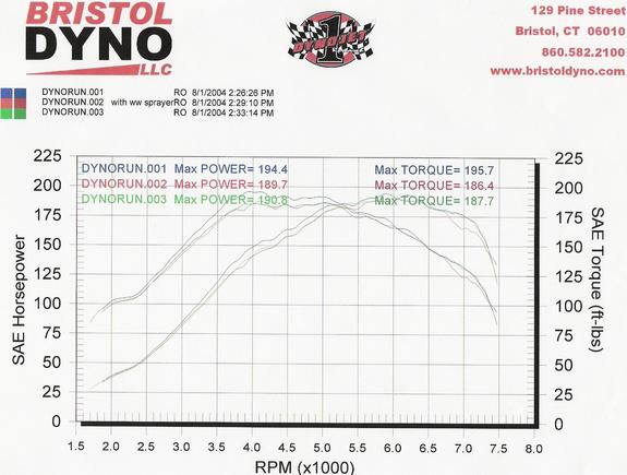

Here's some dyno results I just found:
This is from a Nissan Exa with a CA18DET with a T25:
This is the same car, now with a GT28RS and HKS cams:
Note the smooth power curve of the T25. It was supposedly a hot, humid day for this run, so power figures are probably a tad low. The same engine now with a GT28RS and the HKS cams goes from 100hp at 4,000rpm to 200hp at 5,000rpm. That's pretty scary.
I have just calculated what rpm my engine will be at when I change gears (eg. when I go from first at 7500rpm to second). When I get into second from the redline in first, I will have 4227rpm. From second to third I will go to 5133rpm. From third to fourth I will have 5419rpm, and fourth to fifth I will have 6457rpm. If my dyno chart were to be exactly like the second one pictured above (with the GT28RS), then when I go from first to second gear, then I will be right near the base of the steep power curve that follows 4,000rpm. From second to third and third to fourth, I'd be right near the top of the power curve. I had at first thought that this power curve was too steep, which it is in someways, but the main issue is that max power is at only 5,500rpm, leaving about 2,00rpm unused. I don't want a laggy turbo, but one that uses more of the rev band more effectively would seem better.
