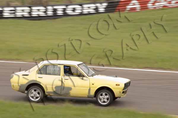

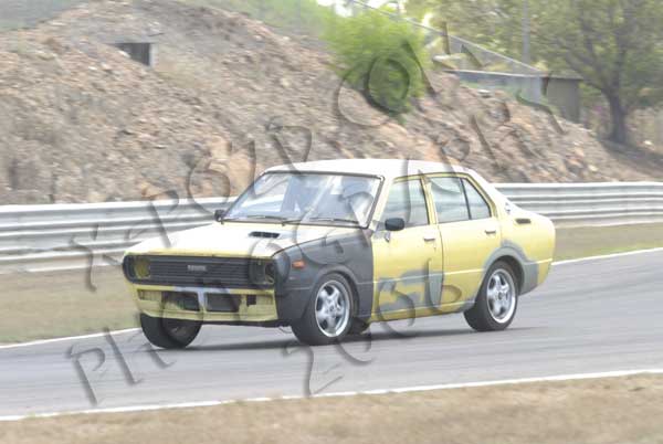

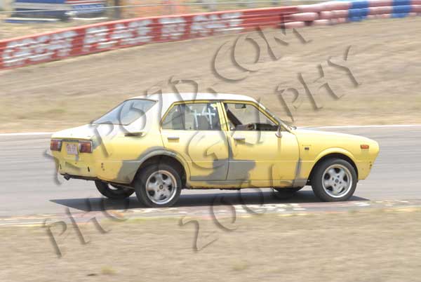

Finally got some pics from the race meet. There's one of me taking the sweeper, and it's a good comparison of how the car used to look while cornering to how it corners now:
Before front end lowering - 19.3.06
After front end lowering - 29.10.06
Work that suspension!!!

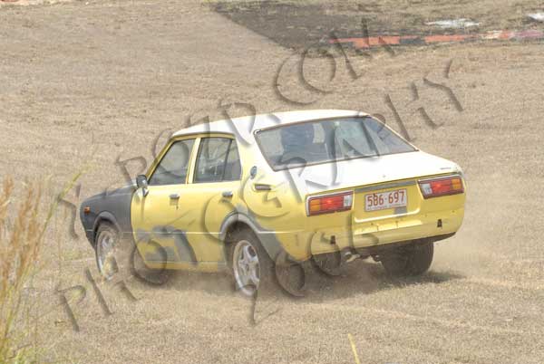

Me parking it off track when some intercooler piping came loose, making the engine act like it had a wide open throttle. :jamie:
