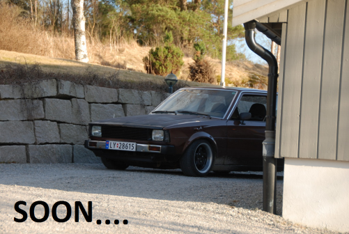

Long time since last time here now. Havent had time or money to do anything with the Ke70, but today I picked up some new wheels :) It is 8x14 and 9x14 with 175/50-14 on all 4. These are 4x100 and ET35, so I will be running wheeladapters to 4x100. There is also much more of 4x100 wheels to get than 4x114. I was out measuring the size of the adapters, and think about 50mm on the rear and 30mm on the front will be ok. What do you guys think? is front; 8x14 ET5 and rear; 9x14 ET-15 ok? :)
Have some pics, neeeeeeds lowering! :)

Just drop it.
And so it was
Custom buildt coilovers all the way. pricetag, about 300USD :) The rear are a bit to much out, they are ET-15, ET-5 would have been better :)
