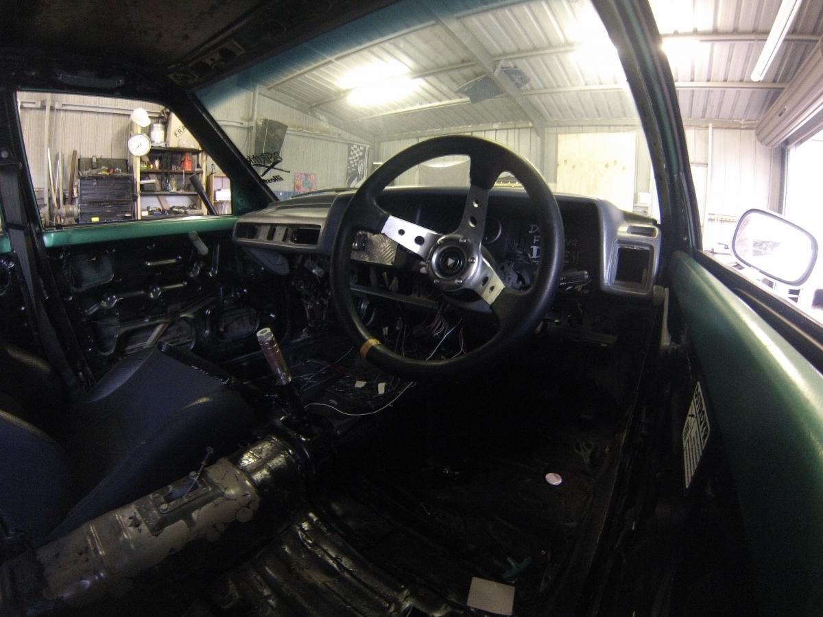

seat is going to be the last thing i do so i can come up with the best and strongest way for it

was thinking doing the seat this way.
http://clubroadster.net/vb_forum/86-diy-how-writeups/59318-fitting-elephant-suitcase-diy-mounting-race-seats-floor.html
but would also be welding in flat bar to the bottom of the floor for extra strength in the floor
the right hand side of the seat will still need to be raised up an inch to level it out on the floor but I'm thinking this may be a good solution for this problem I'm having.
for the rear top side bolts i will make up the uneven floor where in dips down into the rear seat footwell with a mount for either side.
will get pics and plans tomorrow

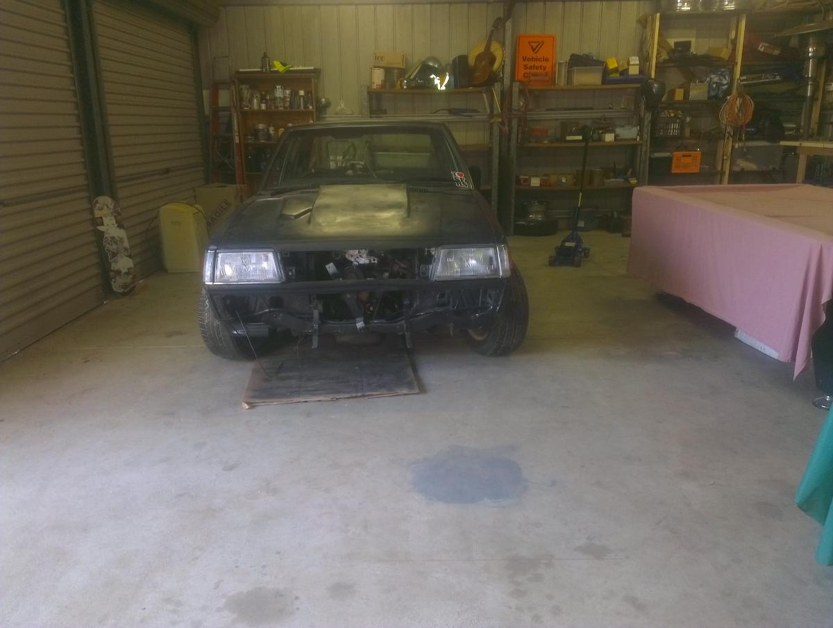

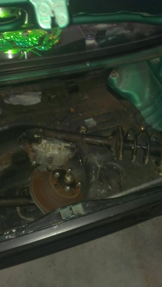

picked up some xt130 struts with brakes on em for $45 each pulled from the wreckers today.
pretty damn happy with that
also put in my extended lca's
which through out my alignment bad due to the tierods not being long enough.
they will be getting extended once i get some decent tubing.
scored a nice bit of stainless C channel which has solved my seating problem

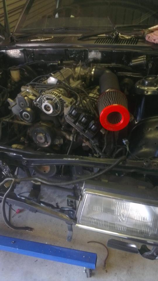

cleaned the engine up a bit with the wire brush and sanding block.

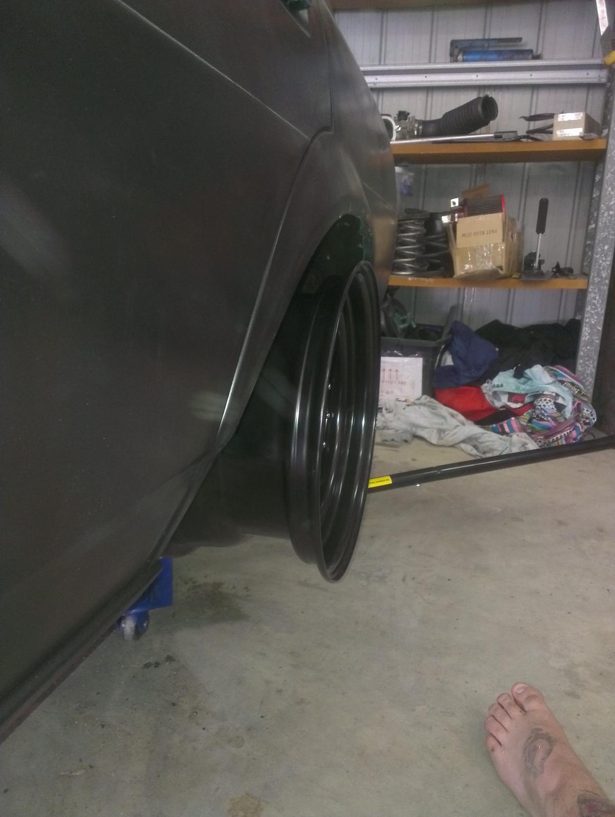

and fitted my wheels up to the rear so i could measure what size flares to order.
i want to run a little stretch as possible
the fronts require some to help with strut clearence but will be running the bare minimum.

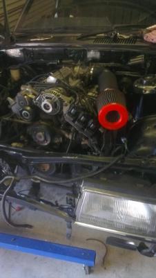

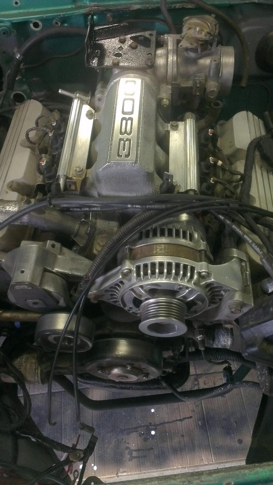

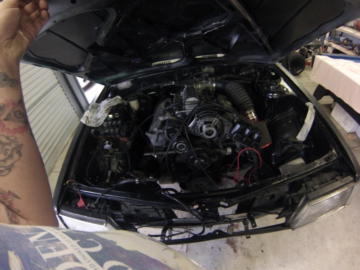

put the engine in over the last week
the guy i bough it off made the mounts a bit crooked so had to fix that.
which resulted in it sitting up a little higher then i wanted but atleast its straight
there is probably less then 1cm between the top of the firewall and the throttle body
only downside is the box was sitting against the tunnel so i had to cut out one side of it and bashed the other out
will be making a removalbe cover for it when i get ahold of some sheeting.

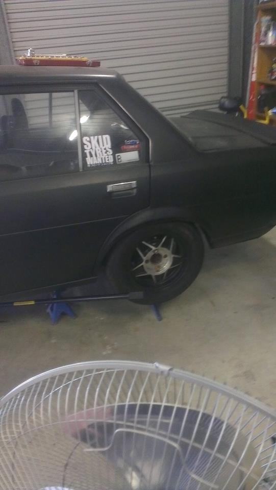

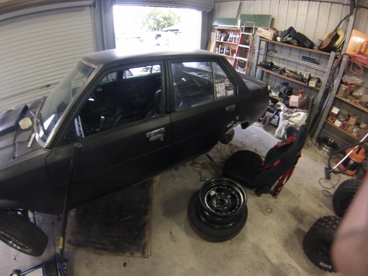

rear is pretty much finished suspension wise
got the sierra shocks in and it holds the choppies in at a perfect height
will order some decent springs eventually but these will do for now
have some xt130 struts sitting in the boot waiting till i order weld ons and then the front is sorted.

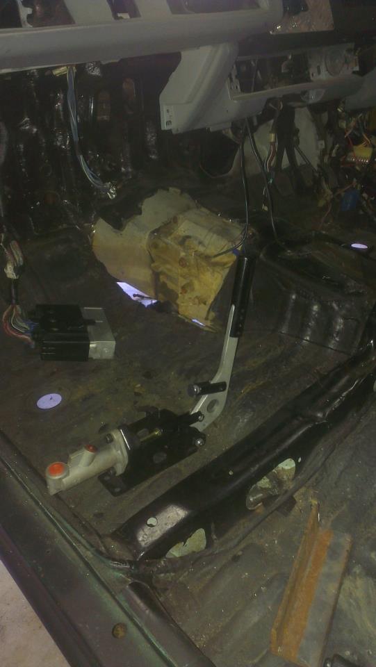

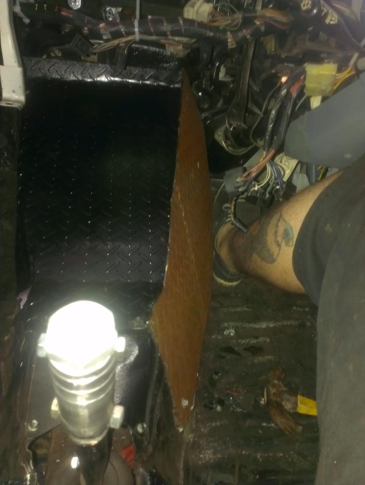

started on shaping the removable trans tunnel today.
got to get one more peice for the left side and then weld it all up and get some bonnet pins to hold it in place.

You can actually flip the inlet manifold over and run the inlet pipe out the front on theses :)
thats actually a pretty good idea would clear up alot of room.
still waiting to hear back from my uncle about this engine first

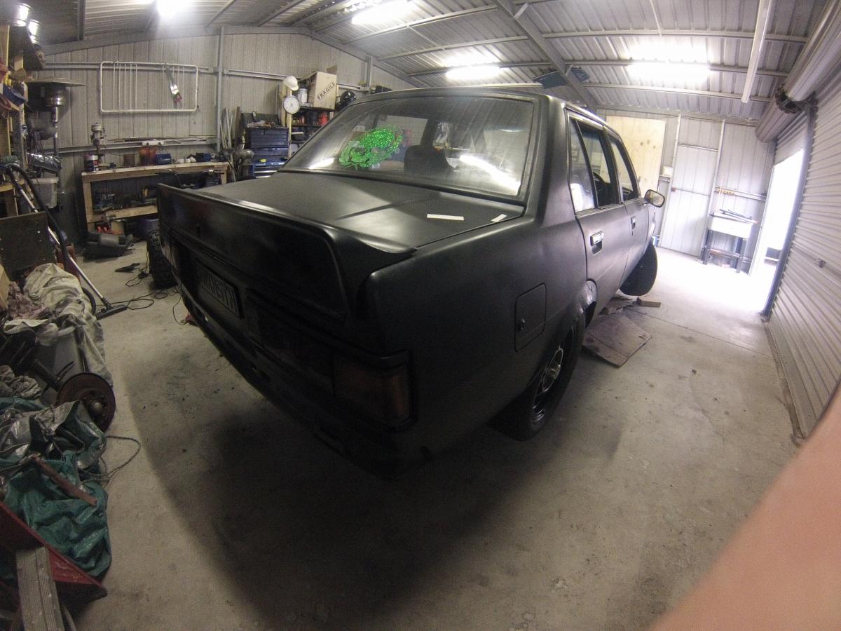

Another slanty front from newy!
looking good man :-)

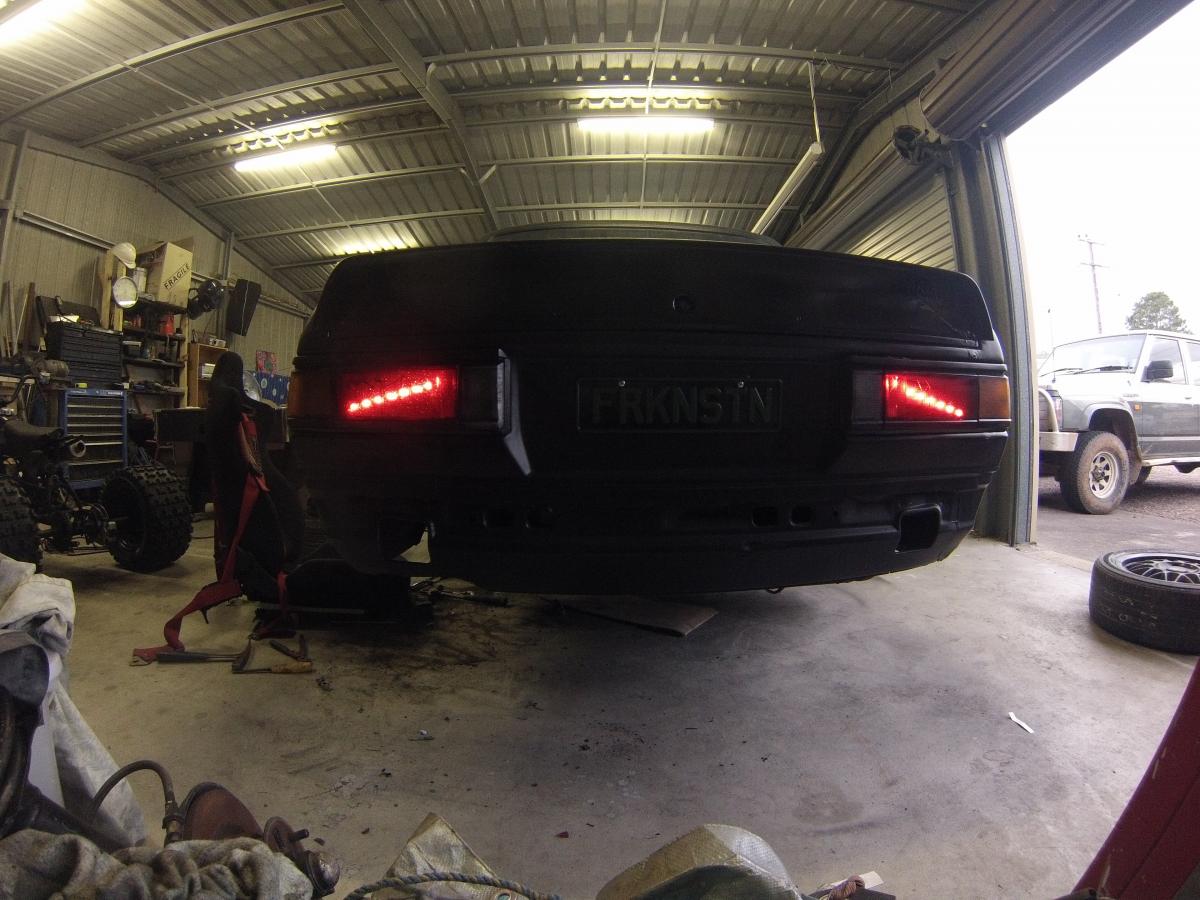

brake lights were F'd in the A so put some LED's i had in them instead
while i was getting the wiring all sorted.
chucked some other pics in as well
no i have another pair I'm yet to put in just gotta run wires
they will end up as an X once the brakes are on
will be tinting those ones so they arnt as bright
though 2 stage is a cool idea
