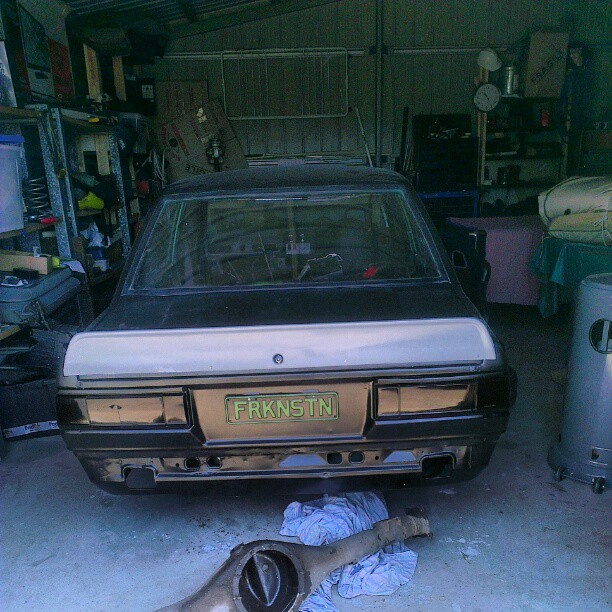

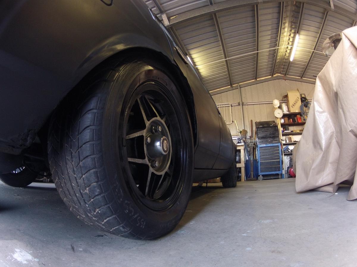

heres a couple pics.
was playing around with the gopro on camera mode.

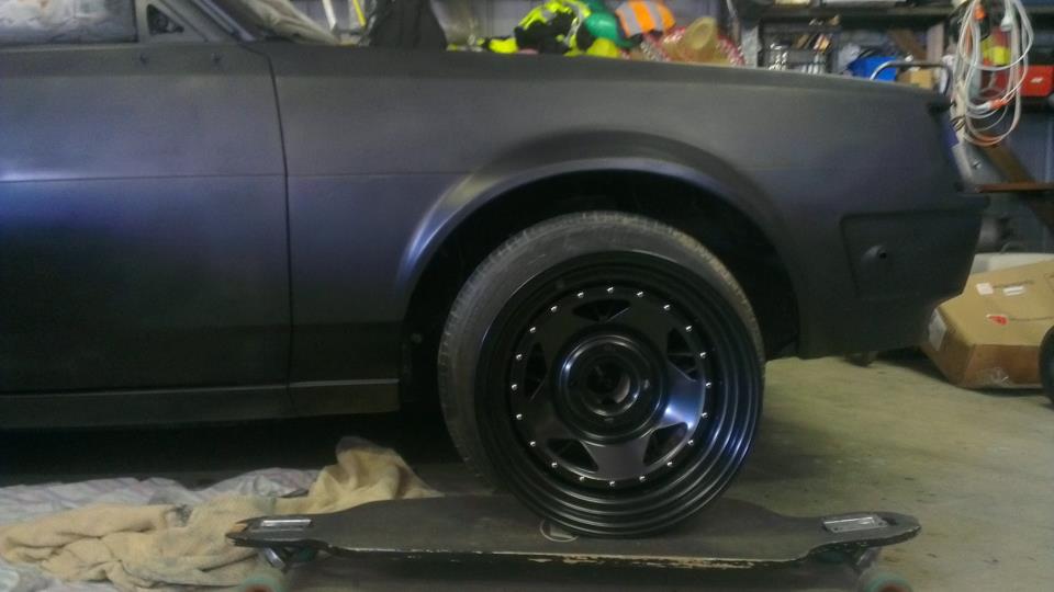

Get a real skateboard! Long boards are silly.

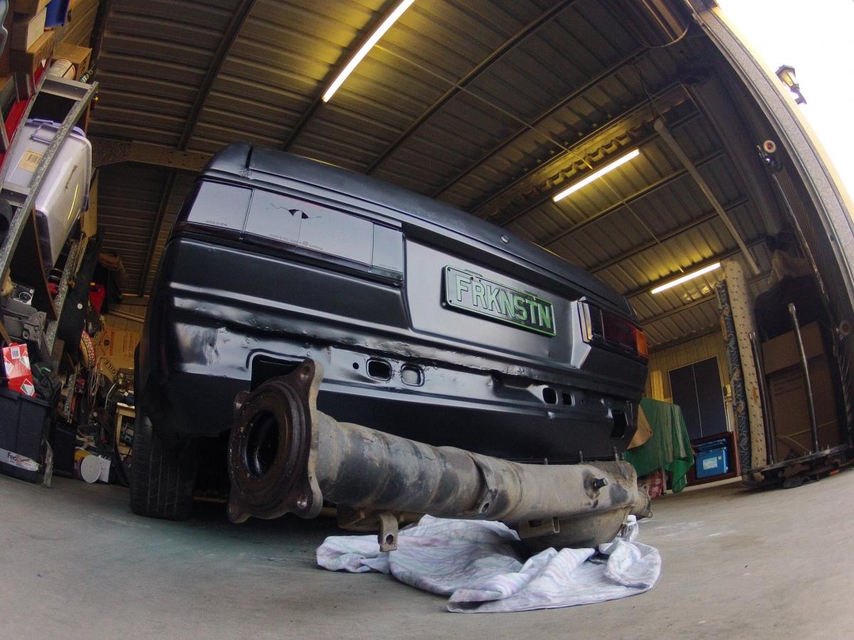

Also did you mean to paint the taillights?
Edited by It's_AUDM_Yo
There dodgy tinted gonna clean em off with thinners and redo em.
Edited by frknstn

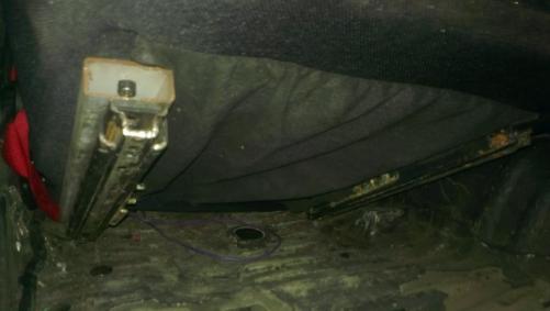

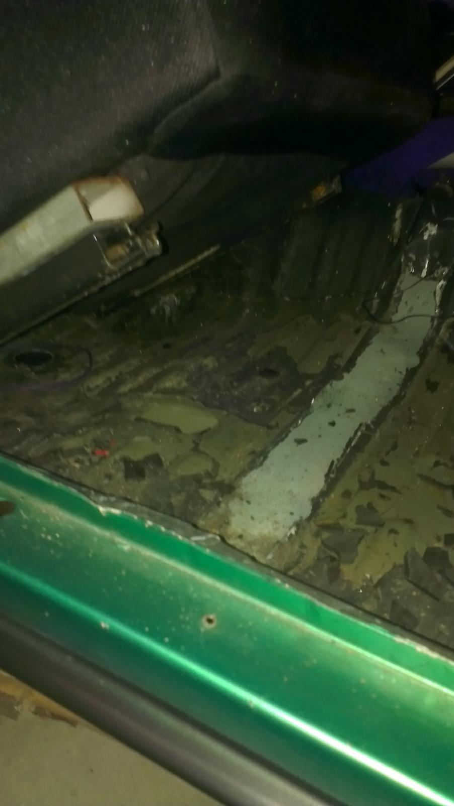

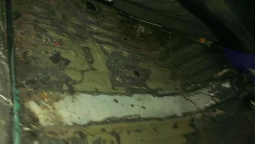

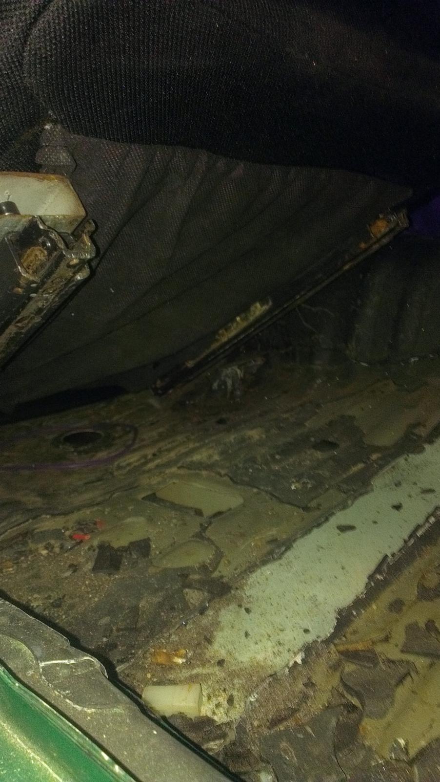

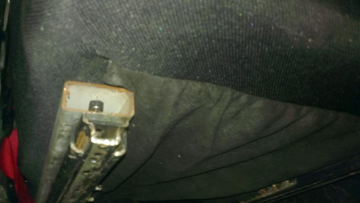

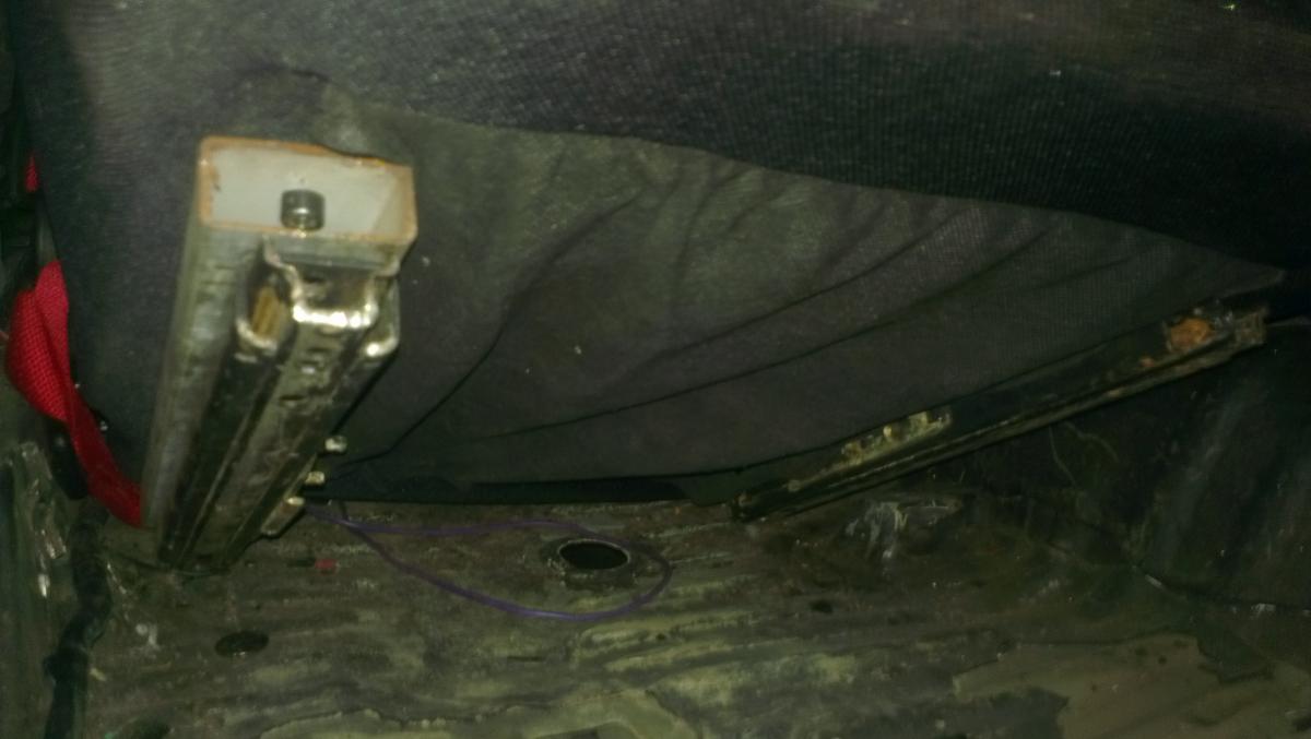

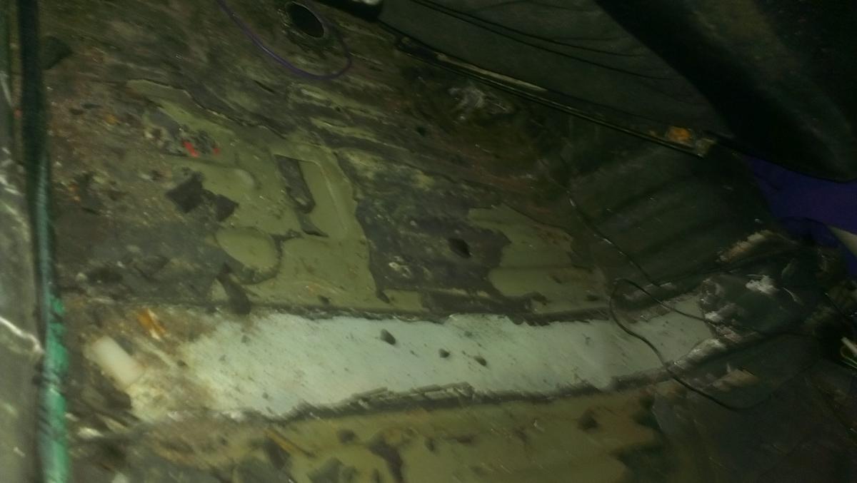

since my car is missing the seat mounting rails like so.
i started to think how to overcome that the best way.
the rest of what is left there will be removed as best as possible.

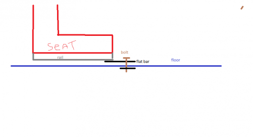

i got some square tube and mounted it on the right side of the seat to raise it up level since the rollas floor is slanted.
then i will be making up mounting brackets off the ends of the rails with 4mm flat bar that can get bent to the shape of the corolla
with bolts then going down through the floor with flat bar backing plates so it doesnt rip through the floor with the nuts welded onto them
can anyone who has delt with scrutineering at event see a reason why it would pass or not
this is the only thing i have been able to come up with to fix the problem

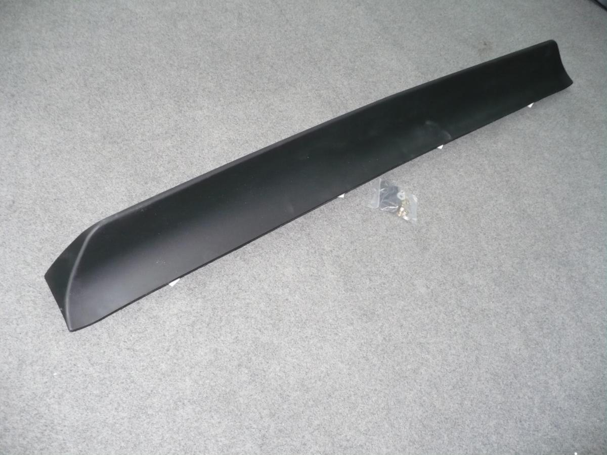

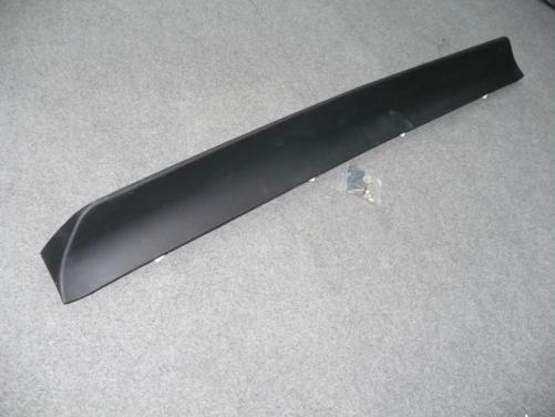

ive finally found the ducktail wing i want.
onlything its 20cm to long so I'm gonna have to cut and fibre it back up but should look the good.

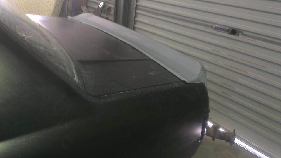

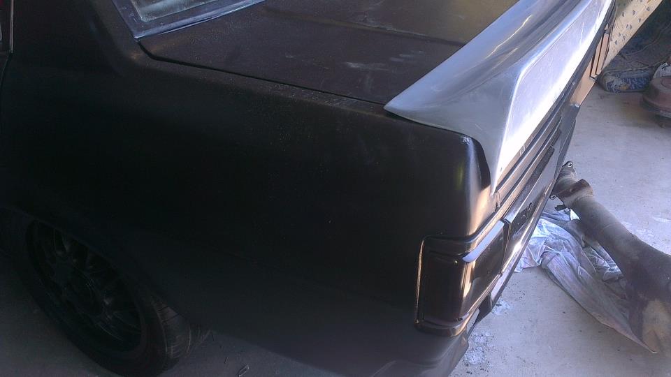

Hey look I have a wing.
Test fit before crashing out. Been sitting in a car for the past five days
Phone won't upload the pics.
Will do it in the morning
Edited by frknstn
Scratch that it worked

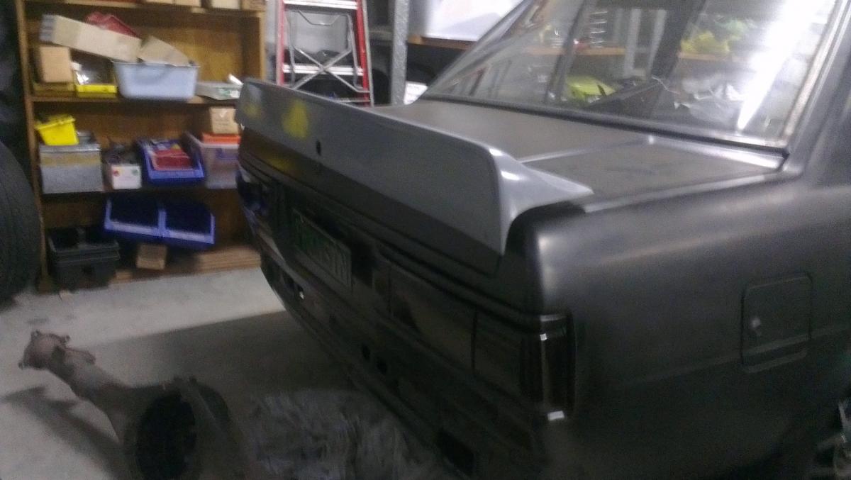

Wing looks tuff man love it, what's it off ?
Gte Xu1 Torana. It's almost a perfect fit man. And there fairly cheap

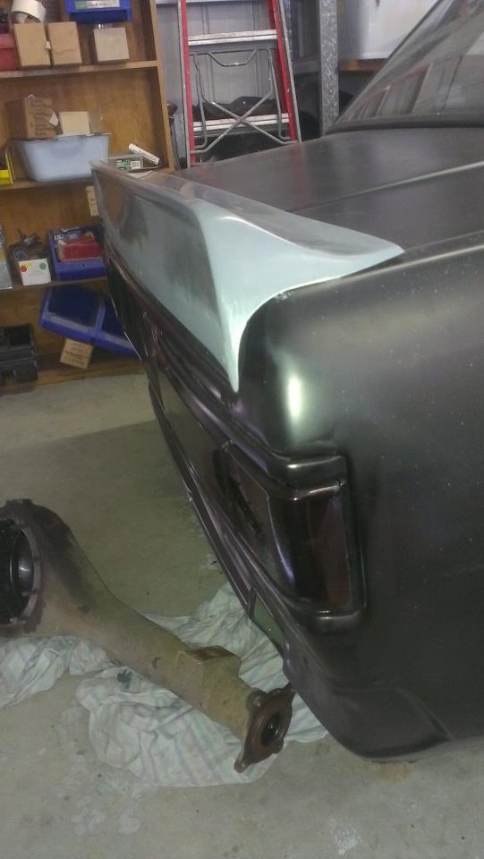

few more pics of it pretty much fitted
could do with a bit of work on the ends to fit a bit better.
the only thing about this wing is that on either end it kicks out a bit giving the gap on the ends
you could fibre in those spaces I'm guessing or cut the shape out of the boot line to match and it would fit better but
thats more effort than i can be bothered with since its only a thrasher.
looks the good anyway and its a perfect fit lenght wise.
You might have to rethink that seat mount idea as it won't hold up too well strength wise,
maybe with thicker flat bar, closer bolt mounting and extended length under rail it might though...
The problem is bolting it or welding it to the rail isn't always easy unfortunately.
