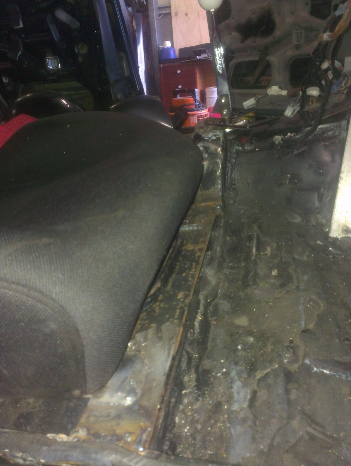

Got some 5 mill plate off cuts from work and made some seat mounts finally. Welded in main piece then cut up two more langths bolted to the seat and welded them on the main plate. Has a nice bit of 3mm stainless chanel style shit I found. Not sure what it was from but its strong as balls. Welded that in under the rear of the seat and bolted it up aswell. Seat does slide but its stiff as shit so gonna be a bitch to get back off if I have to. Just go Na clean up the front with a panel covering the Gap you can see.

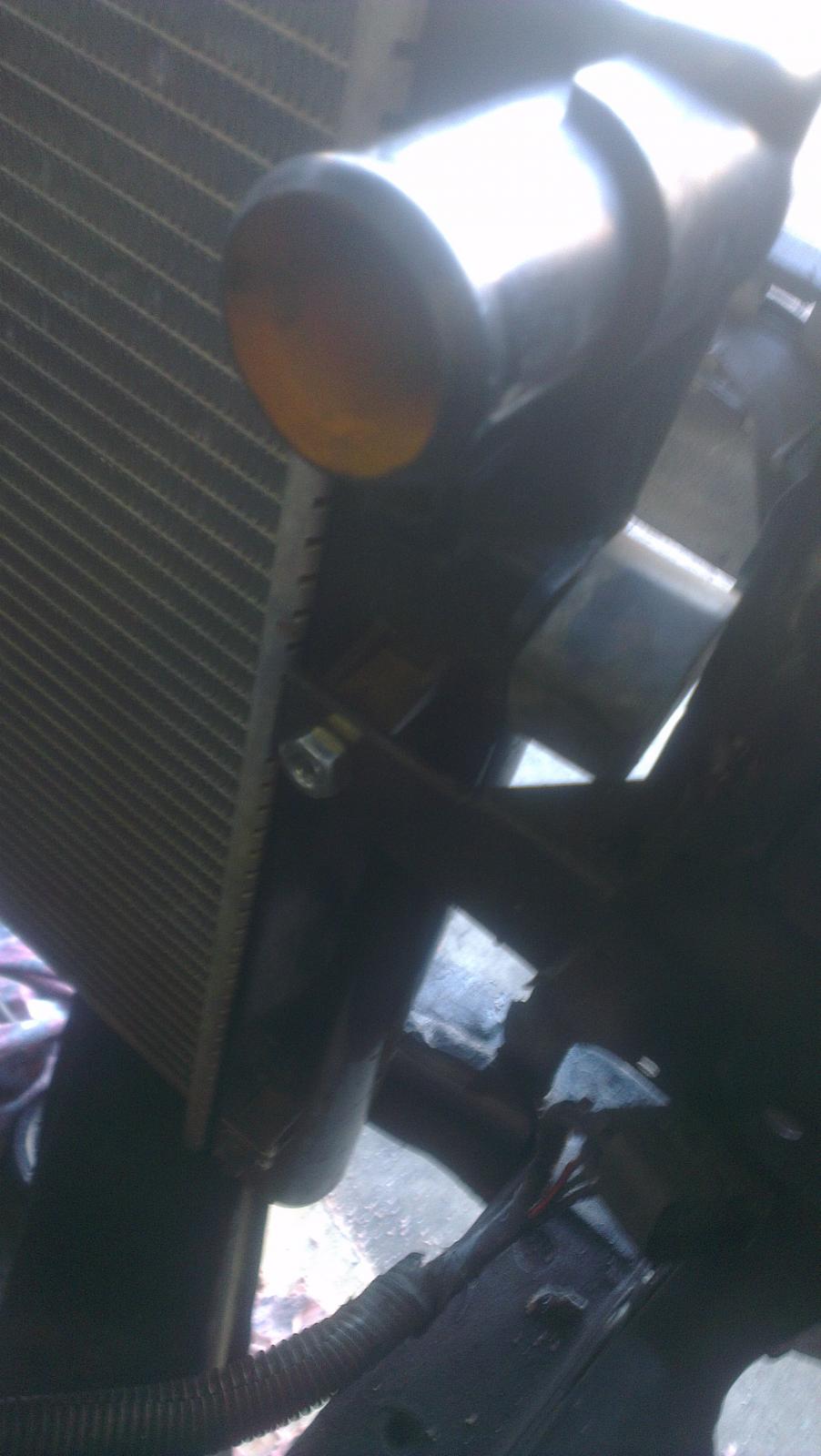

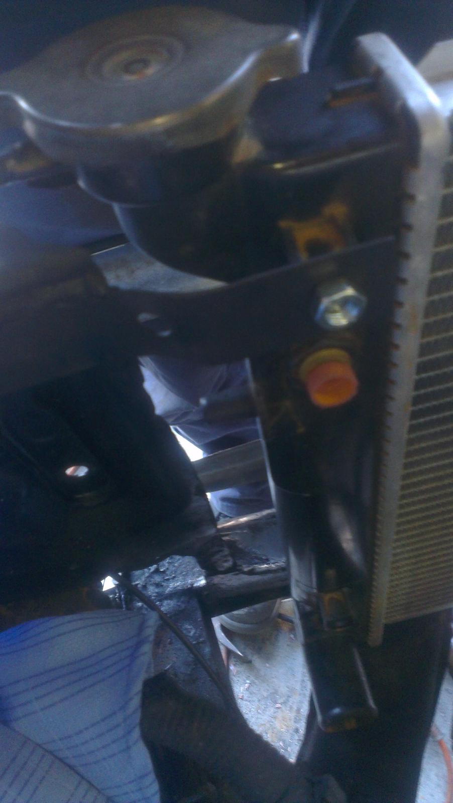

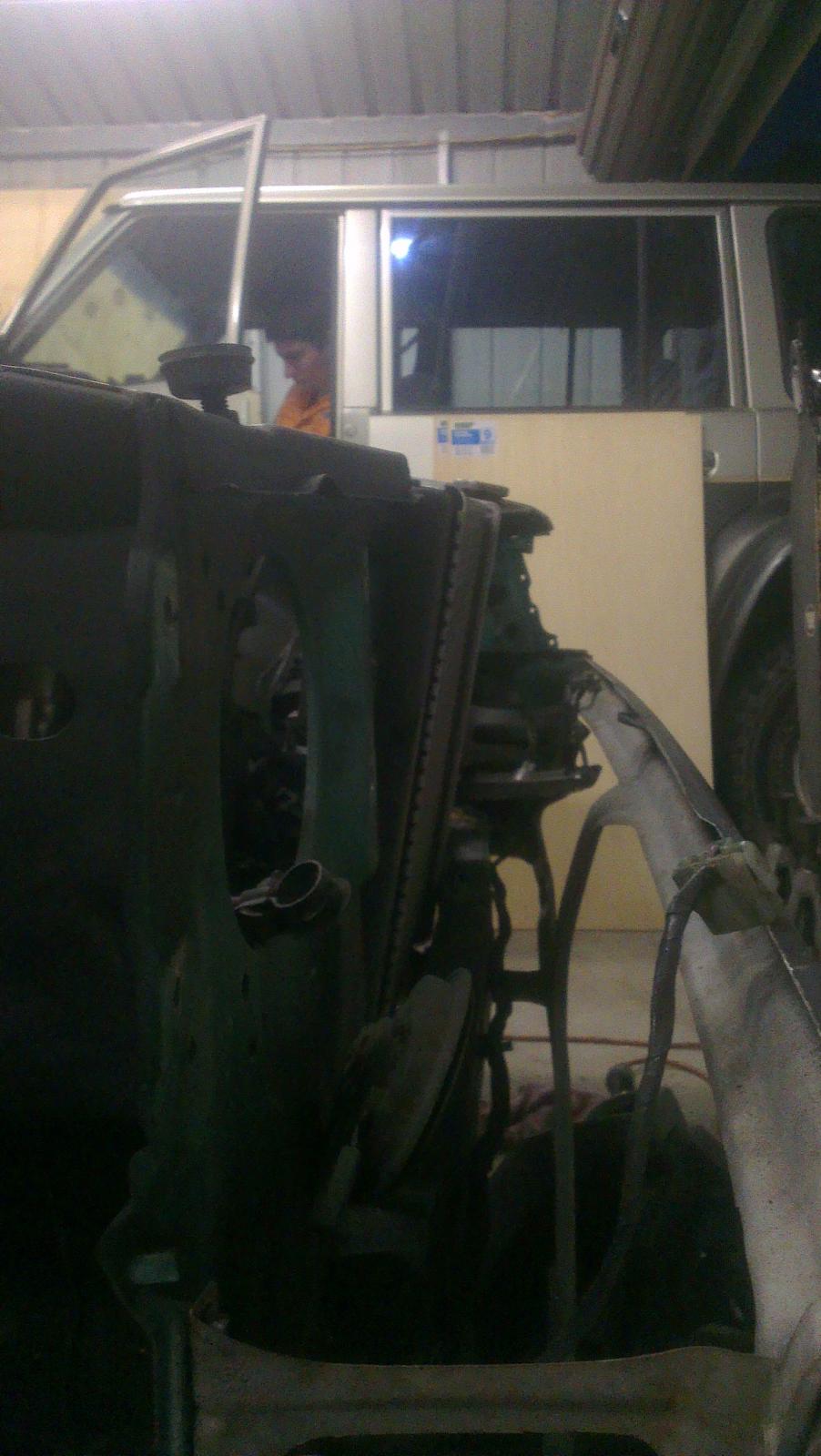

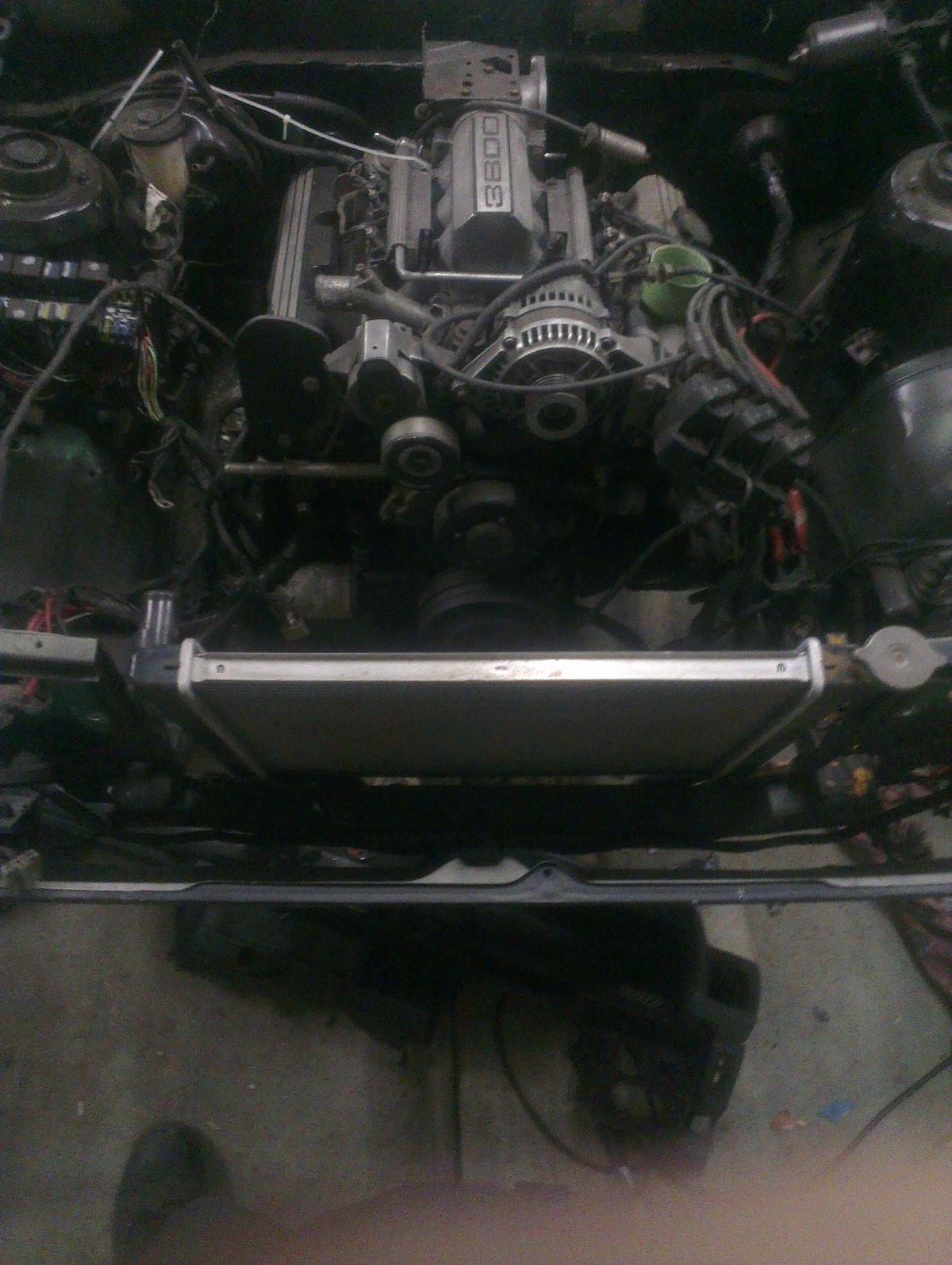

Had to cut some space for it so I can have it on a slight angle for the bottom hose to clear the subframe and give more roo. For a slim fan trying to figure out how toount it now

Cut some sheet metal drilled someholes to fit the original rubber base mounts for the rad welded them onto the subframeat an angle so the bottom hole has enough room. Made up two more mounts and welded them on. Two bolts and it come straight out. Also giving plenty of extra room for engine removal.
