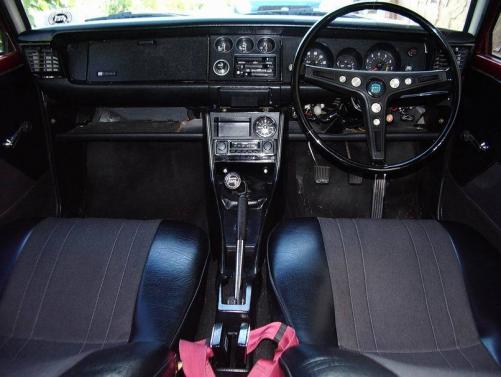

asirike20 Posted September 5, 2012 Author Report Share Posted September 5, 2012 Hi there, i asked for spark plug caps from MM organization but said " no "...... Black ones are ok, but where can i find them also?? The suspension bushes the spare parts shops are very low quality... they wear out out quickly... :oops: anyway here's some recent pics.... lights in action Full strength front lights..... :storm: here's the seat covers i bought from panchikawaththa rear seats woodgrain dash..... oh i love it... enjoy guys...... :rocknroll: Quote Link to comment Share on other sites More sharing options...

asirike20 Posted September 6, 2012 Author Report Share Posted September 6, 2012 It was boring today.... :doh: so did this...... Before After Re-painting And also painted these knobs... Since i'm crazy in music.... wired up the CD player.... pioneer speakers are on the parcel shelf.... Hmmm that's all for today... but the little bulb in the "Rear def" switch doesn't work.... :doh: Oh where can i find it ????? :doh: :doh: Quote Link to comment Share on other sites More sharing options...
