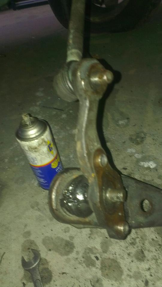

Put the the nuts back on and hit really hard with lump hammer lump hammer not them girly builders hammer.
On the side not the nut .
Edited by corollaart
Put the nut back on the thread(so you don't damage the thread) and give it a good bash with a sizable hammer/mallet!!
If that don't work, you can buy tie rod/ball joint separators from bursons, autobarn, super crap etc.
Corollart beat me to it.
Edited by kickn5k
Do you have a heat gun?
Put the nut back on a bit
Heat the steering arm/knuckle up heaps until wd40 etc smokes a bit then smack the nut with a hammer.
Works for both LCA and tie-rod end
EDIT: bloody hell beat me to it.
Edited by It's_AUDM_Yo
Put weight on it otherwise your wasting your time.I will often try to break the lock of the taper before I lift a car up to work on it now days. Leave a bit of the nut on. Or put a hammer on the other side of where your hitting. It's a pain in the ass dude
This would help if the thread wasn't minted from the lcs being removed y the last owner at some point
The nut came off but won't go back on. And I can fix the thread
