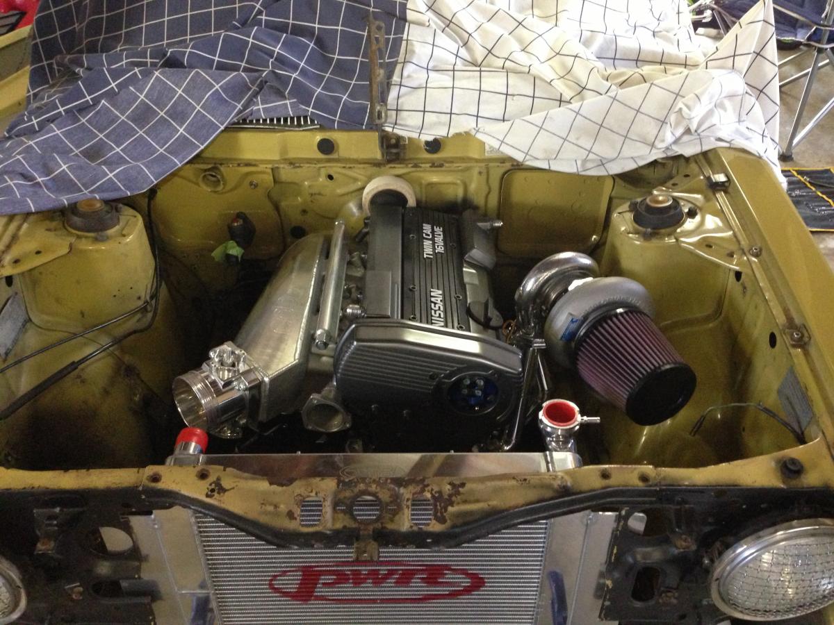

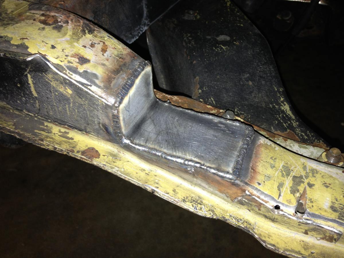

  • pic of the ke20 progress. engine, box, interia out. getting it ready to do the tunnel and some cleaning up.
  • Engine looks real nice mate. Bout to do the same conversion myself. Good luck with it
  • Thanks Scott. Yea the 1200 was a big job and I never finished it as didn't have time as 2 kids and working away from home seem to get in the way so bought this ke20 thinking it will be going quicker b
Hey mate, yes building a sleeper as such because can't afford to do the rest, so plan is just to get the basics done and go from there once running.

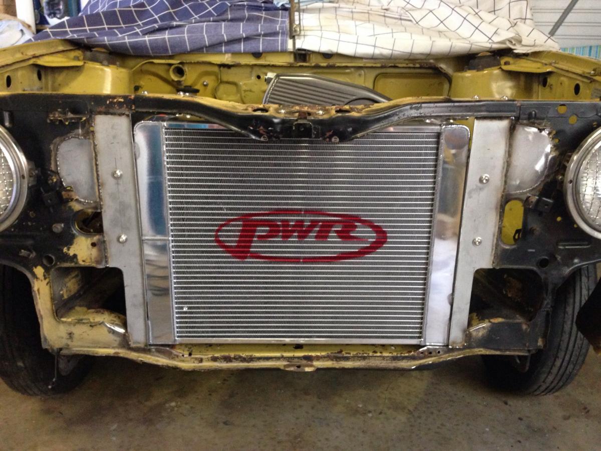

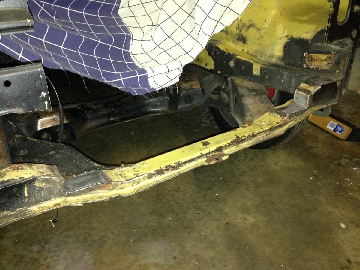

Bit of progress, had to chop into lower radiator support to fit radiator lower, dummy fit engine to see room for shit in the front. Seems to be all good.

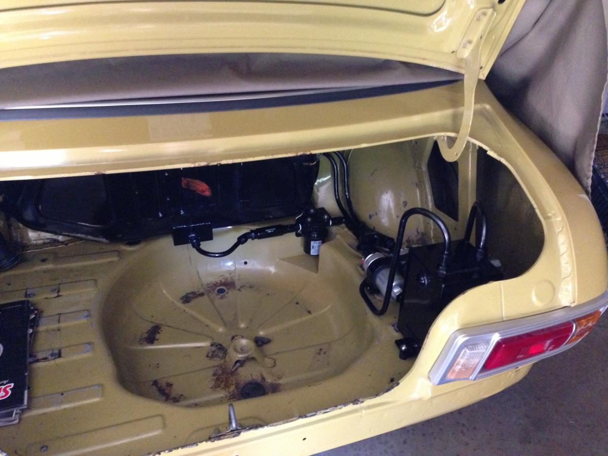

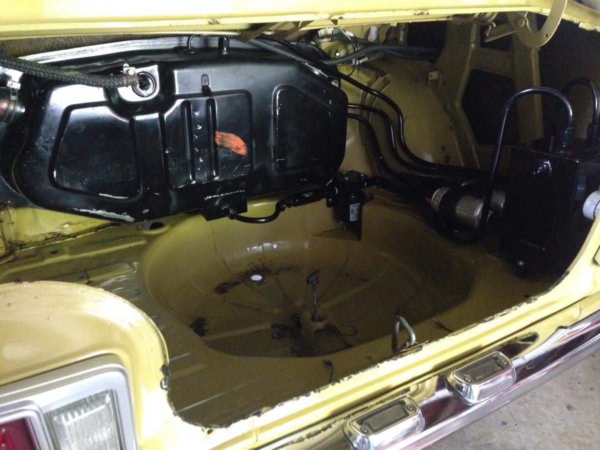

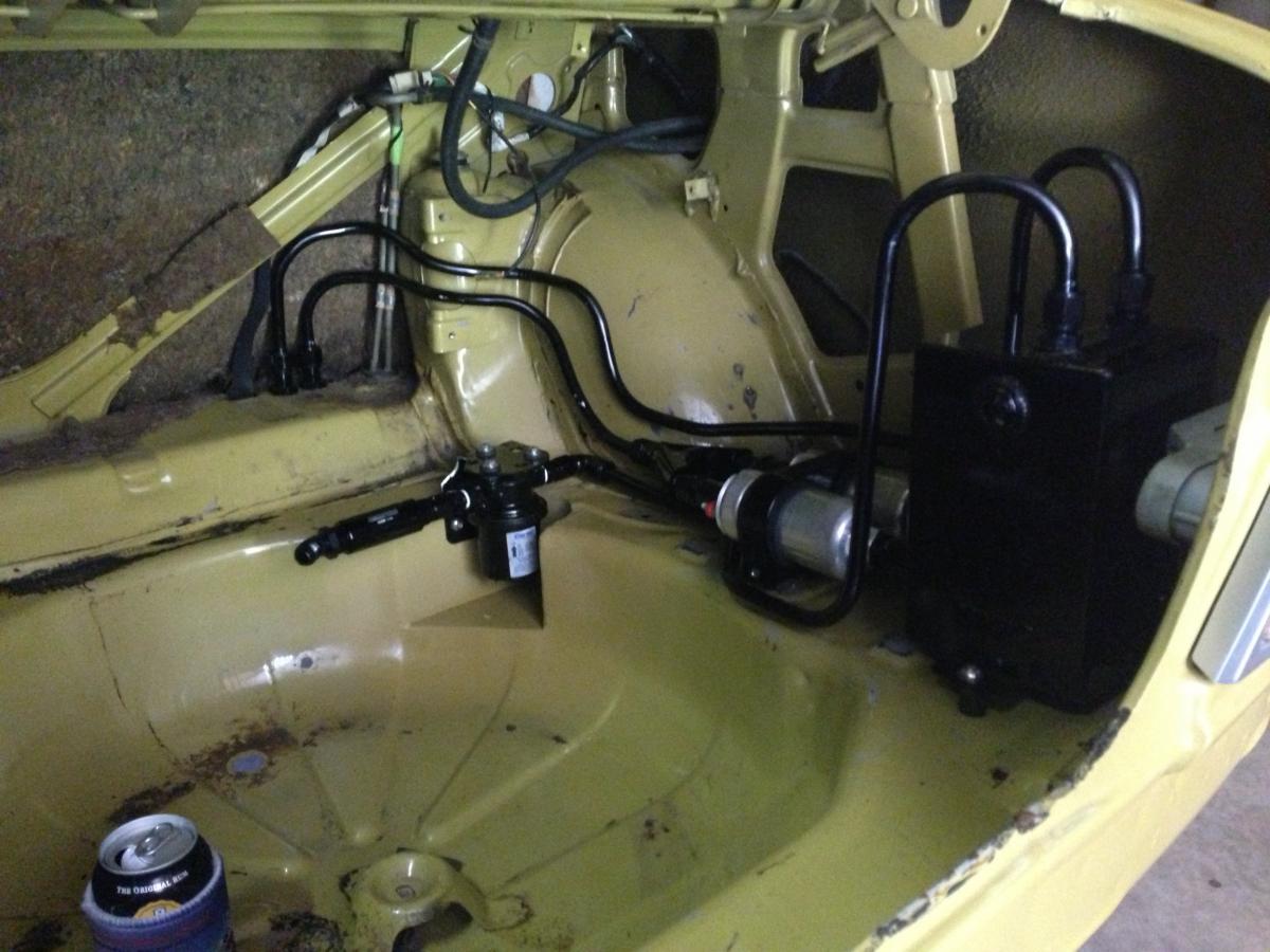

Bought some gear to make hard fuel lines, just cheap tools to do the job, 1st pick was first attemp but 2nd pick I redone the return line to surge tank as wasn't happy. Hard line looks neat but who ever says its easy to bend up a maze of hard line is kidding them selves.
The big fuel system is all -8 it's abit over kill but will be plentiful for e85 and chasing the 500-600 engine hp figure so bit keen to finish it.

Nice job on the fuel system, hard lines that size are a pain! Try doing them out of 5/8" food grade stainless! God that was fun(ye old sand bending techniques helped heaps that day) I'm going full teflon braid for my 11, it's dearer but will take me a couple of hours compared to a couple of days to do.

i do have alot of teflon braid with nylon but going to use it only from firewall where hard line ends to engine then back to reg, only where the movement will be in engine. i did want to go braid but then had to clamp it down as i like the clean out of the way look.

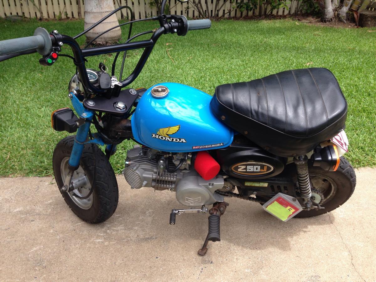

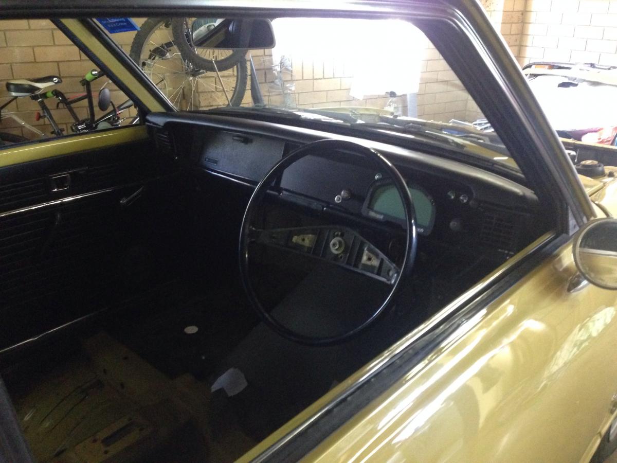

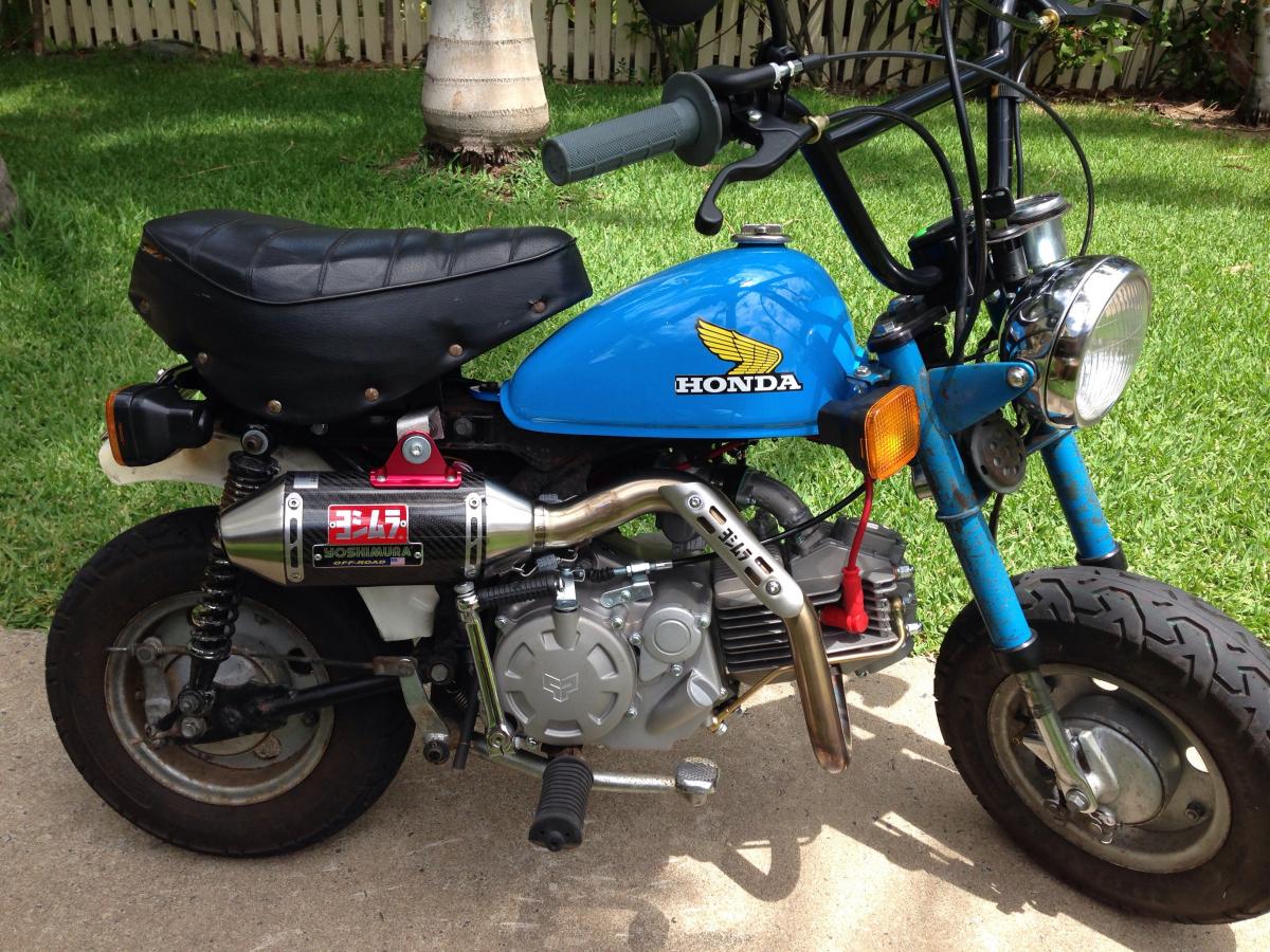

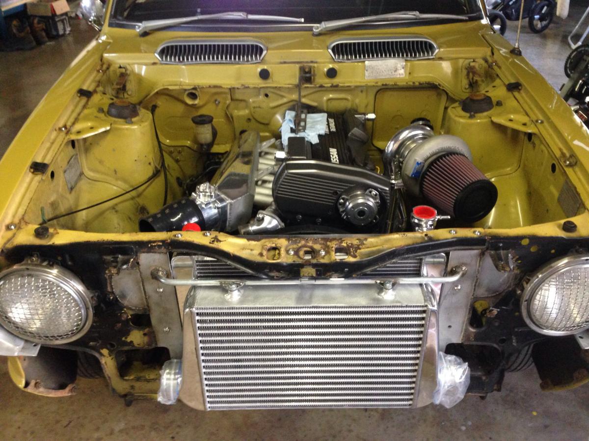

Been busy and away for awhile and built a bombed up original Honda z50j and been having too much fun cruising the streets with a mate with one. But couple of small things done. Vinyl wrapped dash Matt black which came up alright. Cut front radiator support out and redone it and mounted a eBay special intercooler. Made some custom engine mounts using some patrol bushes and machined sleeves, bit overkill but should never break.
I know it's not a rolla but some of yous might enjoy the z50
Boot finished finally, all lines done and bolted back in.
