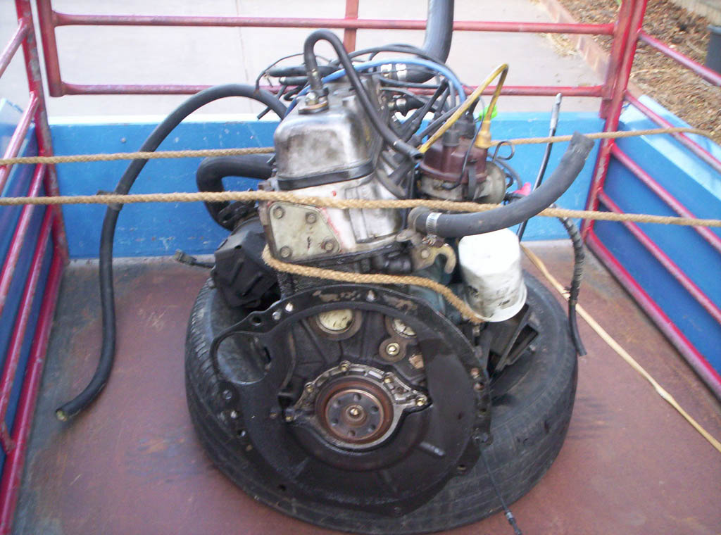

Raven Posted December 2, 2006 Author Report Posted December 2, 2006 Just picked up my new motor today from Turbo_Rolla. Comes complete with air-con compressor bracket (supercharger eh? :)), GT40 coil, dizzy, leads and thats about it :) I didnt require the manifolds as I'll be getting rid of the emissions stuff from this motor. :( Quote

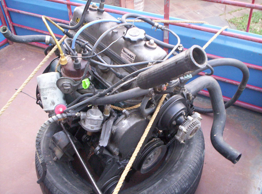

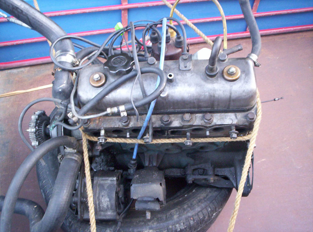

Raven Posted December 2, 2006 Author Report Posted December 2, 2006 Some pics of my sexy new motor: Quote
TheNOBBLER[RL] Posted December 2, 2006 Report Posted December 2, 2006 Lookin good! Got any pics with the new rims? The pv will look sweet as full lock through a corner! Quote

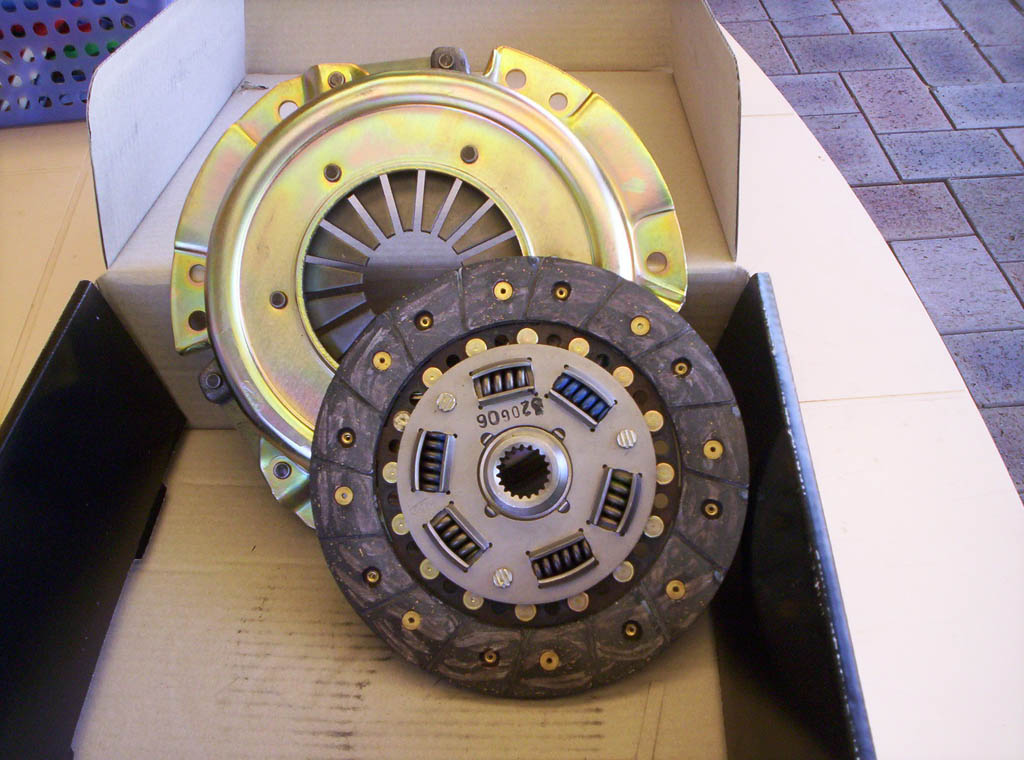

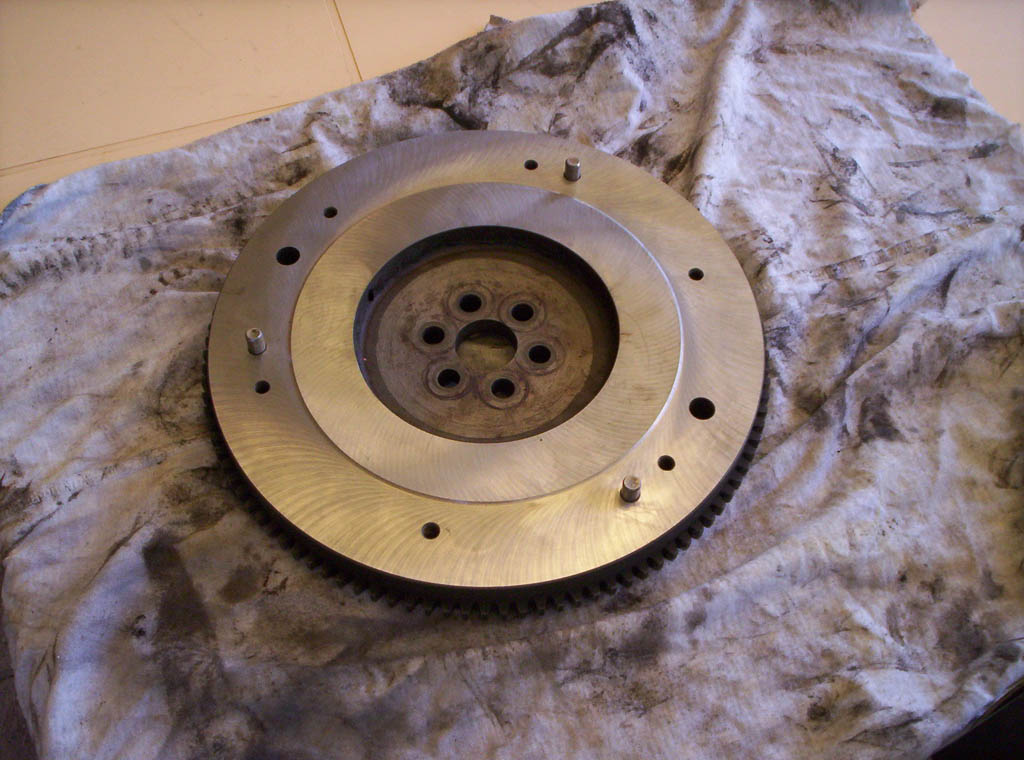

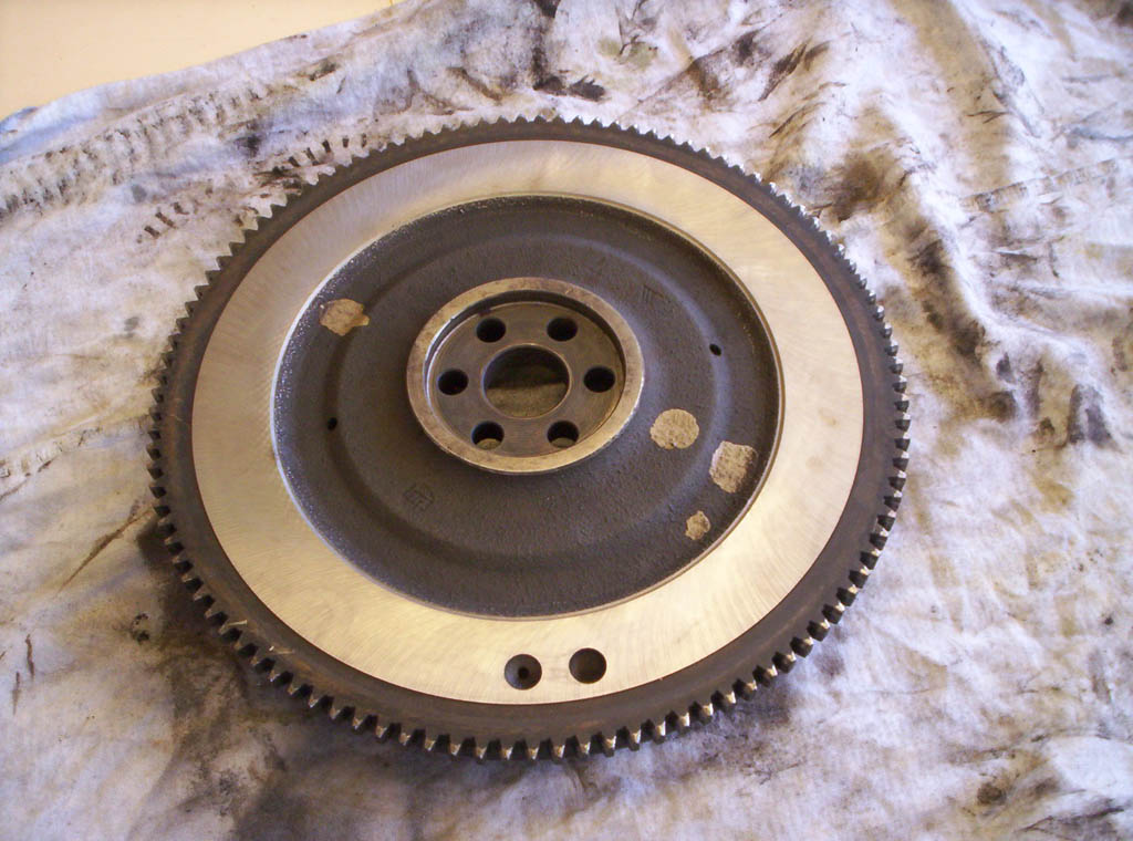

Raven Posted December 20, 2006 Author Report Posted December 20, 2006 I got paid today. So i went on a spending spree. I should have it driving by Saturday arvo I hope. Pictures tell a thousand words: Had my flywheel lightened a little (1st Pic) and then had it machined for the clutch side (2nd Pic) RPM Heavy Duty Clutch Quote
