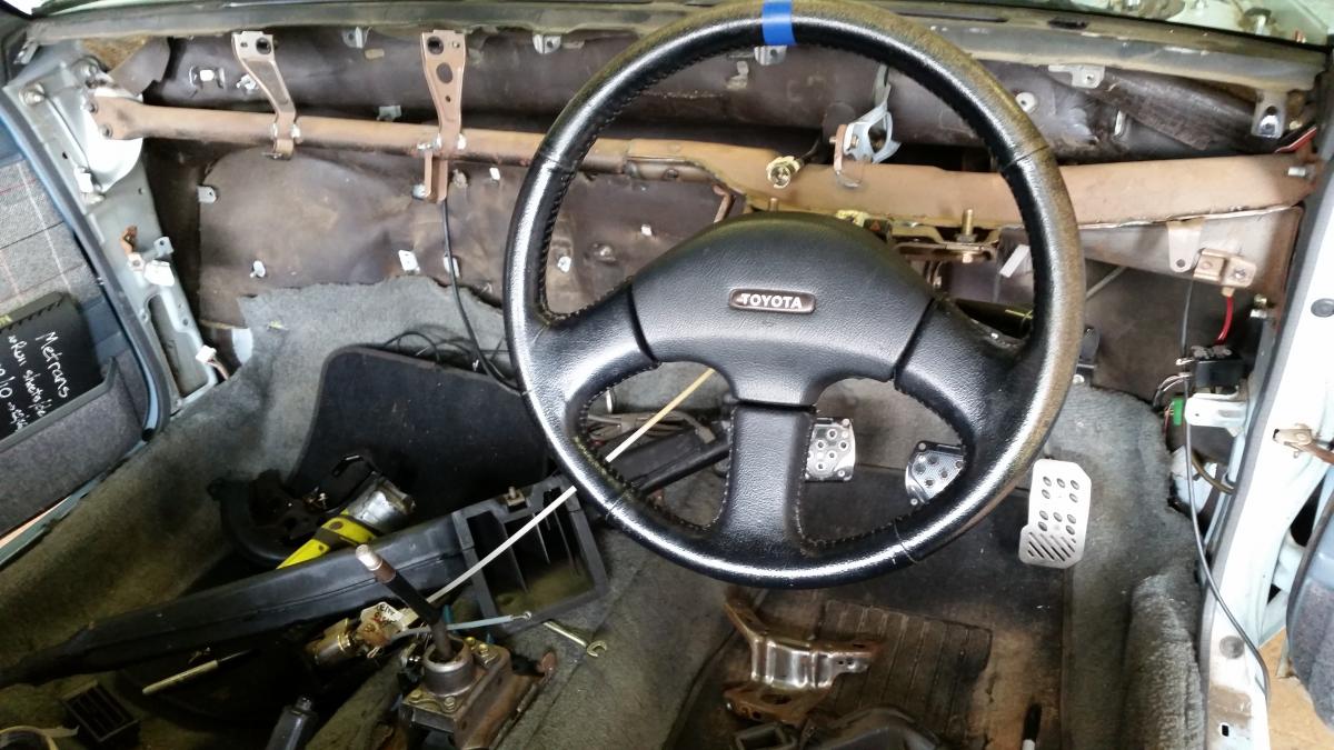

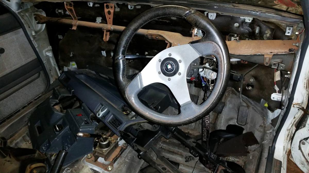

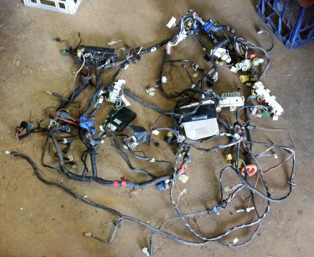

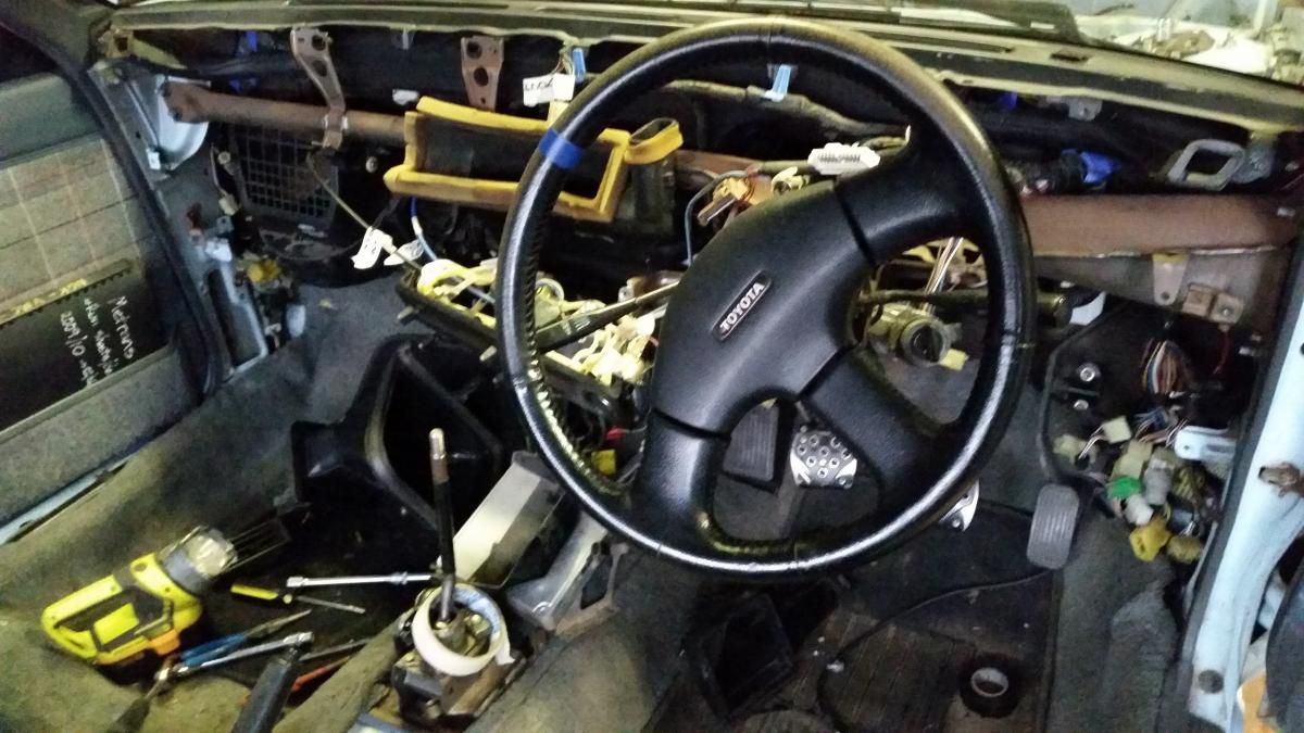

All the wiring required to run an EFI engine. While I was there, also removed the fuel flap/hatch release cables/levers for installation into BT.

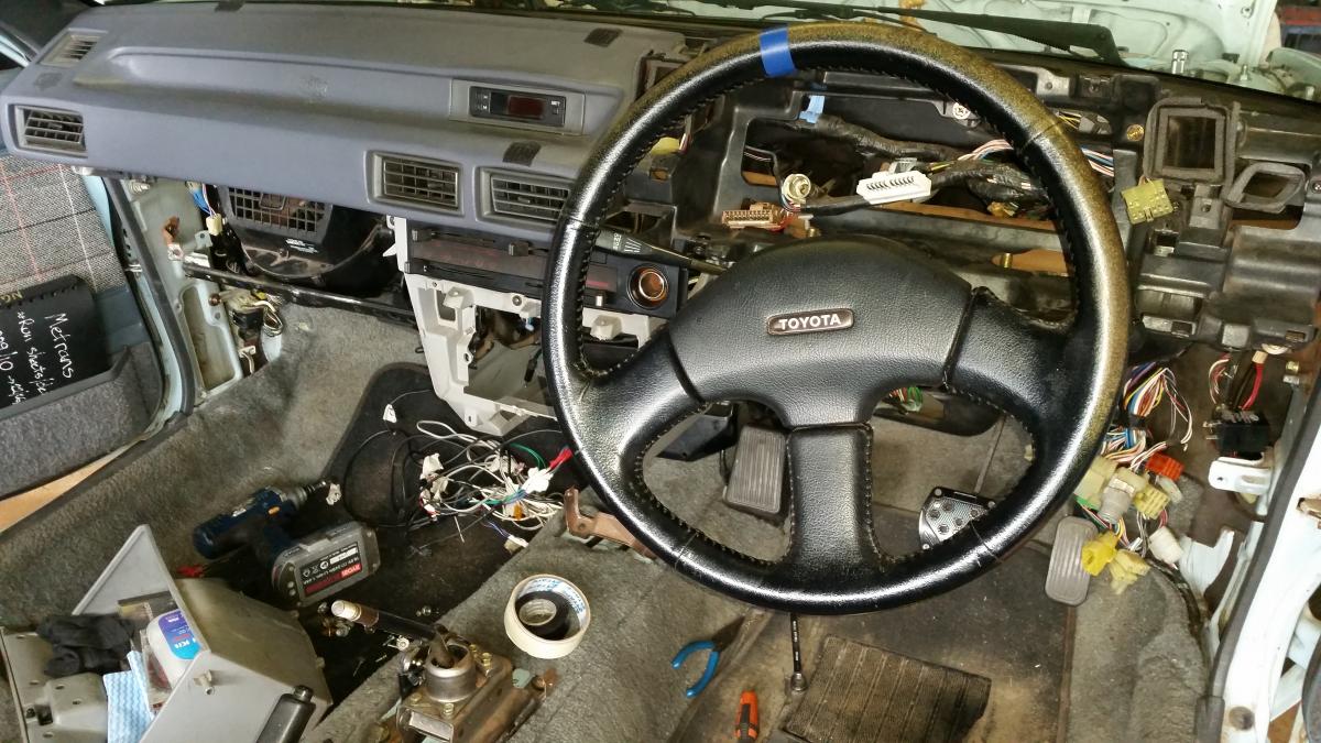

I don't have to put this dash back together, Blue Things on the other hand...

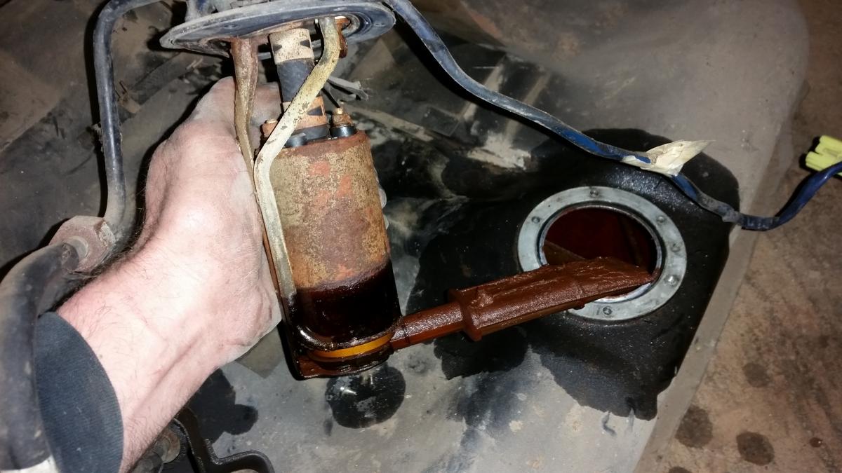

There's a heap of rust in the EFI tank that's going to have to be cleaned out before I can use it. Urgh, there's always something.
Had the fuel tank dropped off for treatment on Tuesday, called up on Friday to see if it was done...hadn't been touched.
"Mate, this tank has a bit of rust in it!"
"No $h1t, that's why I brought it to you."
Took the tank to another business, should be able to pick it up on Wednesday. Sure, I could scour wreckers looking for a better condition tank, but chances are they're in similar (if not worse) condition.

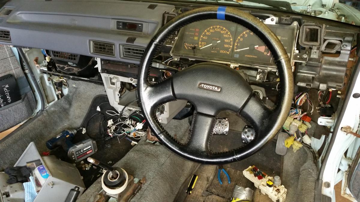

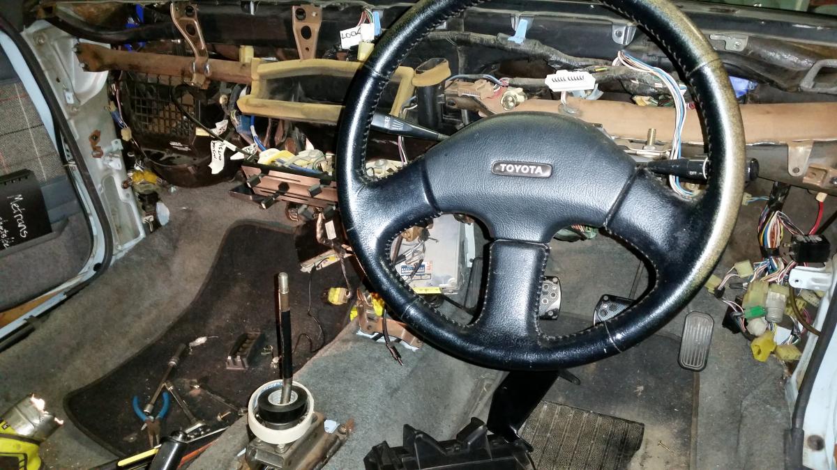

Plugging away day by day at the wiring loom swap. It's tough getting much done during the week, so most progress happens on the weekend.
Not really keen on doing it myself, done my fair share of rust treatment before. Have heard good thingd about the POR15 kits though, if I had the time again I'd try that. It's due for pickup in Wednesday evening, it will be going straight into the car, connected & filled to the brim with BP's finest.

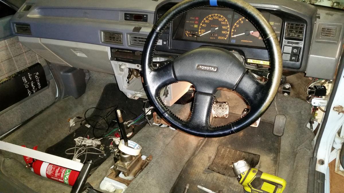

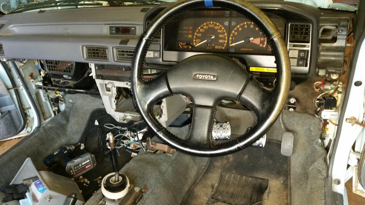

Dash in.
Instrument cluster in.
Cluster cover in.
Still need to do some minor electrical work (cd player & O2 wideband wiring) but for the most part, the wiring transplant is done. Which includes the body-loom.

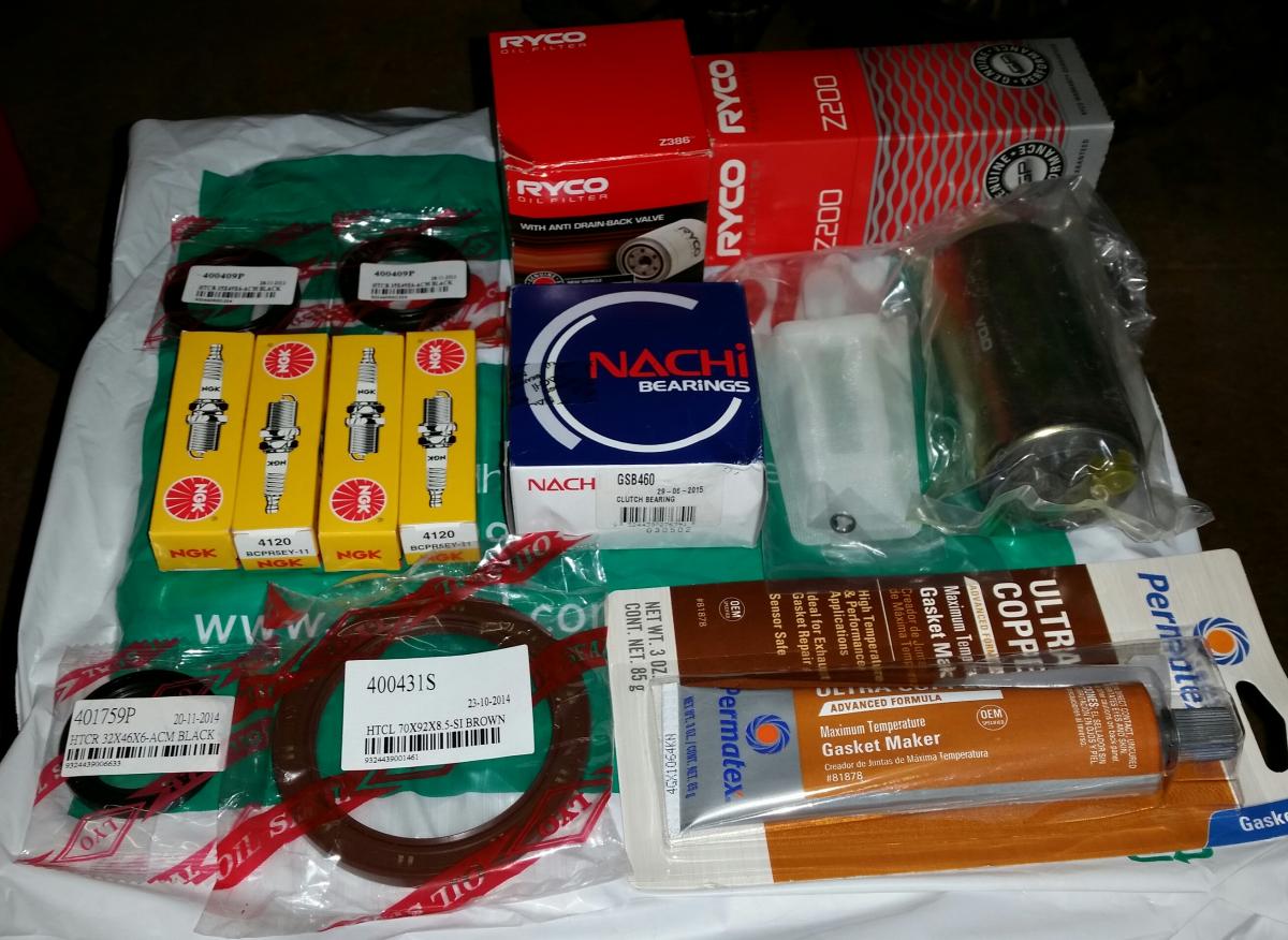

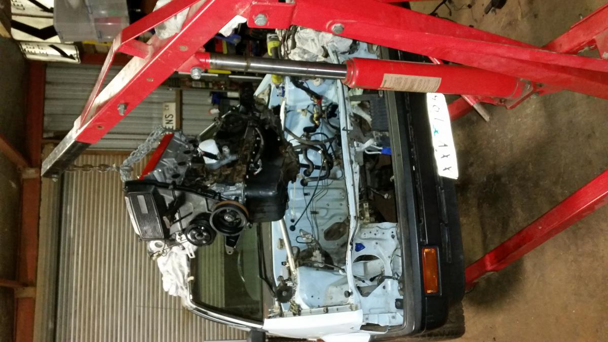

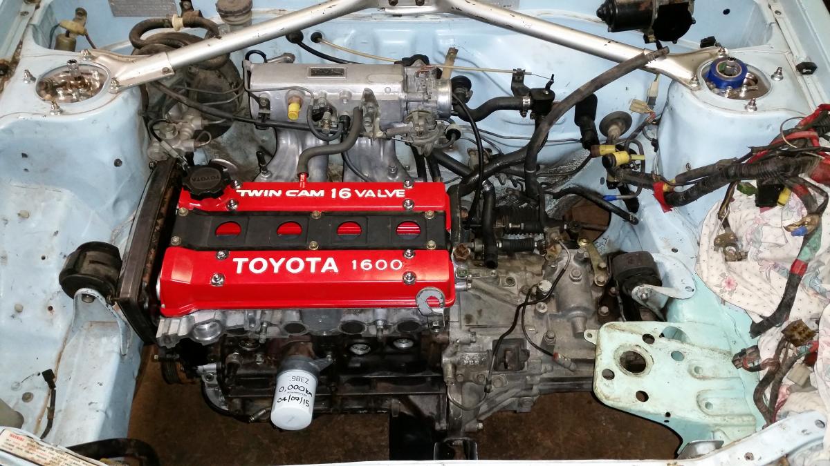

The engine's on the stand for a good scrub/clean up, thinking of changing things like camshaft seals etc (while I'm here.....) before it gets bolted to the C56 & thrown into the engine bay. Tempted to bolt the Exedy HD clutch that was attached to it back on as well.
Finally got the fuel tank back, after 9 days. Get it home, turned it upside-down to have a look & a heap of dust/dirt fell out. Required a damn good flush out in order to be usable. So if anyone feels compelled to use the services of Reg's Radiators in Hoppers Crossing, my advice is DON'T.

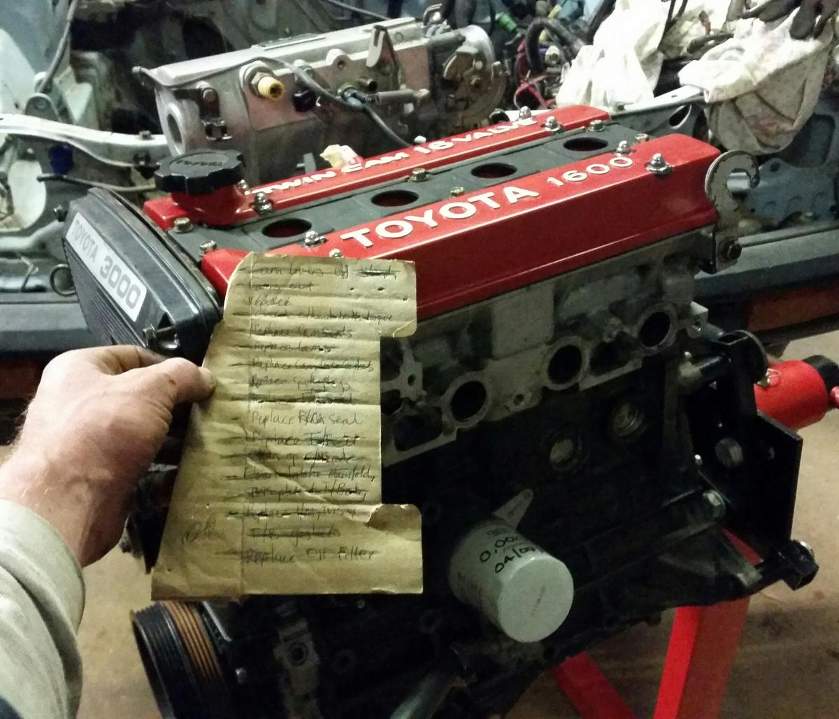

Heaps of "while I'm here" stuff done, all gaskets/seals.
Had a minor delay with the fuel system, got the tank in only to discover that the fuel return lines are also different sizes. Back out, swap lines, back in.
Made up for it yesterday, it was a good, productive day.
haha! There's nothing better than a long list with lots crossed out!
Thing is though, there's always more lists!

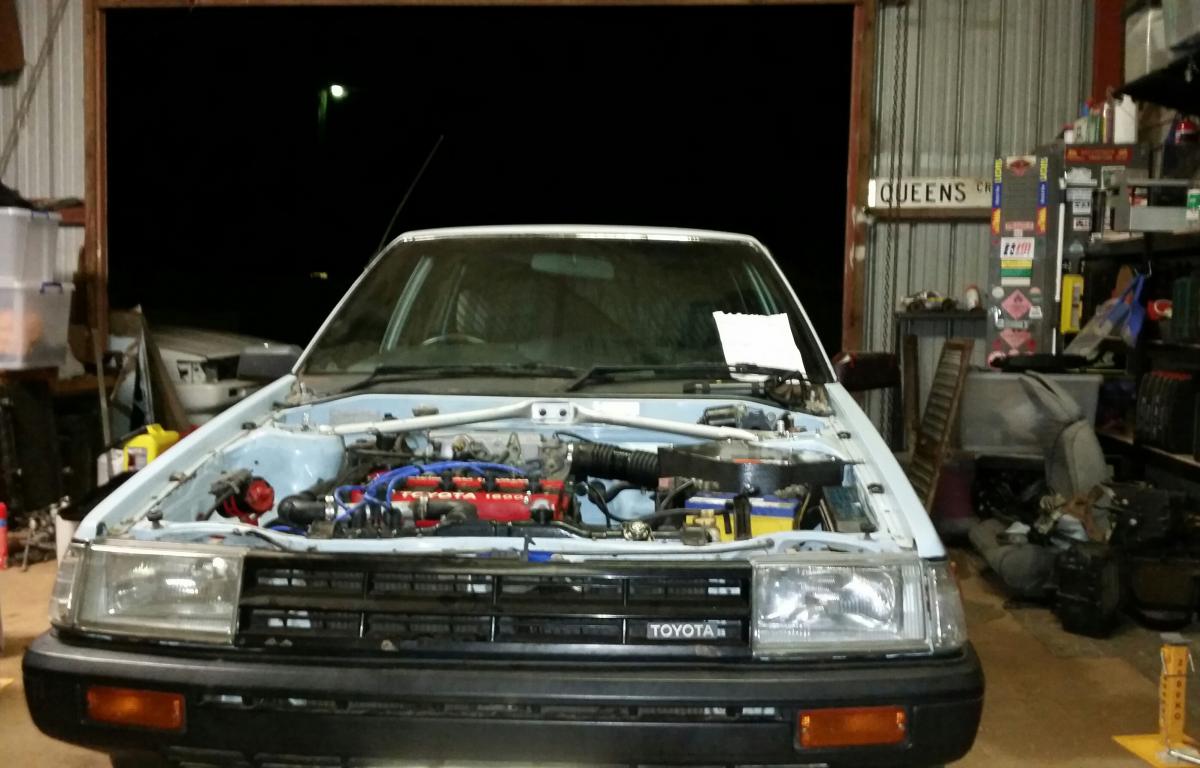

Pulled an all-nighter, was a bit stubborn to start due to dizzy being out a tooth & the fuel lines/rail being bone dry. But, at 5:30am this morning...SUCCESS!
Drove to work, no leaks so far, timing's good, idle's good, I'm a happy camper.
Cheers guys, was f-ing exhausted but drove to work & back with the biggest smile on my face that even Melbourne traffic couldn't get rid of.
