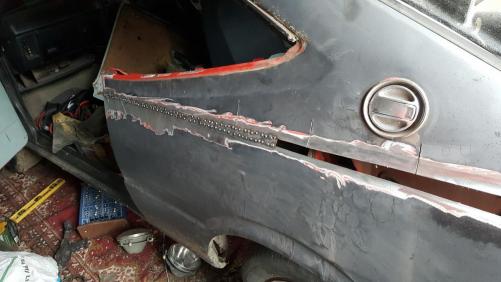

October 21, 201511 yr Author comment_700864 Ordered somesome new lenses for the rear lights. Just as well I'm widening the car. Dodge Charger 73,74. Also welded up 60cm of the other side. Edited October 21, 201511 yr by MIKE KE55 Report

October 29, 201511 yr Author comment_701038 Ran out of mig gas but I'll sort it out tomorrow. Getting there..... Report
