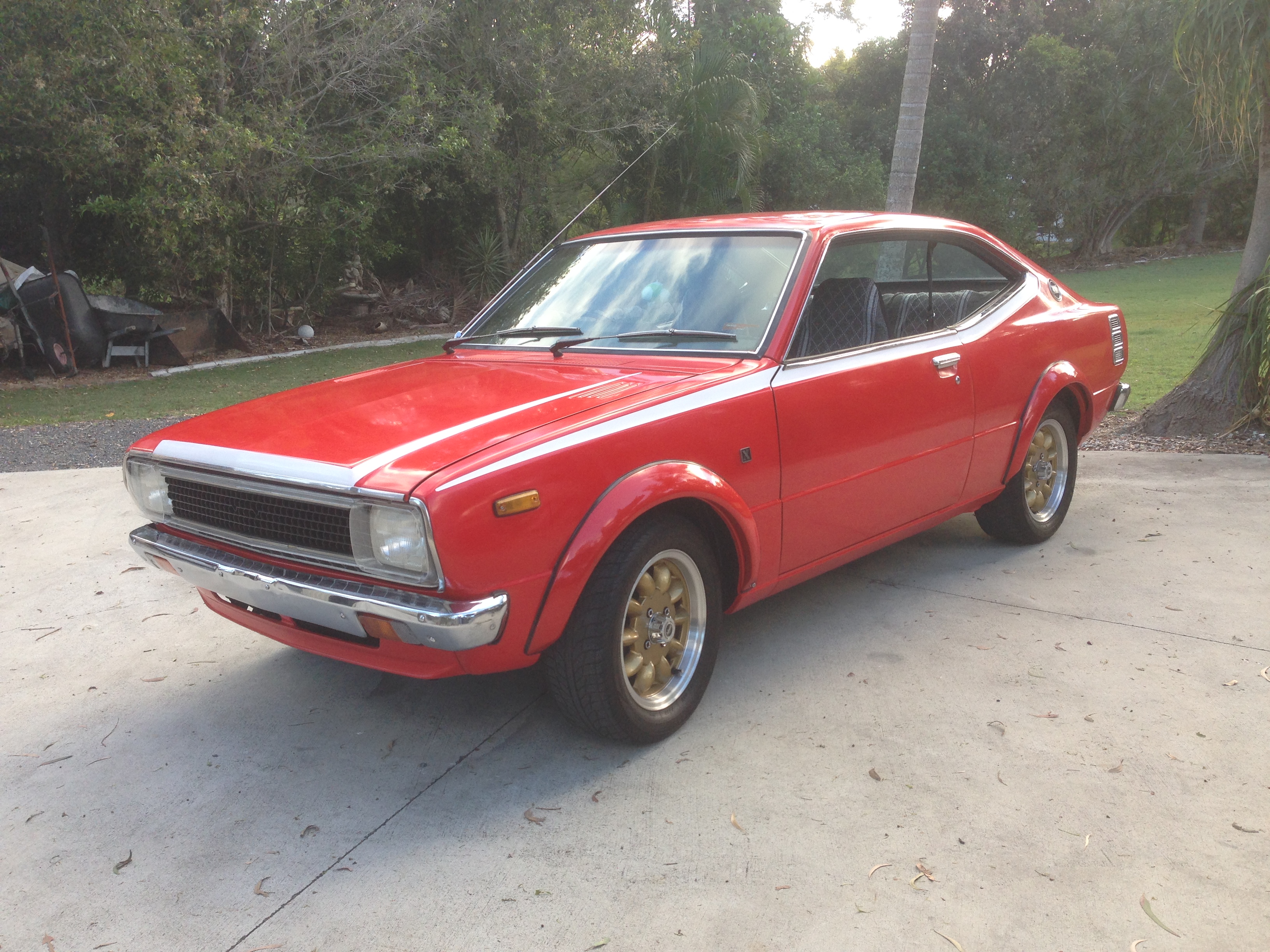

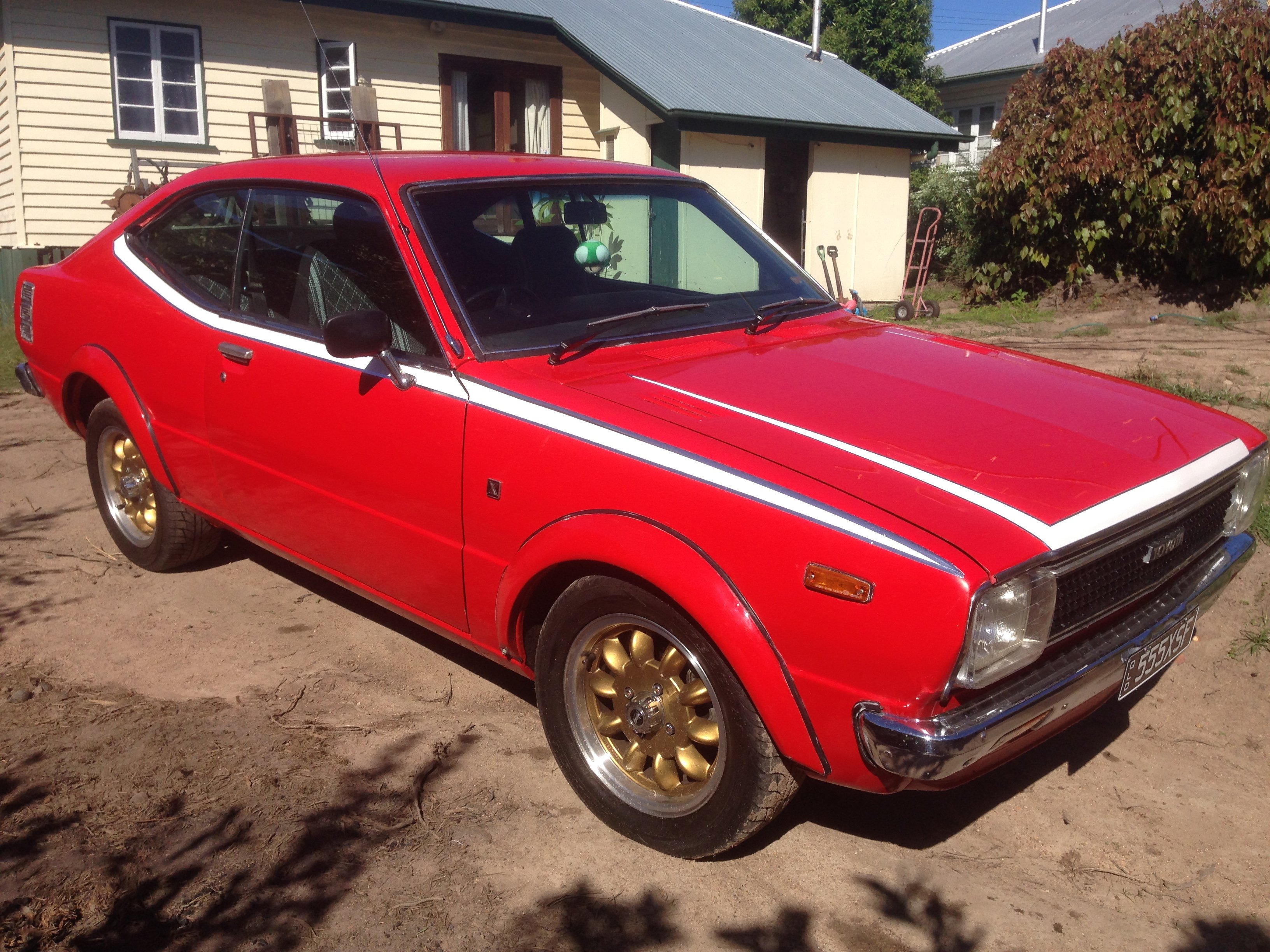

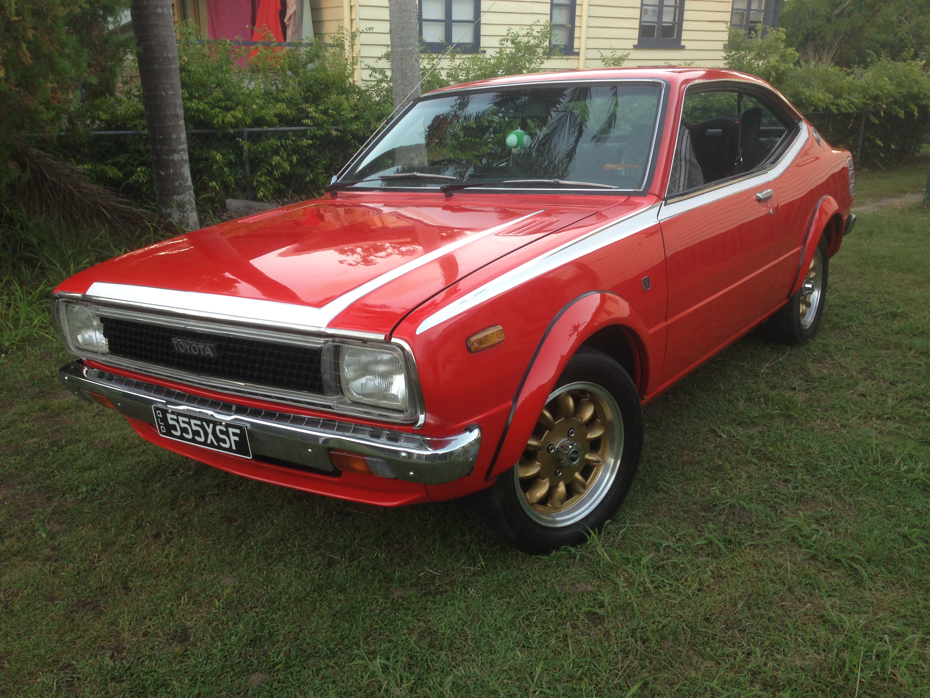

One thing that was causing me some consternation was my inability to get a decent buff on the duco, despite numerous attempts.
At my first Cars and Coffee outing it was clear that mine was the only car with swirl marks. And at night, it looked like nothing special at all.
As with anything, you will all know it comes down to the right tools/product/procedure for the job - which isn't always obvious to the layman (i.e. me).
In the end I got there though!
I washed it with 1200 wet and dry, then I washed it again with 2500. That took care of the orange peel.
SCA branded polishes just didn't work. At all. Turns out the product I needed is called "One step ready" which I picked up from DIY Colourfast at Lawnton. It apparently starts as an abrasive and rubs down to a cream in <one step>.
I applied the One step ready with a foam pad from the same store, on an electric buffer and the swirls disappeared before my eyes. Only one burn through to touch up! Bah..
Swapping pads, I then hit it with Bowden's carnauba wax to seal in the glossy goodness, and buffed it off with a microfibre cloth.
I'm very happy with the results now. Previously I was like, "It's ok for a 40 year old car" while secretly being envious of 2 pac painted cars. Now I know that acrylic can be just as good - it just takes some rubbing - with the right gear!
I also applied some pinstripes.They're chrome, so it's a bit hard to make out in photos. But they've straightened my painted lines and add a nice *bling* highlight when they catch the light.

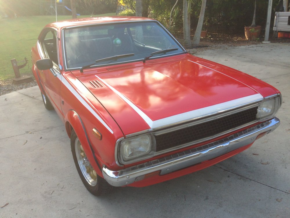

Appears to be a big difference in paint when comparing pics at the top of the page to the latest. Awesome job. Ive been following this build for a while now, its always good to see a rolla built right threw to registered. Gives me motivation to pull my finger out and get cracking.

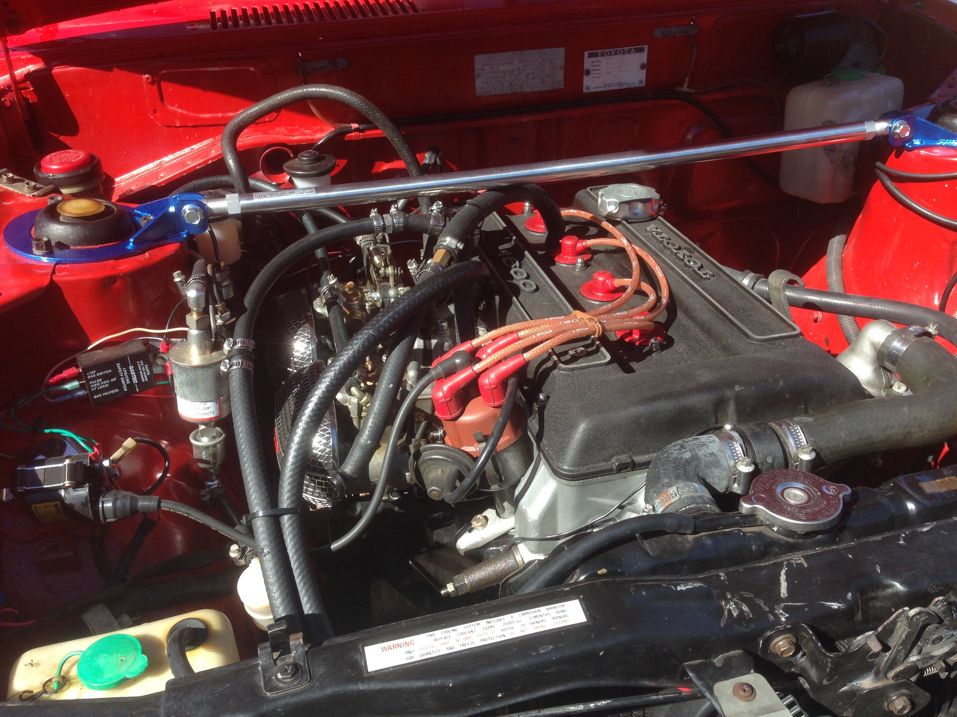

It actually spat the (water heated) intake manifold gasket along there last month. Wasn't happy.
I prefer dry gaskets but I had been persuaded by an aircraft mechanic pal to use goop on the first gasket. No good. So the new gasket went on dry and I'll nip up the nuts in a few weeks
While I had the carbies off I realised the pump rod was jammed on one of them, making it impossible to tune. All sorted now and it's going heaps better. Still not 100% on a 1500rpm clutch dump but certainly driveable. I might swap around some pump bleed jets to narrow it down.
I think the old 15" tyres are a bit hard and maybe even flat spotted from sitting as I've got a bit of a vibration over 100. So I haven't taken it very far. Still ironing out the niggles to be confident taking it on a road trip but it's done around 1100km now.
Fitted a Cusco strut tower brace which probably doesn't do much, but I always wanted one. $200 delivered from Japan in 3 business days which was fairly reasonable I thought!
