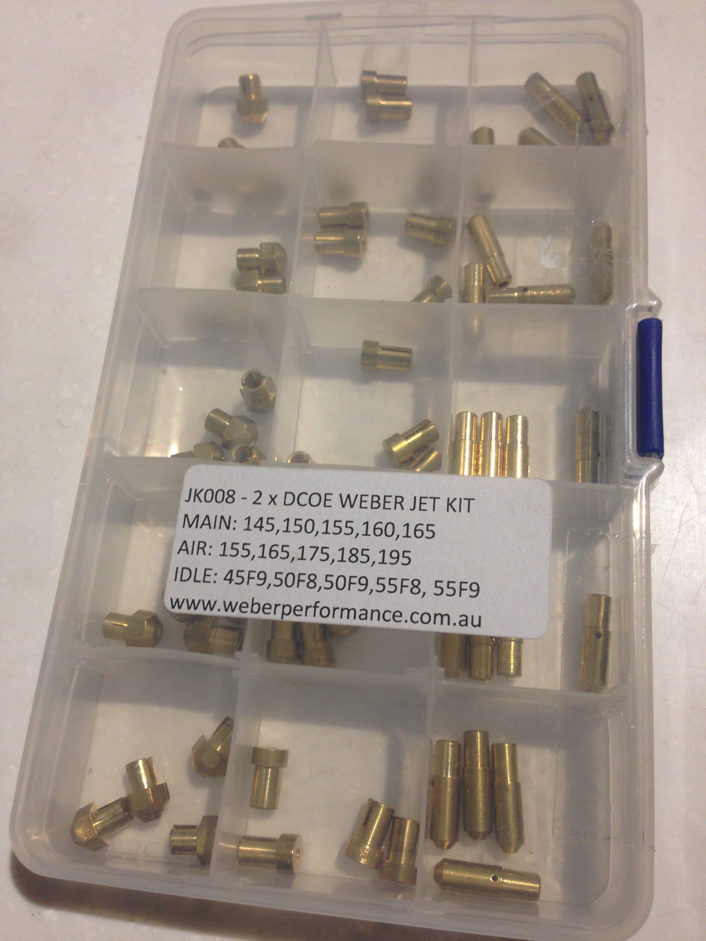

Tuning kit. No more jets, I'm done.
Deal with these guys and your gear arrives in less than 24 hours.
I've gotten through the progression with the idle jet, using  34mm chokes and F16 emulsion tubes. With the few jet sizes to hand I was able to load up the clutch on the corner of the shed slab and torque it up enough to do a skid, but the main system still bogs and spits
With these and what I have, fresh plugs and another 10 litres of 98 - I seem to be going through a lot of those - I'll be able to have a really decent crack at finding the goldilocks zone. Just maybe not this weekend ahhh
