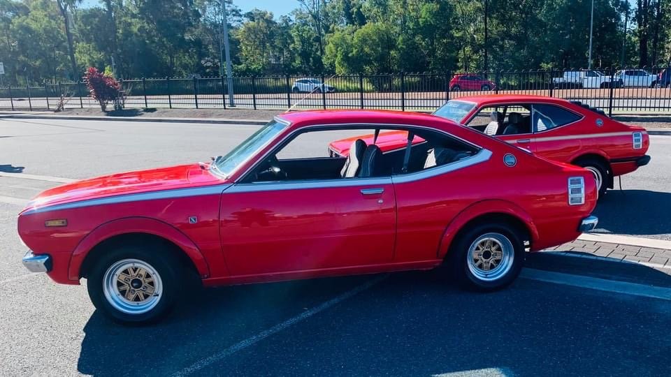

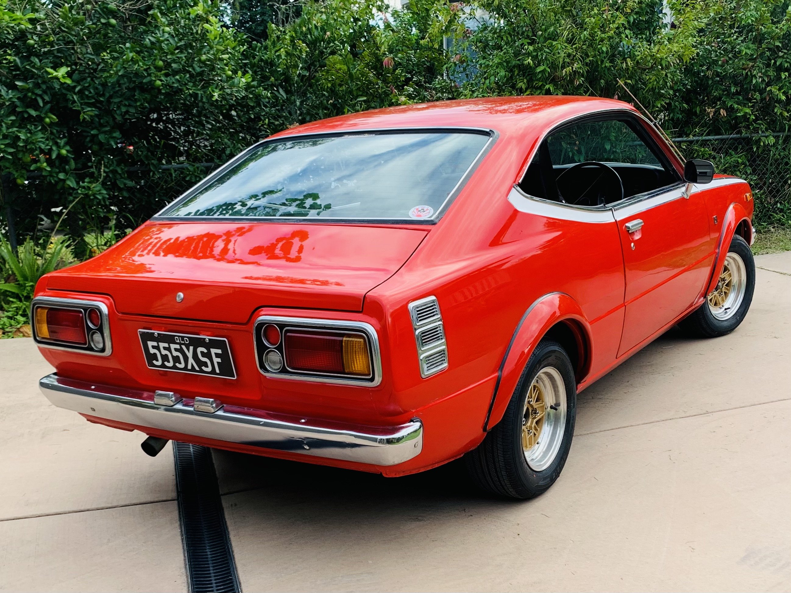

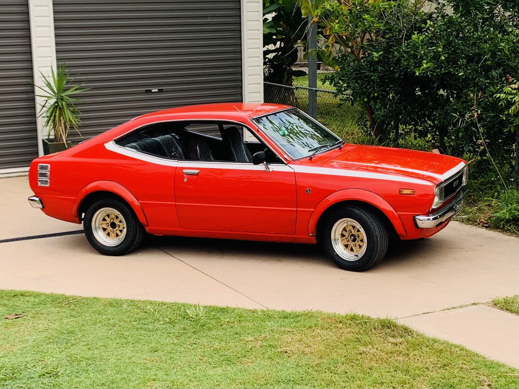

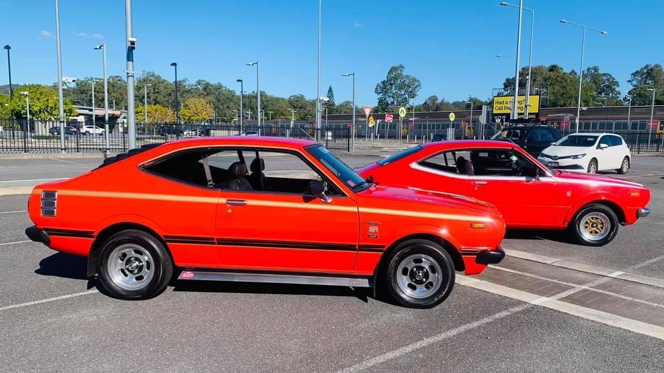

The wheels were a bargain buy. I got them from a fellow forum member for $150, back when the forums were still abuzz. They came up good with a polish and paint.
I certainly keep in dry in the shed to keep those rear window quarters clean. Ironically you'd probably have a crack at repairing that rust now, if you still had it.

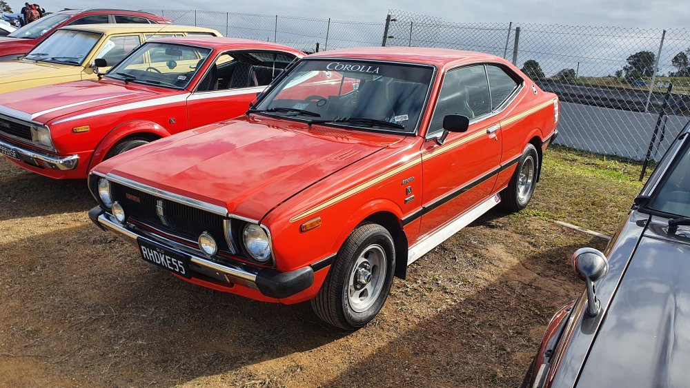

The poor old KE55 is underrated I reckon!
Yes R.I.P. !   (Rust In Peace)  dear olde KE55 Coupe.
Not as shiny as yours !  When I stripped it for parts, I then cut the body up, &  the rear end floor & wheel arches, went to someone up on the Sunny Coast, who was wanted to "Tubb" his rear end for enormously wide rear tyres.  It was when I cut through those quarter rear panels, I realised how much the pillarless design, relied on that area for strength & rigidity.
Toyota, in their wisdom, added maybe 3-4 extra layers of steel sheet between inner & outer areas, for increased strength, for the pillarless design.  Trouble was, they were raw mild steel, with no paint or prep. on them at all; & when moisture got in, around that large rear glass rubber, it got into that raw steel, & the result was a disaster.
I never even took a photo of the rust, it was so appalling, but totally hidden & lurking.  The other thing a lot of people don't realise about modern car body resign; is how much the rigidity of the body, relies on those two big sheets of glass in the windscreen & rear window.  I once saw a car, (a Toyota Crown) literally break in half, because the owner, drove around on dirt roads, for a month, whilst awaiting a new rear glass, to arrive from overseas.
Cheers Banjo

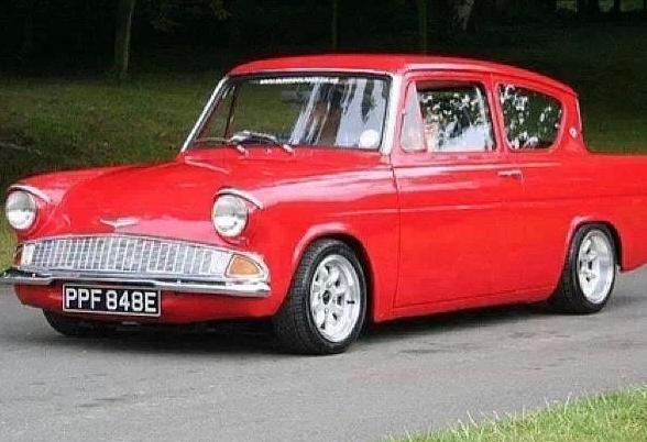

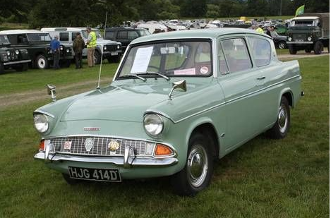

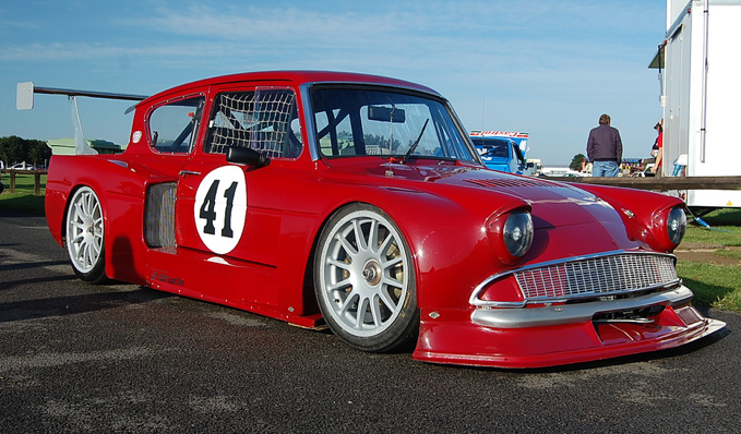

Take this late 1950s early 1960s Ford Anglia 105E Piddly little 510 x 13 inch wheels.  I've seen wheels bigger than that, on a wheel barrow.
I know, because I used to own one once.  I put 640 x 14 Holden wheels on it, & the 640 x 14 Holden tyres were cheaper than I could buy the 510 x 13 tyres.
Lower it a bit, & then the car became a different animal. Green one looks scared  . . . . . .  The Red one looks like it could take on anything.
Mind you, if that's not to your liking, you could make the wheels & tyres just a little bit bigger.
Cheers Banjo

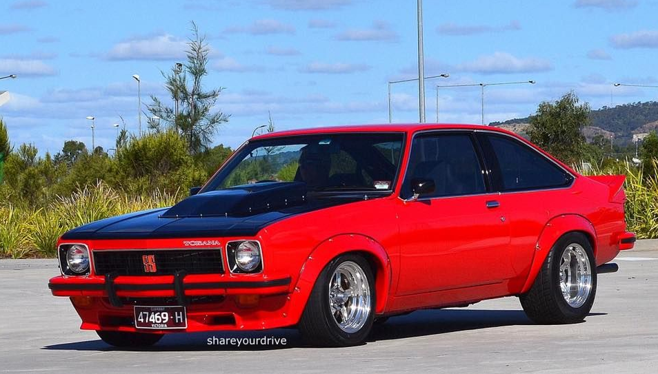

I’m 14 x6 on the AE86 and 13 x 6 on the TE27 (when it can roll). 13 x 5.5 on the KE15 for now which is overkill unless I can find some nice period 13 x 5 for it.
Considering the Falcon GT had 6 inch wheels from memory.
It’s just too much unsprung weight.  And of course modern tyres are incomparable to what was available back then. I appreciate tyre choices are somewhat limited, but not impossible.
Those wheels on MS car look phenomenal!
  • Upvote 1

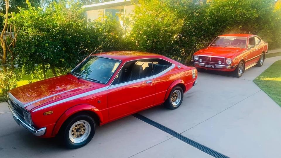

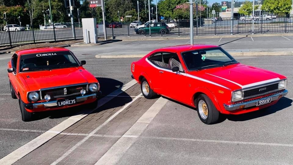

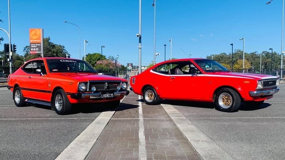

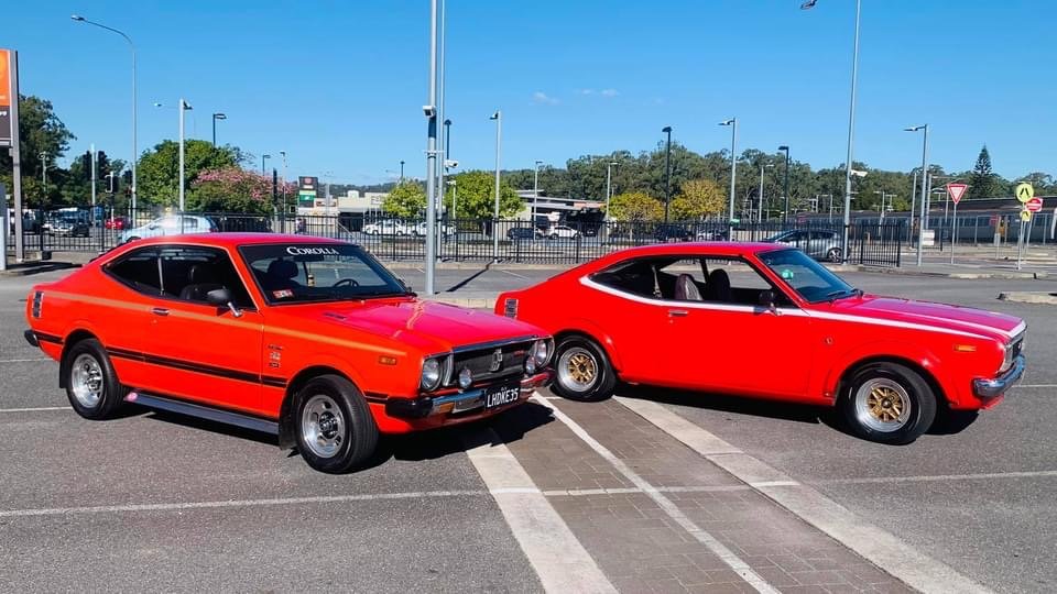

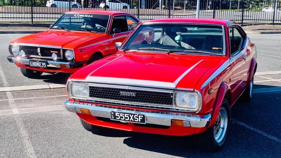

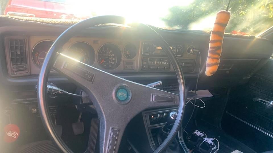

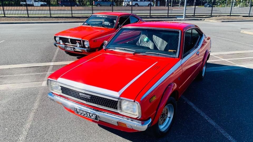

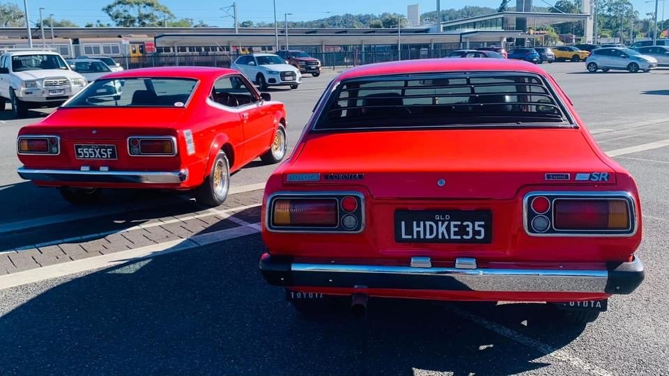

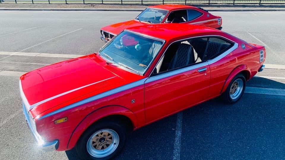

On the weekend I met a very passionate Corolla owner named Steve.
He was passing through town and stopped by to show me his left hand drive KE35, a recent import from Spain.
Steve also owns a mirror-matching RHD KE55, a KE50 and has a KE35 convertible in the works - all painted in Bright Brown.
Interestingly it's fitted with a cable operate T50 mated to the 3K. The clutch cable on the right hand side is actuated by a cross-bar from the left hand side clutch lever.

It does seem they didn't get the K50 over there Simon, as this was a '78 model - so not so "early" 5 speed.
