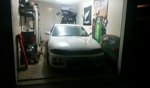

and i had to fix the clutch on my daily.. the slave pump was not releasing, so the clutch was stuck sometimes..
Looks like some good progress, keep up the good work :)
P.S: Awesome daily!
LoL! You should've offered to buy it of Tore for $100!
As good as Antiques Roadshow!
haha, no I'm not parting out this one
