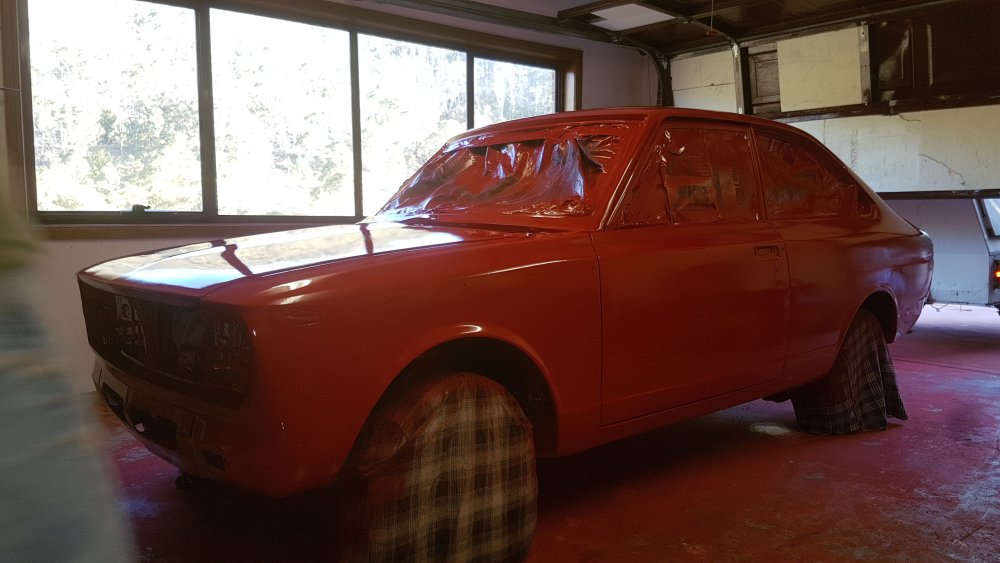

The Sprinter is now painted! It was sprayed on Thursday afternoon, 18/01/2018. Five days before my eighteenth birthday!
(One excellent present if you ask me)
Dad did a fantastic job on the gun, the paintjob is absolutely gorgeous! There are a few imperfections that will be corrected with a light rub and a good polish. I'm off to go get some 1500 and polishing compound this morning.. though we still need to wait a while before we can do anything too serious.
For now, I'm happy just to sit in awe of it's beauty. The paint went on well, and didn't reveal any body imperfections we weren't already aware of. Absolutely stoked with the outcome.

Looks fantastic! Did you go 2pack or Acrylic paint? The paint prep was what seemed to take the longest on my rebuild. After that it should come together quite quickly. You will be rolling in no time!
Thanks mate,
We went with 2pack in the end. Yes the prep seemed as though it would never end.. though it finally has. I'm very impatient to put it back together right now but it needs the 1500 grit treatment and polish first..
I'm certainly hoping to be rolling soon!
