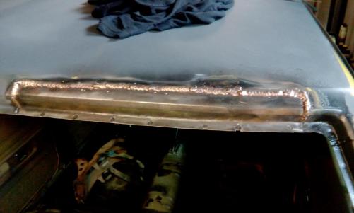

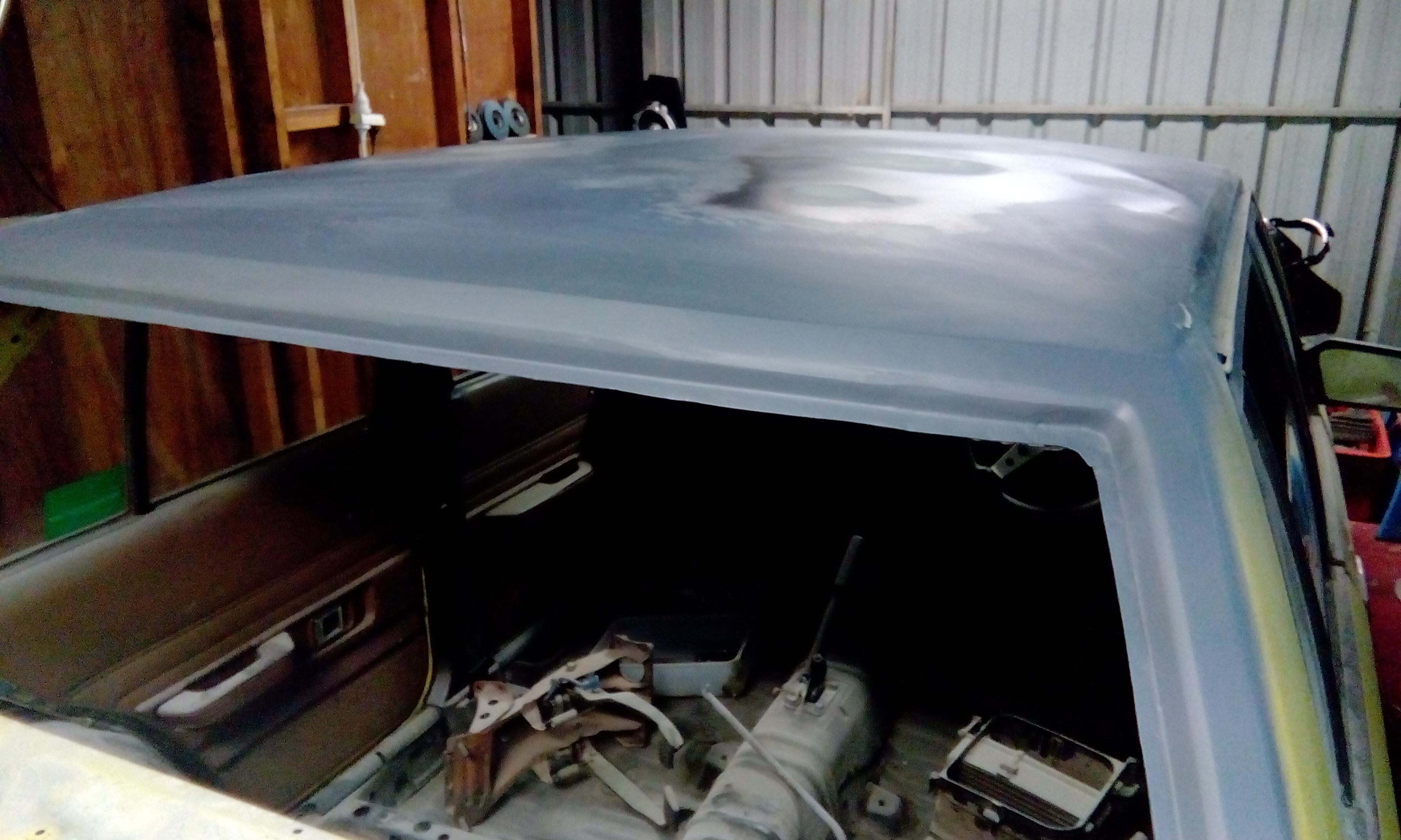

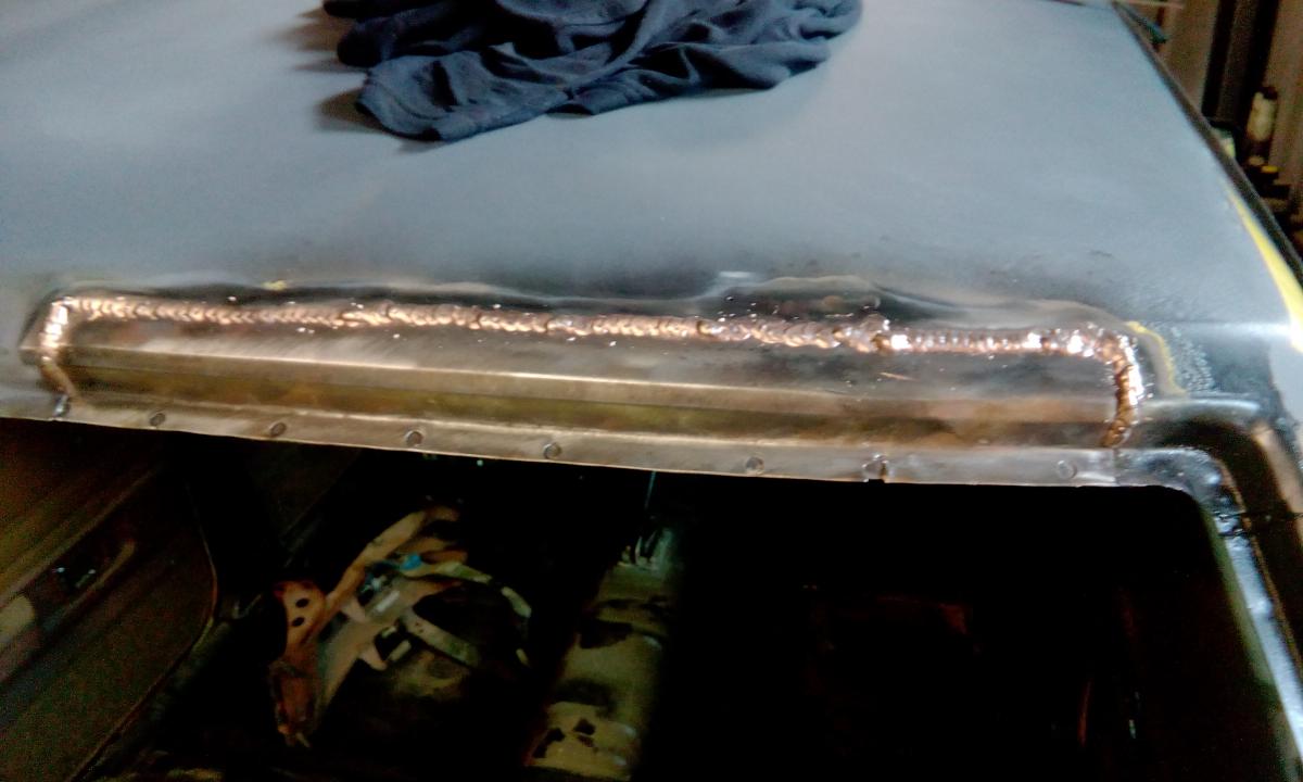

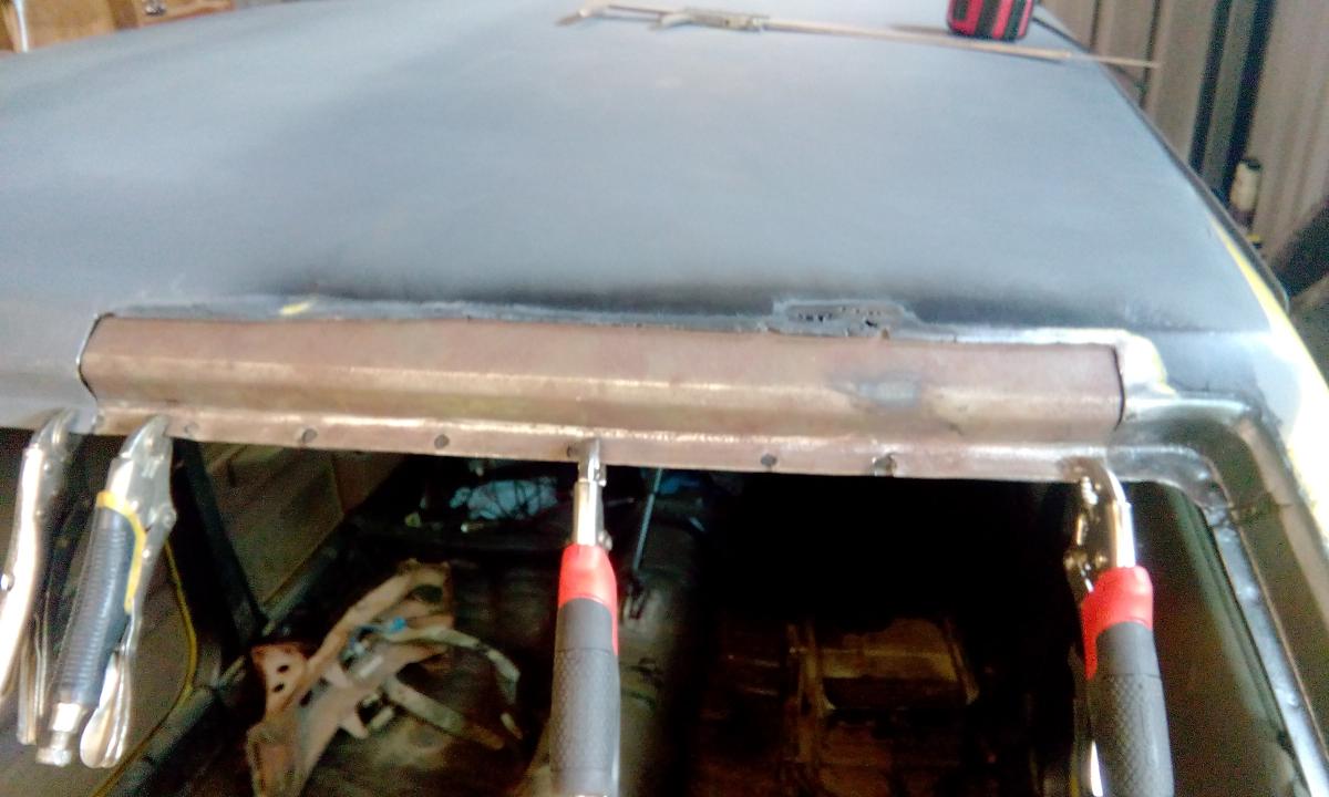

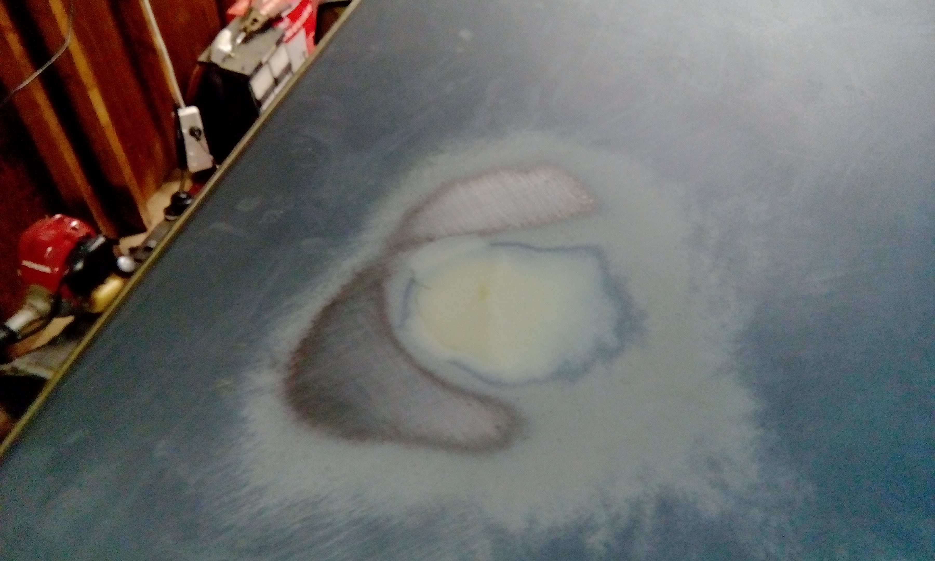

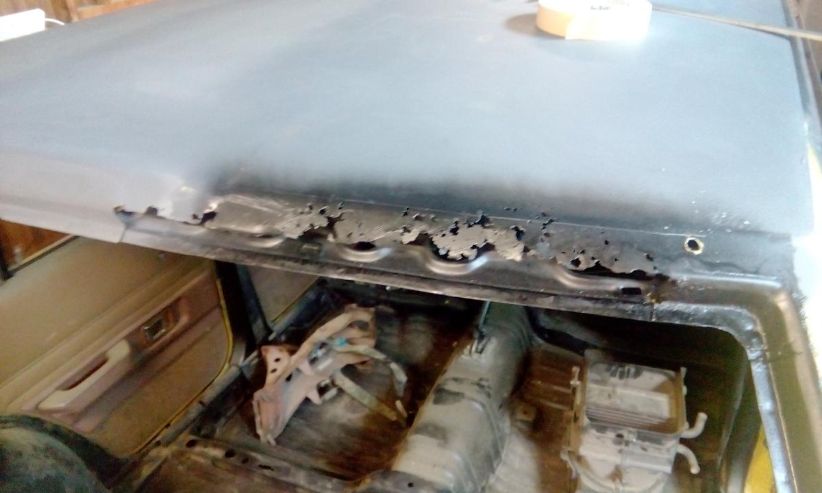

    Been a while scince I last updated this. Gets hard to find time between work and looking after my daughter. Got the shape back in to the rear window opening now and started filling the dents

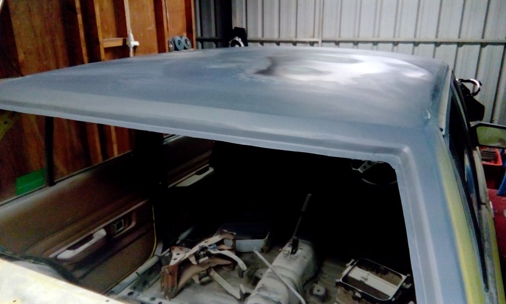

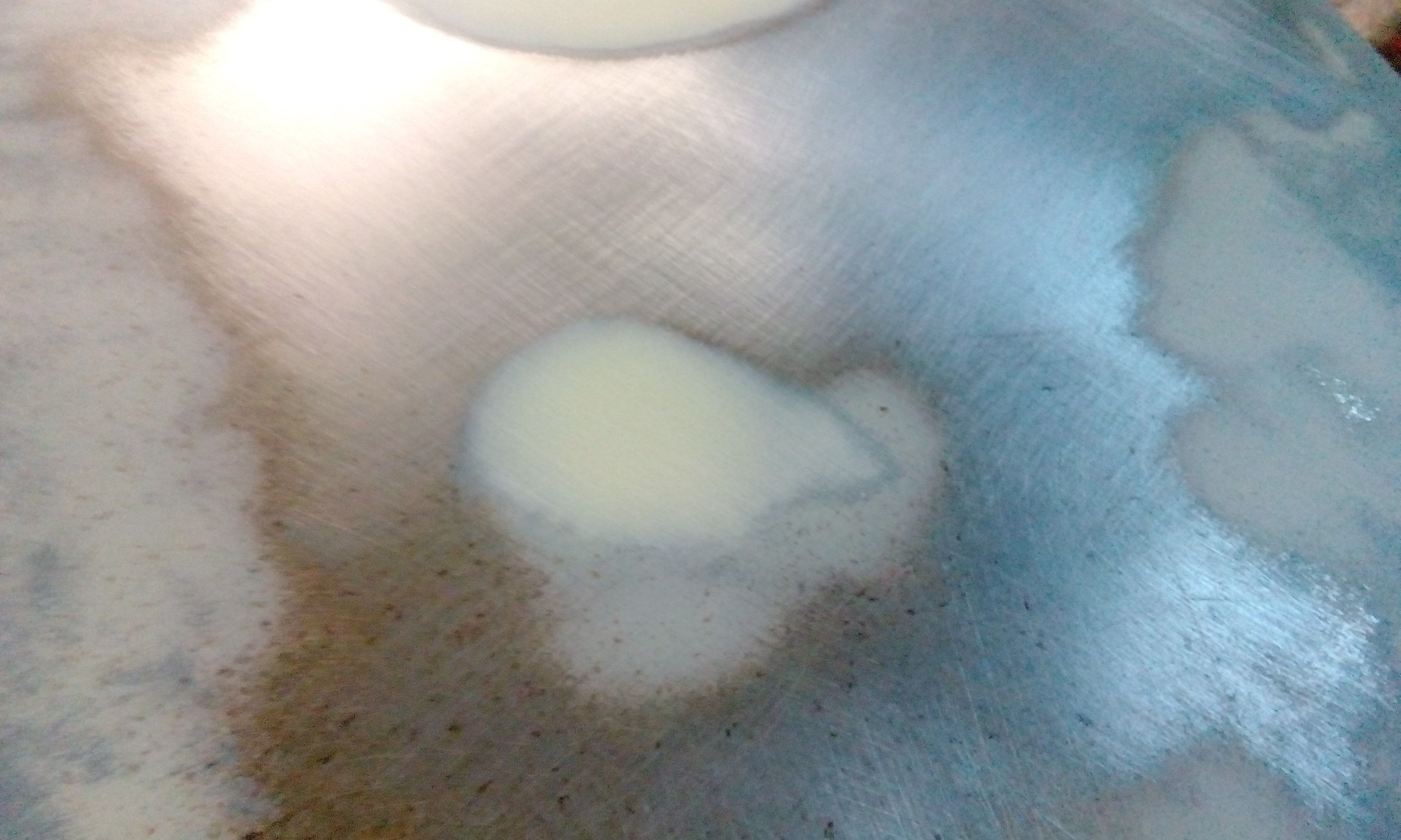

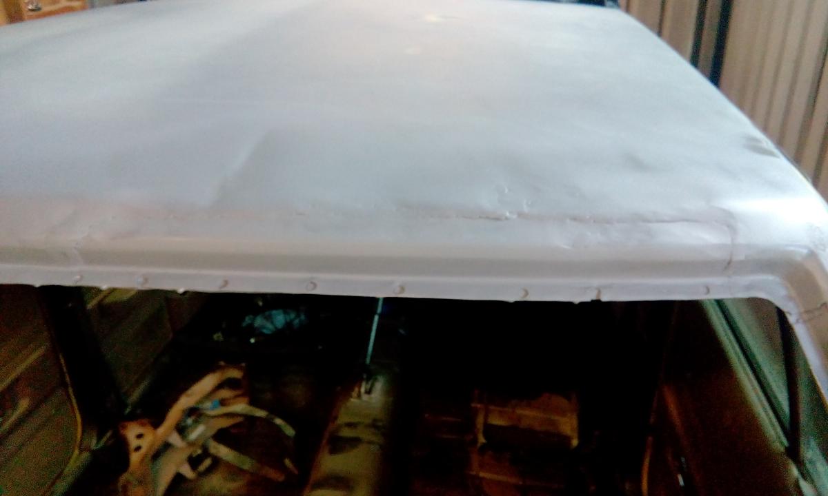

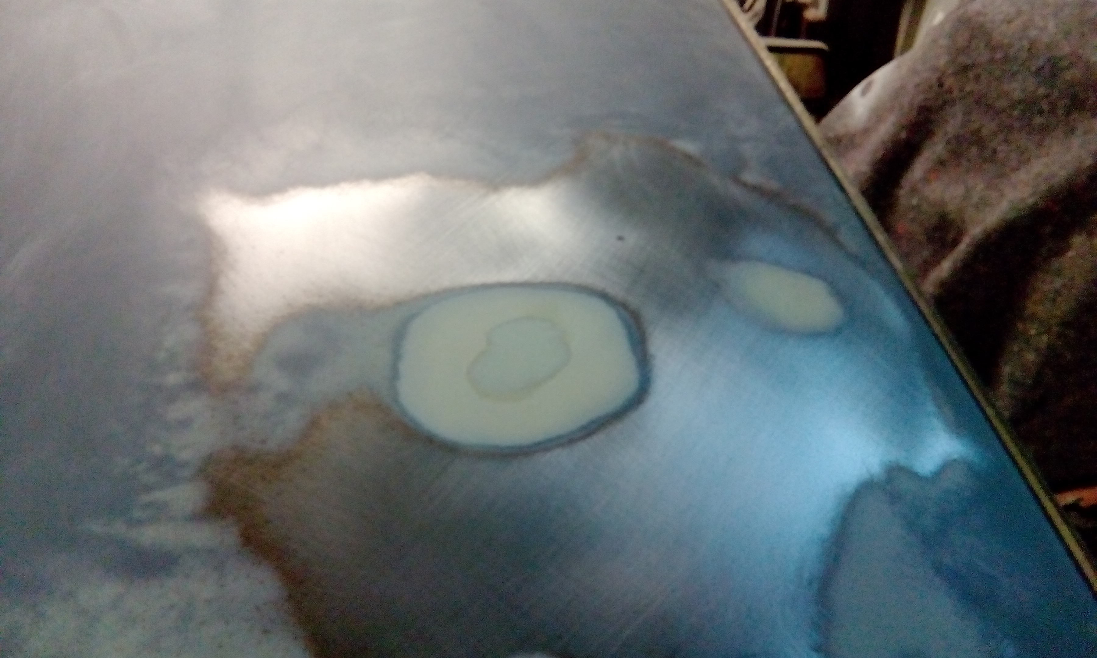

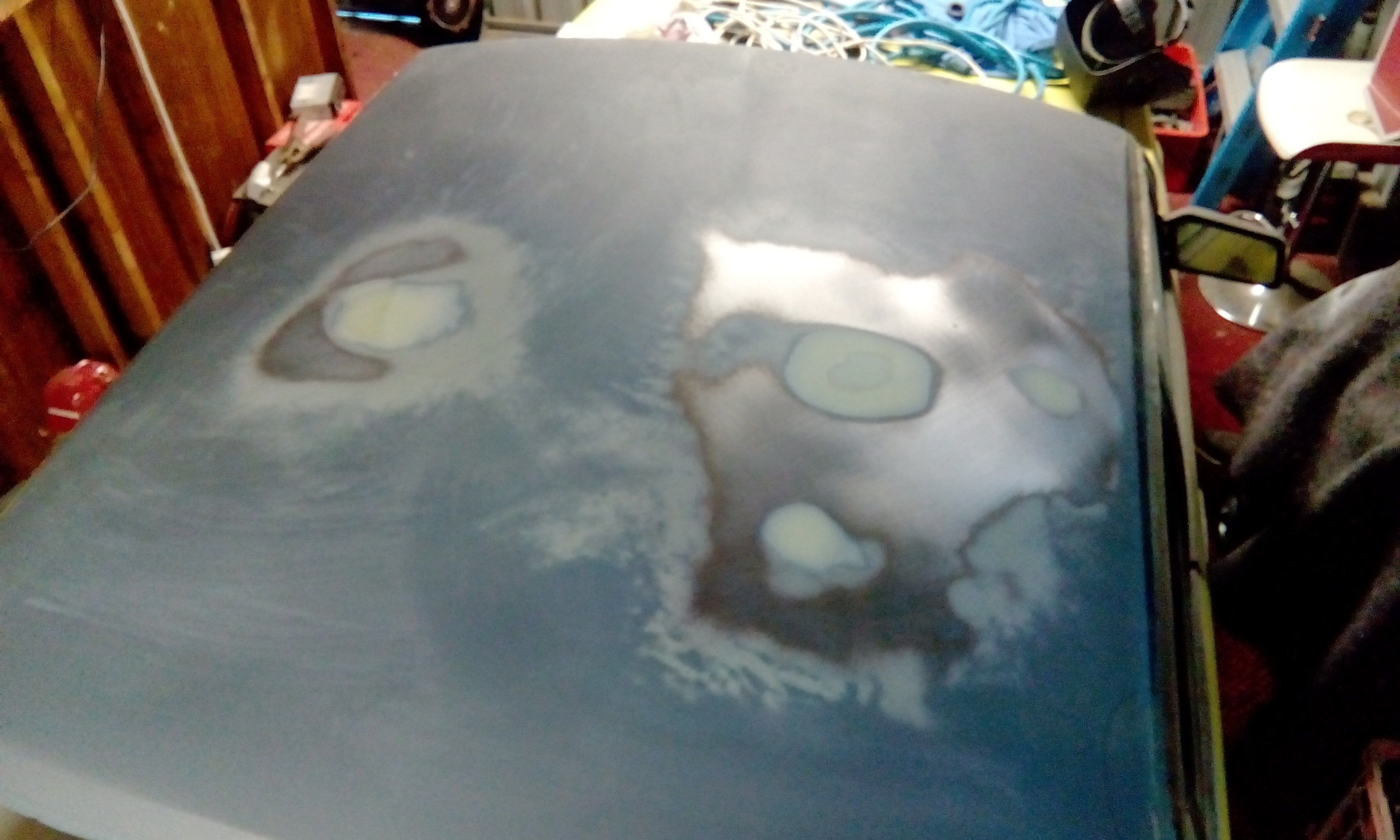

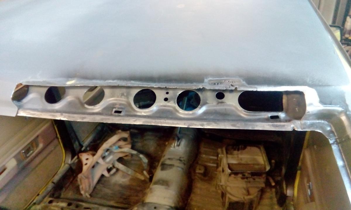

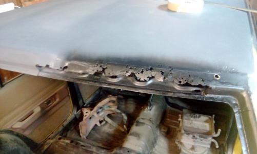

Got the shape back in to the rear window opening now and started filling the dents in the roof where it was vandalized. Think I might need some shrinking around the dent on the drivers side, keeps collapsing on itself when you apply a bit of pressure when filing..
