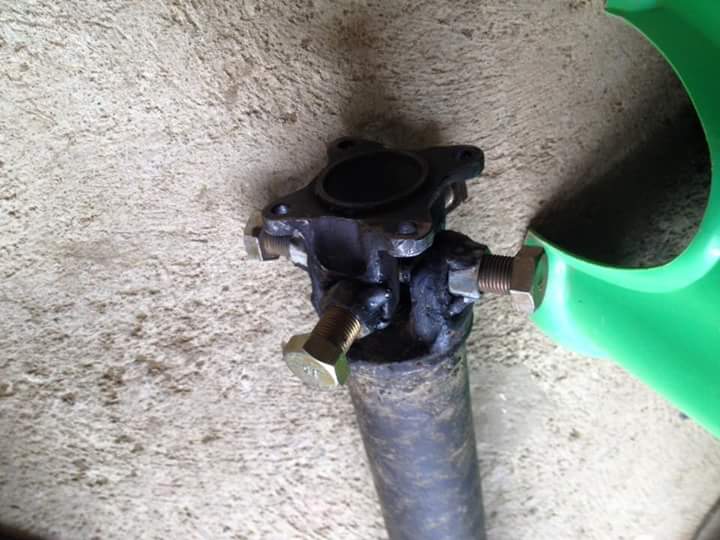

i managed to repair a none repairable staked in u joint and balanced it on the vehicle using nuts n bolts welded to the holes on the cross bearing (u joit bearing) holes.
I cranked up the rear left axle stand under the rear,  started the engine, put it in first gear got under the car and used a marker pen held firmly in my hand against the ground and touched it lightly against the rotating driveshaft. it left marks on the side which needed to be pushed away.
u can use this marker pen method just to see if there is a particular direction your shaft is vibrating to. if it consistently indicates movement only in one direction, (marker only marks one side), the u joints are defective or missaligned and need to be replaced or the flange is missaligned.
