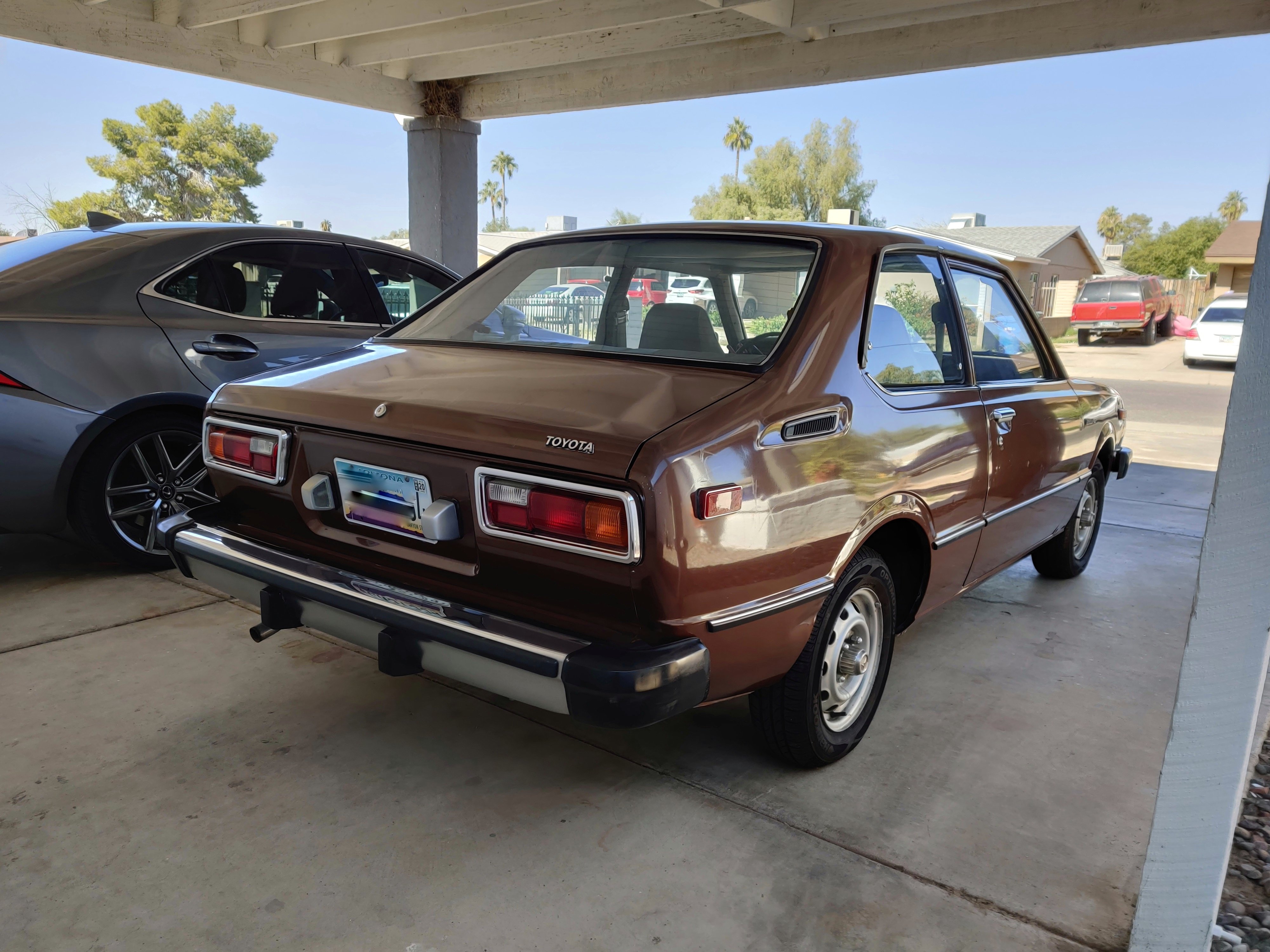

New to the forum and just purchased this beautiful example of a 1979 Toyota Corolla! I have so many questions on what to do with this platform. Here's some pictures. Hope you guys like it!https://youtu.be/Rotu6dRFY8M
Edited by Misael
Video upload
Here's a shot of my interior. 83k original miles. 2TC. Unfortunately automatic.
What do you guys recommend to start replacing or changing to get some power into this thing? Is it worth it on the 2TC platform or would a swap be more recommend? What engine swap is relatively easy? Appreciate your guys input! Thanks in advance!
