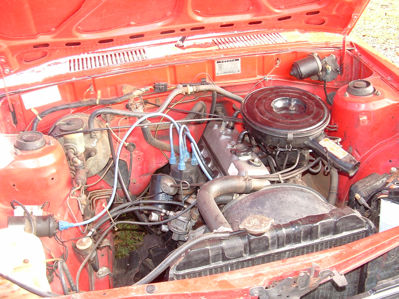

81 ke70 5 speed,
plans, coil overs front, chopped falcons and sierra shocks rear.
4agze, t50.
welded diff.
and drive it.

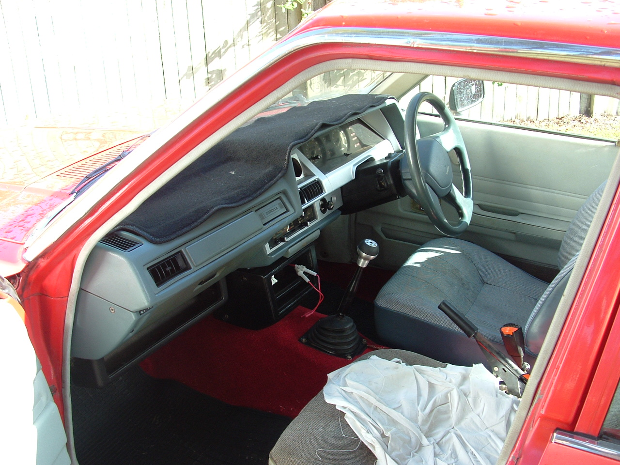

so far ive got it registered and mod plated for the 2 seats
sprayed the boot black
lowered the back and will do the front tomorrow.
found a pair of bucket seats for it (bride)
bought a boss for an oldschool steerer i got off rollaandy
put some nice wheels on it from andy.

powerwise around 100kw at the motor, somewhere around 85kw at the wheels.
if anyone is on the sunshine coast and doesnt mind giving a hand with the conversion ill be more than happy to pay with beers, could turn it into an 4age into ke70 conversion party.

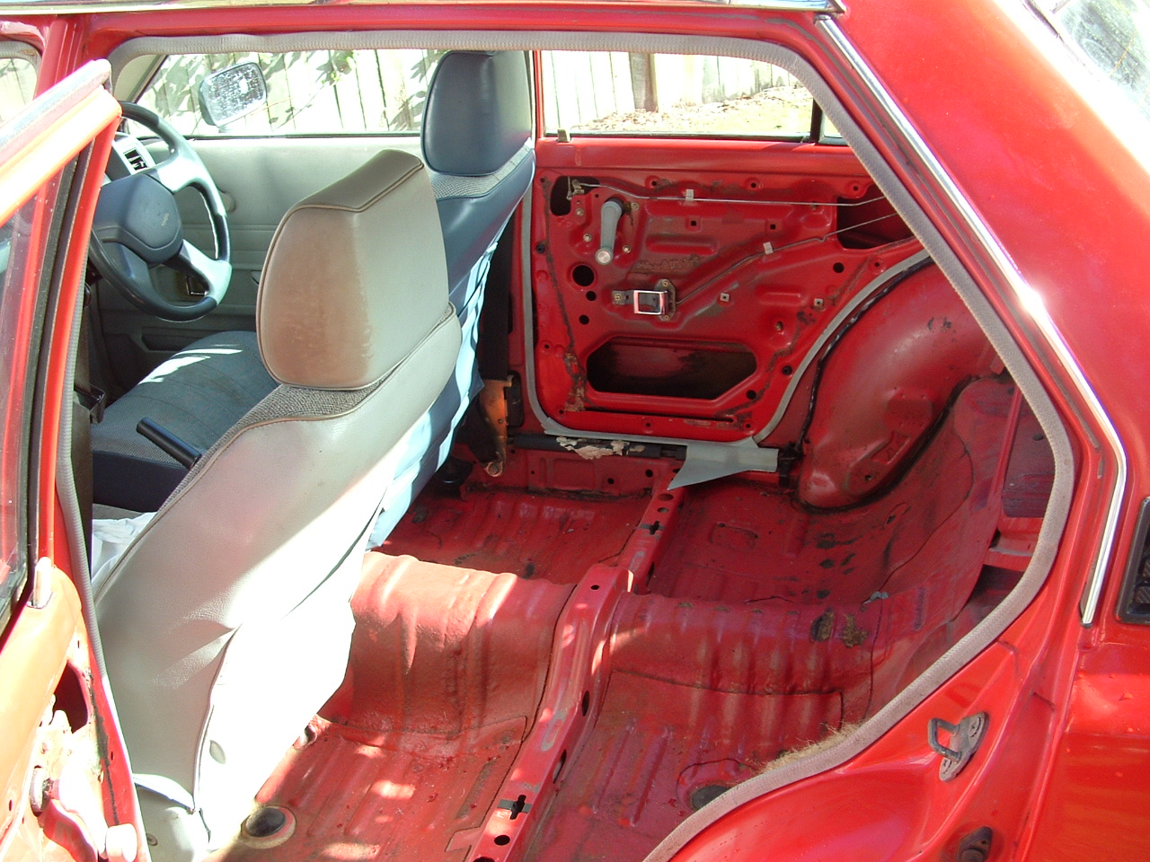

just pulling all the old junk out today.

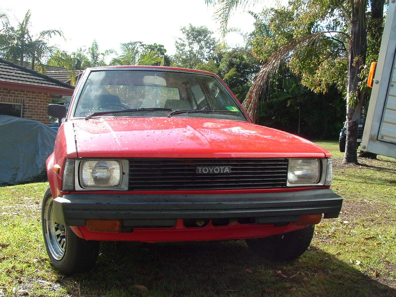

one other quick question - does anyone know if there is an easy way of converting my headlights the the jap/nz twinies, can i buy them on ebay.nz or something and have them shipped over, do they bolt on? can i even get hold of them. Cause I'm going the whole jap look with mirrors on the quater, twin head lights, wantanabees, panda paint.
Edited by driftke70
twin headlights wont bolt on unless you get the entire front including panels and rad supportbar i think.
Just make your own ;) cheaper and just as good.
Biggo, you are incorrect.
My project car was an early front end like the car in this thread...
To convert to twinheadlight front end, if you have the early front end (like this car)
1x Twinheadlight front end assembly (lights,light brackets, Grill)
1x Twinheadlight front lower apron
Chrome bumpers front and rear
Chrome bumper brackets & Nuts + relating assembly
Slight change of wiring to suit 2 lights (on twinheadlight - outside lights are normal, insides are highbeam)
