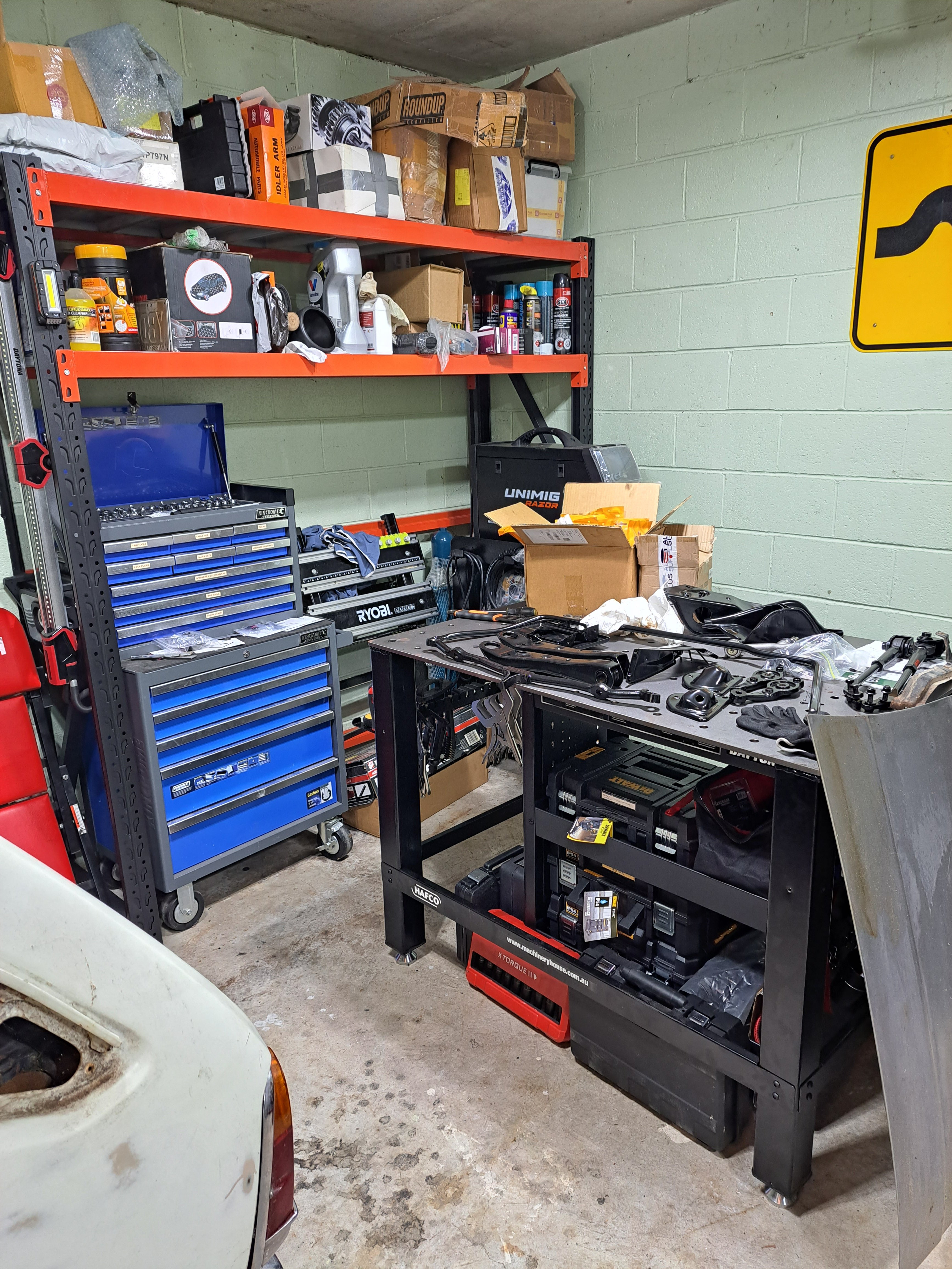

Getting a larger workspace with more of my own tools, that would be the dream. I think that would be retirement for me, just working on cars and not the desk job. Right now my garage is a little cramped,
That is my home setup, the suspension is now packed away in boxes and I'm working on the bonnet, some rust repair and then I'll deskin that too. But now on that later 😁

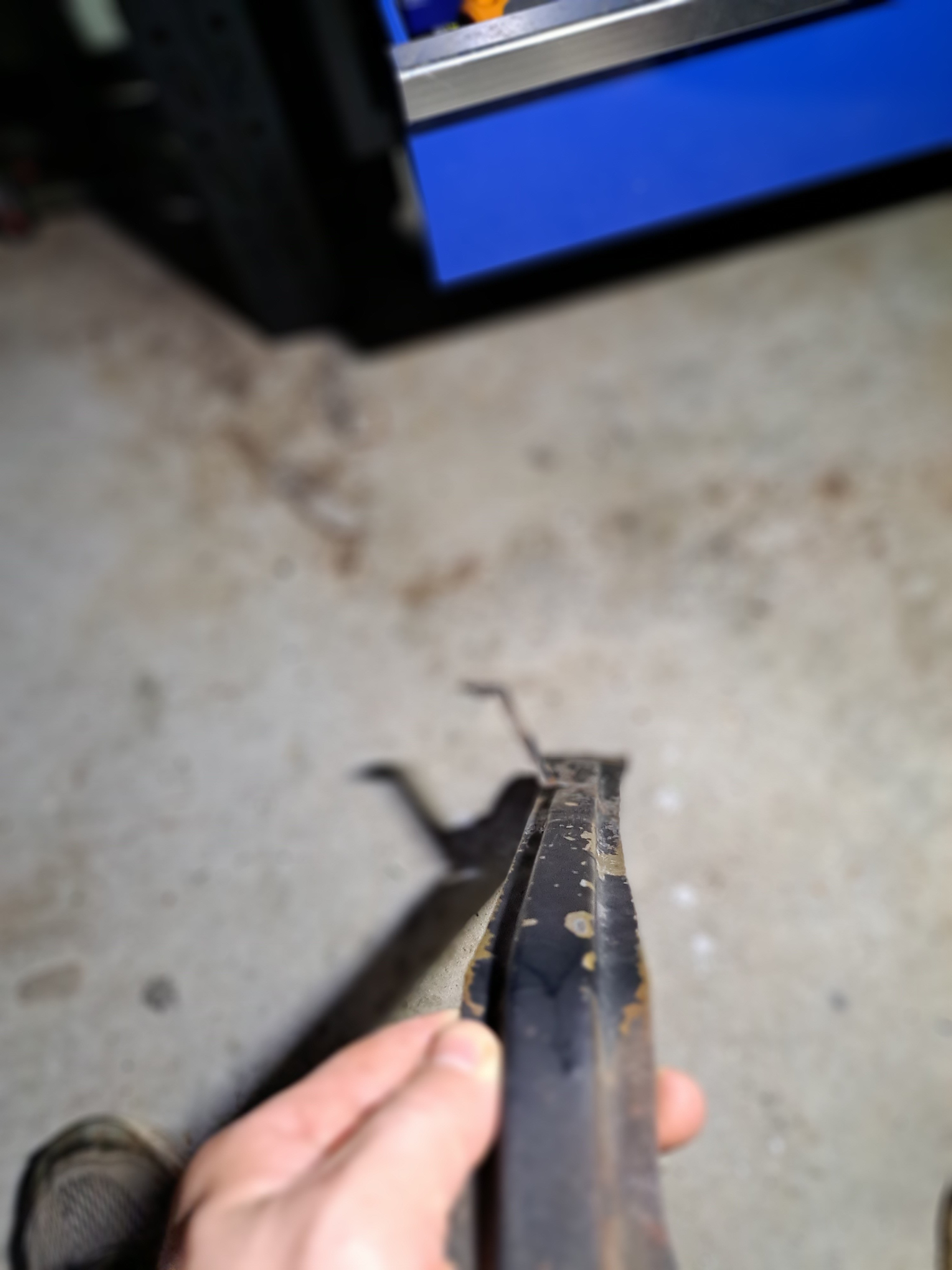

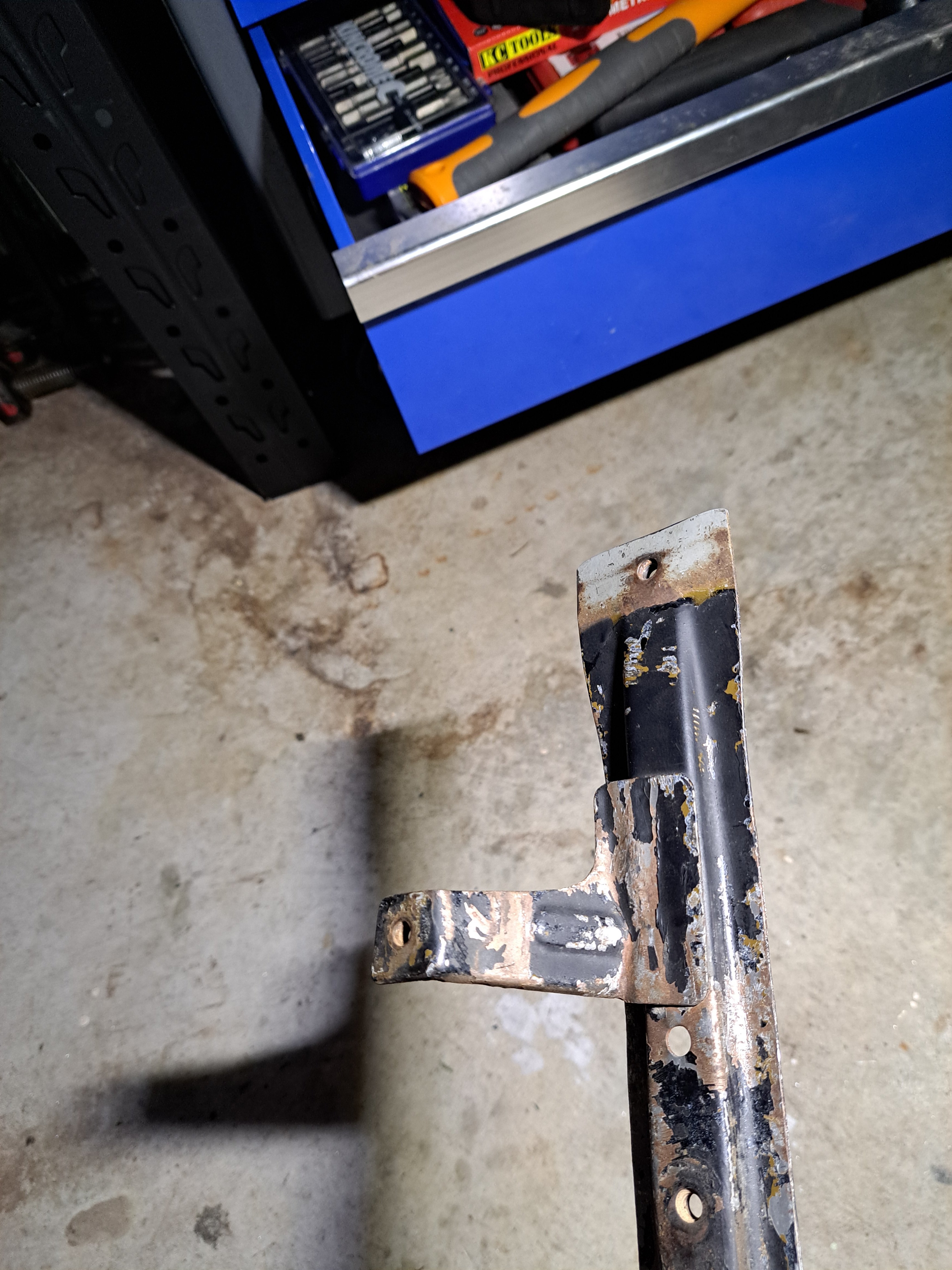

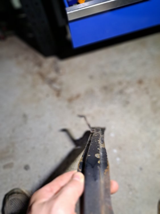

But back in my own garage I have also finished straightening the grill brace, so now it's nice and straight down the main channel.
I am still deciding what to do with the actual bracket for the grill. I might drill out the spot welds and fashion a new brace as this one is very bent.
I will give it a paint strip and see what it looks like. But it's rust free for the most part, so a run over with the wire wheel and the rust converter, primer paint and it should be ok

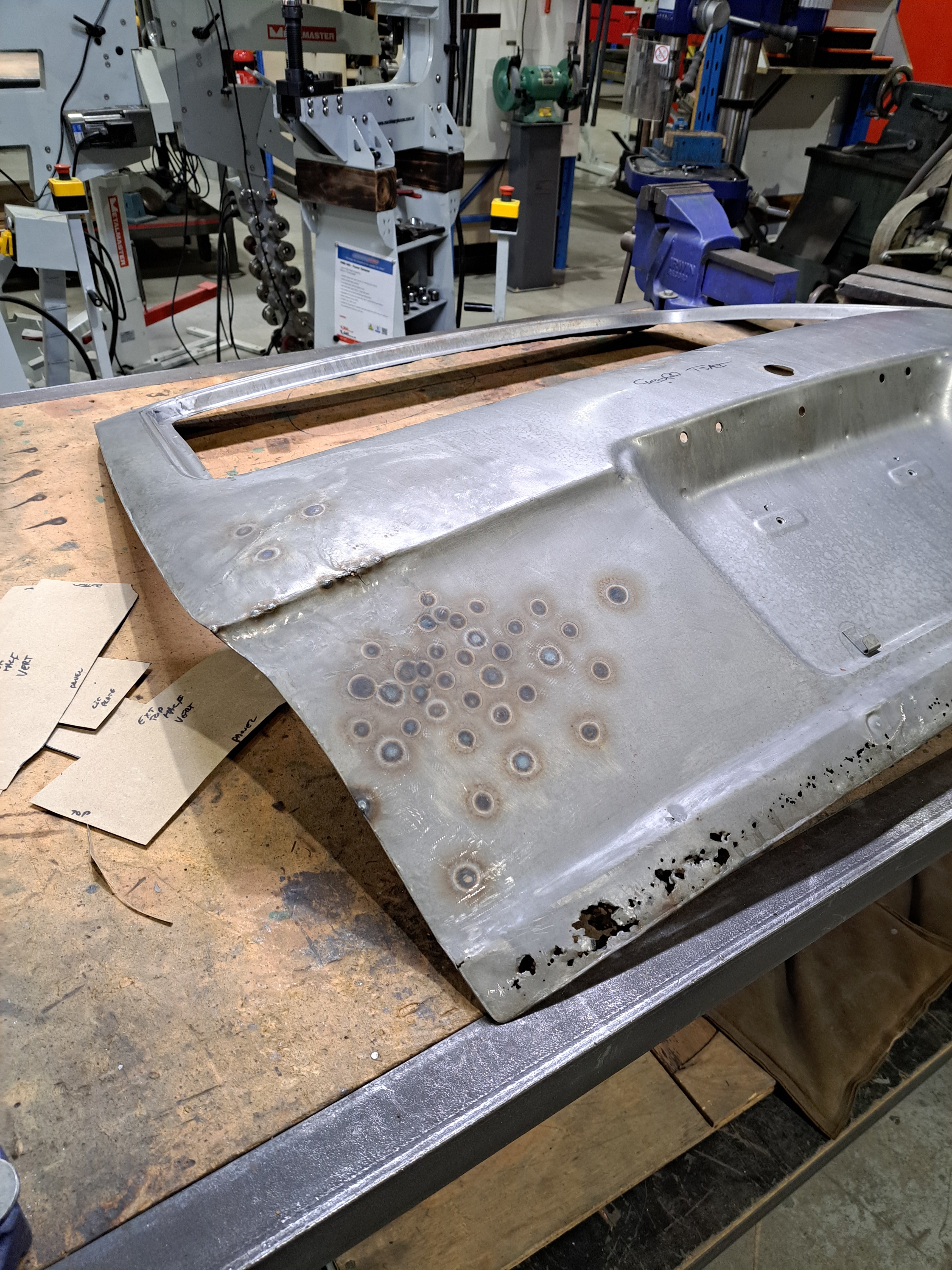

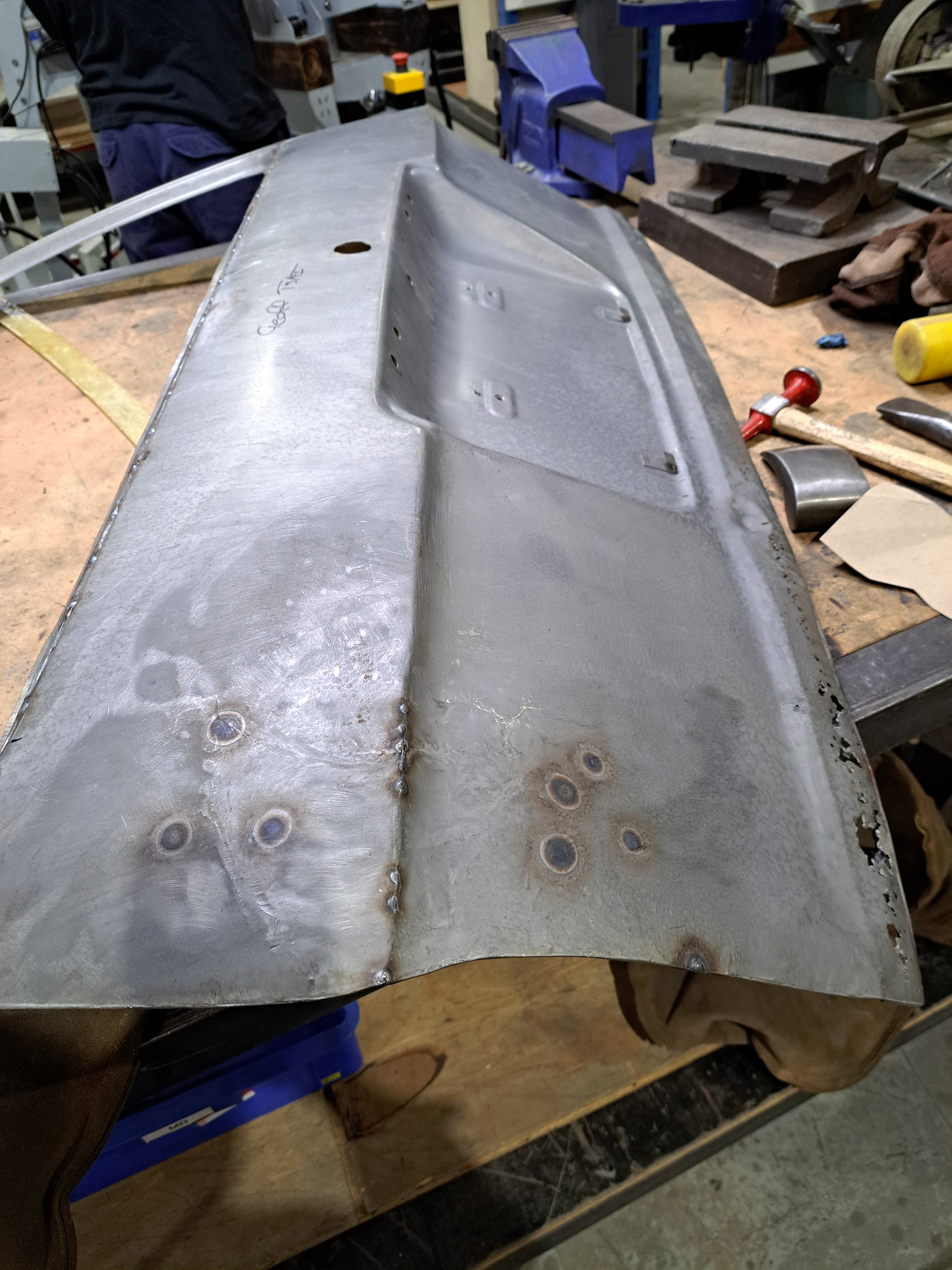

I started work in the major damage to the tailgate, it started with taking many a profile of the various shapes and curves from the good side.
And then I started to put the body line back into the center of the tailgate. This unfortunately showed up that there was a large split in the steel that I have tacked together whilst I get the main shape back into the panel
Then I started work with the hammer and dolly to remove all the wrinkles and the large creases. This then left the steel very proud as it was badly stretched from the accident. So with a multitude of hot shrinks I have begun the chasing of shape back into the tailgate
But it's starting to look like a tailgate again

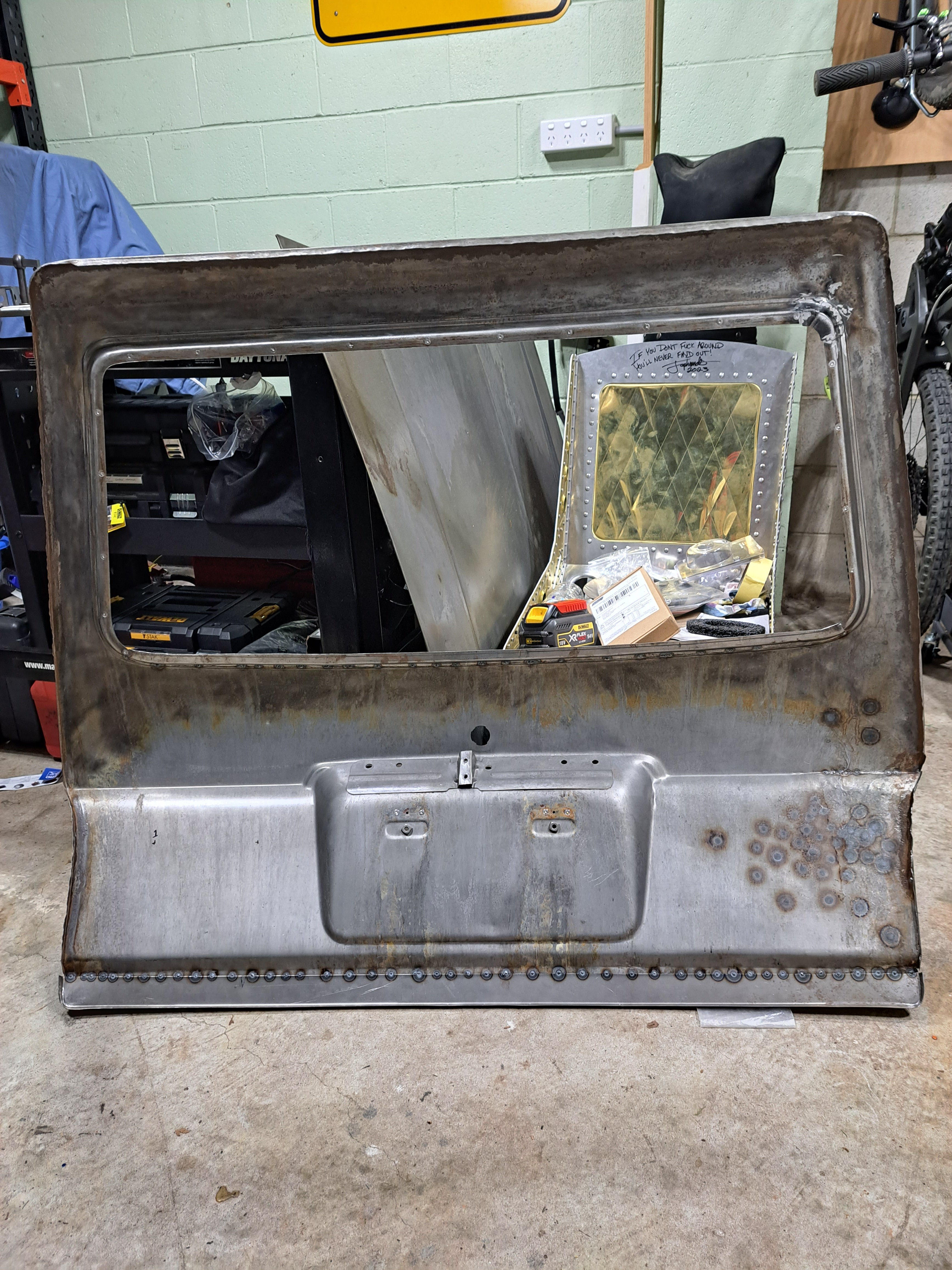

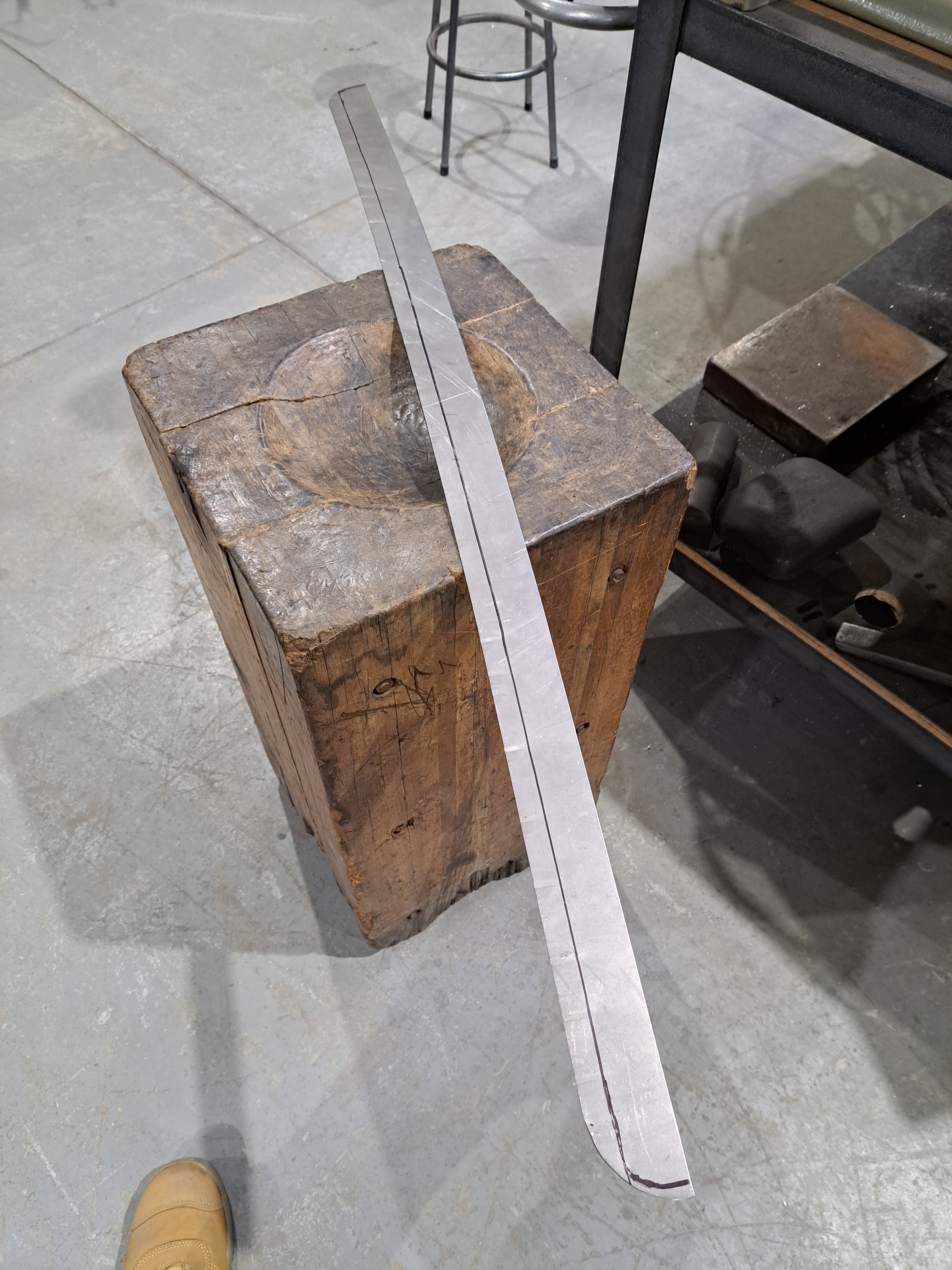

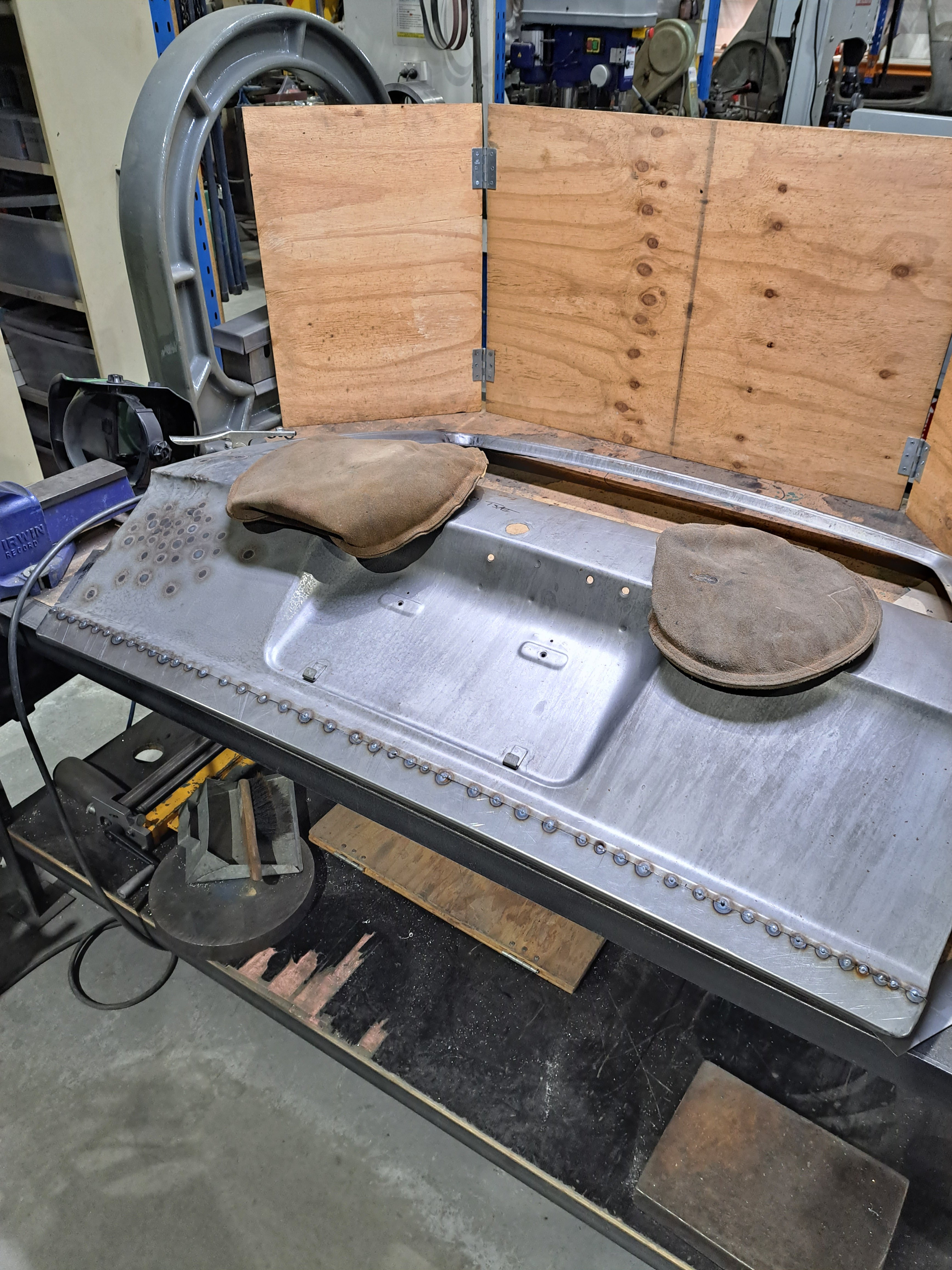

The base of the tail gate was templated and then I cut a new peice of steel.
It was folded, shrunk on the seam and then I put it through the English wheel to get a nice crown and get into the shape of the tail gate. Then I cut the rusted bottom section off and I have tack welded the new bottom section in place.
I know this tailgate is taking some time, but the light is at the end of the tunnel.
Next I'll try for it back on the car to make sure the skin is good. Then I'll start fixing the frame

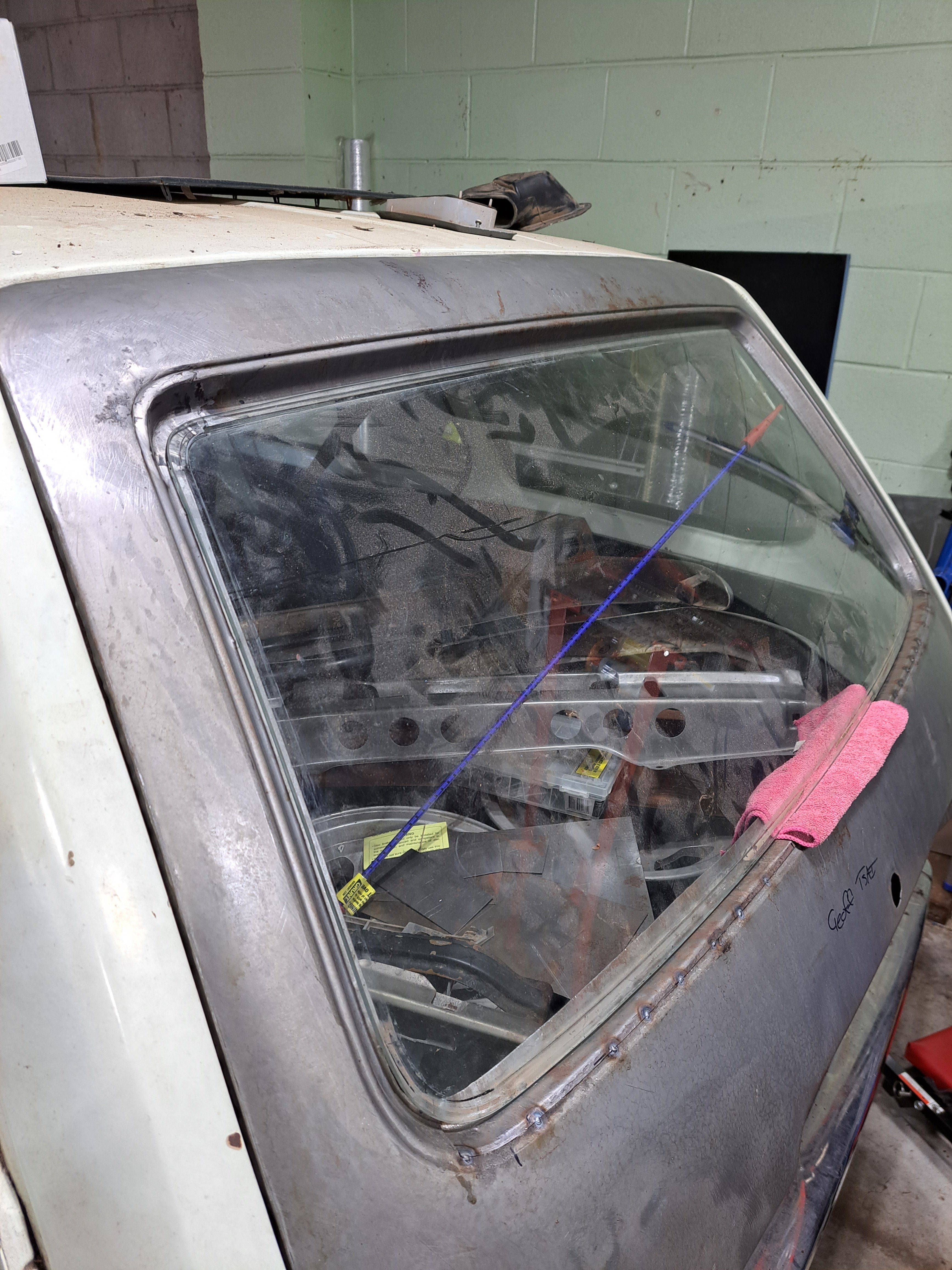

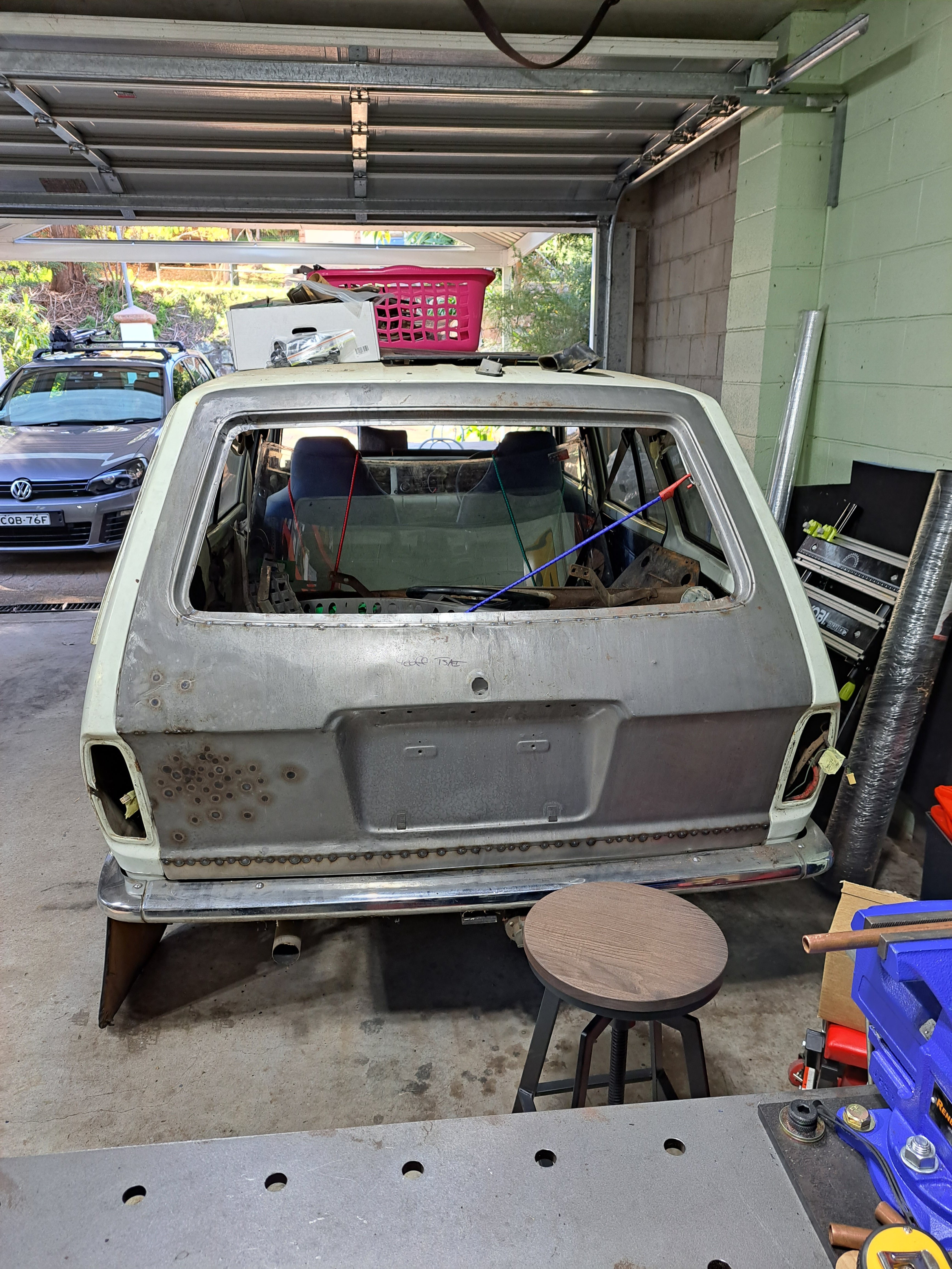

Quickly putting the skin on the frame, and test fitting back to the car...
It fits, a little tight on the passenger side, but I expected that as I still have some shrinking to go to get the profile right.
Double checking the glass as well shows plenty of room for the rubber as well.
So now it's back at home I'll linish back the tacks and weld it in fully. Then I'll take the wire brush and clean up all the rust and hopefully apply a layer of rust converter and primer.

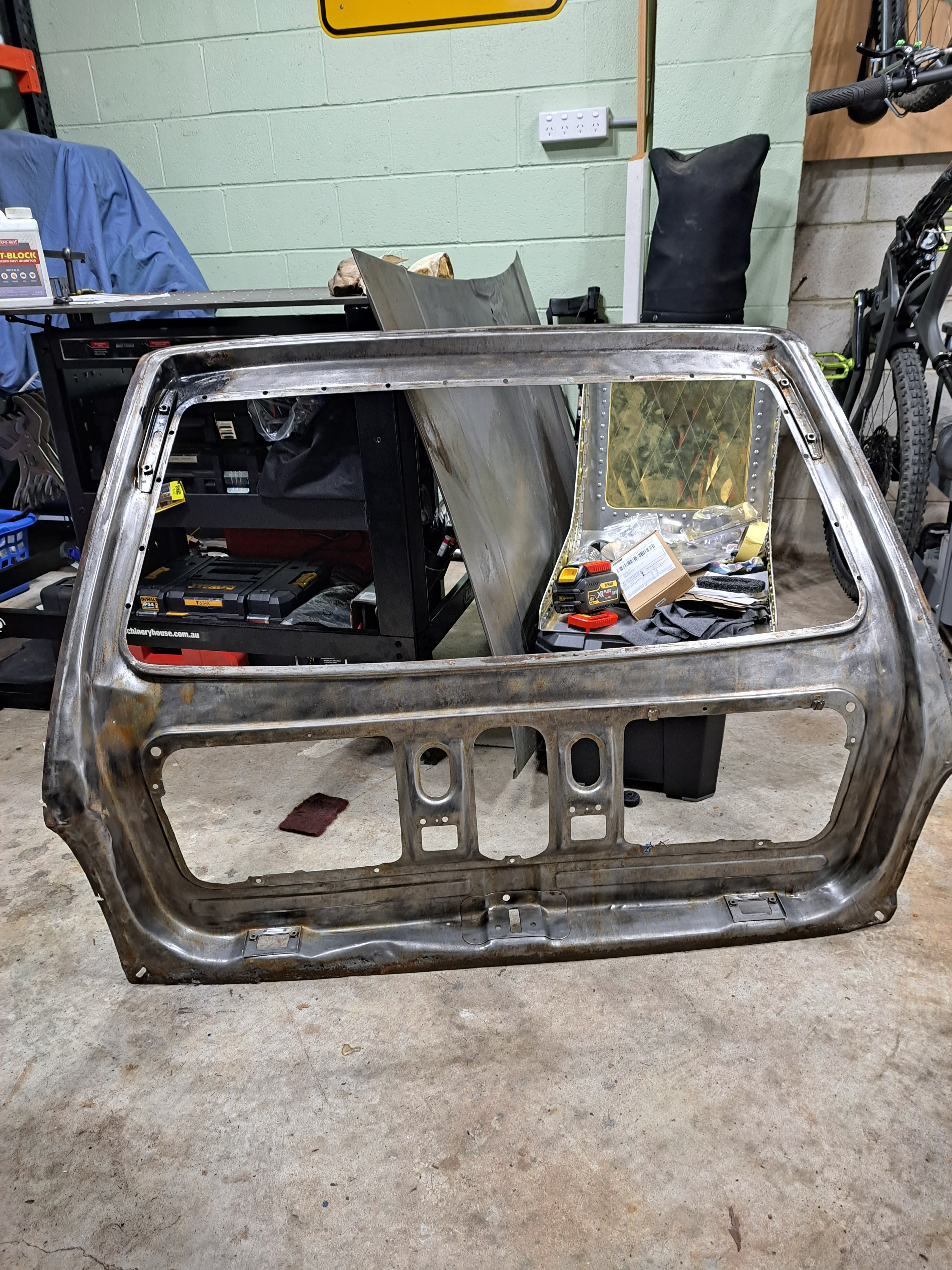

Just a quick update as I have been busy with work and family life. But I have taken a wire wheel to the frame and skin to remove the loose rust, and completed the first pass with some Scotch Brite.
So now that it's clean I have linnished the tacks back so that it can be welded up.
But there where some more tears in the steel around the edges, so I have tacked those so things don't warp out of shape before the final weld

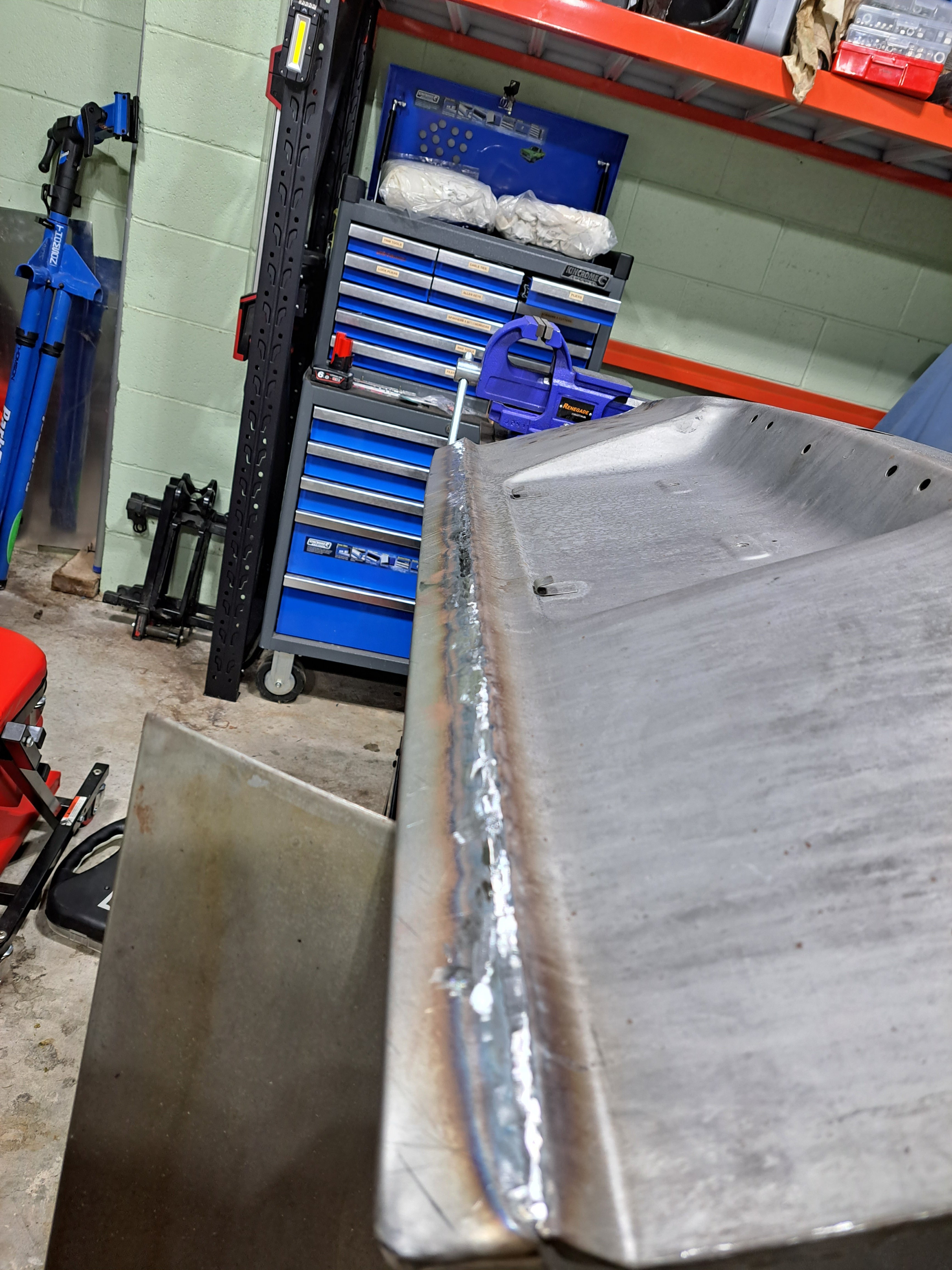

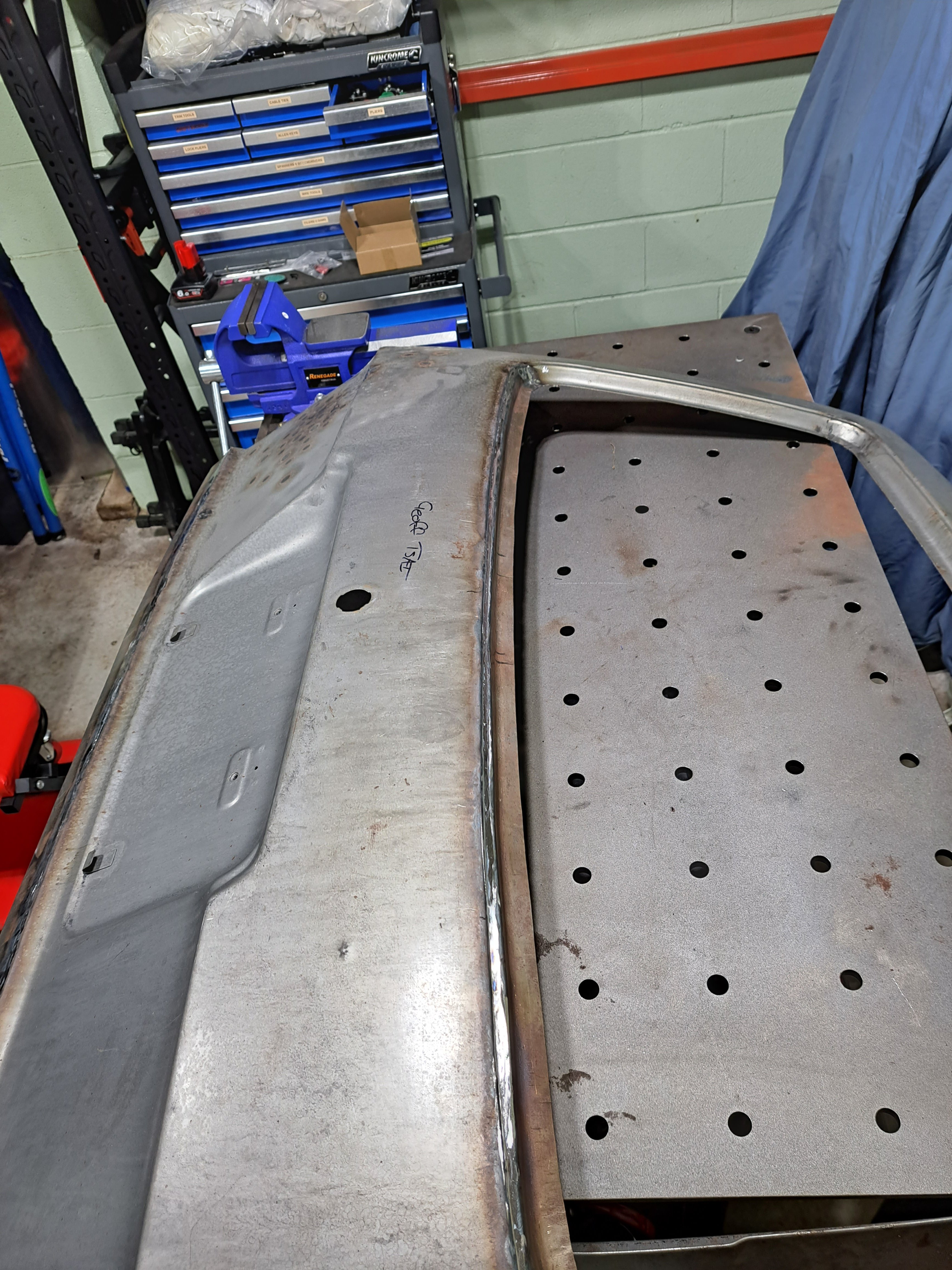

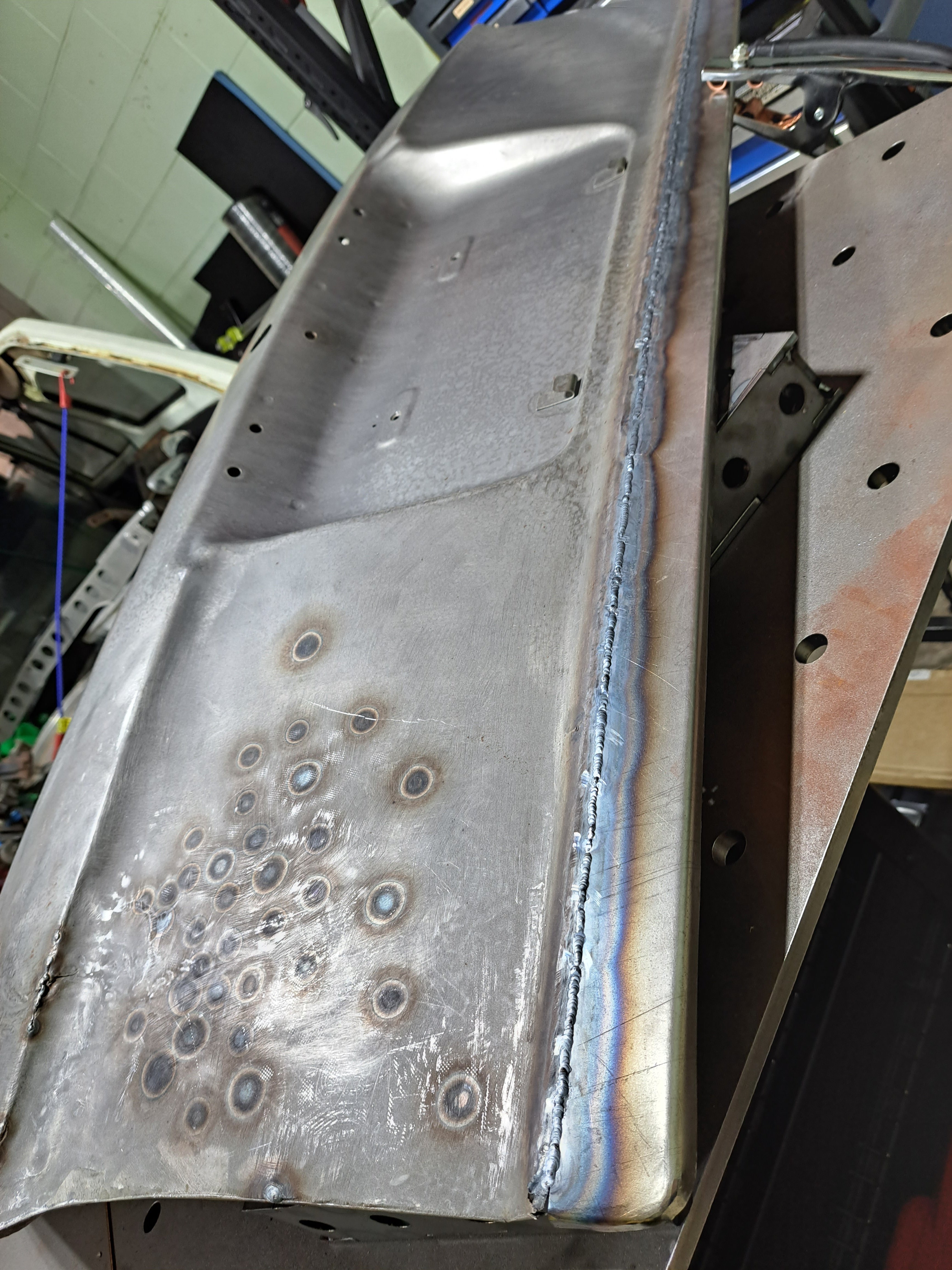

I have had as to take a small break but I'm now back on the tools. I started by welding the bottom of the tail gate in fully.
Took a little trial and error as I haven't used tig on my home welder before. But with a little fine tuning I was happy with the result.
To try and minimize the warping I did a stitch weld tactic. I welded between every alternate tac, then let it cool before I went back and did the finishing pass.

Well the linishing back of the welds is done
The window sill turned out pretty well.
You can see the ripples in the light so I am planishing out with the hammer and dolly.
