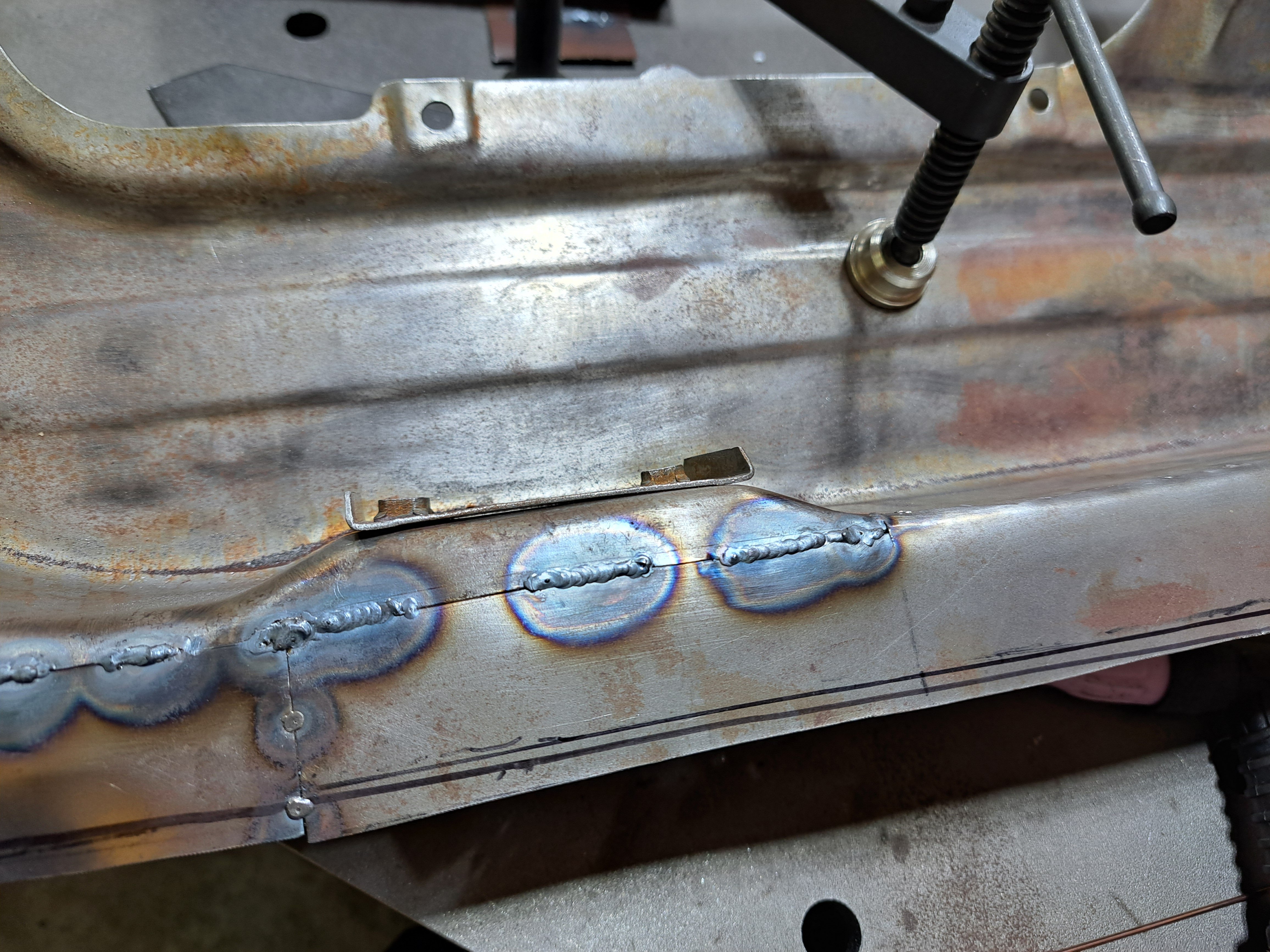

I usually have panels fairly flush, no gap bigger than 1mm however I like them hard up against each other. but I'm using tig so I can control the heat and get the right penetration because I can watch the puddle. If you find you aren't getting the penetration then you can up the Amps for TIG, or voltage for MIG. however a much better welder then me well have more advice.

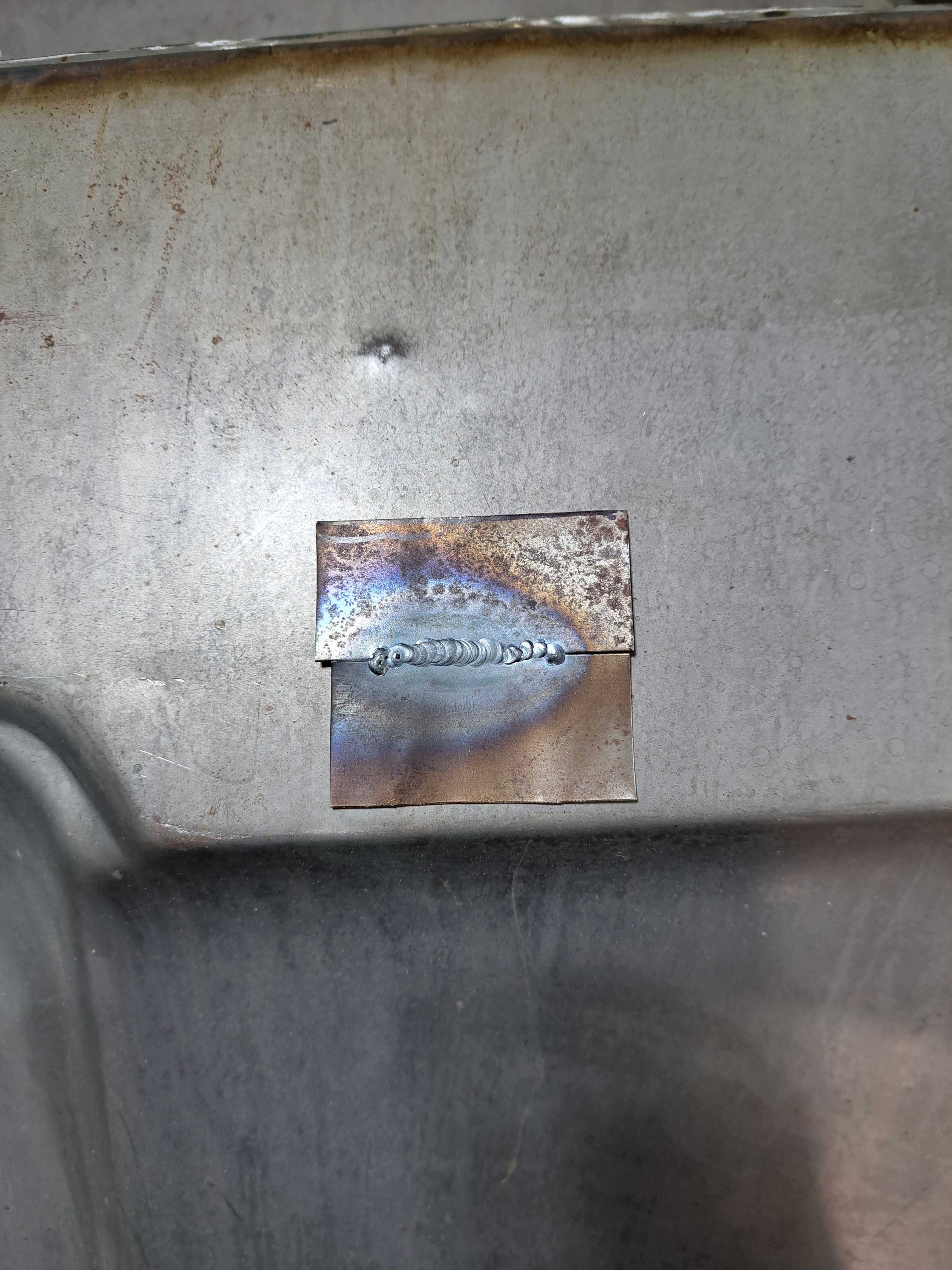

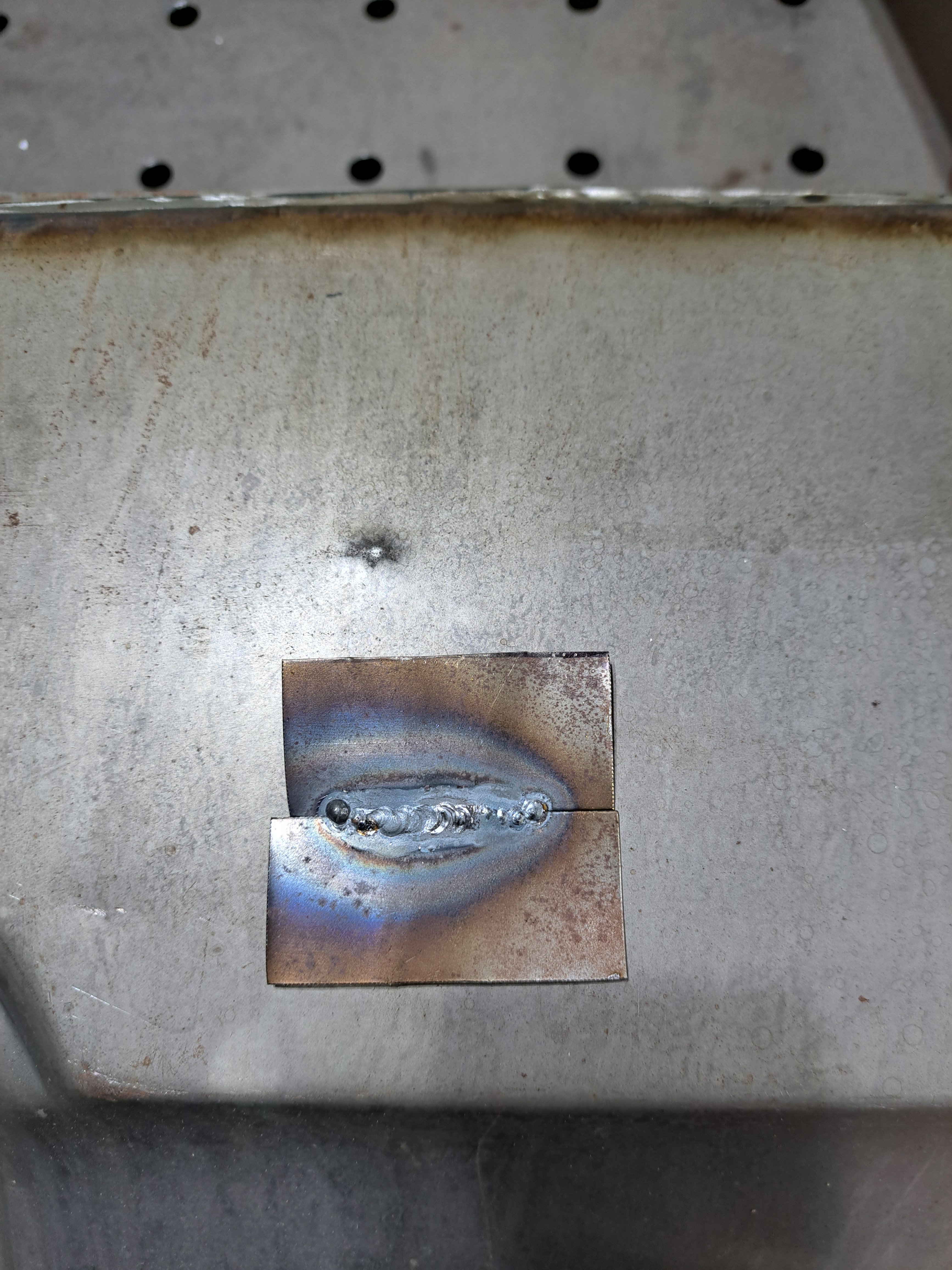

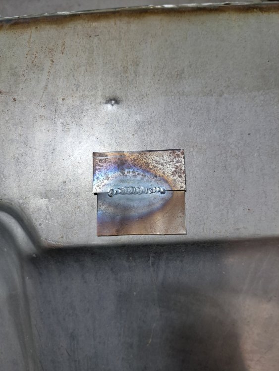

So here is an example, I'm using 0.8mm cold rolled steel. Starting on the right I went too fast and you see the weld is proud and almost shiny. Then I slowed down and let the puddle form and you can see the change in the weld, goes flatter and the filter rod flows into the parent metal.
There was no change to the settings, no change in gas, I just slowed down a little. Flipping it over, again right to left with the metal butted hard up against each other I didn't get penetration because I was too fast. but then looking right to left you can see I get good penetration once I slowed down.
Hope that made sense and it helps

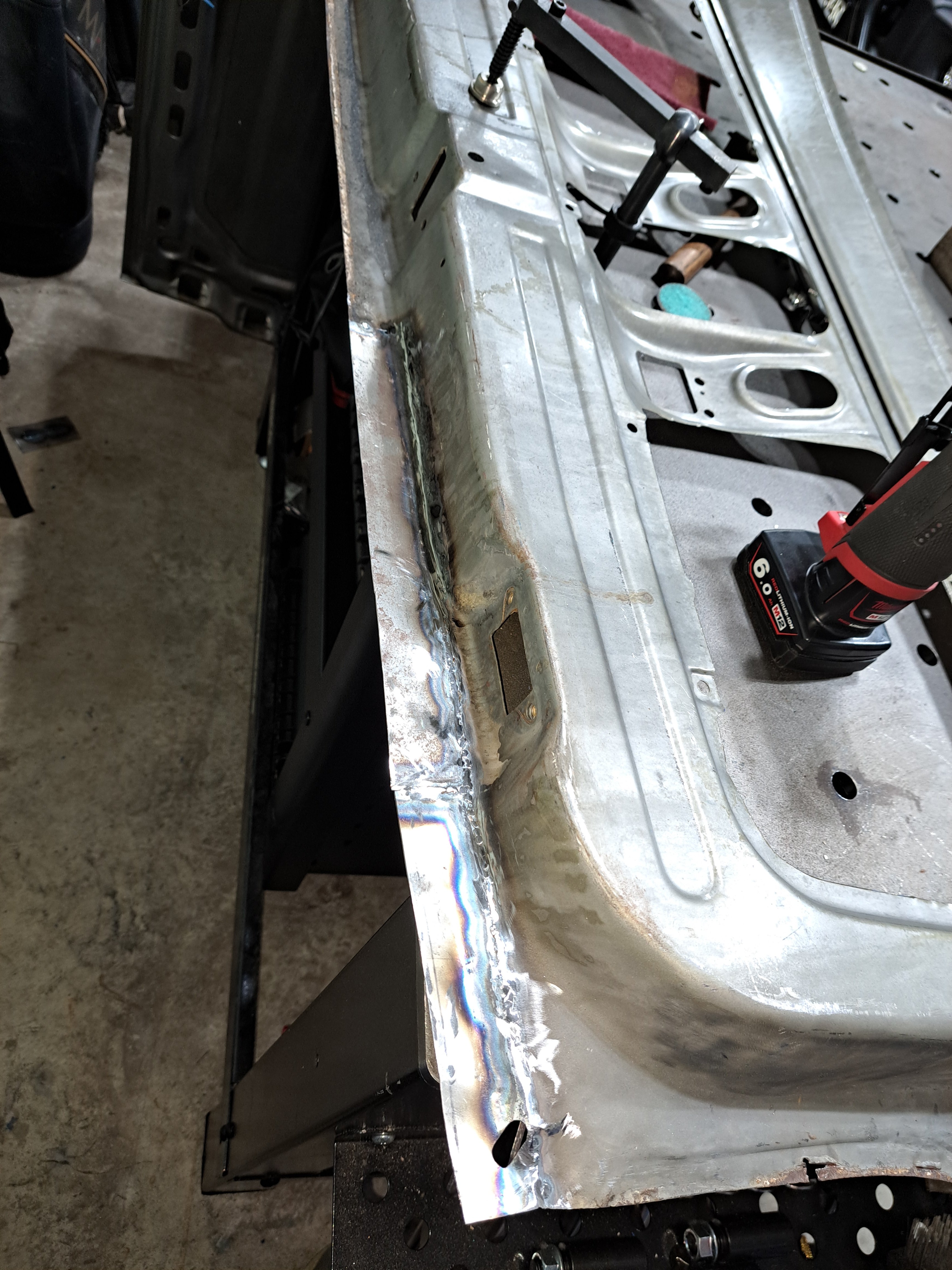

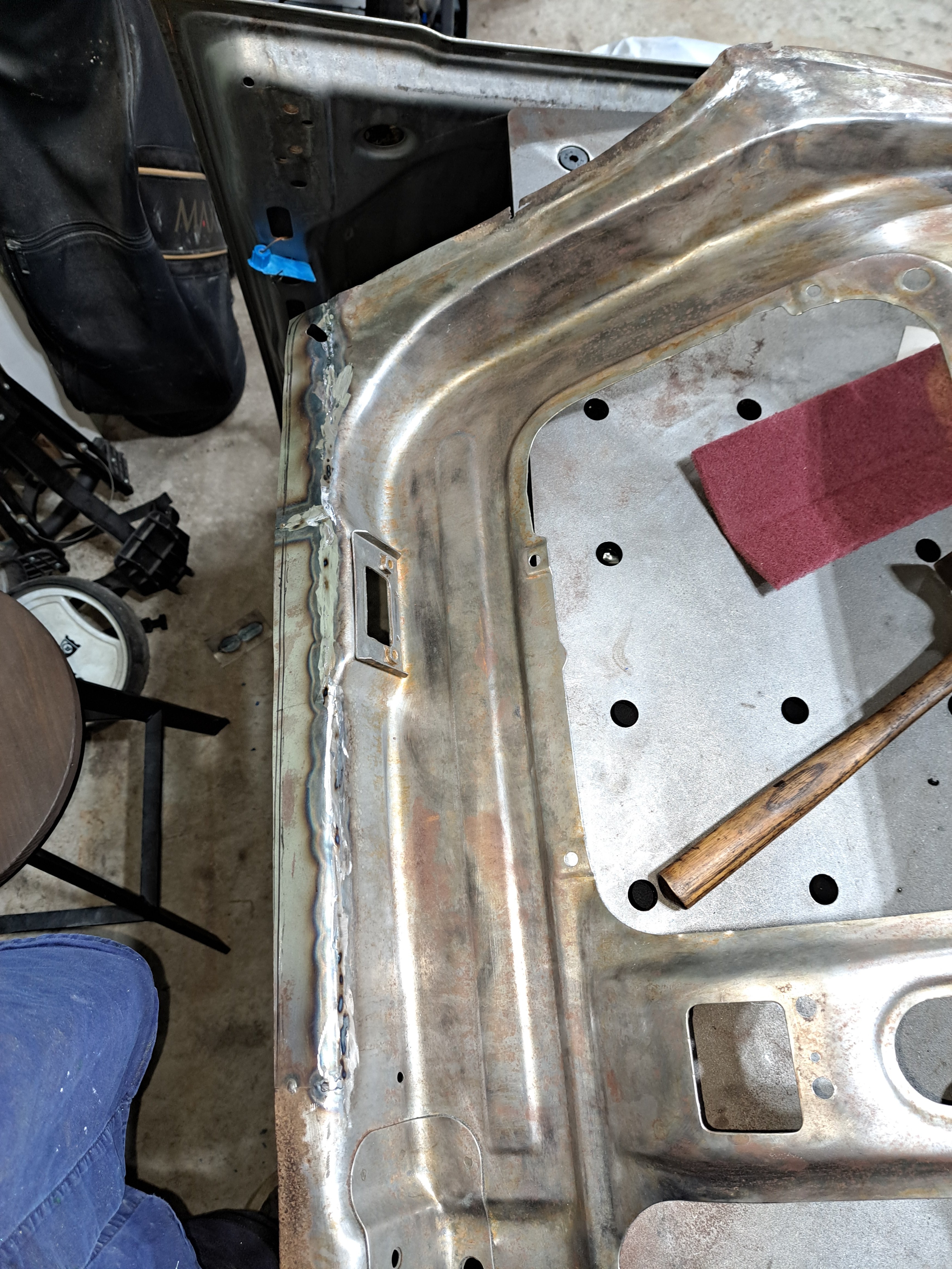

Well I took a clean template from the side I haven't touched yet before I started to weld the pieces in.
Once the measurements were taken I then grind flush the tacks and did my stitch weld process to minimise the heat in the panel
This is also a good time to get the hammer and dolly out to lightly tap the weld and release any tension that had built up.
Then I went back over and completed the weld
The finished product turned out ok, it was a bit funky welding at different angles as the replacement panel bent over curves. So my welding went a little astay in some sections.
But a little grinding to get everything flush and I will need to go over the whole thing and get the file finish I'm looking for. But the front turned out ok,
The back I'm still working on but you can see a little warping in the bottom of the panel, but I'll be cutting this but off anyhow.

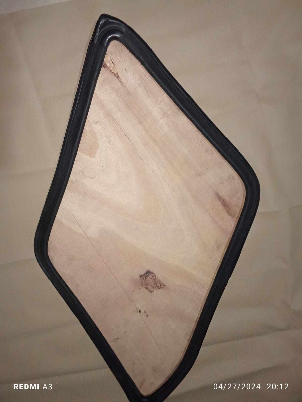

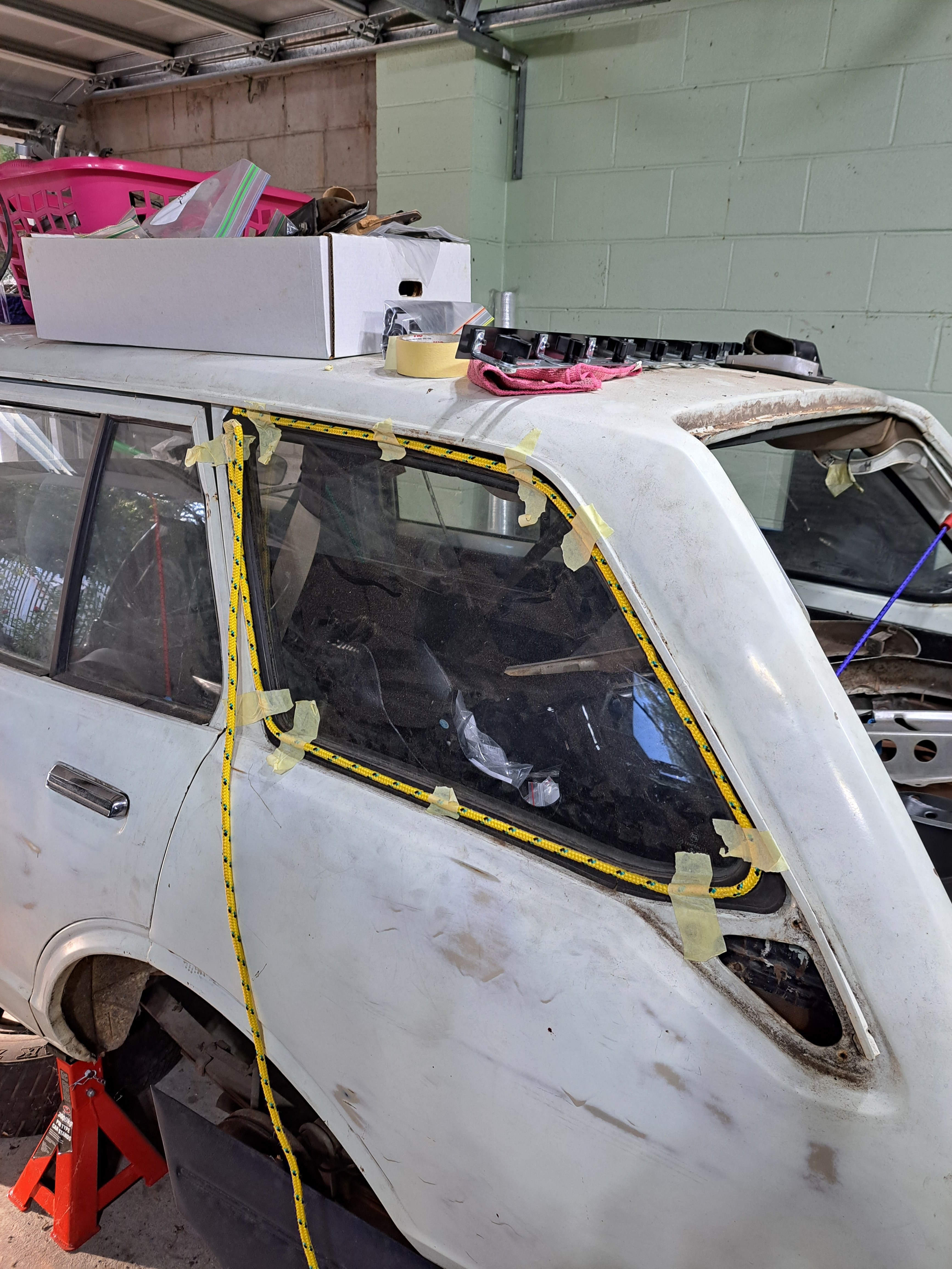

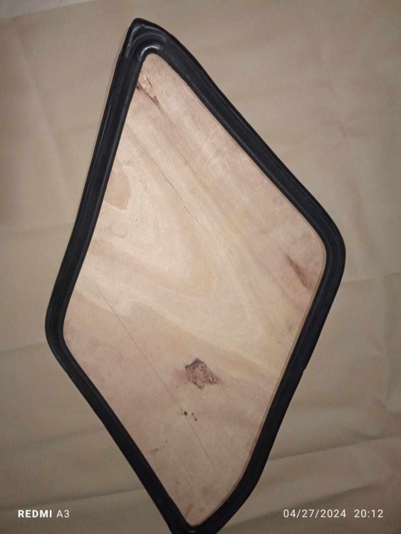

However I finally found someone willing to remake the rear quarter window seals.

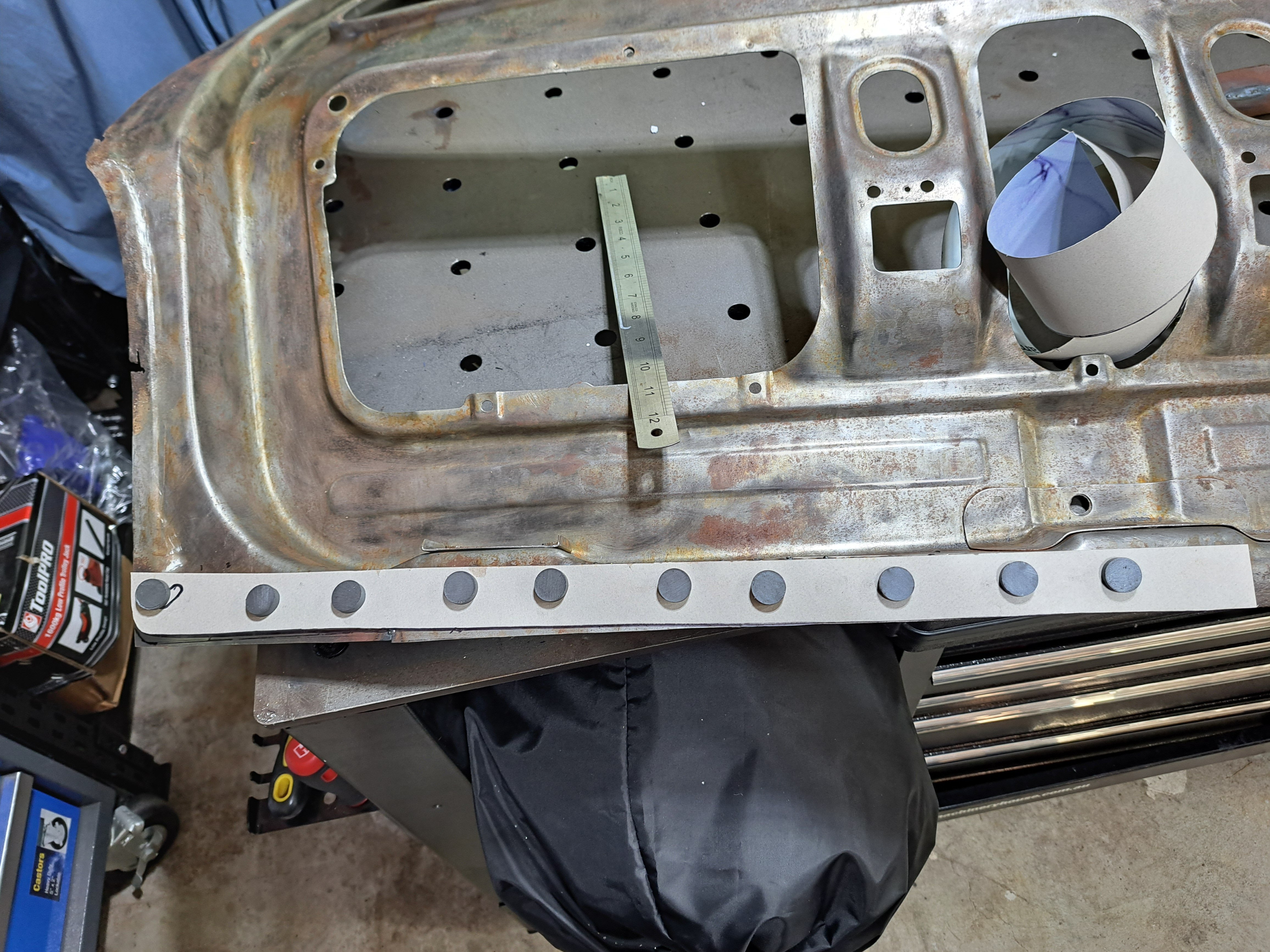

So using some rope in the locking channel, using that as a guide I took some basic measurements, lengths of each side, each angle and I even made a plywood template of the window.
But then I sent all those off and I eagerly awaited the results. The photos sent through looked good
So I now to remove the window and do a test fit when it arrives. If this works I'll order the same for the other side. Hope this works (insert gulp)
