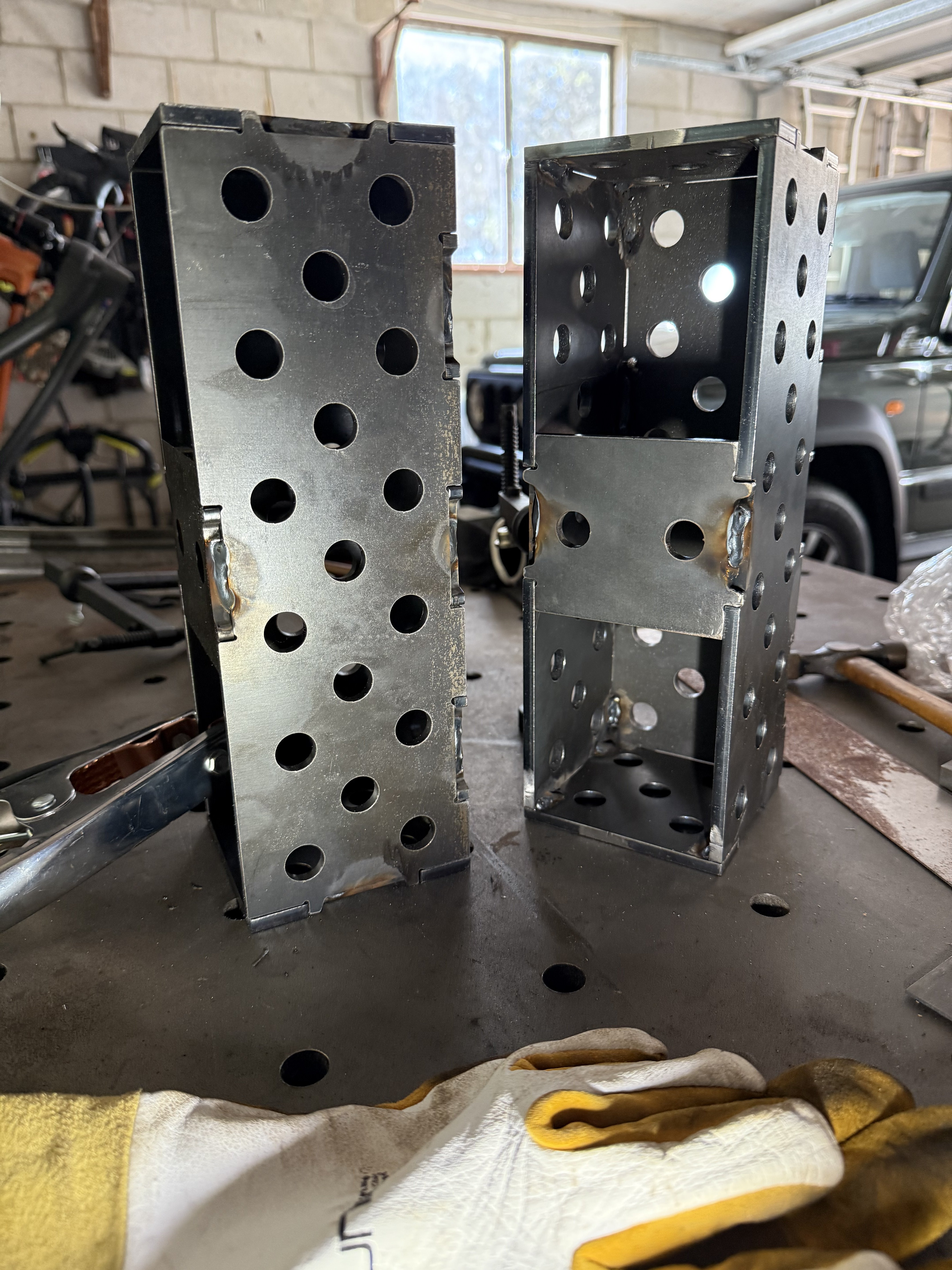

September 3, 20251 yr Author comment_738329 Sorry everyone following, life events took over and I didn’t find time to work on Kevin. But I’m back now, and to get back into the saddle I welded up some table blocks that will come in handy later i haven’t welded anything that thick before and so trying both inside and outside welds was an interesting experiment Report

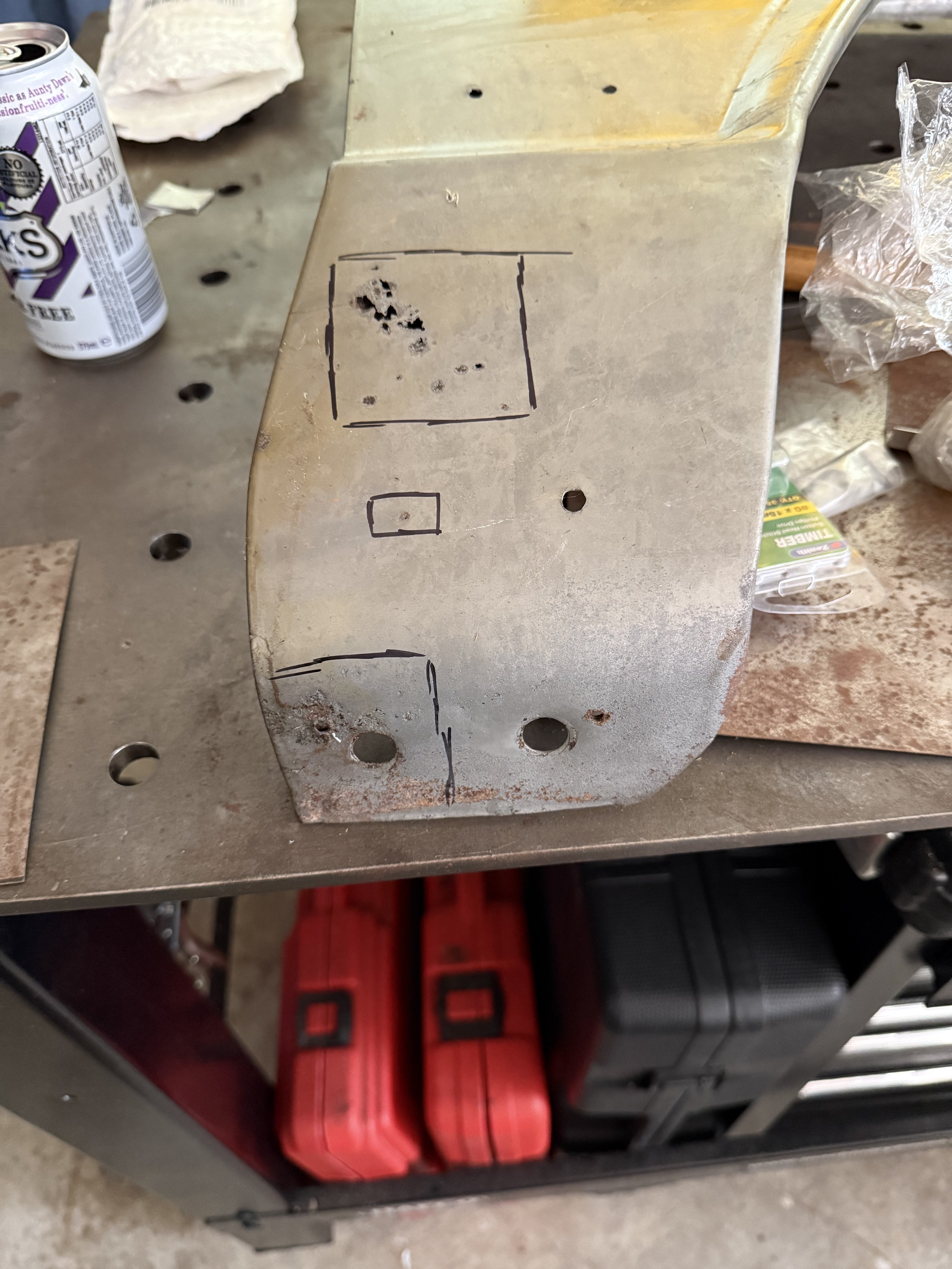

October 14Oct 14 Author comment_738752 Well life got in the way for a while, after losing both my parents I kind of lost motivation and many a project stopped. But I’ve decided to take a sabbatical from work and focus on the family and getting back to my old self.So that means… getting back to the front fender. When I left off I had removed the inner brace as when I cut out the slab rust patch I could see there was much rust back there.So I took the strip wheel to the brace and found some pin holes that also needed mending.And the top of the brace had rusted so that got some treatment tooBut after looking at the bottom section of the fender I think I will just cut the bottom off and remake it. It’s heavily corroded and the 0.8mm steel will be paper thin by the time I clean it up Report

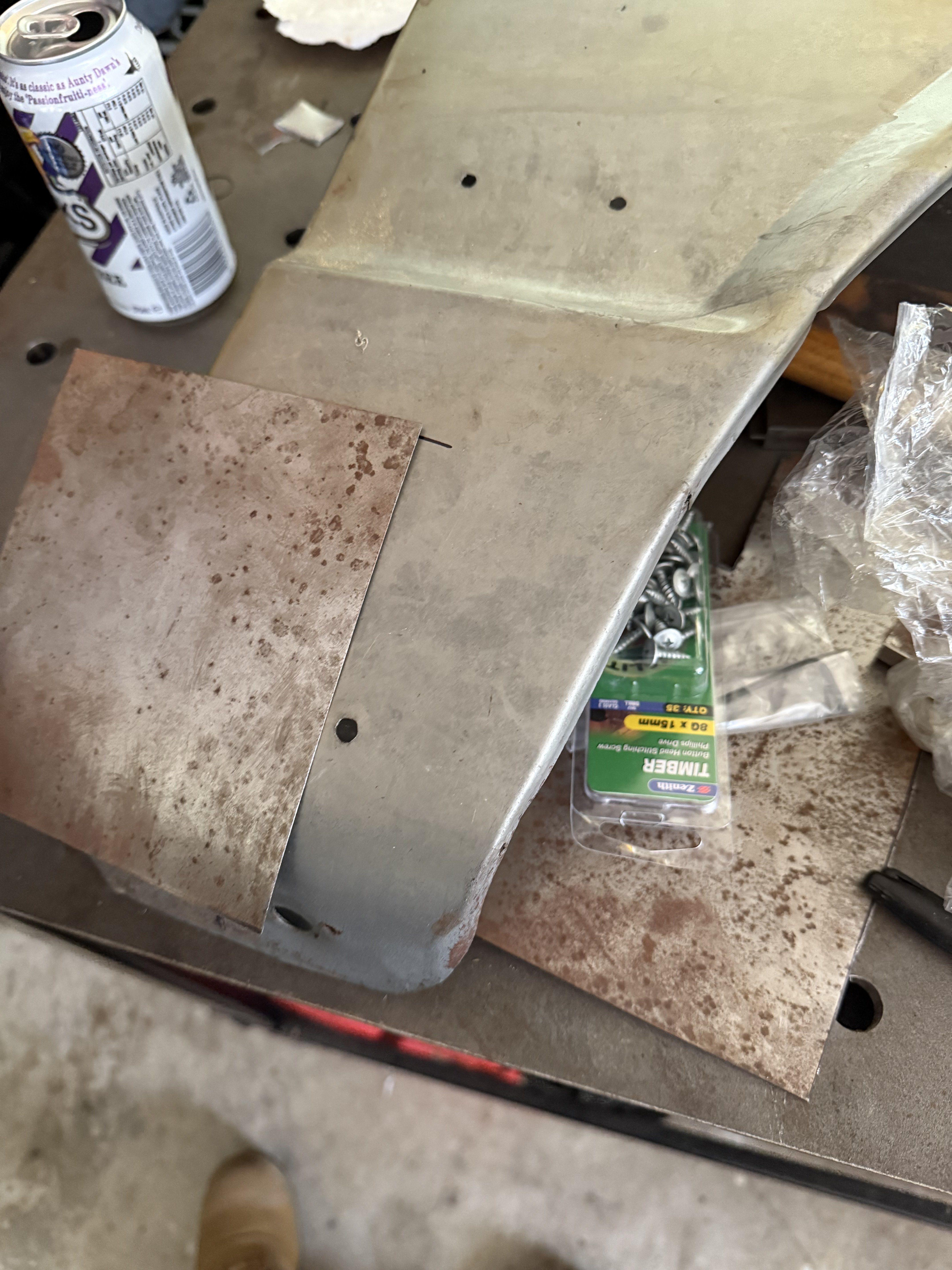

November 6Nov 6 Author comment_738765 So I started the new patch panel in the same manner as always. Start with cardboard templateThen make it out of something a little harder, and start fettling. For some reason my fettling is taking a very long time. i had to manually put the bend in, so i used the handle of a hammer but i put it in the wrong spot. So straighten and realign. then bending the corners I just lost focus and they are a little wonky but nothing some time with a hammer can’t fix.So after a good while I feel like I’m getting close. With the brace held back in place with clamps things seem to mostly line up at the back.Then looking from the front I am fairly close, I still need to trim off the extra material I left but I will continue to fettle Report
