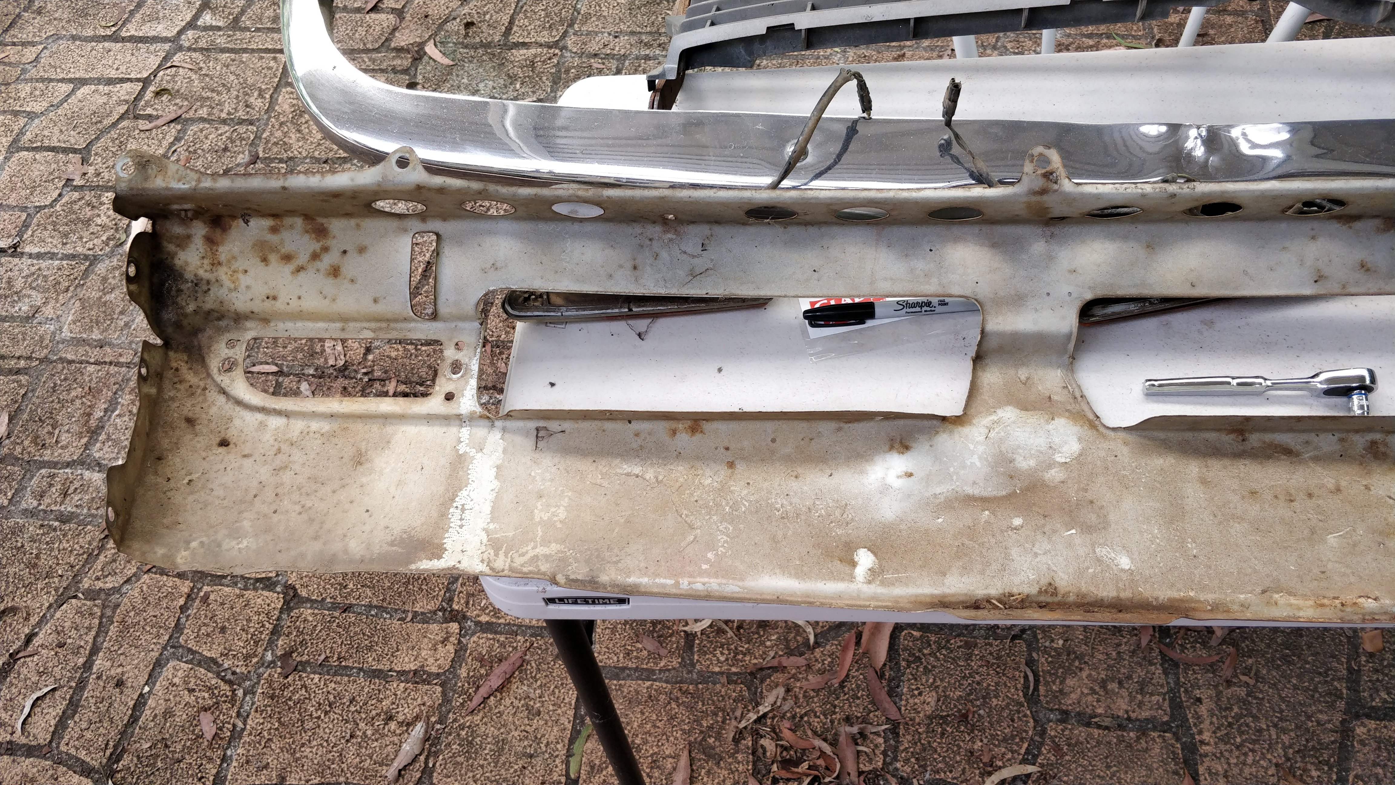

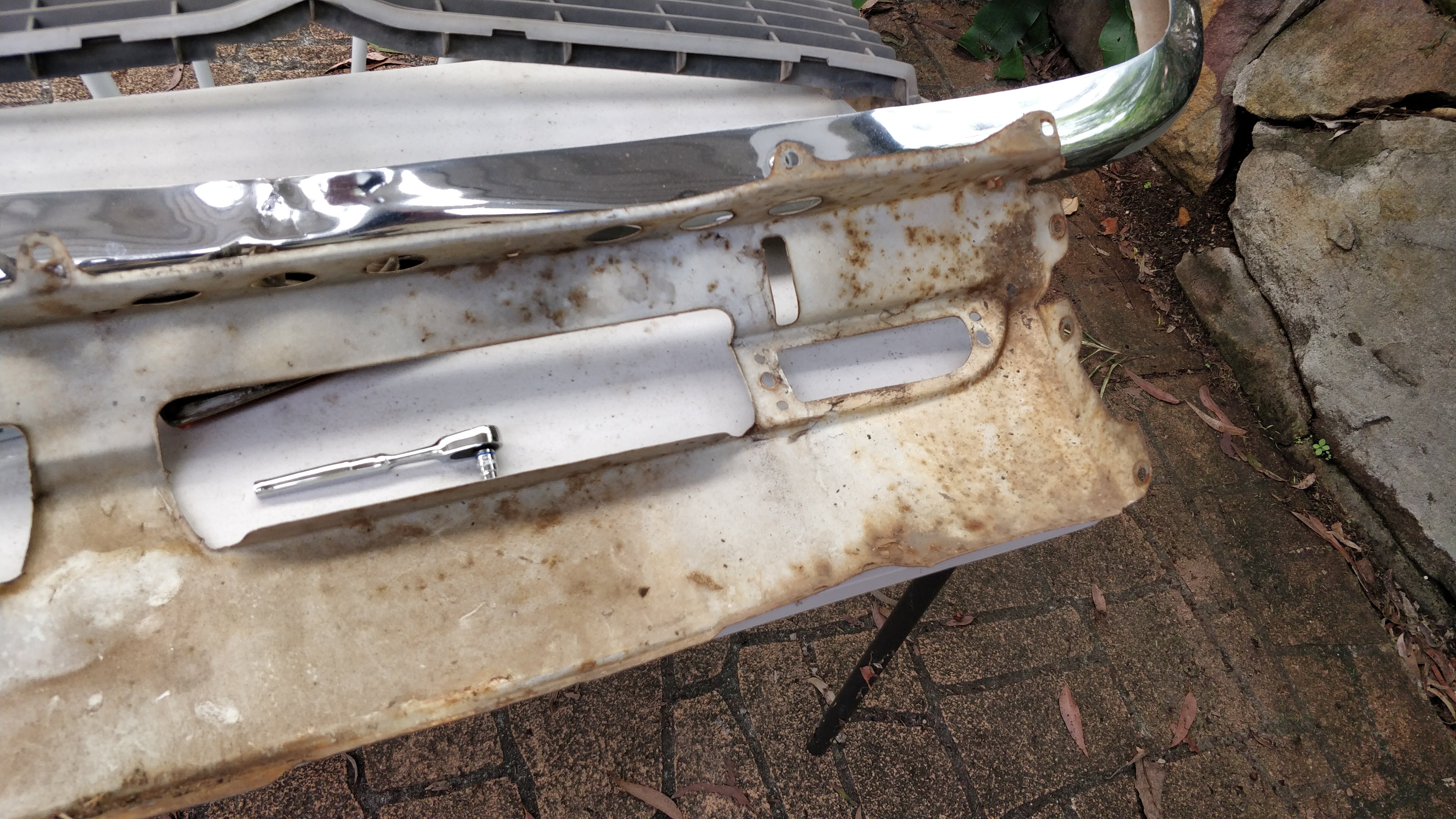

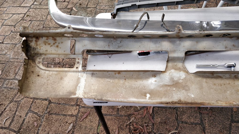

So I started on the front apron, I can see that it is also a victim of an accident
There are some other tears in the edges of the metal where it has stretched.

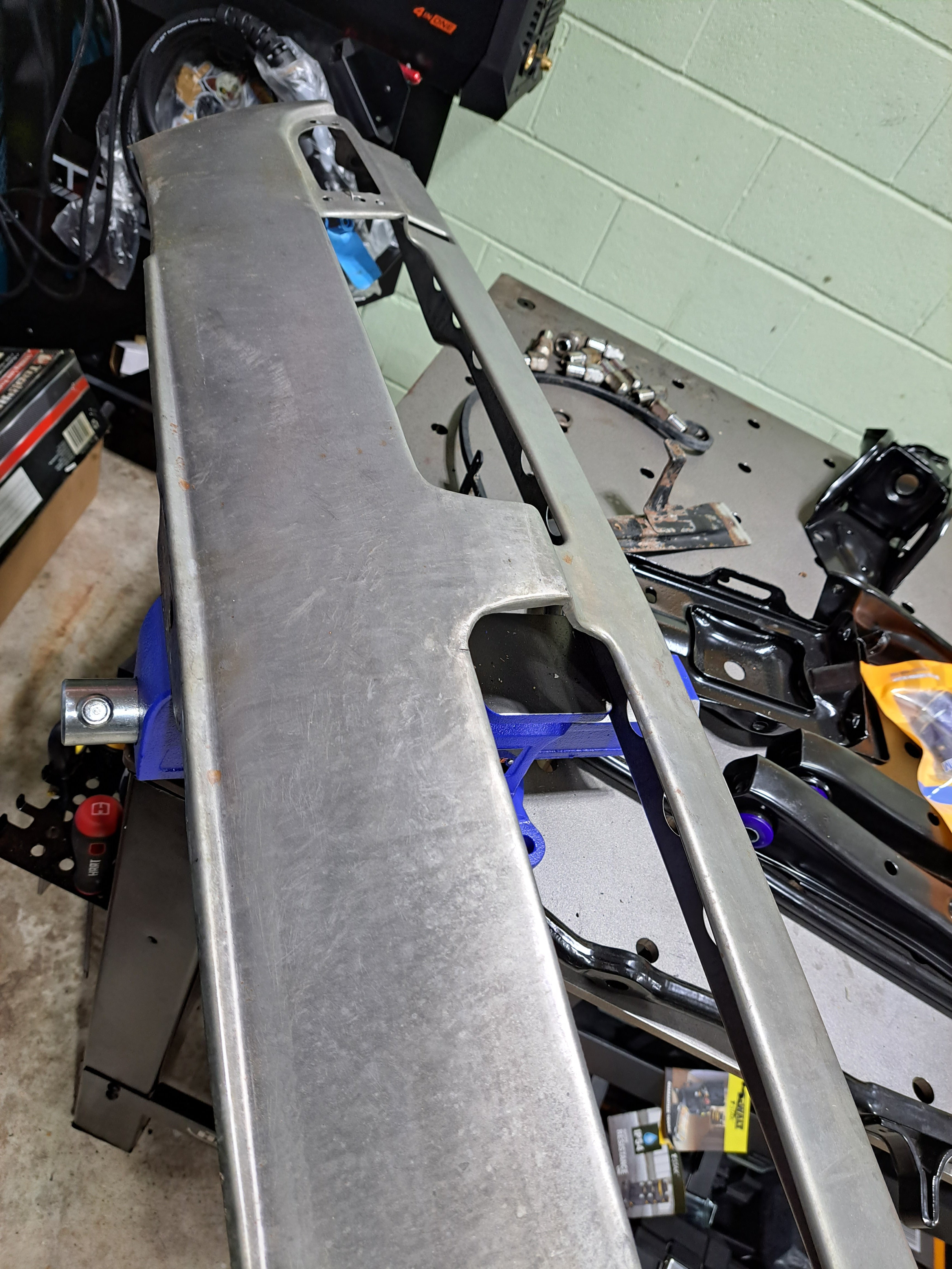

So I sent it to be dipped to remove the paint so I can at least make progress here.
So after some paint removal and a little time with the hammer and dolly the main damage is mostly repaired. I'll hit it with the body file and get it perfectly smooth.
However before that I will need to weld up the tears in the edges of the metal

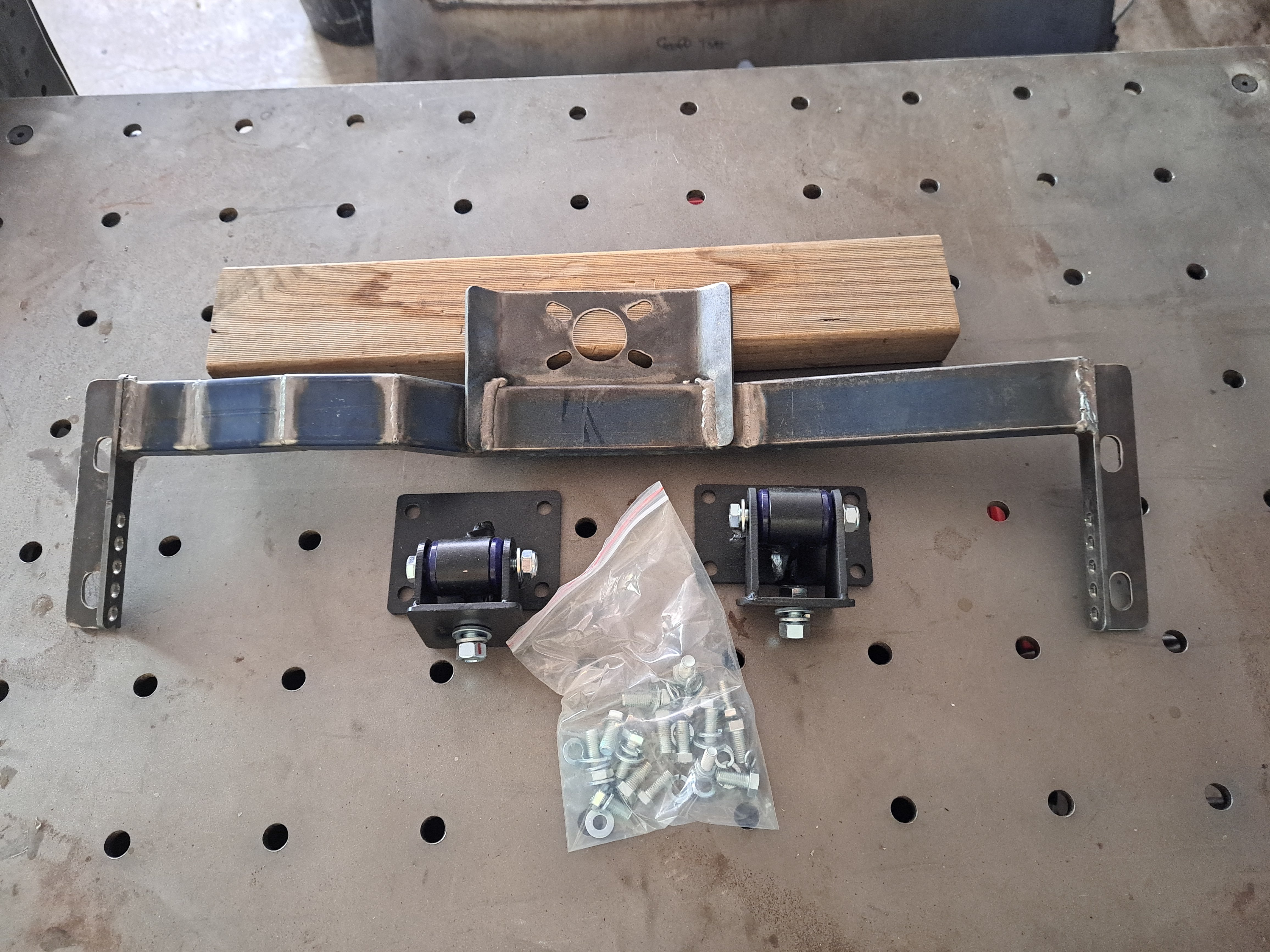

I ordered the 3rz engine and transmission kit from ke conversions. So I started refitting some of the steering components and the sway bar to make sure things clear when I do get arround to fitting the engine.
I think the 3rz might be too big for the little rolla. But the 2rz could be a better match, physically a bit smaller and so might package a little better. Apparently they use the same mounts, but I guess only time will tell

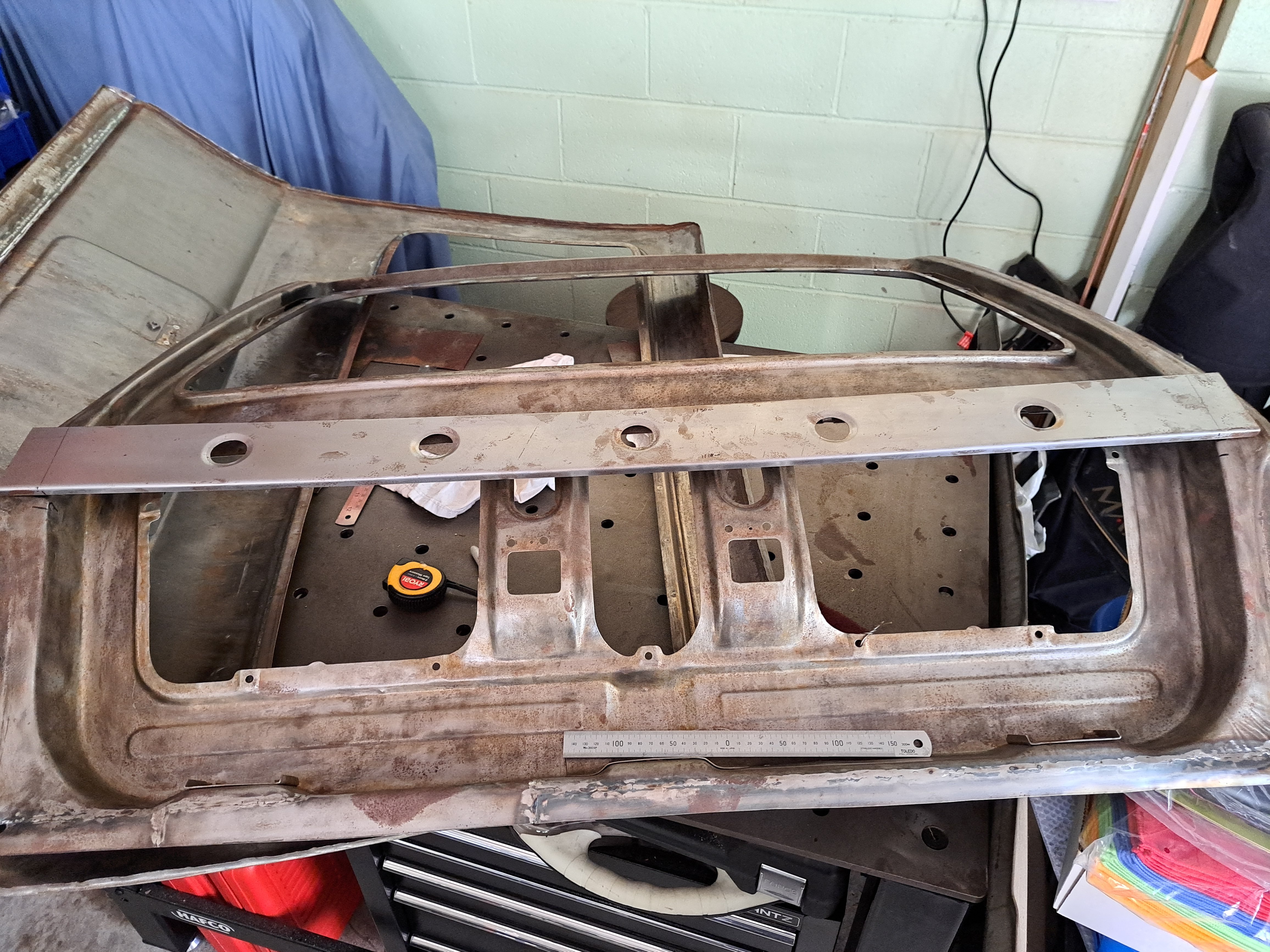

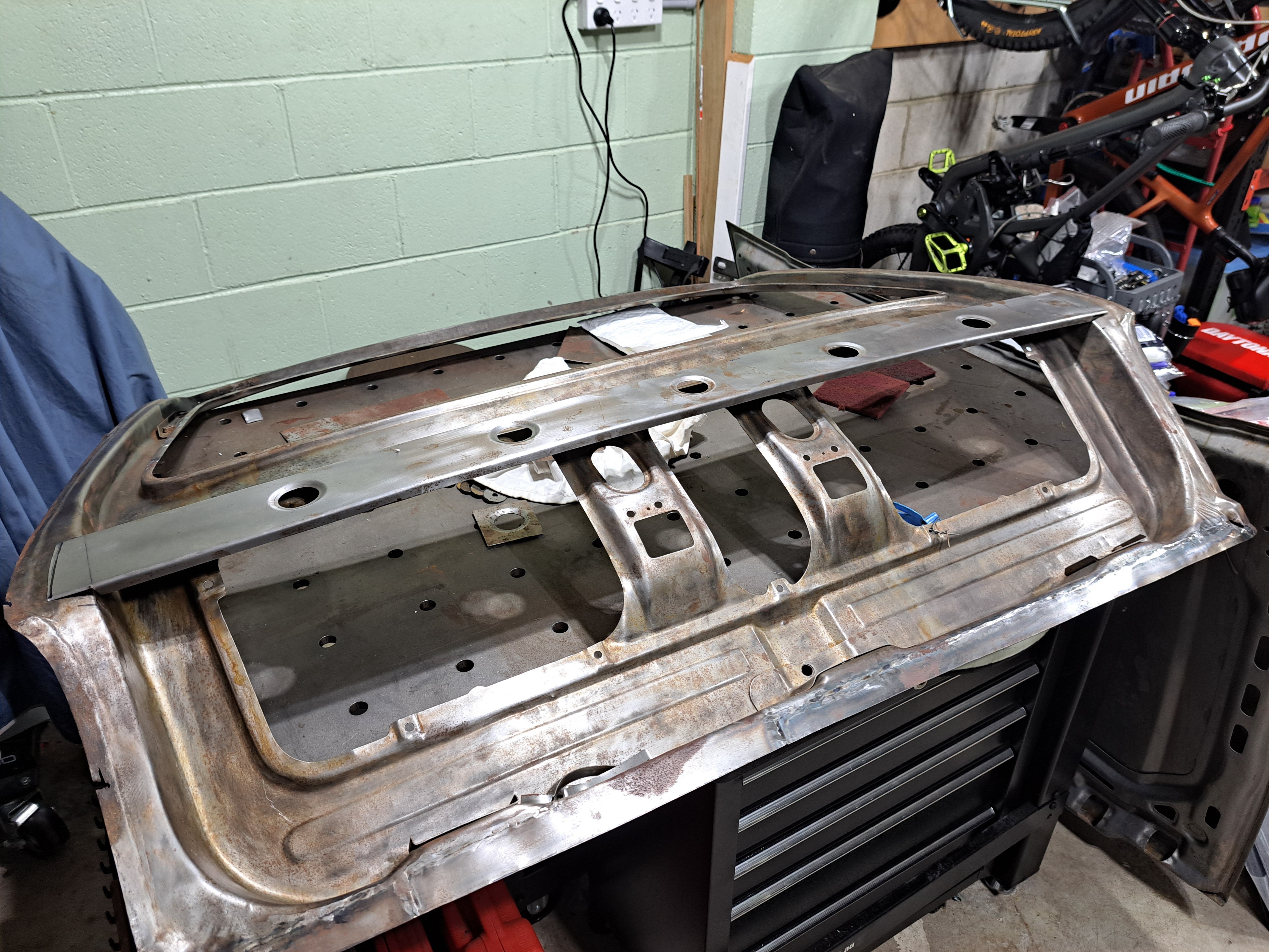

But I also started on a brace for the rear hatch, because there was so much damage and I have also repaired the frame I'm worried it might have lost some strength.

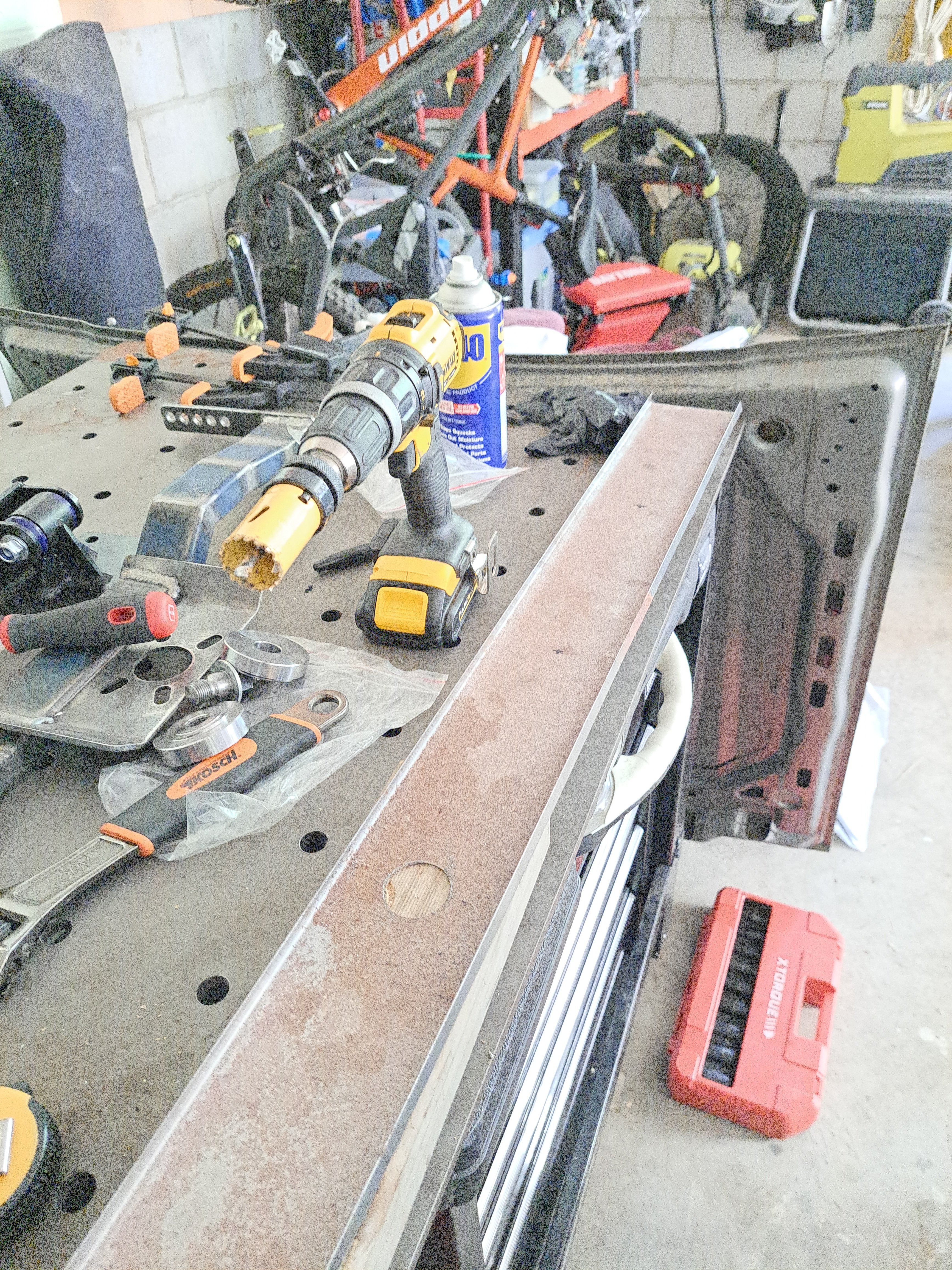

So I used the workshop to cut a strip of steel and bend up some edges.
At first I put a hole right in the middle for the lock to go through
Edited by wenisman

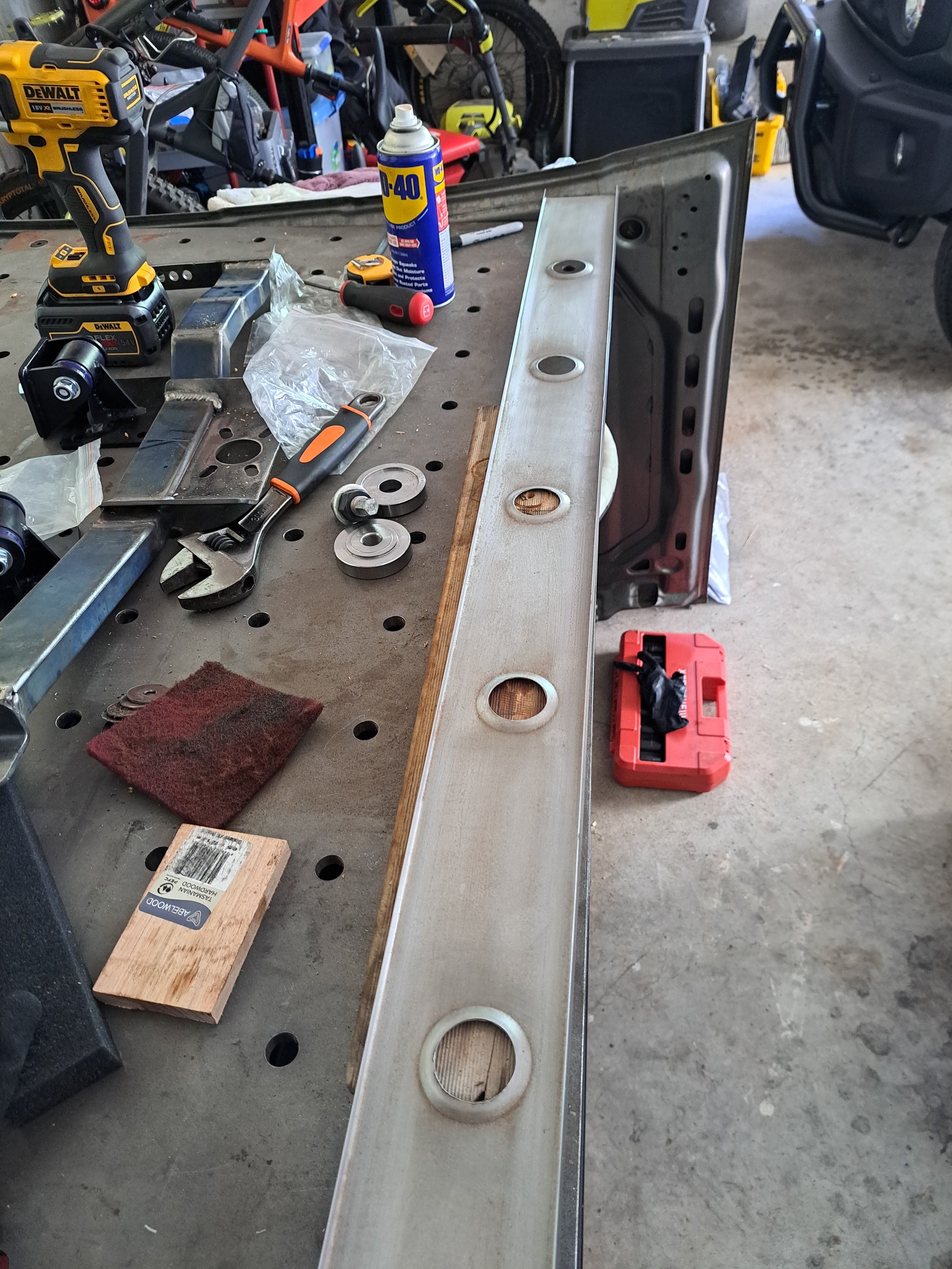

But I picked up some stepped flange dies that use the draw stud. So I went about adding some more strength to the brace
I'll bend up the ends when I'm convinced of it's placement as I needs to clear the center lock.
I was thinking of putting a rear windscreen wiper in using the brace but I don't think it would work. From the few I tried they just wouldn't fit in the frame with the brace, motor for wiper, water lines etc
Edited by wenisman
"I picked up some stepped flange dies"
Aren't they clever! We use dimple dies a lot for the gussets and panels in roll cages, they make the same shape using a press, and they take the flex out of a flat panel.
The step fange die is great, just means I can do a dimple die at home with hand tools. It was funny even with the edges turned up there was a bit of flex, but with the dimple dies the brace is now rock solid.
It might just be me, but I found using an impact wrench to tighten down made the dies slip and so the dimple works end up off center (by a lot).  So I sprayed both sides of the metal with wd40 and manually wrenched down the dies to get good alignment. But you still need the impact for that last little bit just so you don't put pressure on the panel trying to hold it

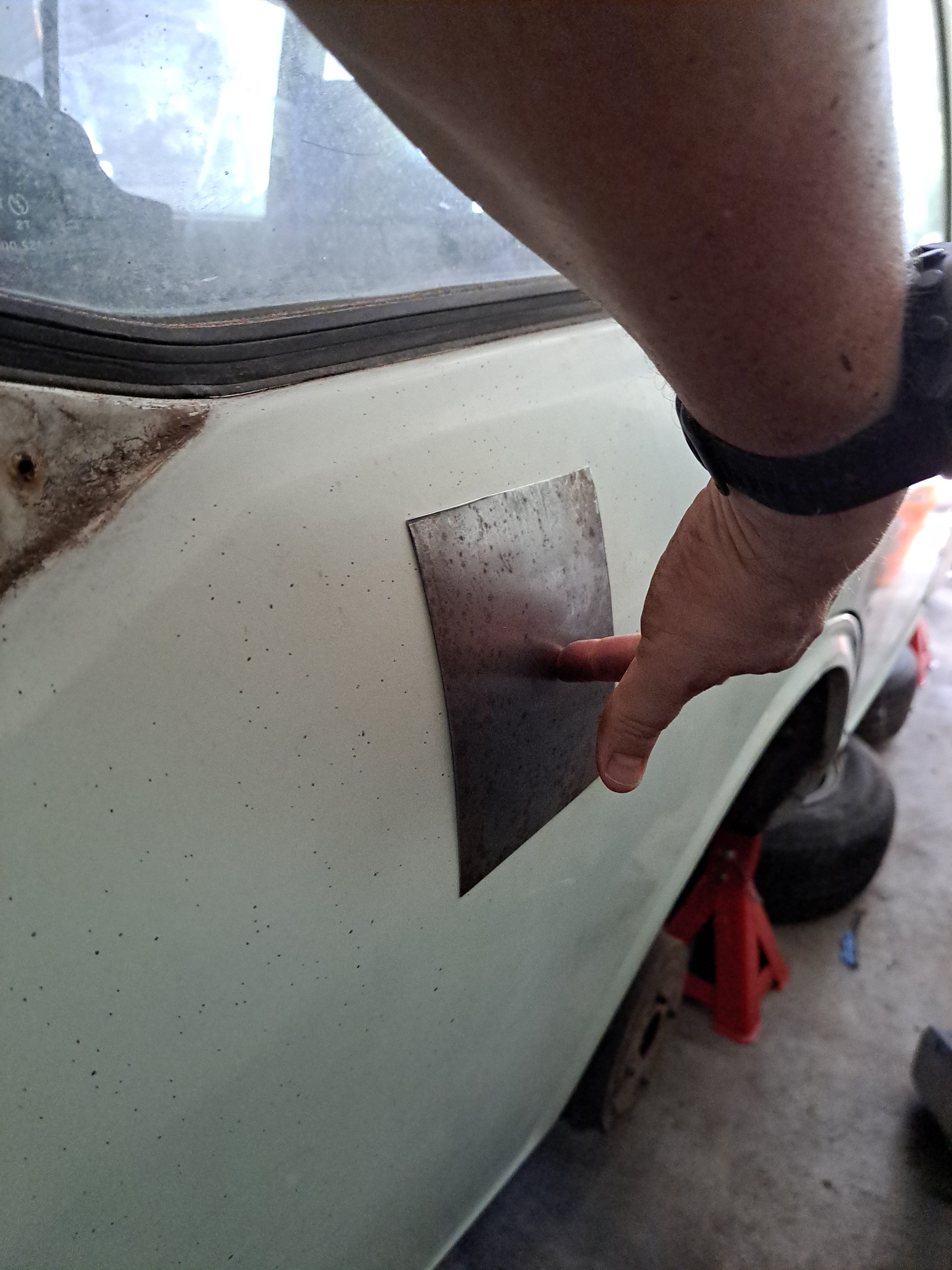

Well I said I started on a few side projects over Xmas, so the first was tinkering to get myself an fuel flap. Whilst I'm not sure how it will actually function, I continued on in blind faith and ignorance. So a small square was cut, and put through my mini English wheel. Wheeling in one direction gives the curve in the panel.
So I cut some 50mm discs from 1.5mm steel, I might need a slightly larger disc but I didn't have a bigger hole saw. The hole for the fuel flap is 60mm, so with the door skin I have a fuel flap of 52mm which leaves 4mm gap all round. I might weld a small wire around the edge of the disc if I want to reduce that gap.
However one disc is for the base to hold it too the car, the second is to hold the flap skin. So I'll just the hole saw to cut the centre out.
Right now id be happy to just have it held closed with magnets. It's really just to hide the fuel cap, as long as it looks online with the rest of the body on the car

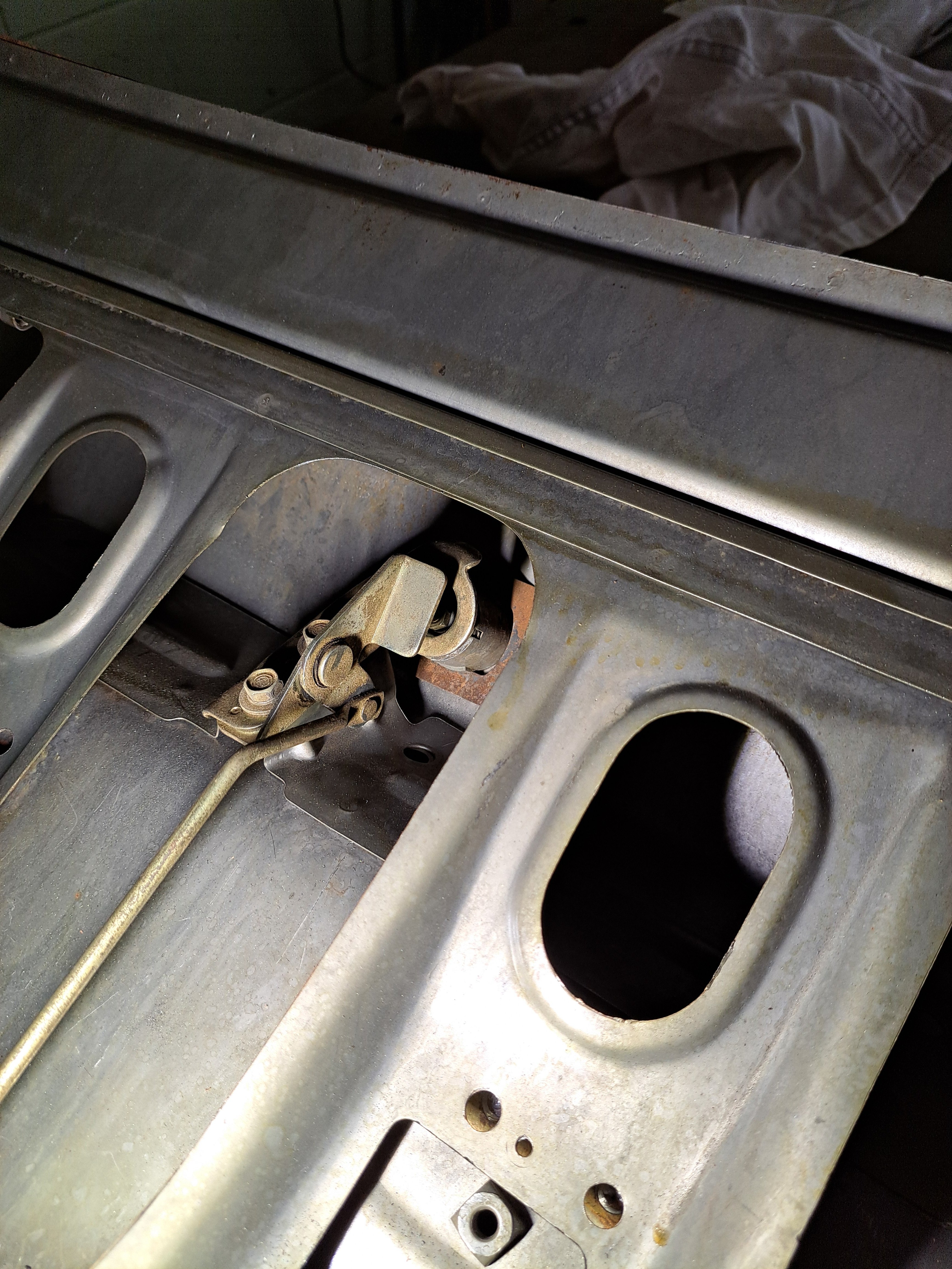

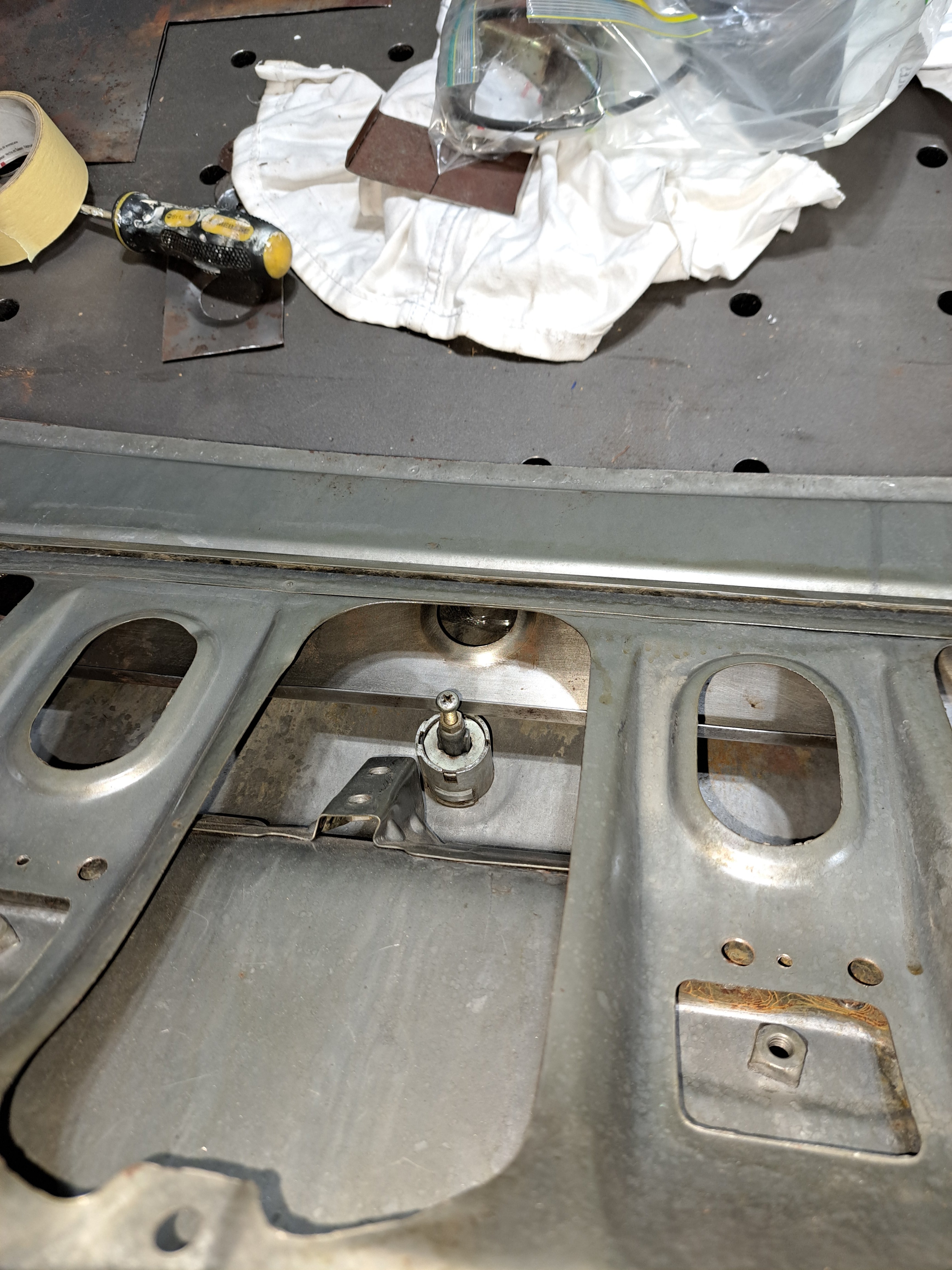

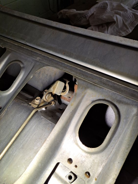

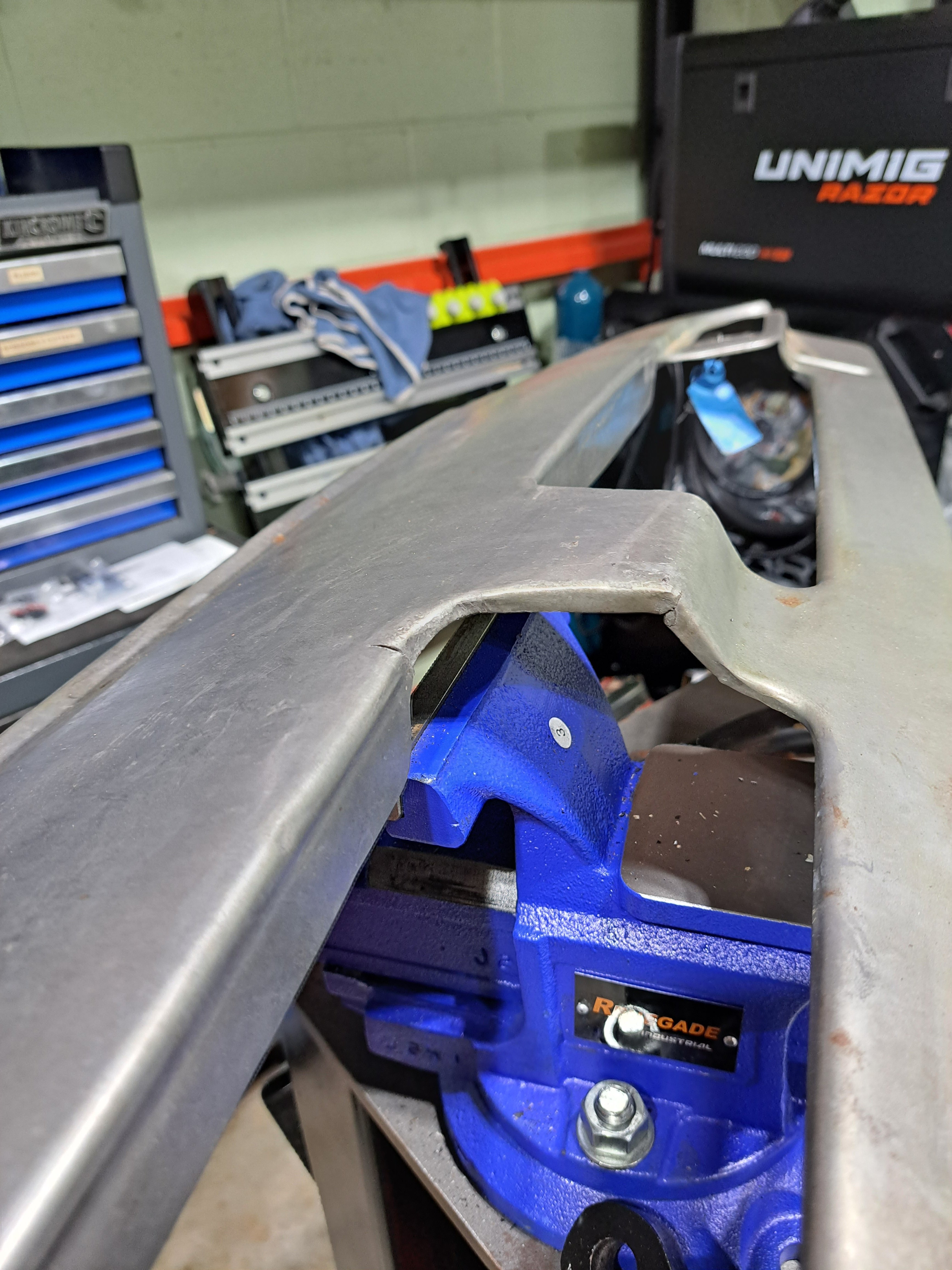

Well my conundrums continue and my procrastination continues with it. I put the lock back in the rear hatch so I can take some measurements for locating this brace.
there is plenty of room between the outer skin and one inner frame. The issue is the budget that holds the lever.
I think I can modify the brace so that it ties into the same bolt holes for the brace. It would make it nice and strong and give me a place for he central locking mechanism.
The idea for the central locking is to have a small latch rotate and then block the lever from being pressed.
My issue is that the brace is contacting the inner frame, I have started putting some shrinks on the edge to give it a curve.
With the brace being straight you can see how curved the rear hatch is.
So a little shrinking on the edge flange between the dimple die has put a nice curve on the brace and it matches the frame
Edited by wenisman
So I had to keep moving the brace around to clear the lock, pushing it up higher in the frame seems to work. But I will still need to put a relief into the brace for the latch mechanism.
It is tight in there But as they say, "clearance is clearance". So I have trimmed the ends of the brace, I will bend them over, weld and make a solid right angle. Then I can spot weld it onto the frame, but first, more repairs to the frame edge
