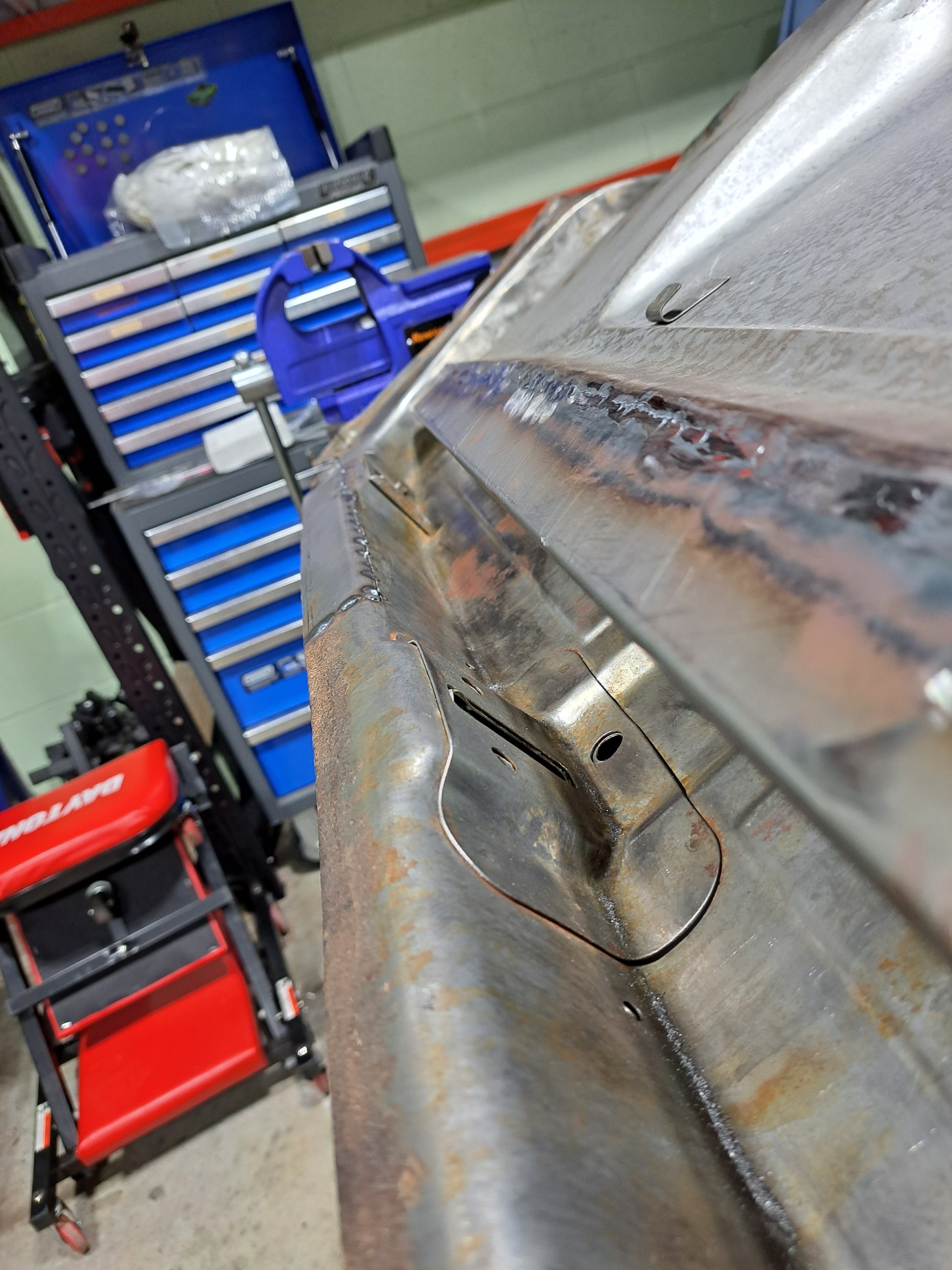

There are still some sections that are very thin, even after welding. So along the edge of the window sill I started grinding out the thin material
Then a very small patch was made, using my rudimentary tools but it looks like it will do the task.

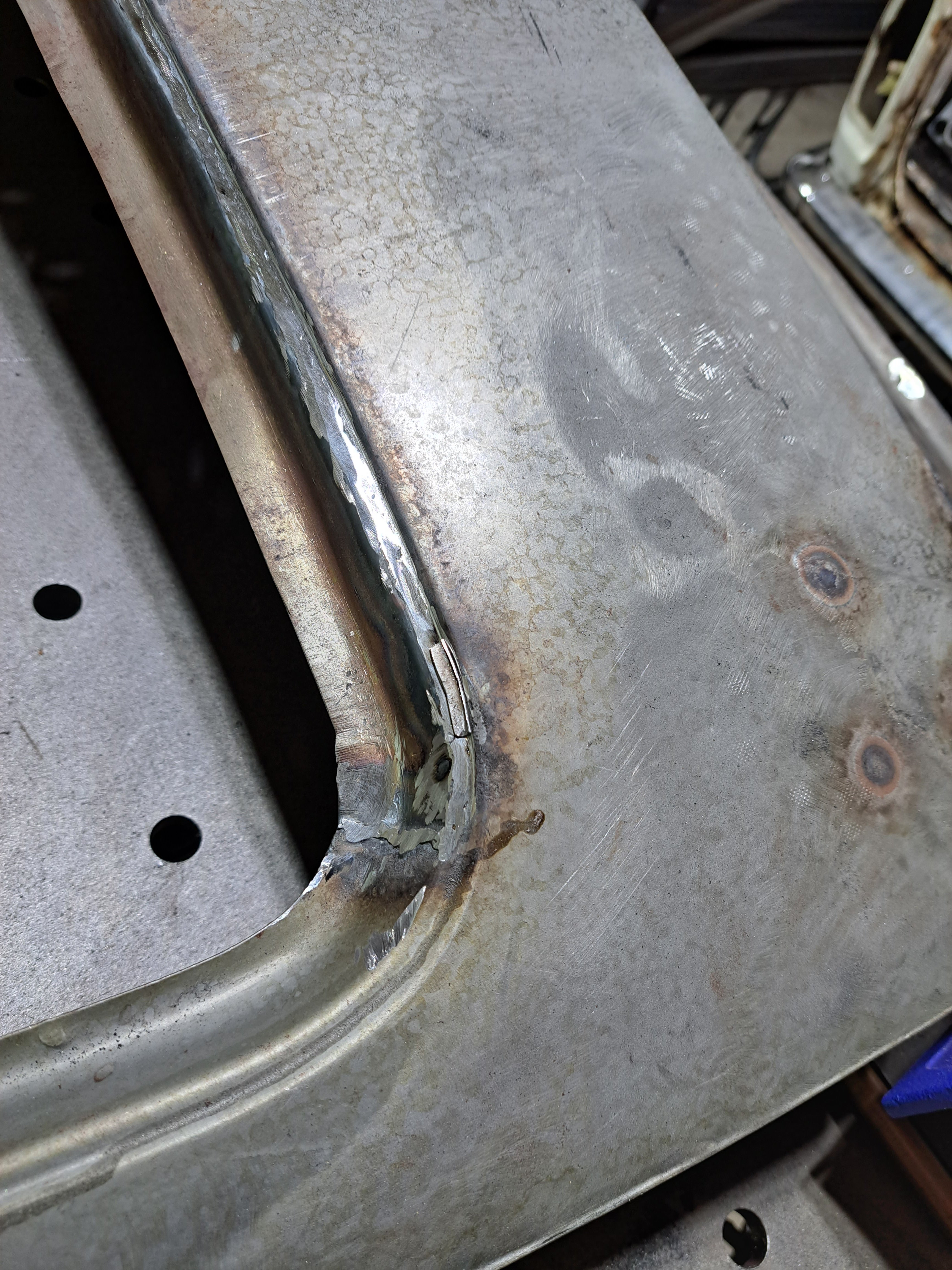

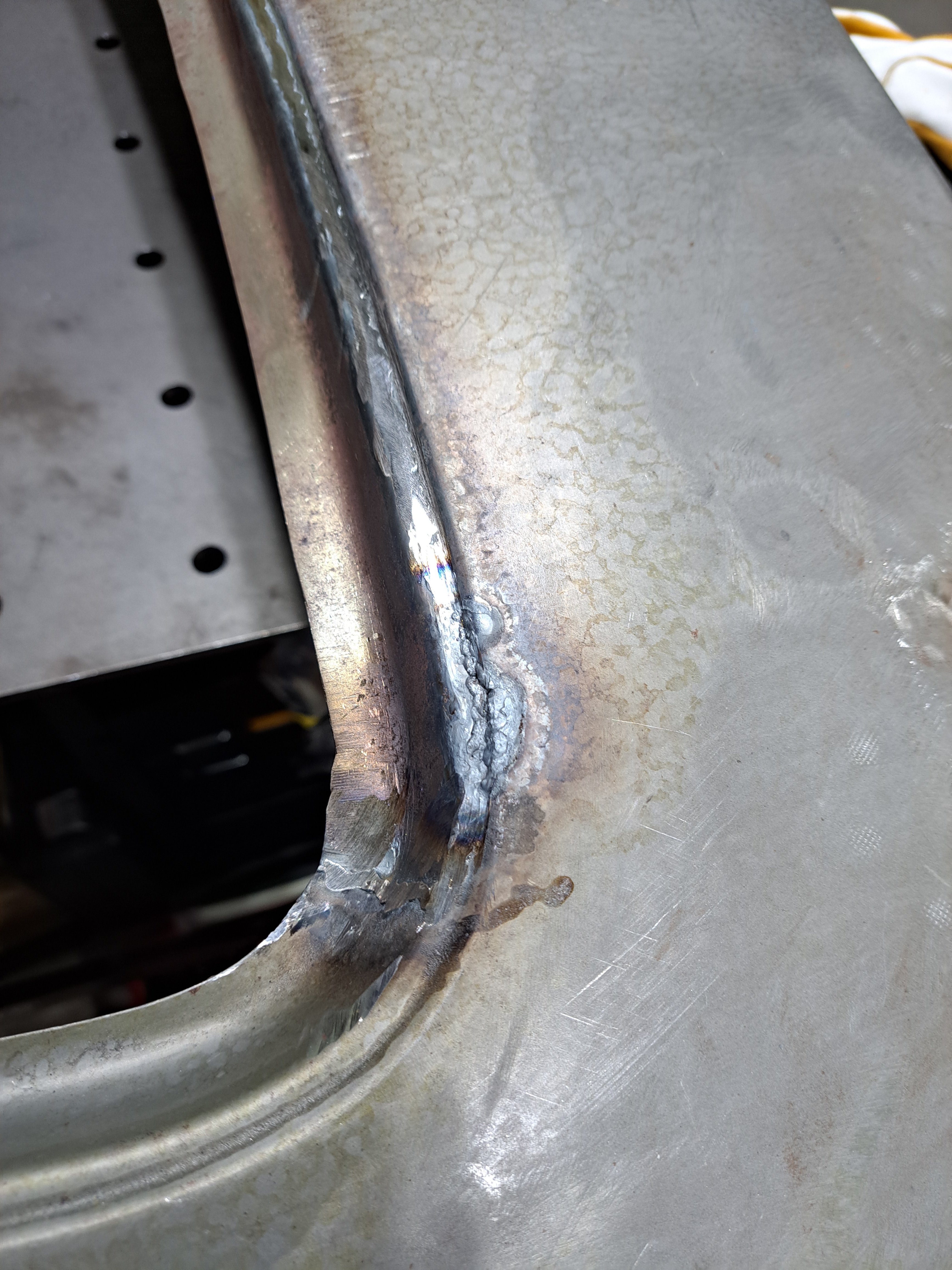

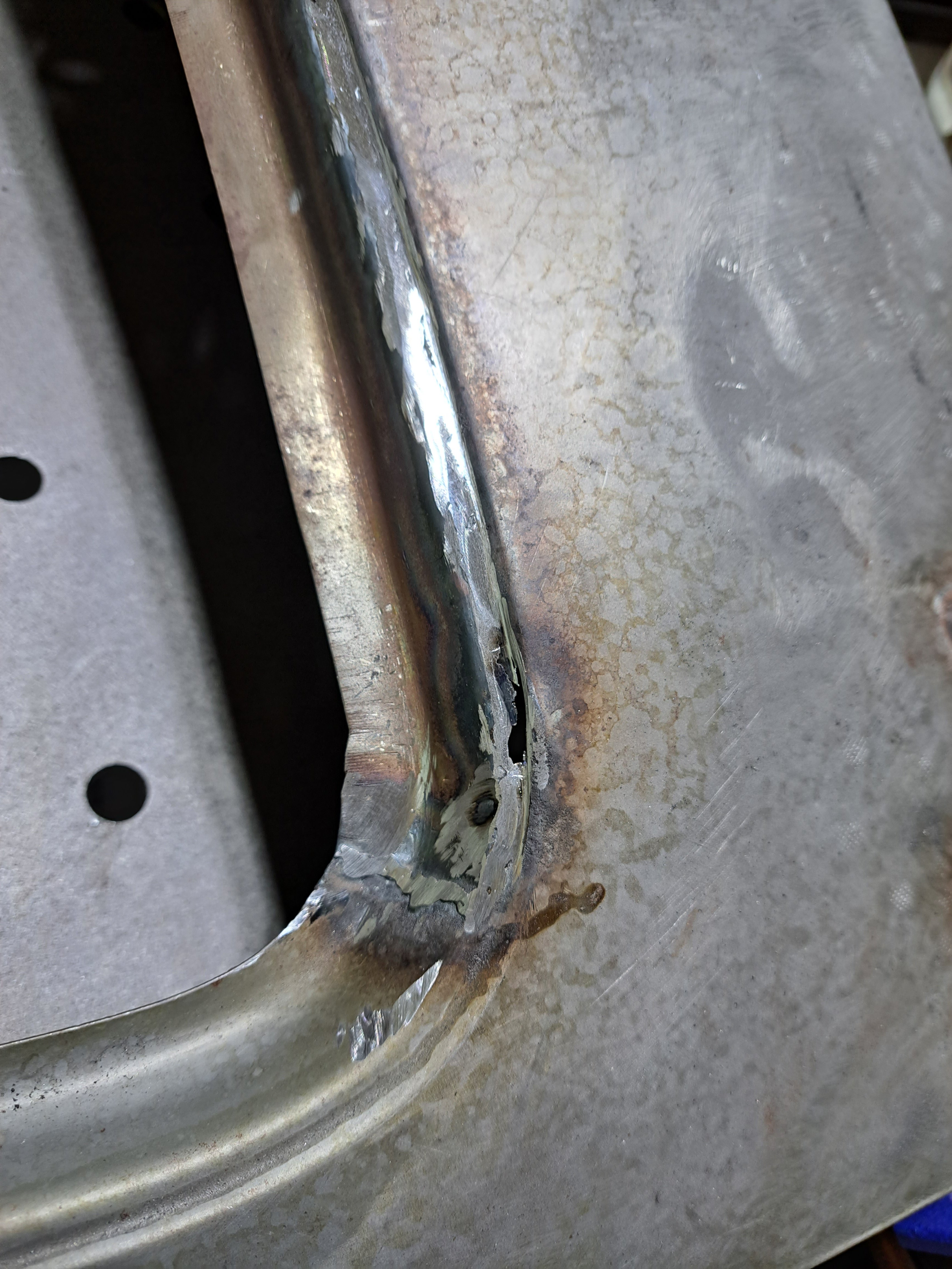

So I decided to weld the hole in the window sill with mixed results. But it was better than trying to hold the small peice in place as it would have just melted away.
But once it was linished back it looked reasonable

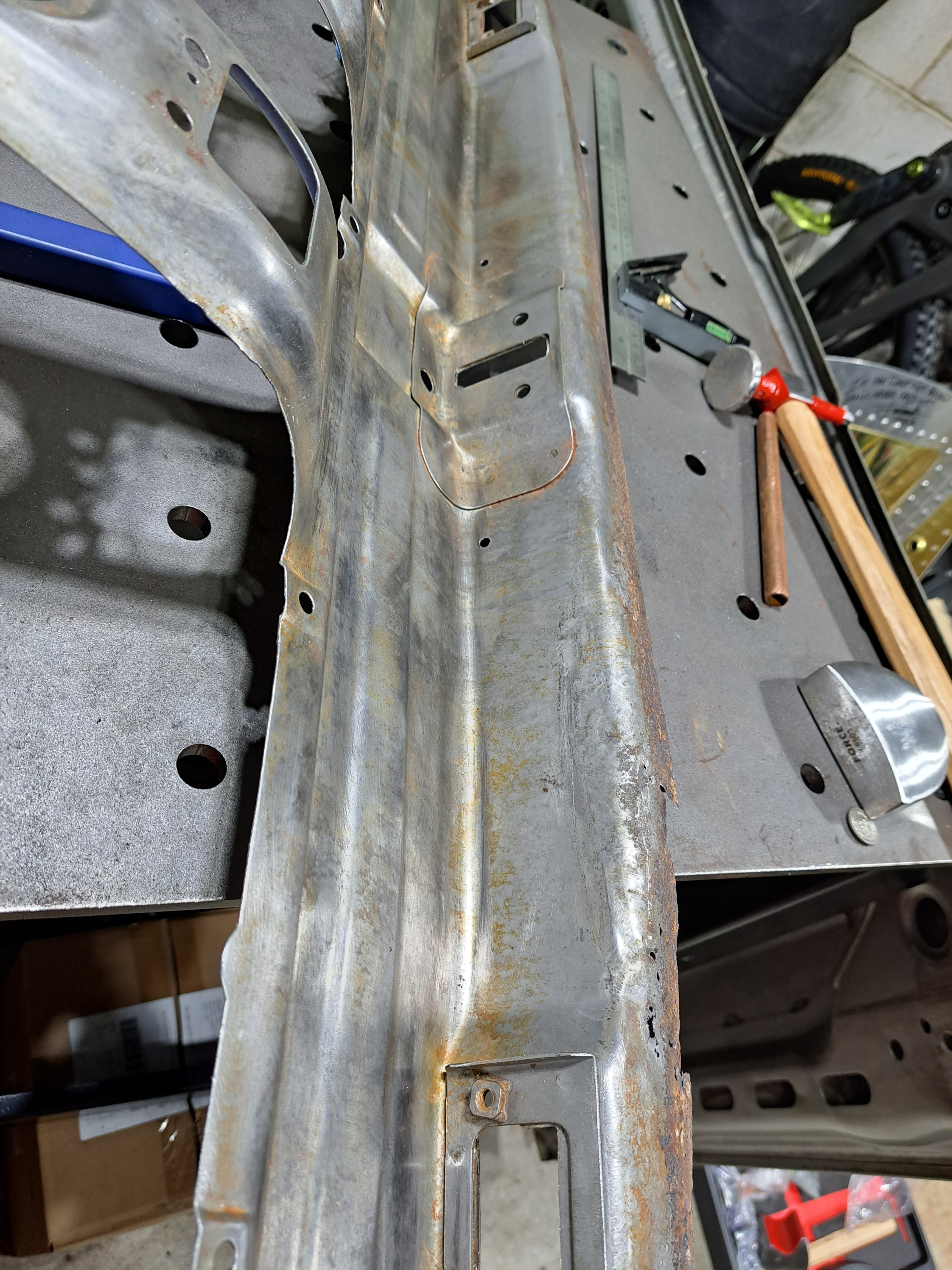

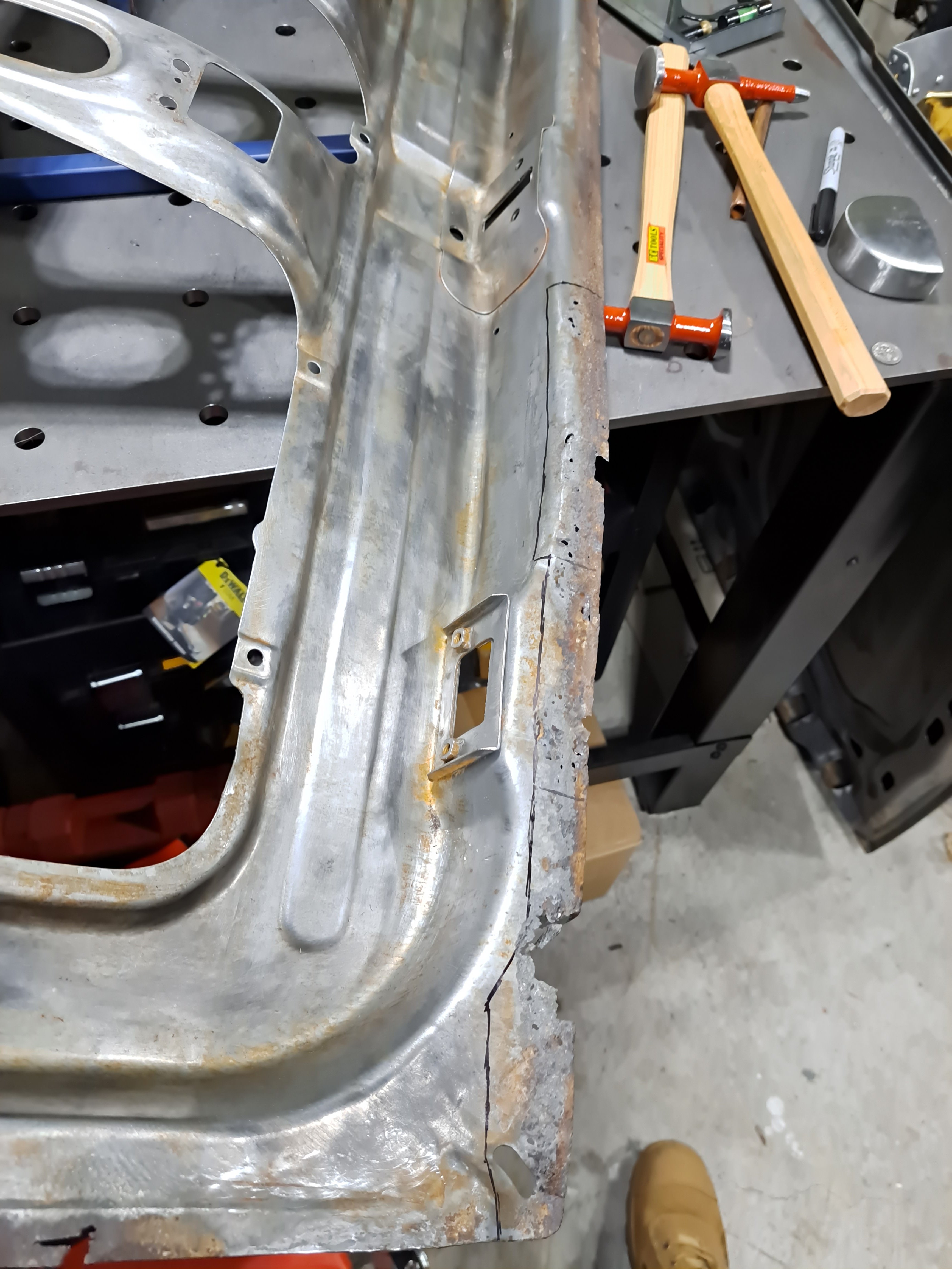

I then decided to try and straighten the frame... it's been a small odyssey. I started with the bottom. You can see the crease mark to where it was originally pushed into. I have had to massage it a long way out but the metal is literally falling apart
So I marked out a battle plan on what peices I need to remake for that bottom section. You can see where chunks of metal literally broke off the bottom.

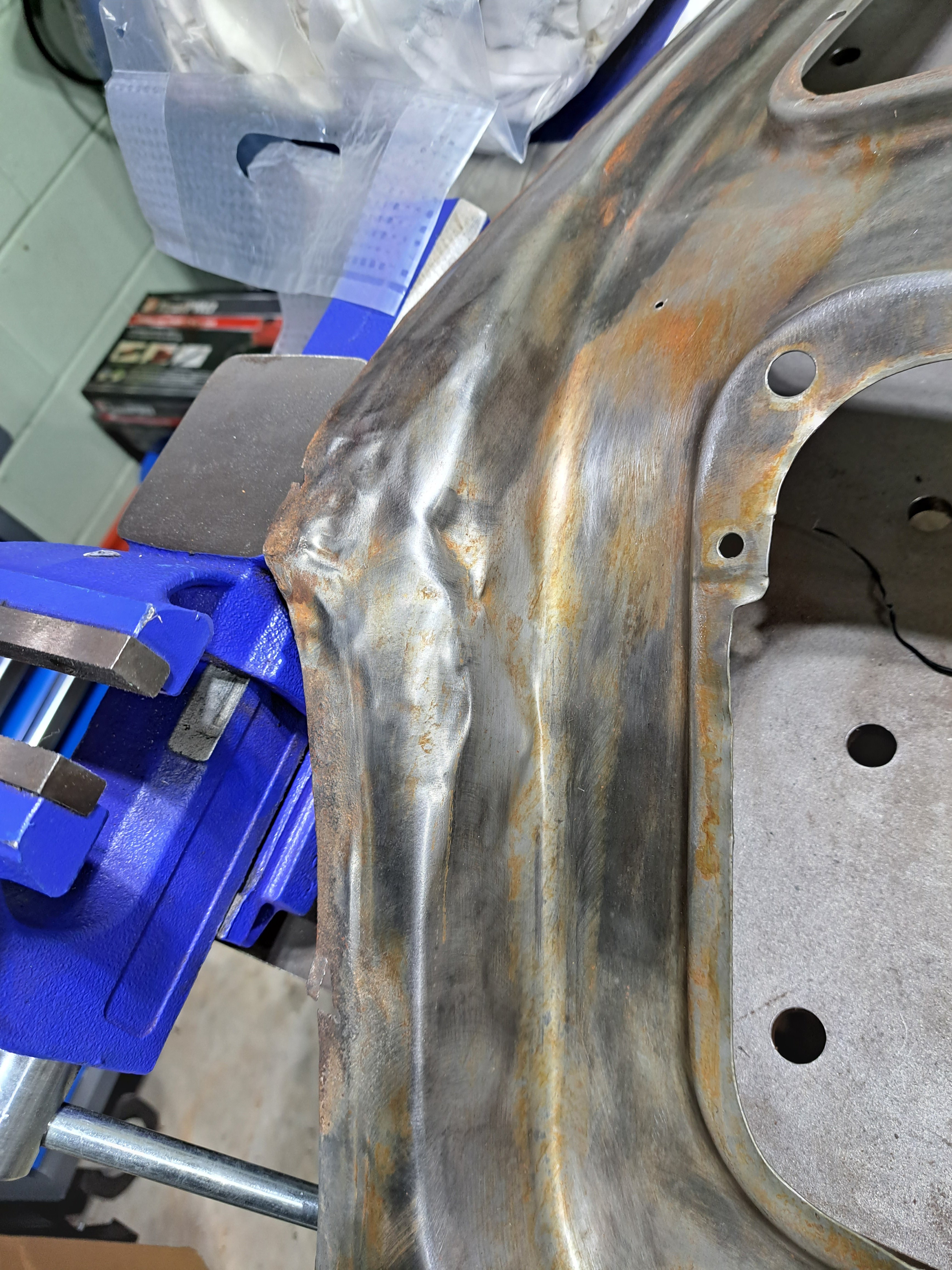

So I started on the side of the frame which was also buckled. When I painted stripped it I could see that the original repair had just welded the frame to the skin as the two were different sizes.
After a little work it was at least the right size again.
And then a bit more hammer and dolly work and it's looking mostly back in line
I also straightened out the crease a little further up whilst I was at it.

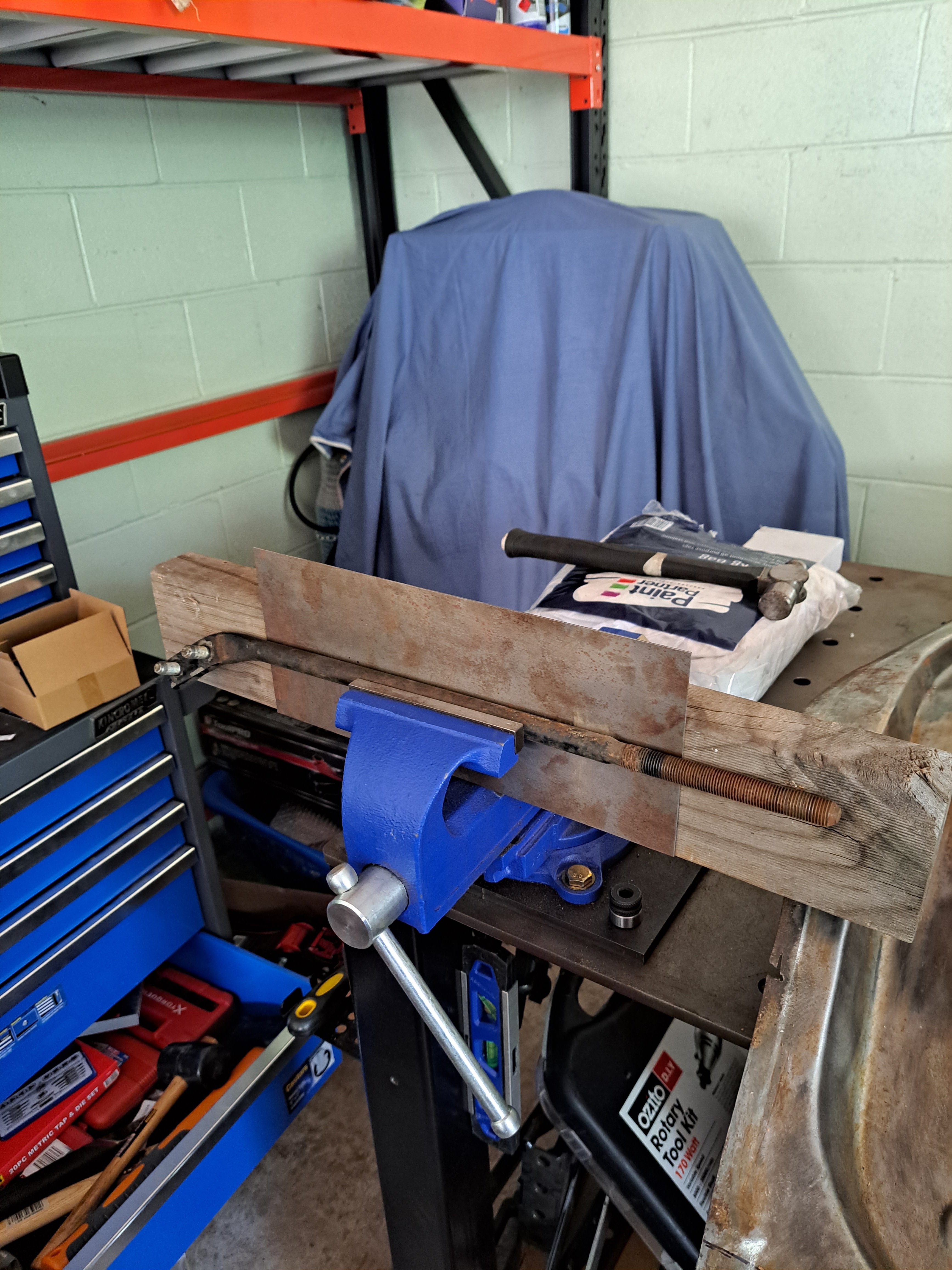

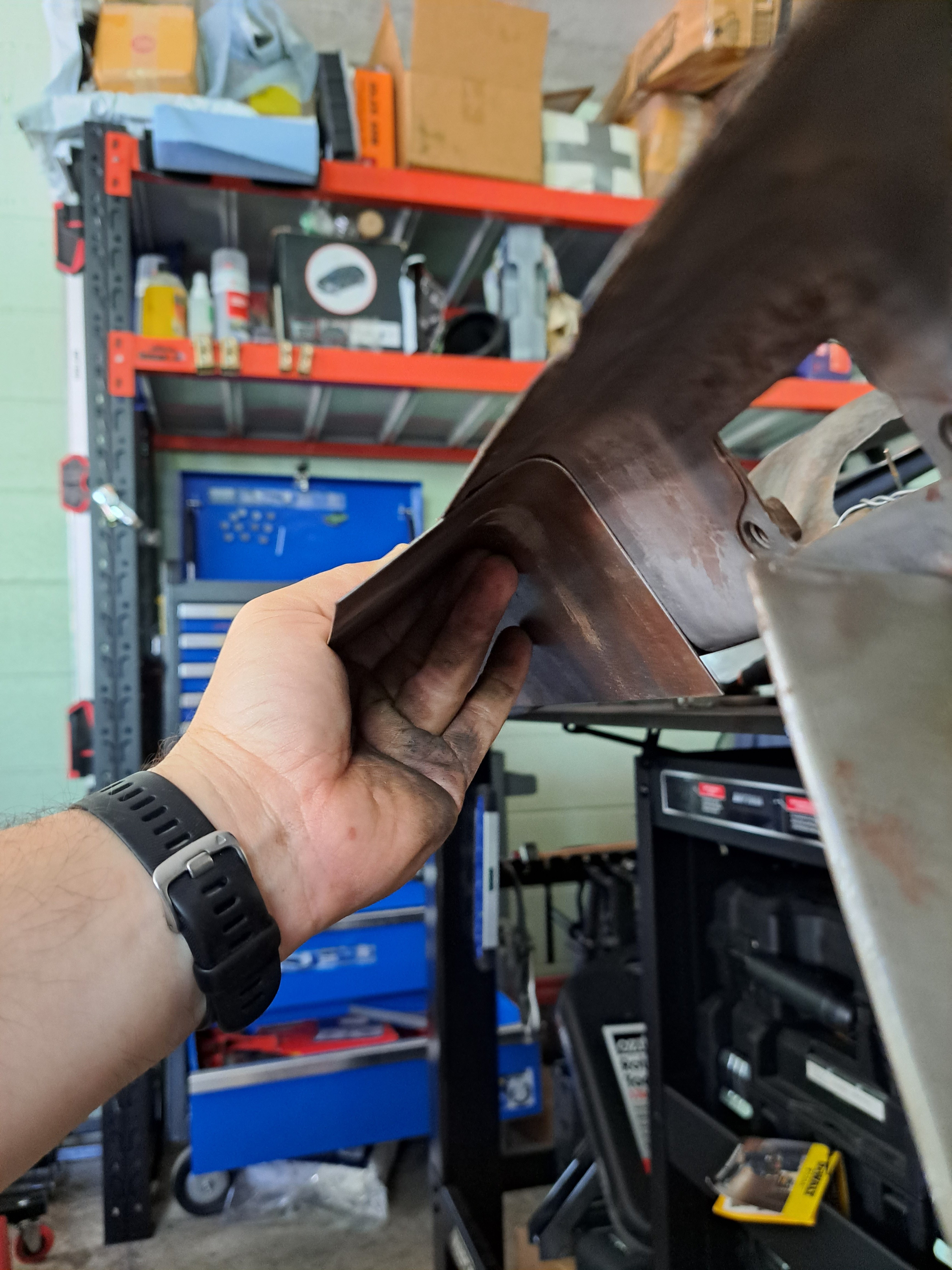

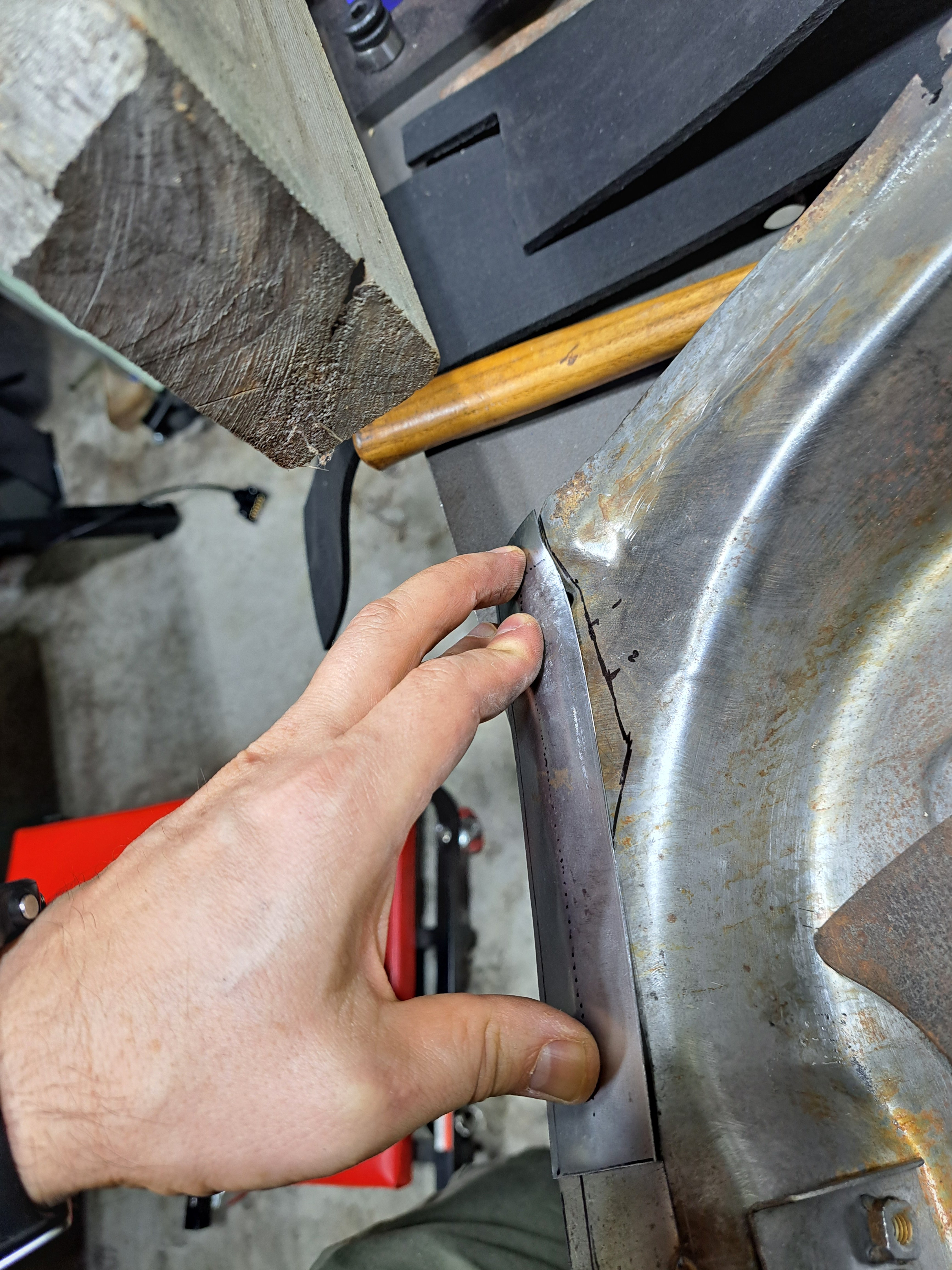

So using the old steering arm, some wood and a vice I made a bend with the right radius.
With a few manual adjustments with my favourite hitting stick I think it will fit. So I checked the radius on the other side and I think it will work.

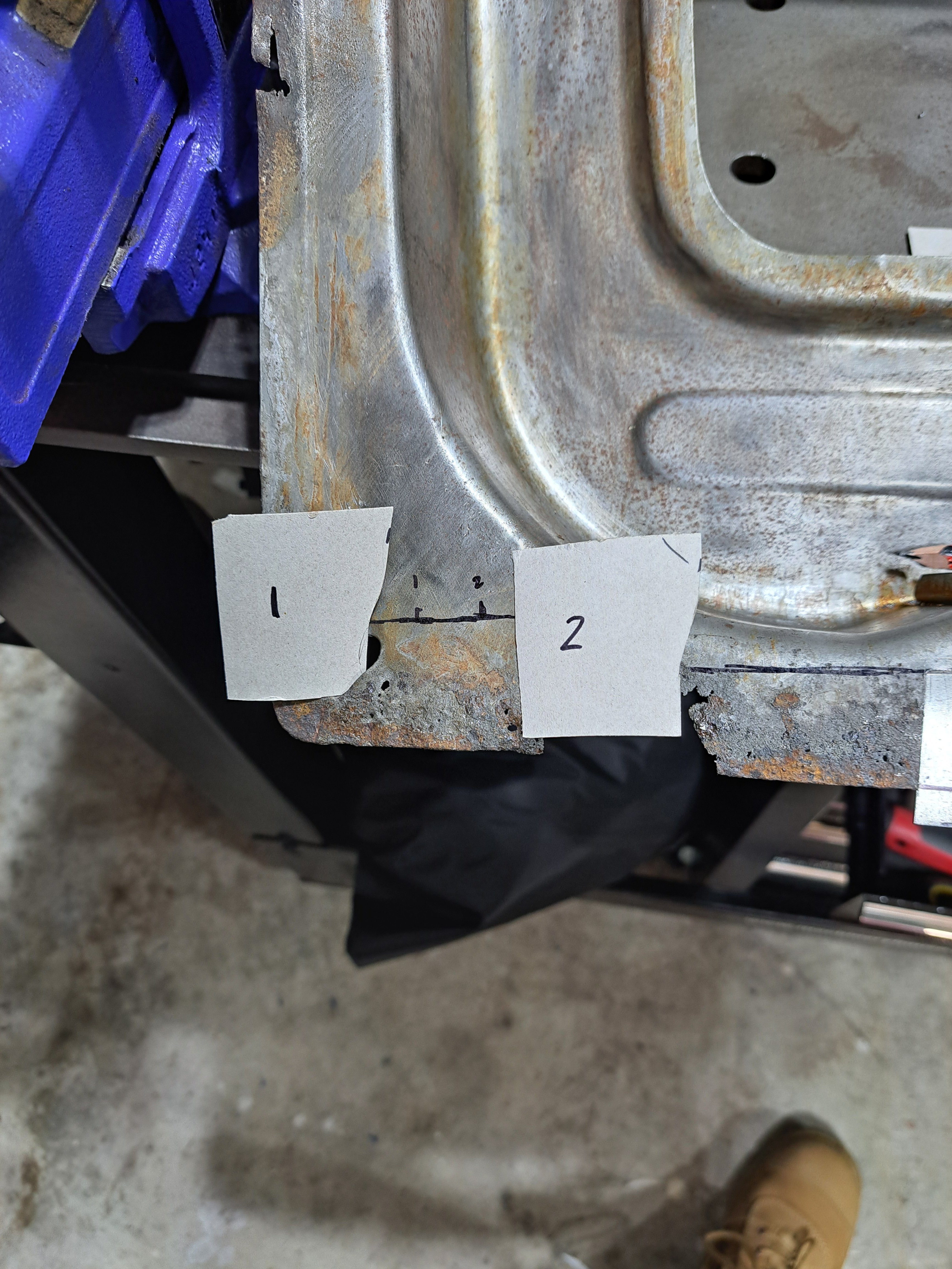

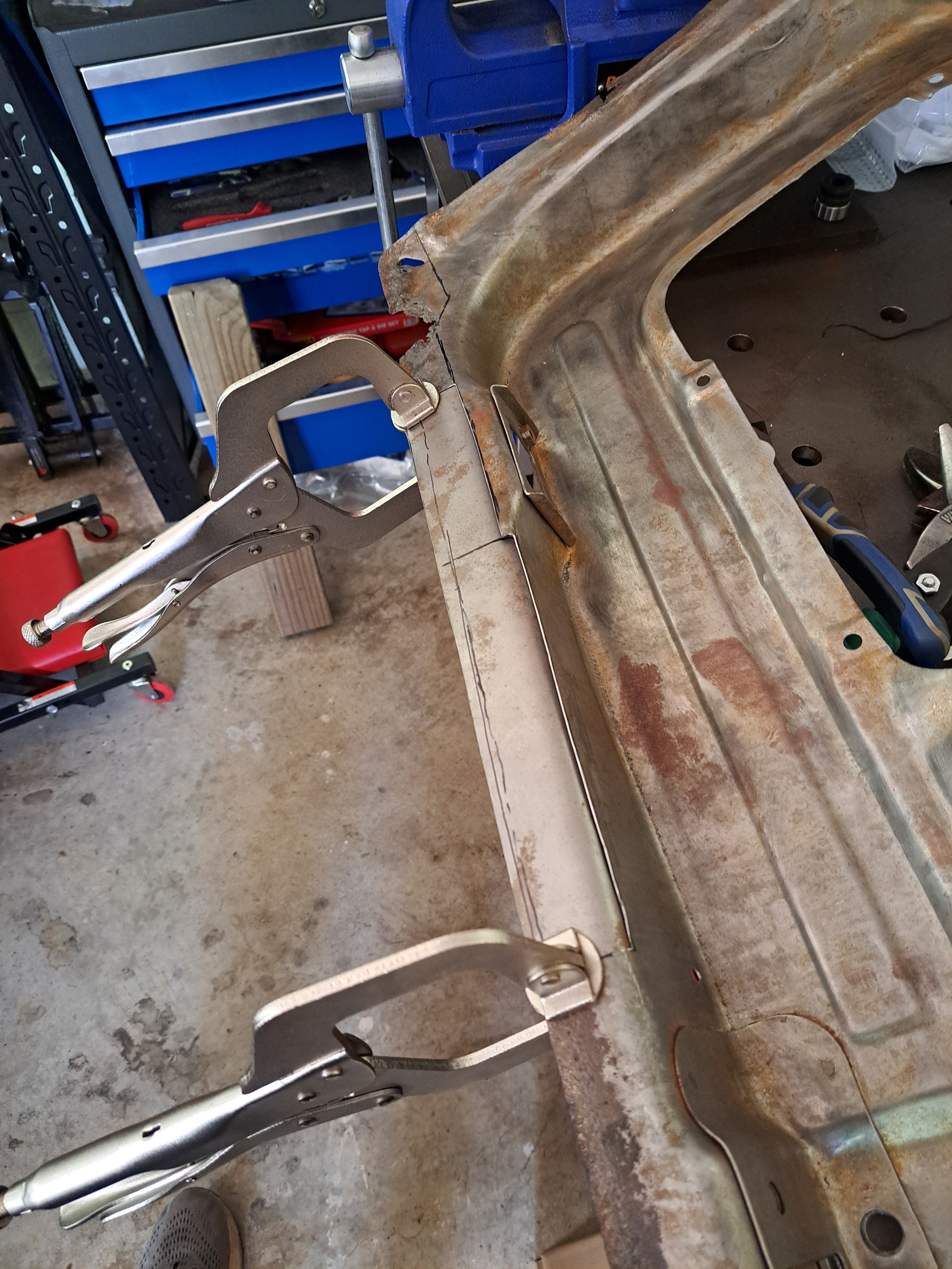

So I then cut out the old rusted section and I am again manually adjusting to get it to fit.
But there is a curve to the bottom of the tailgate, so I will need to use a shrinker to get the right curve. But it's getting close.
I have had to straighten the bottom a bit more but it's looking ok at the moment, considering it's just hacked up tools at home

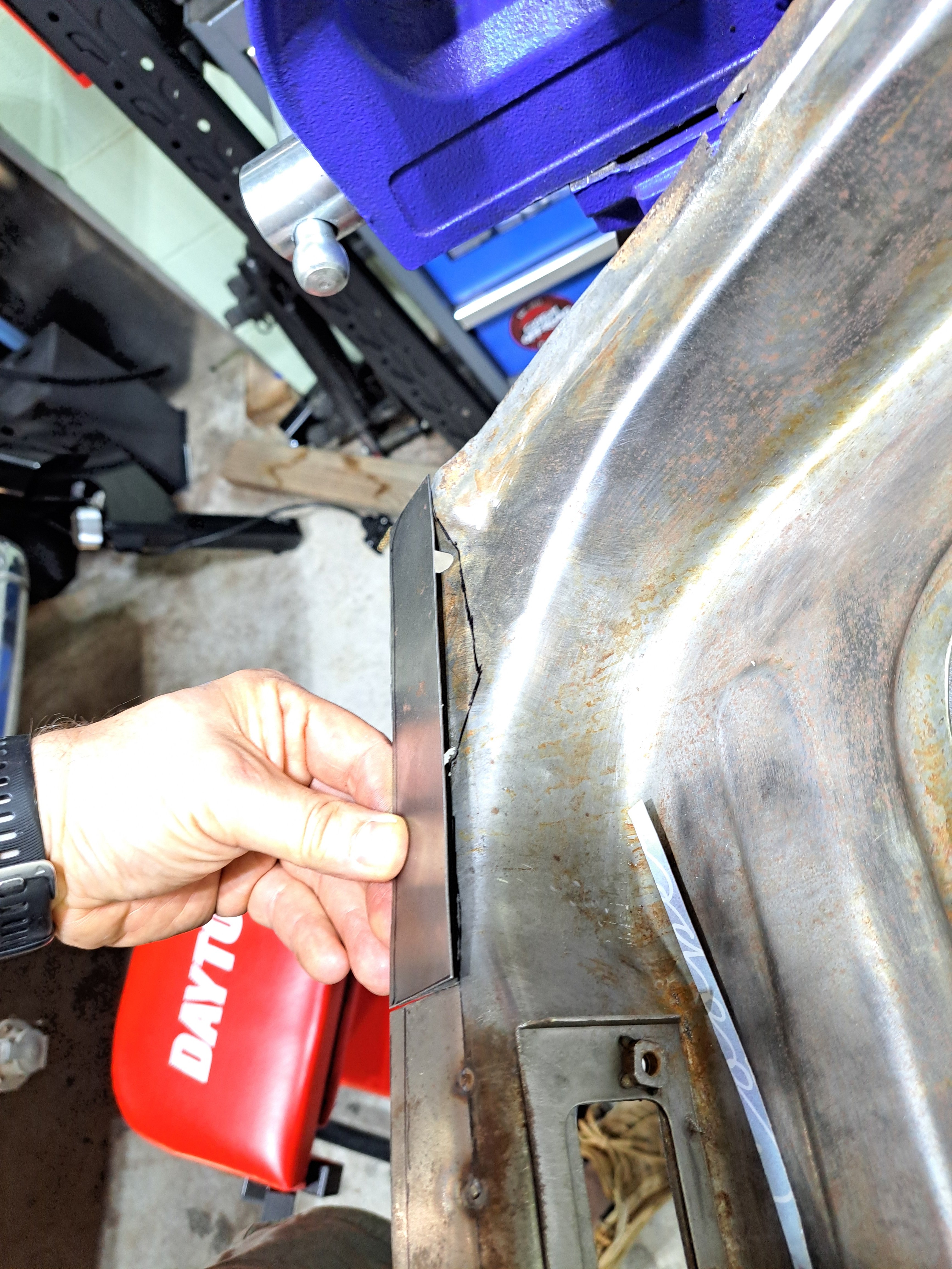

With much trimming and fettling I got to a point where I was happy with the patch panel. So I tacked the new peice into place
Looking along the edge of the bend it still needs some work but it came out ok in the end

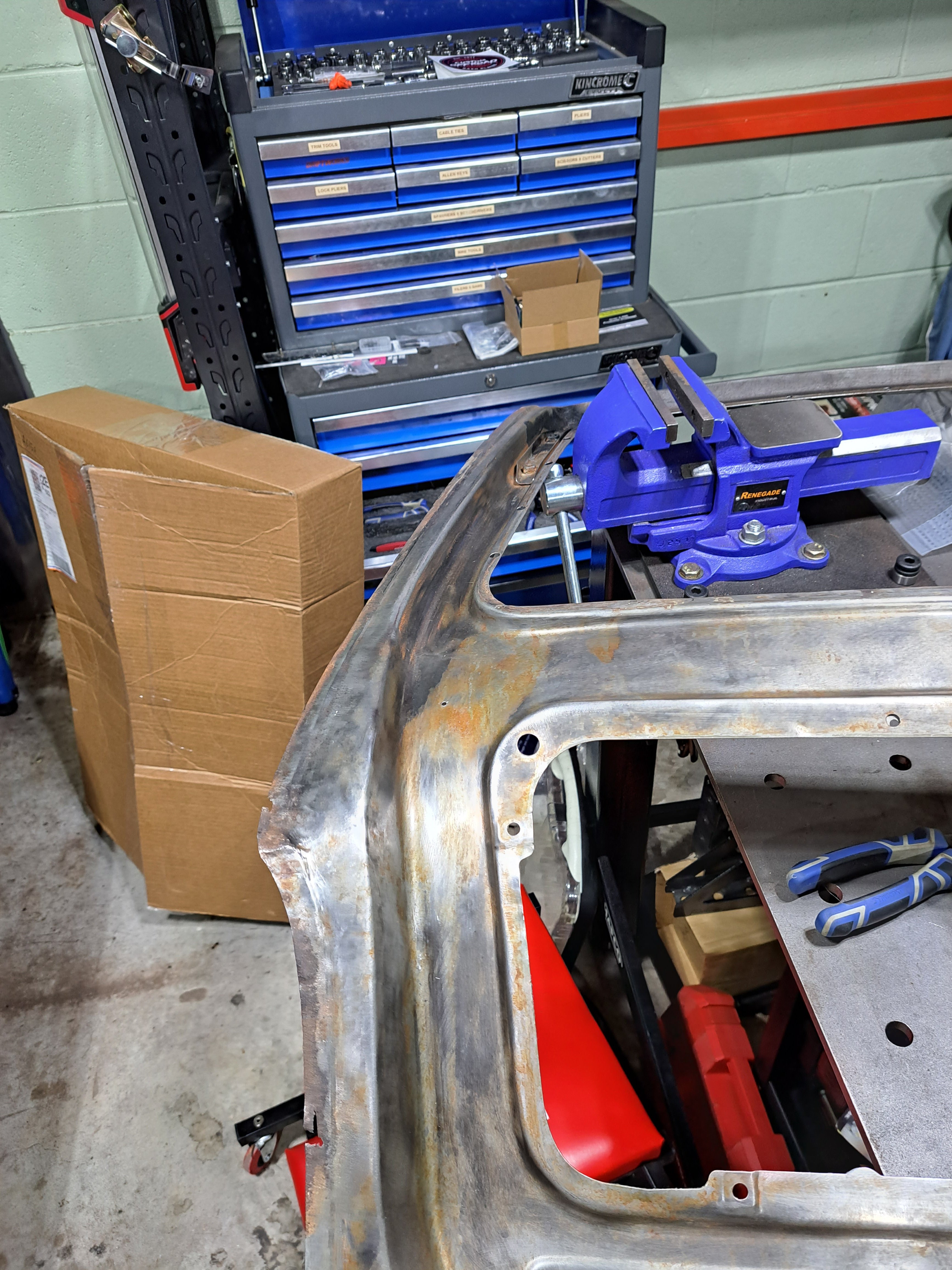

After what seems like forever, my life is somewhat back in order and my torn ligament in my left arm is still painful but healing. So it's back to it...
Started where I left off, the corner. It has a step on the side, unfortunately both sides of the tailgate are damaged and so getting an accurate measurement is proving difficult. But with some pliers and a small hammer I have it fitting back on the skin of the door well. So I'll run with this guestimate of how it should look.
I then took a few cardboard templates and cut some steel.
You can see the profile of the lip for the frame edge here, and some small templates to give me some references

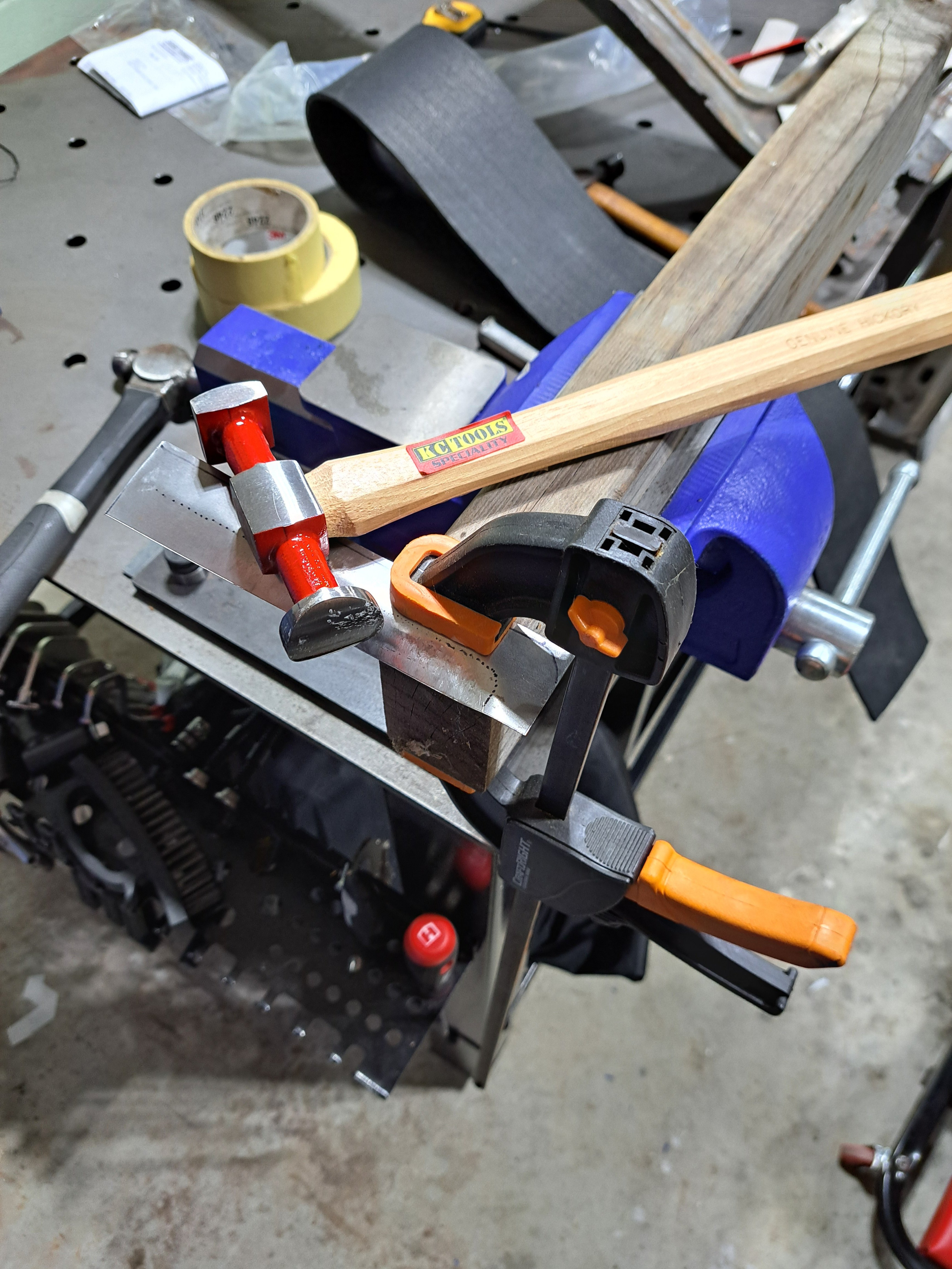

So armed with my very rudimentary tools I notched a small divot from some timber and with a soft jaw clamp got to hammering
Then with a few minutes I was getting close, I know many people will be upset with how I'm doing this but I have to work within my tools. However the result is starting to get close

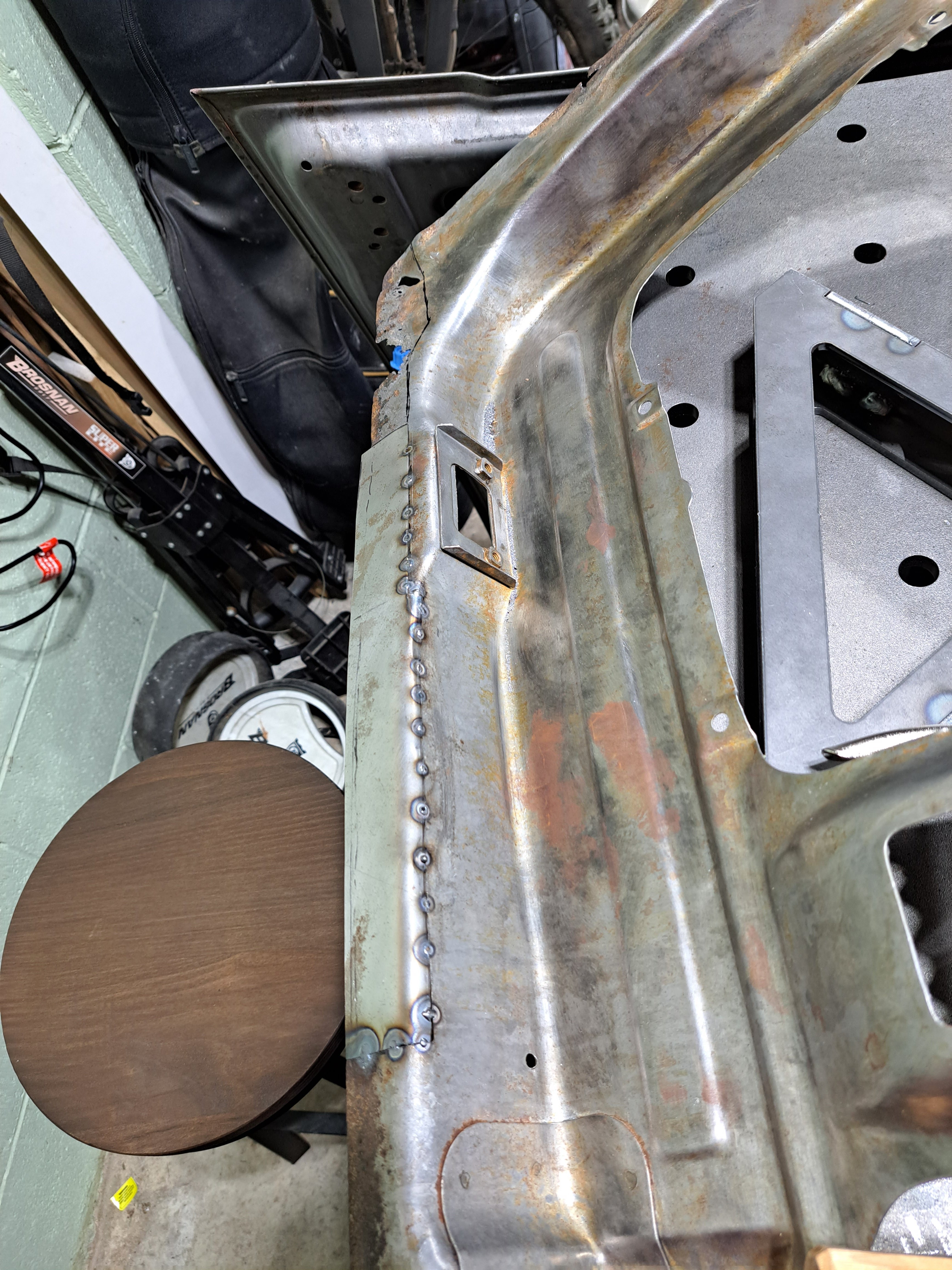

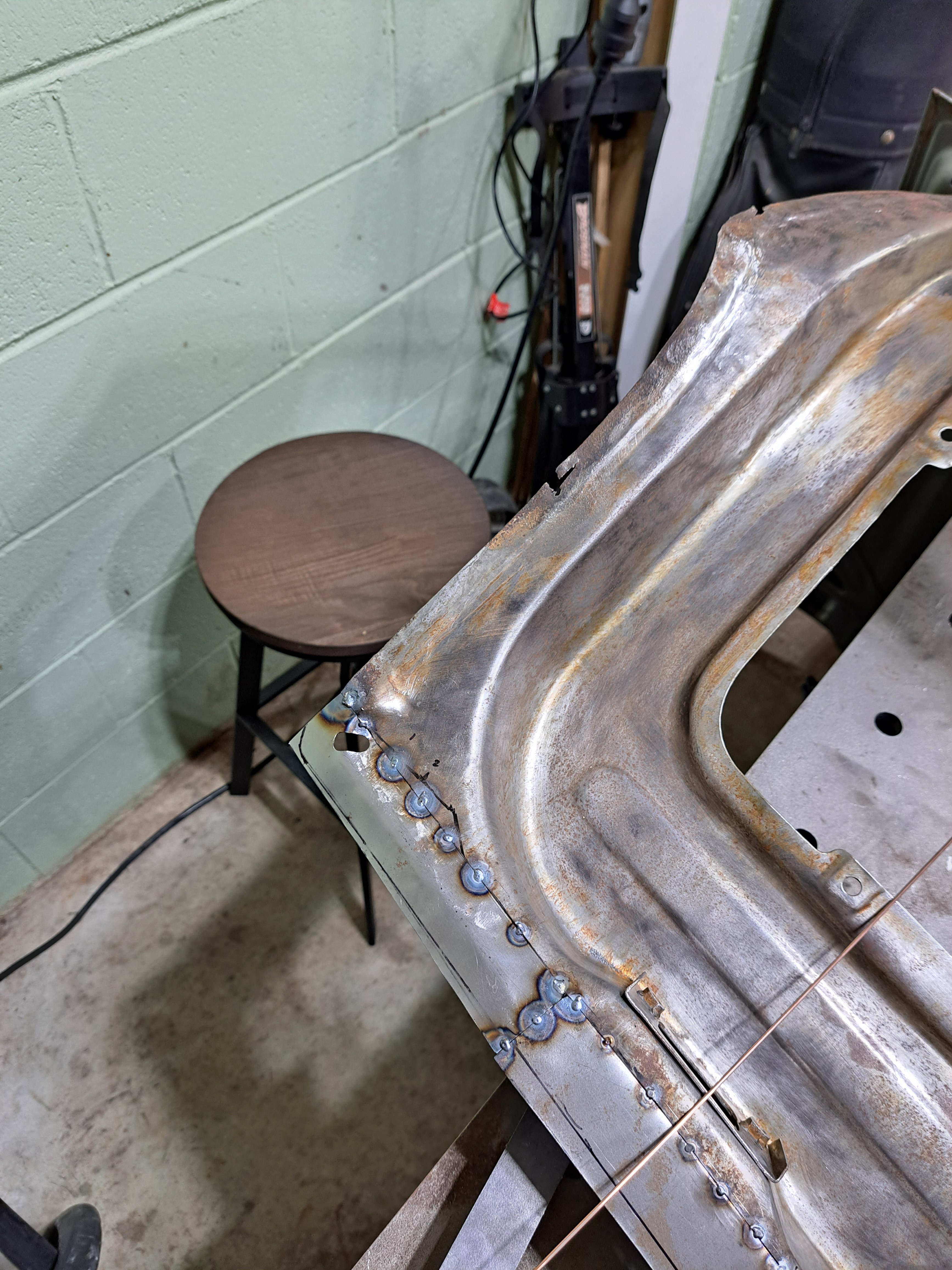

And the finished product for today... One corner peice tacked in place
Next time I will get the bottom radius from the better corner and trim the bottom to shape 😉
