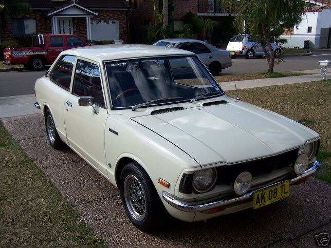

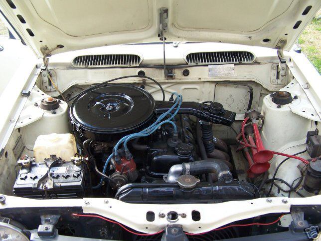

First of all i know nothing about corollas, i bought one on the weekend and its the first one ive ever own. I'm here to learn as much as i can about the car and how to make it go faster without spending a shitload of money. I bought a KE20 corolla with an engine from a T18(whatever that is) in it, it goes pretty good and its like driving a go kart cause the thing only weighs 860kgs. previoulsy ive only owned utes which ive lowered the shit out of, i still own an 87 king cab navara with all door handles, badges, fuel filler etc shaved and some other body work done to it, its too low though and without airbags i can't really drive it anywhere without scraping the leaf spring hangers..... anyway back to the KE20. I'm in two frames of mind at the moment, on one hand i want to keep it all toyota so id like to put a decent toyota motor in it to get some more power, on the other hand I'm not richy rich so id like to get the best bang for buck. is it possible to get the same sort of power from a toyota engine compared to a nissan engine for the same price?? I'm assuming its not and that i'll end up with an SR or CA in it but you people are the experts so id appreciate ANY feedback. also, i don't like the brakes in it, i like to be able to stop fast and the drum/disc brakes arent cutting it, whats the best way to upgrade the brakes??

nice lookin rolla, i think if you want best bang for buck do a bit of work to the motor thats in it. ad a mild cam, a deacent sized weber, extractors and give the head a port, polish and plain will your at it. it should be great bang for buck
IF you don't mind may i ask how much you got it for? That was on ebay last week wasn't it?
this car was on ebay for 2500.
as for bang for buck, it already has a 3T in it.
1800cc in a ke20 is more than enough.
so some small easy mods to engine like extractors, weber, cam etc etc and ull be set.

you got yourself a sweet ride there, take good care of it.

Anyways, it looks cool, i was hoping the ebay buyer would get on here!...
Whats ugly about it though? its know its no BMW but hey...

thanks for all the help, i bought it outside of ebay for the asking price, i work with the previous owner and i know how much money and effort he put into it. its also handy being able to walk over to his desk and kick him everytime something goes wrong
aint nothing ugly about the ke20, i love the shape and it shits on those ugly beamers that came from the same era, my username comes from a hip hop album by atmosphere and i liked the title so its been my username ever since.
the 3t is pretty quick but a guy that lives below me just bought a series five rx7 and i want to beat him for half the price, he'll hate that. The 3t has some 'hot cams' already, I'm not sure if this made much of a difference cause i didnt drive it beforehand. i need to go through some of the threads and read what other people have done so i can get a better idea of the potential of the 3t, i like the idea of sticking with the 3t though cause swapping engines is a pain to say the least

you wont be beating a FC with a worked 3T.
may have to look into turbo charging it if your looking at killing a 13BT FC.
cheers scott
You could go 3TGTE and give the FC a good run for its money! :y: Looks tidy mate, good luck with it.
yeah I'm thinking about going for a rotor, if you can't beat em... join em. but before i do that i want to get the most out of the motor ive got so i'll get some webers and what not and take it to get tuned as well, it definitly needs some tappet adjusting.
