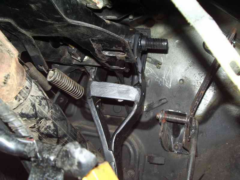

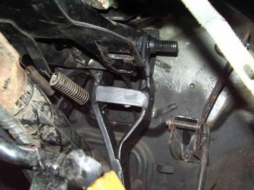

i wouldnt be too worried about the firewall. as the others have suggested just get someone to check the wall while you press the clutch.
if it was the brake master cyl, where your pushing against the resistance of the brake pads (through the fluid), yeah you'd want some bracing. but the clutch has no real resistance as its only working against spring pressure. theres no hard stop at the end like brakes do.. and all the converted effort is done at the master, after the firewall.
my ke25 has a hydraulic clutch the same as yours, and i have had no problems with the firewall yet.

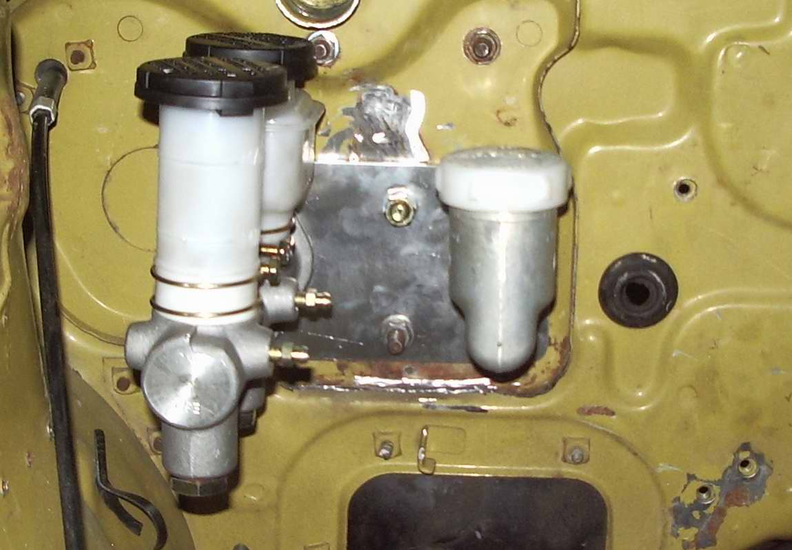

put the plenum/manifold on the other day to check if i had clearence from the master cylinder , looks fine for the moment but i think that i might have to go a dual circut m/cyl but i might leave that untill i get to the stage of brake upgrade.
I'm installing a 4age blacktop 20V in a ke25 IPRA car at the moment, I used 6mm aluminium on the fire wall side as a brace and now it has zero flex, I also relocated the M/C 60 mm from standard to clear the intake trumpets and filters.
