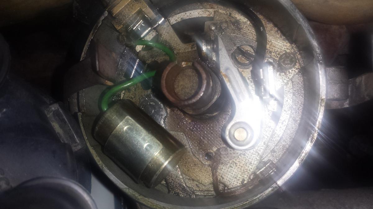

  1. This is the inside of my 4k dissy
  2. Hi guys I bought a 7k-e electronic dissy ages ago and I've come to the time in the build to install it. The problem I'm having is there is a small 2 pin plug on the side of it, I'm assuming they are positive and negative I have not looked inside it yet. If someone has used a 7ke dissy on their 4k or 5k can you point me in the right direction. I've also looked at installing the electronic type point conversion you can do for the standard point type dissy. But I cannot find a type to suit my single bolt point type has anyone done that type of conversion to help me in that direction. Thanks Mathew

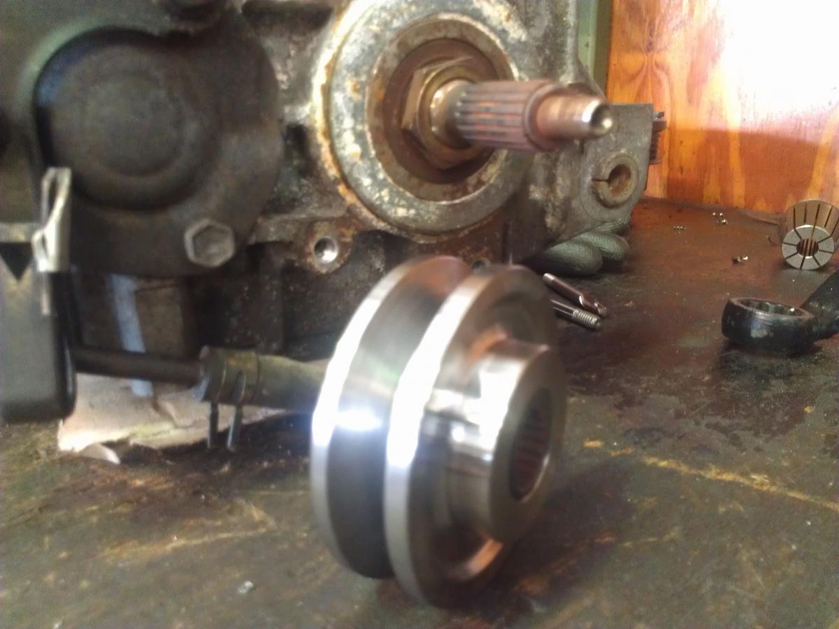

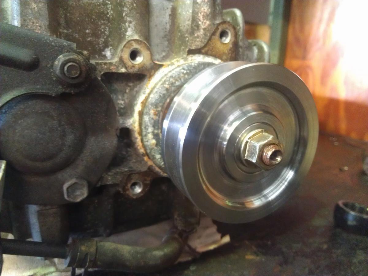

  12. Hey guys I've machined thebv pulley for my sc12, I dunno if its the right size. I found a pulley size to psi calculator and it said my pulley had to be 2.5 inches in diameter, I dunno how true it is but I can always modify it if need be. If anyone has a v pulley on their 1.6 Ltr and can measure it it would be great, Anyways here's some photos of the pulley machined up.

  14. I'm gonna be running a idler pulley aswell so I shouldnt need that much tension as you would with out. The shaft is pretty soft but I think it should be fine. We shall see when I get it assembled. I can always take it apart and put stronger bearings in it or if needed make a stronger shaft but that shouldbnt be necessary. I hope. But I would like to see the photos of how you have done yours

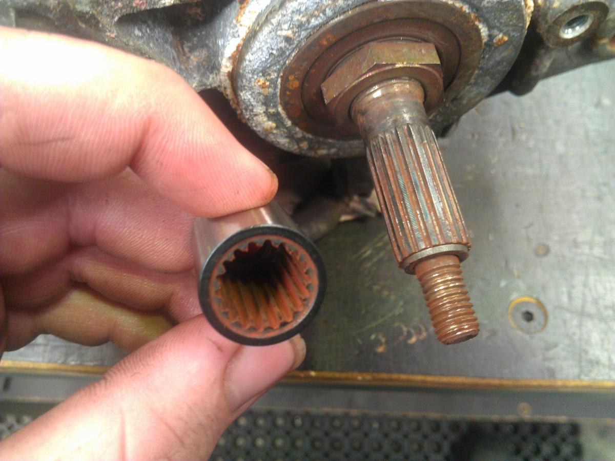

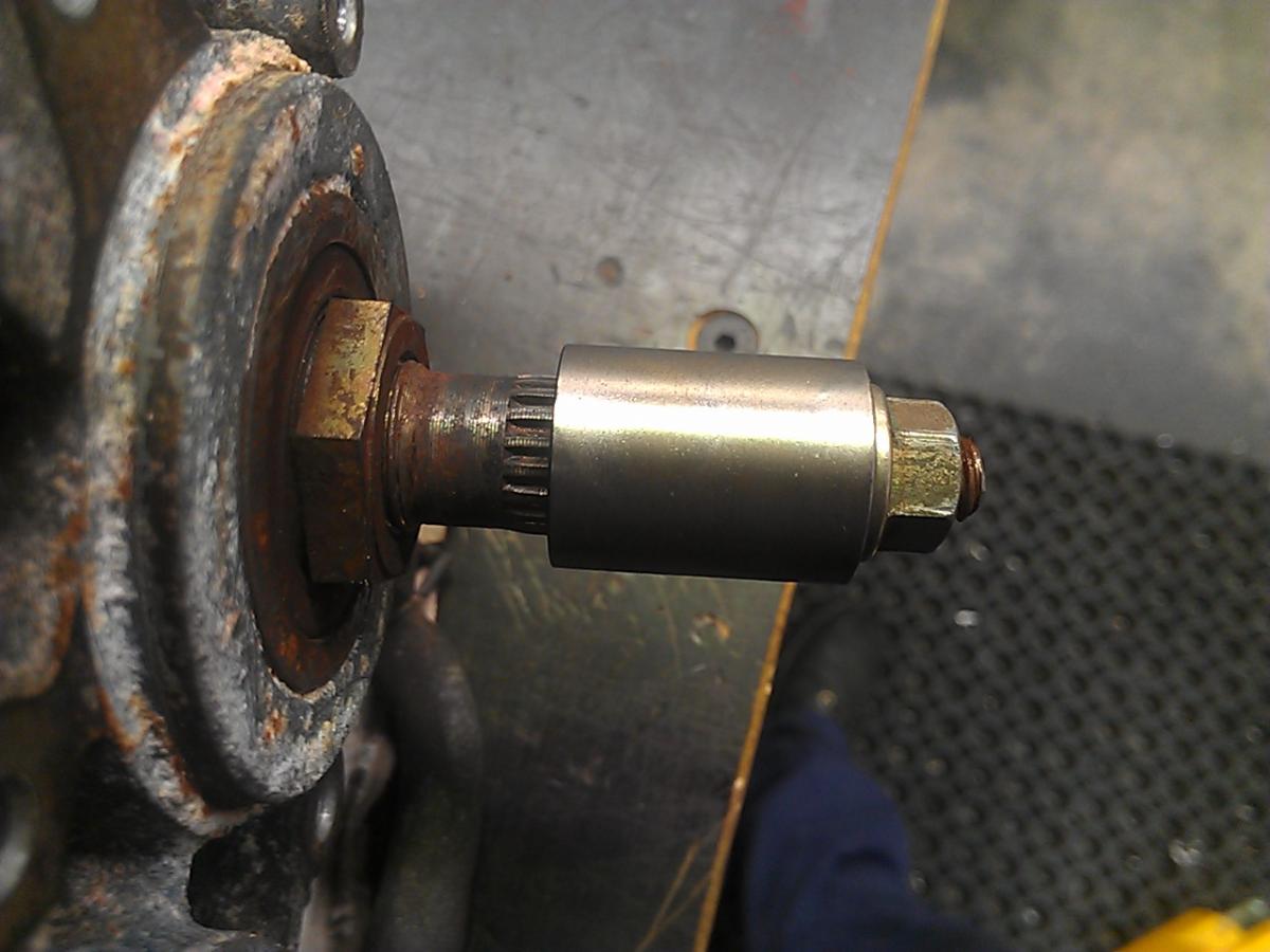

  15. Pretty much all I did was once I got the old pulley off and apart I just ground the heads off the three pins that held that front part together, punched out the pins and you should be left with the spline, so i then put it into the lathe and turned the outside diameter so it was a clean nominal diameter eg the outside is now 20mm, when I make the new v pulley I will make it .02 interference fit so it won't come apart :), it helps being a fitter and turner.. If anyone needs this done I'm able to machine it for you for a small fee. It's better than welding a pulley on the front of your standard pulley, at least this will run true.

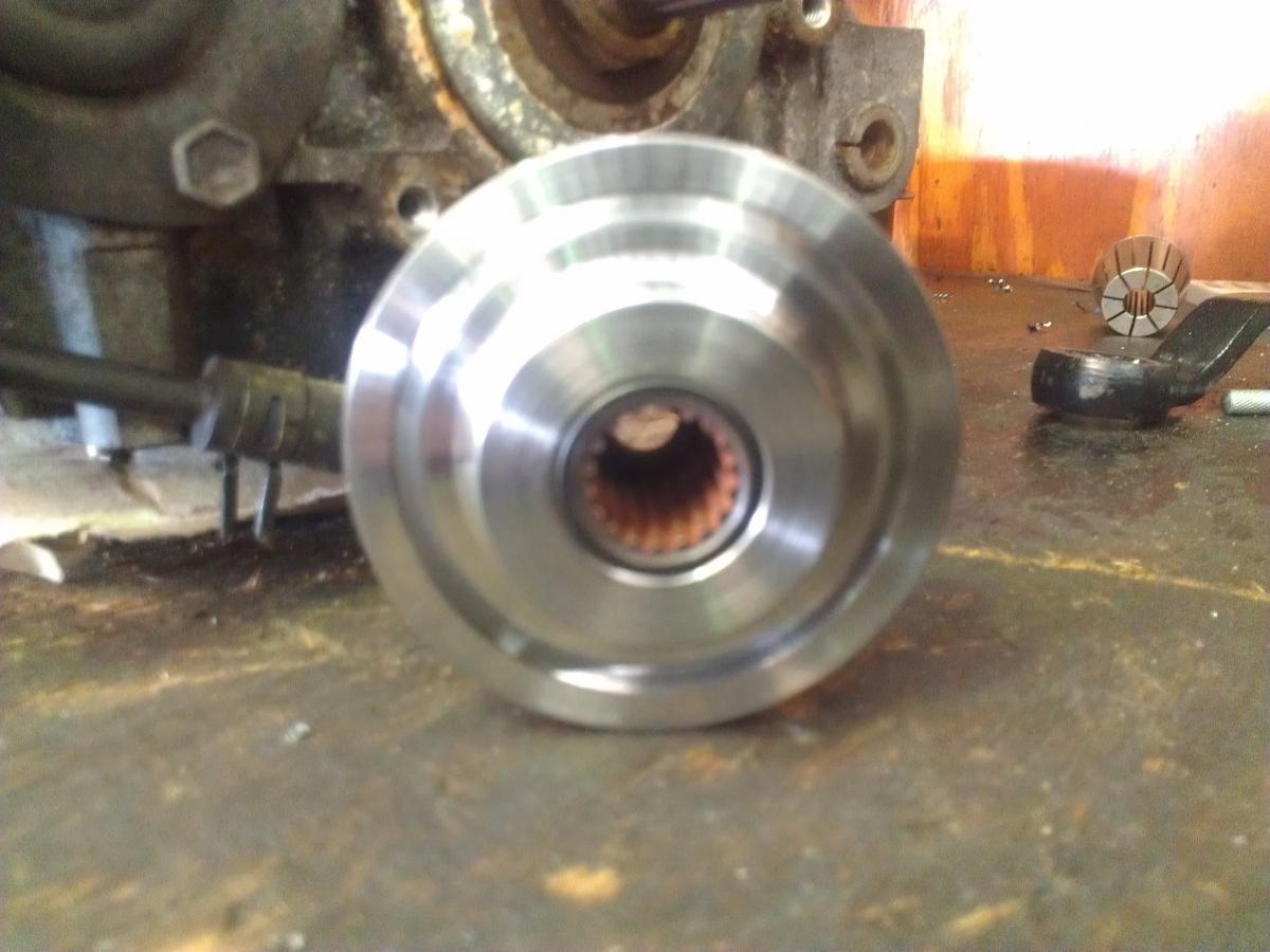

  16. Hey guys I'm doing a 5k supercharged blow through carbie, going into my 82 ke70, My motor has been built for it. It's got the following 5k block bored out 20thou, New pistons and rings I think d dished pistons Reground cam to street setup Solids conversion Reground crank All new bearings, Welsh plugs, Seals, Block was decked and acid washed, honed. Lightened flywheel Exedy heavy duty clutch 4k head Lightly decked New valves New valve seals, New valve springs 3 angle valve grind Extractors and 2 inch straight through pipe with sports muffler with ve ss exhaust tip. I got my sc12 the other day and I took it into work and pulled the pulley off to put a v belt pulley on it. I haven't machined the v pulley yet but i machined the old pulley so I can still keep the geared spline and ill just press the new v pulley onto the machined pulley, I took some photos of the old v pulley machined up.

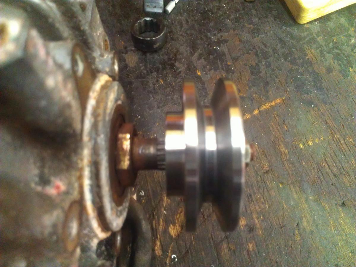

  17. take a photi and put up what ive done so you guys can see and hopefully it works. ill Took the pulkey off abd took it into work and spun it the lathe and machined it so it has fresh v and made up a idlrr pulkey to mount off ths alternator braxket tk bring the belt.round ths pulley abit more to give more surface contact on the water pump pulleye
