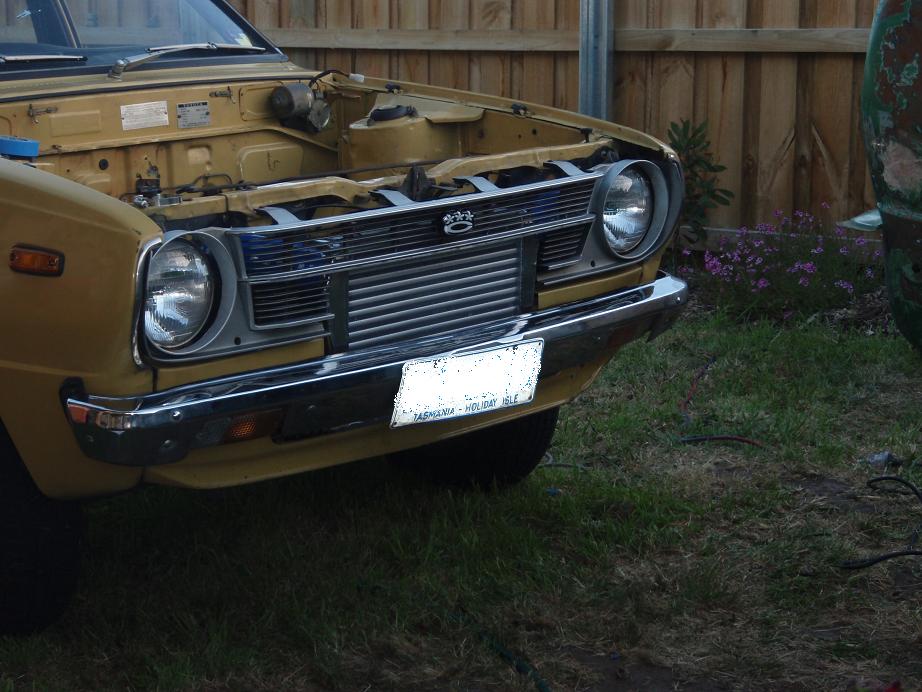

  17. hey guys just wondering what ke30/ round headlight grill has the most room behind it? because i had to cut my intercooler in to this one in the pic and i don't like it. and i want to try eliminate re mounting my intercooler! cause of my stainless pipes and everything has already been made.. or a way to mount the ke55 headlights into it so i can use the honeycombe grill in it like i did in my ke55 or any other suggestions to solve my problem. any opinion would be helpful! johnnyt
