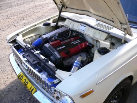

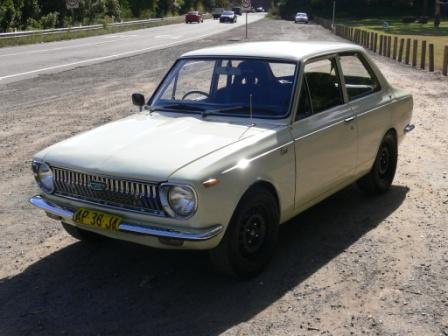

Hi,
I was only going to post my car when it was painted and completed, but thats never going to happen. A project car is never done.
I will spare you all with in 'in the build pictures' untill later (there's heaps). It was stock standard when I first got the car. I was going for a tuff street sleeper car.
Iv'e tried to list all the modifications, but there is just so much. Here it is:

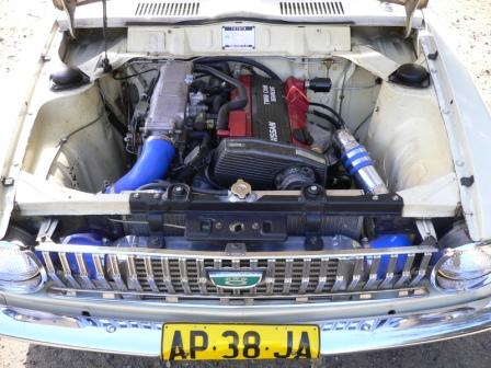

Engine
Nissian CA18DET Stock.
All seals/serviceable parts completed prior to installation.
Modified firewall & tunnel.
Modified S12 engine mounts with RX7 Nolthane rubbers
Gearbox
Nissian S13/S12 (shorten version) gearbox, rebuilt. (Poorly rebuilt by professional. Still to be removed and returned)
Custom gearbox mount with Nolthane rubbers.
Extreme custom clutch

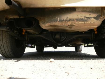

Differential
Custom cut down Hilux diff, Mark William axles.
Rebuilt LSD 4.3.1.
Changed Stud pattern to match 114.3 PCD
Custom tailshaft, 2.75inch (3inch couldn’t fit?) New heavy duty replacable universal joint.
Suspension/steering
Knoi adjustable yellow inserts shocks at front with modified top housing.
Knoi adjustable yellow shocks at rear (recently rear valued at 790pounds = stiff ride)
New leaf springs at rear. Additional tramp leaf, additional clamp to leaf, reversed eyes to stop tramping.
Custom cal-tracks to rear leafs (by far the best modification!)
Modified front struts, Struts where cut down by 2inch to allow for more travel.
New heavy duty coil springs at front.
Nolthane bushes to the lower control arms, leaf springs & idle arm.
New ball joints/tire rod ends
Reco steering box. (made from two steering boxes)
Exhaust
3inch turbo back.
Custom dump pipe
Hi-flow stainless steel cat & rear muffler
Pee shooter tip

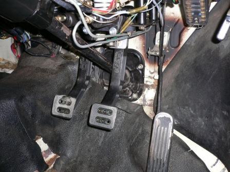

Brakes
New brake lines all round

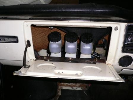

VH44 remote booster, mounted under dash.
Under dash adjustable pedal box with 3 x 7/8 master cylinders, 1 rear, 1 front, 1 clutch.
Corolla Ke30 front Hubs with new extended studs
Reconditioned Corolla KE70 callipers with slotted discs on front
Reconditioned Nissian R31 skyline rear callipers with slotted discs on rear
Willwood adjustable brake bias to rear
New handbrake cable/brackets
Tyres
Skyline stockies
195/60/14 front
215/60/14 rear

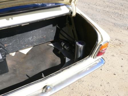

Fuel system
Bosh 910 electric fuel pump
Bosh pre pump (noisy Fu*ker)
Plazmaman surge tank in boot
New 5/16 fuel lines & return line
3 x fuel filters (over kill)

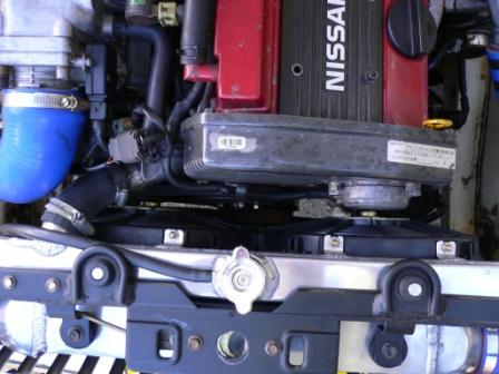

Cooling system
Custom Aluminium radiator, single core.
2 x 10 inch thermo fans. Ultra slim
Modified thermostat housing
Turbo system
Standard turbo on Standard boost.
2.5inch Aluminium intercooler piping
Front mount intercooler
Computer
Standard ca18det computer
As always additional relays, fuses etc due to conversation.

Looks like a pretty decent build. But I'm mystified by why you'd run such a heavy rear spring rate, most 5 tonne trucks have springs that heavy. How's the traction in this thing?

What pedal box is that? cheers! - 26rolla
Its a tilton peddle box.
Looks like a pretty decent build. But I'm mystified by why you'd run such a heavy rear spring rate, most 5 tonne trucks have springs that heavy. How's the traction in this thing? - beerhead
I was getting a huge amount of axle tramp. The leaf spring would always wind up. At first i thought it was the shocks, so I played around with them first. I was told stiffer was better (yeah... not for my arse). With the Koni shocks you can change the valves. Originally it was around the 300ish mark, then changed again to 450ish (can't really remember). It seam to help a little with the tramping, so i up'd the rate again to what it is now. It will be changing again. LOL. But the ride is very stiff. The cal-tracks stoped the tramping. Traction wise is fine if your not hard on the throttle.
