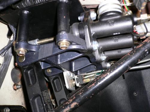

I am currently looking at my brake setup, and am considering either a Willwood or a Tilton pedal setup, but was concerned about not having much space under the dash..
Are you running the Tilton master cylinders or generic master cylinders?
Any chance of some more pics of the actual pedal/master cylinder setup?

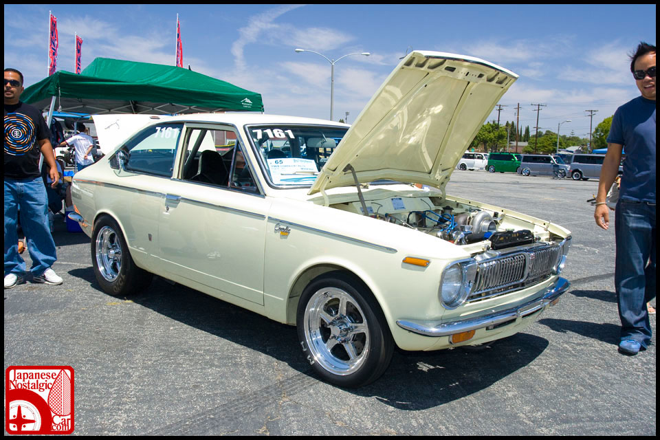

First thing that comes to mind for me when I look at your car is wheels.
Make it look good first that way the car would be worth a lot more anyway.
You could go a cool metallic paint job and fashionable wheels
Or….
Something like this. (notice the standardish ride hight).

I'm also interested in having a closer look at your brake/pedal box setup as I'm considering doing this to my ke26 due to space issues. also a pic of your brake booster setup would be handy :).

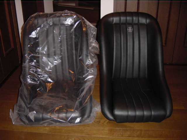

The KE10 already has nice interior. I will be leaving mine original and neat. Don’t even want to cut the dash up for gauges if I can.
Only thing that I will change is the seats to something like this.
