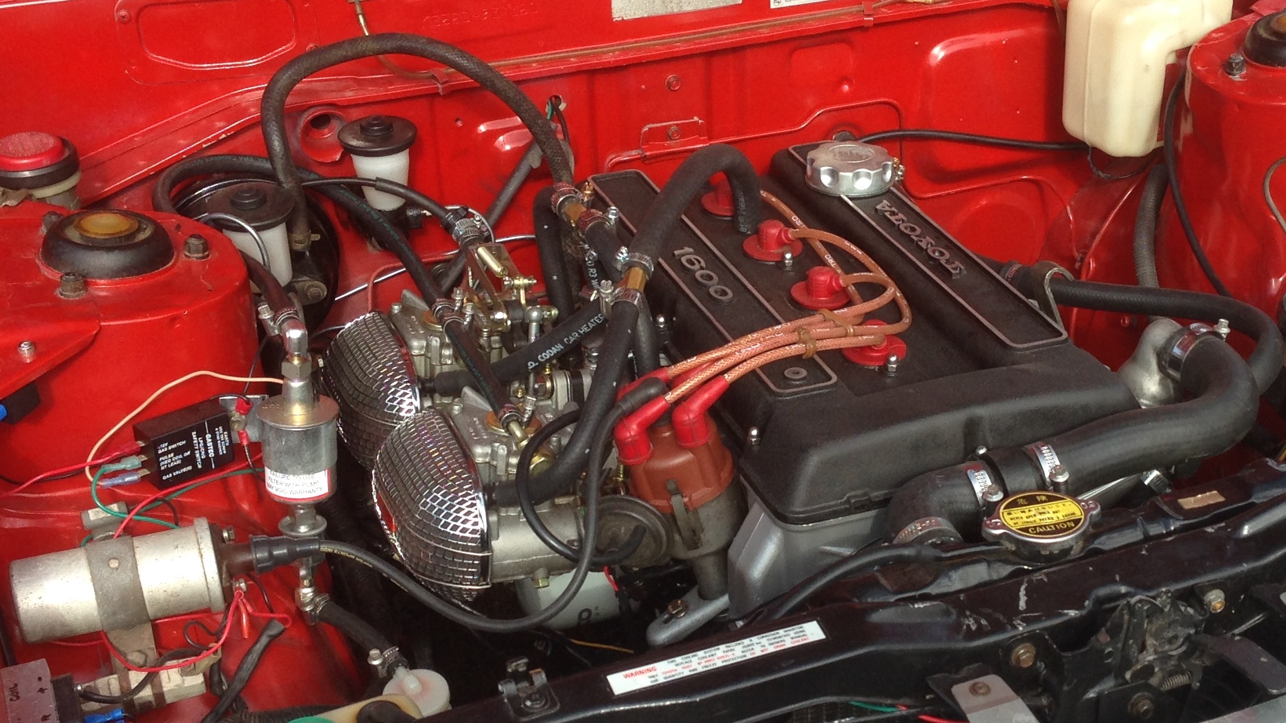

  1. I'm all over the place with this ,so I went back to basics. Standard timing, set correctly (I don't want to talk about it) with vacuum advance connected. Runs a little bit better. But still there's a miss/spit/bog when progressing off the idle circuit. I can advance the timing but the issue persists I've chased vacuum leaks, idle tuning, timing issues and I'm fairly certain I can eliminate those concerns. I even discovered the air bleed screws weren't seated. Still no good. So I think that means it comes down to jetting. I perceive the DCOE 151 is set up for a 1300cc engine. The fellow/place I bought the carbs from was no help - doesn't stock jets and told me that a 1600 at 5700rpm is the same as a 1300 at 6000rpm. On the face of it, I concur. But in practice.. its definitely bogging when I try to floor it or progress from the idle circuit. The 151 DCOE comes with 45/F9 idle jet - seems fine 30mm chokes - fine 115 main (120,125 would seem ideal for the choke size, a little bit richer) 200 air correctors (my reading suggests main + 50 is ideal = 170 air corrector, richer) f11 emulsion tube (my reading suggests f16 or f9 for a 400cc cylinder size) accelerator pump gives a healthy squirt - haven't looked into sizing So I'm thinking to order/buy a pair of 120/f16/170 (main/emulsion/air) jets. Wish there was someone knowledgeable I could ask about it!

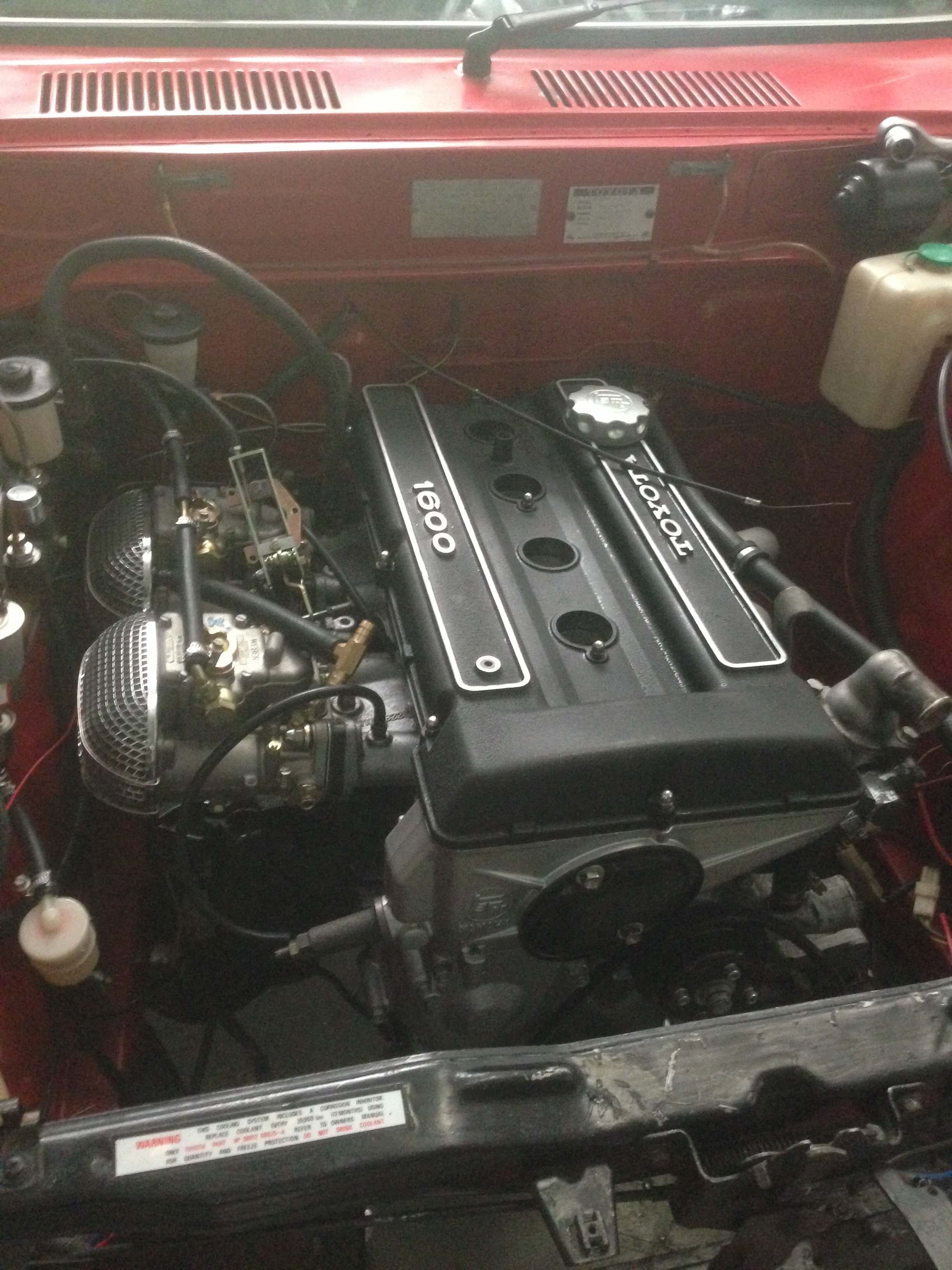

  4. A few weeks between updates, indicative of the ongoing troubles I've been having, and the time available to get to it. I've been able to tune the idle just nicely thank you. But then when I'd try to fine-tune it and go for a drive, everything would go pear-shaped. At first I assumed carb jetting was the problem. Well it's seems that I forgot all my early reading about Webers. Of course now I realise that Webers have no port vacuum and the 2TGEU EI distributor (and probably most others?) requires port vacuum - not manifold vacuum. Duh. So every time I tried to move out of the shed, the timing would become hopelessly retarded whenever manifold vacuum dropped. I purchased a proper timing light and that's when I realised the error of my ways. I've now disconnected the vacuum advance and trying to tune it on mechanical advance only. This has been quite a bit better, but I'm not quite there yet. I'm up to 38 degrees total advance and it's still farting around like it's retarded, though it's running well enough that I'm now able to street test it. And remarkably still starting ok with 25 degrees initial timing, though it needs to be nursed until warm So I put it aside last night, nervous about pushing it with more advance. Nervous for my custom pistons! I began reading about hemispherical combustion chambers and domed pistions I now realise this results in very slow flame propagation. But also makes them very ping resistant. Chrysler Hemi engines even ran up to 45 degrees advance back in the day. Tonight I'll have yet another go at tuning at 40, 41 even 42 degrees. Anyway, it's made it out of the shed again for a dust-off wash. Time for a good buff. I've got a bloke lined up for a mod plate and roady when I'm done.
  5. Richened up 2 & 4 until they stopped spitting and now it runs grouse. Right on my self-imposed 9pm rev curfew too.

  7. Well... what a difference a properly adjusted timing chain makes! Now to just tune these Webers. Had to cut it short last night because I'm not sure if the neighbours are as enthusiastic as I am. I expect I've got a vacuum leak somewhere. I'll try disconnect/plug my gnarly PCV system and see how I go from there. Love the sound of them.

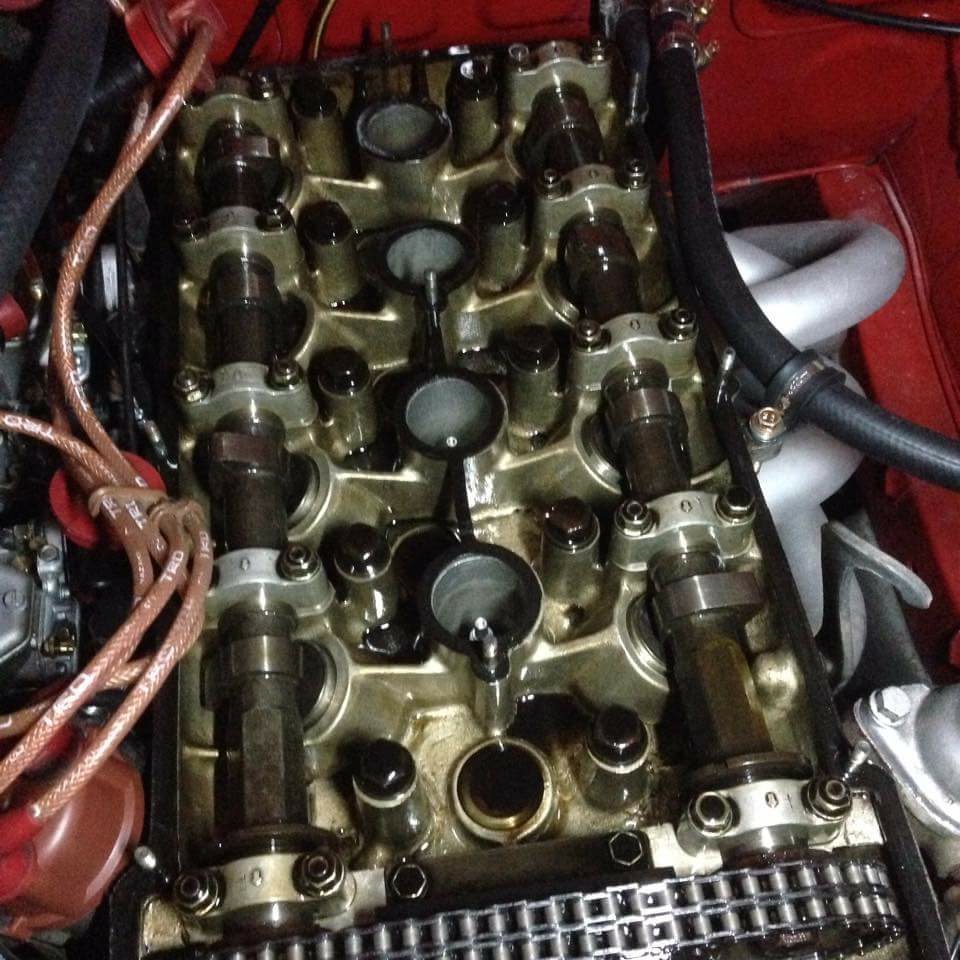

  8. I pulled the cam cover off a couple of times to be certain! With the bonnet down and the door closed all the rattles disappear, so maybe ignorance is bliss?...

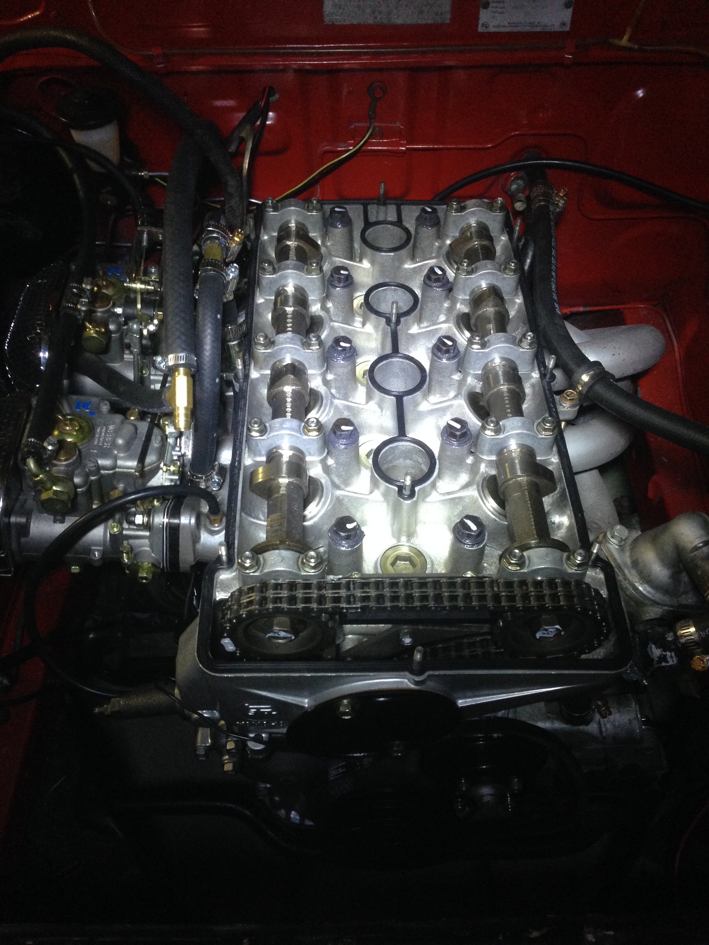

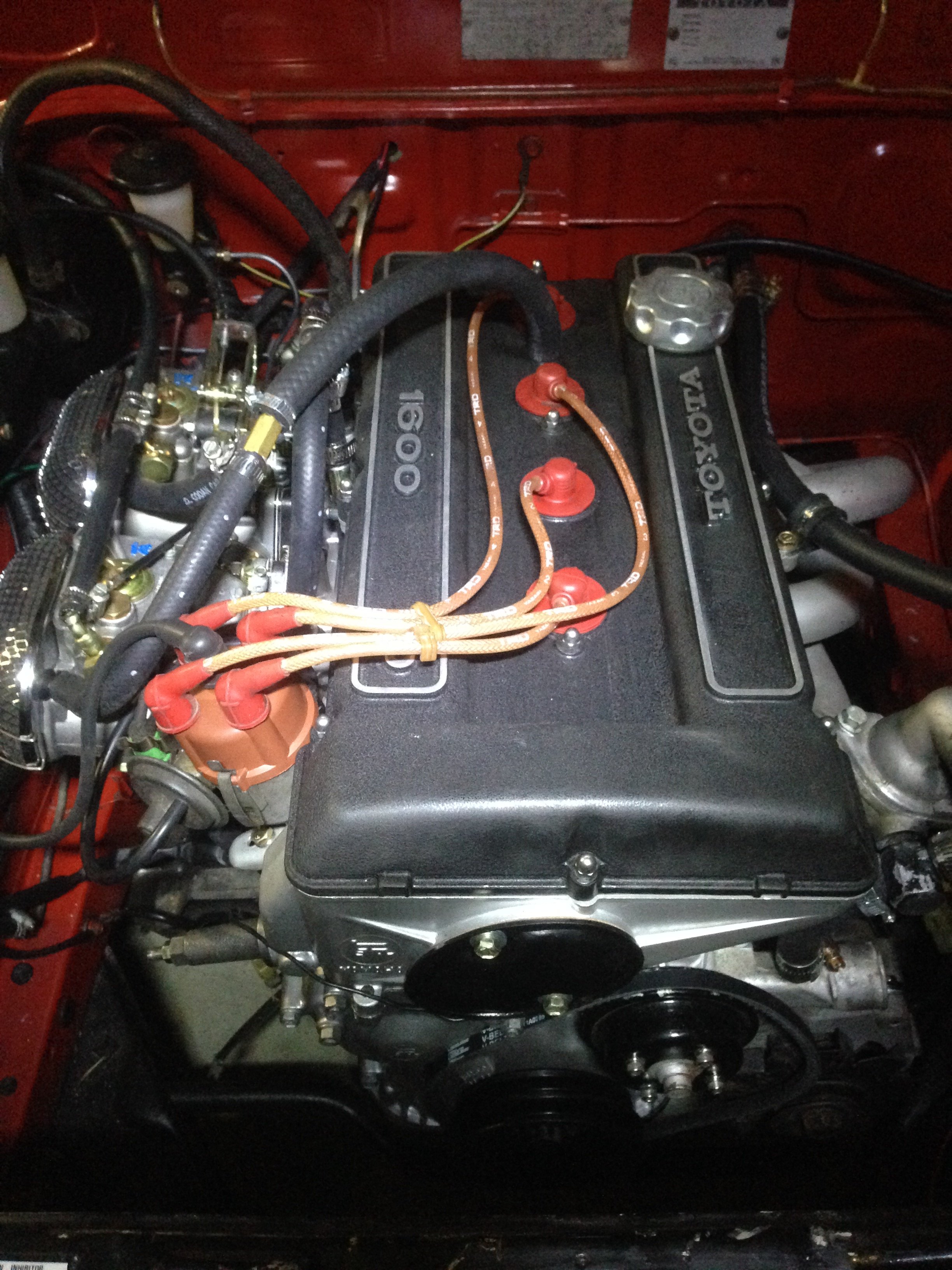

  9. After running around for multiple fitments of fanbelt, last minute hose clamps and running-in oil I popped the cover off to confirm #1 TDC to install the distributor and plumbed everything else. It's all up an running now. A couple of niggles to sort with dash and gauge wiring - something has gone awry there and it's annoying me. The timing chain seemed awfully noisy to begin with but seems to have settled down. Of course I'm nervous at any little clatter or rattle but it strikes me that the 2TG is a bit of a rattler anyway. can't wait to get home tonight and rev it a few more times, maybe drop the running-in oil.

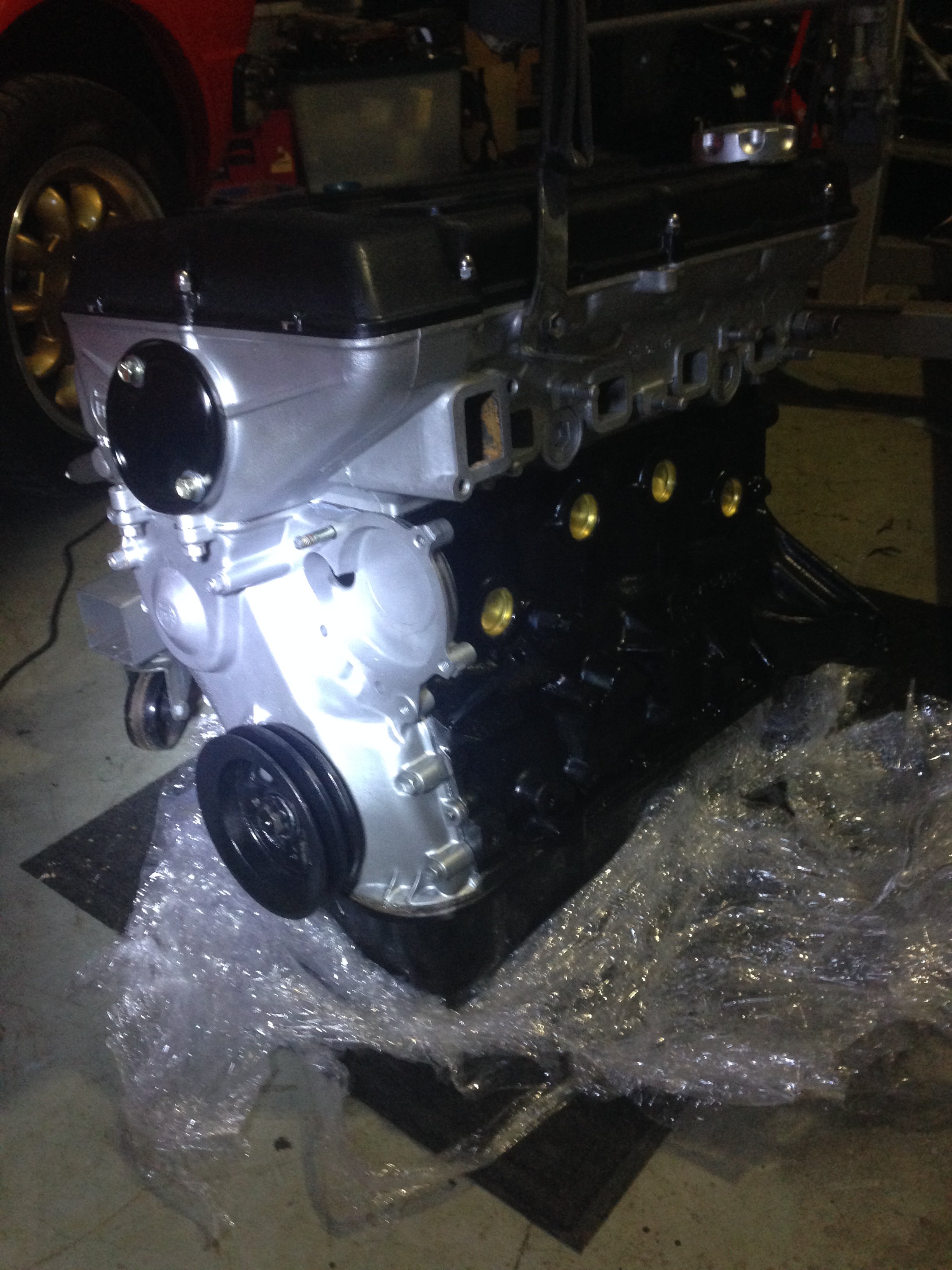

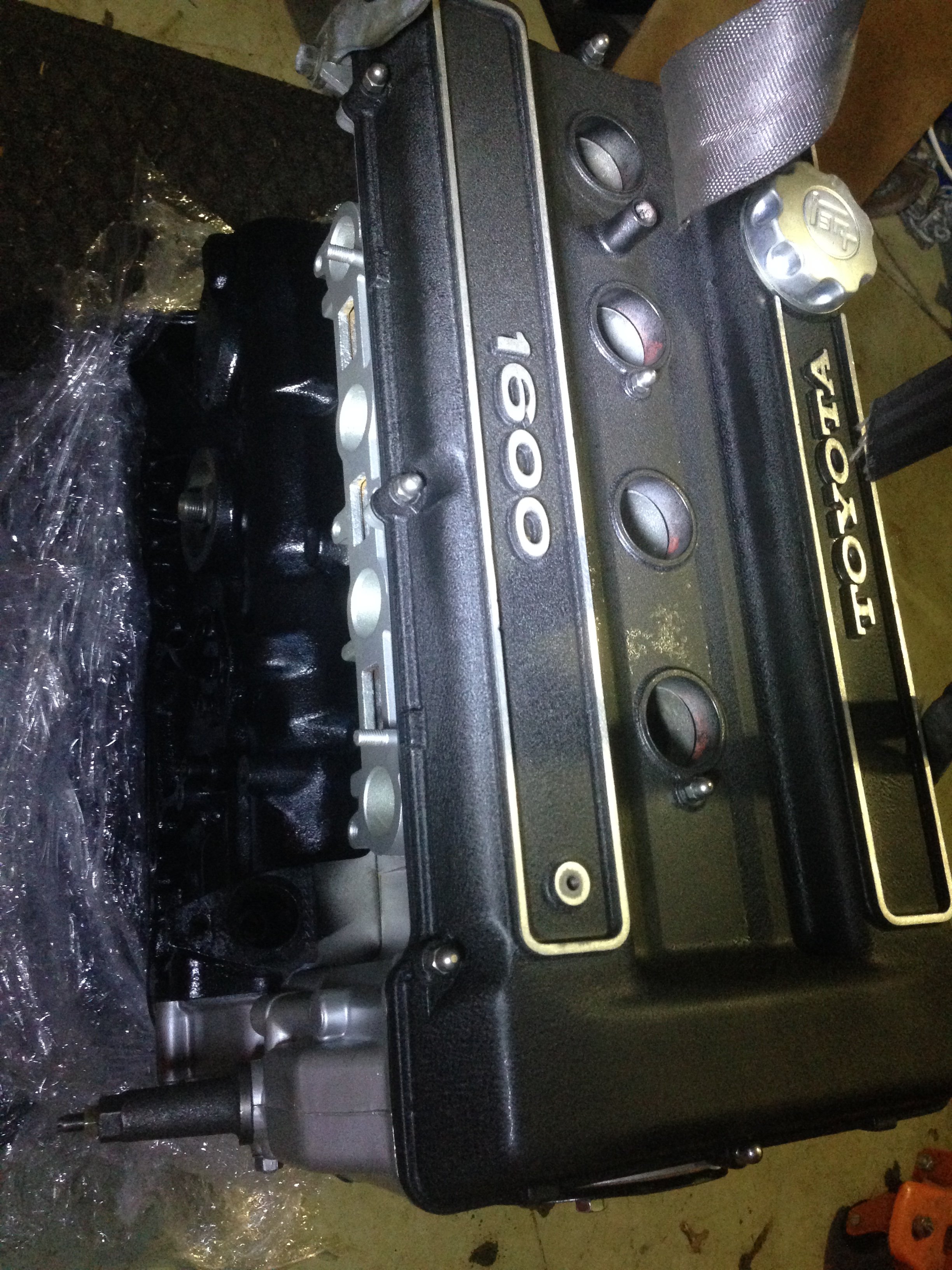

  13. Well it turns out I had to take my own photo of the pistons. But I'm ok with that!
  14. Haha I know right! I figured just do it, with some healthy peer pressure of course. Sitting on the train just now got the call that the pistons are in so the they'll get on with the build. Diamond brand pistons. I've asked for a photo before they lock them away.
  15. The engine was pulled down and it had spun #1 conrod big end. As a result the piston was tap-tap-tapping the head. And all the pistons were shot. A couple of weeks later, presumably after a clean and measure, I had the quote and gave the go ahead. The head will get a full recondion, custom forged pistons to suit the 'EU squish chamber head, and bottom end rebuilt and balanced with the flywheel. Standard cams, because I'd just like it to be punchy around town. Hopefully there's a lift in compression from the pistons & rebore & reface but I'll leave that to them. "Pump fuel". Should be good for 20+ years of Sunday driving! Forged pistons with a late/last model head is probably not the usual 2TG rebuild but I'm just going with it rather than try find an early head. Bit of a lead time on the pistons I understand haha

  23. Fair call - all and any help appreciated! No being a relative noob to engine troubleshooting, I pulled one plug at a time and didn't open the throttle. In hindsight there's probably not much to compress in a vacuum. Though at least the results were repeatable (and repeated). Back to the shed this evening then for a re-test... with some luck a bit of residual gecko egg will fall off a valve seat, or something along those lines.

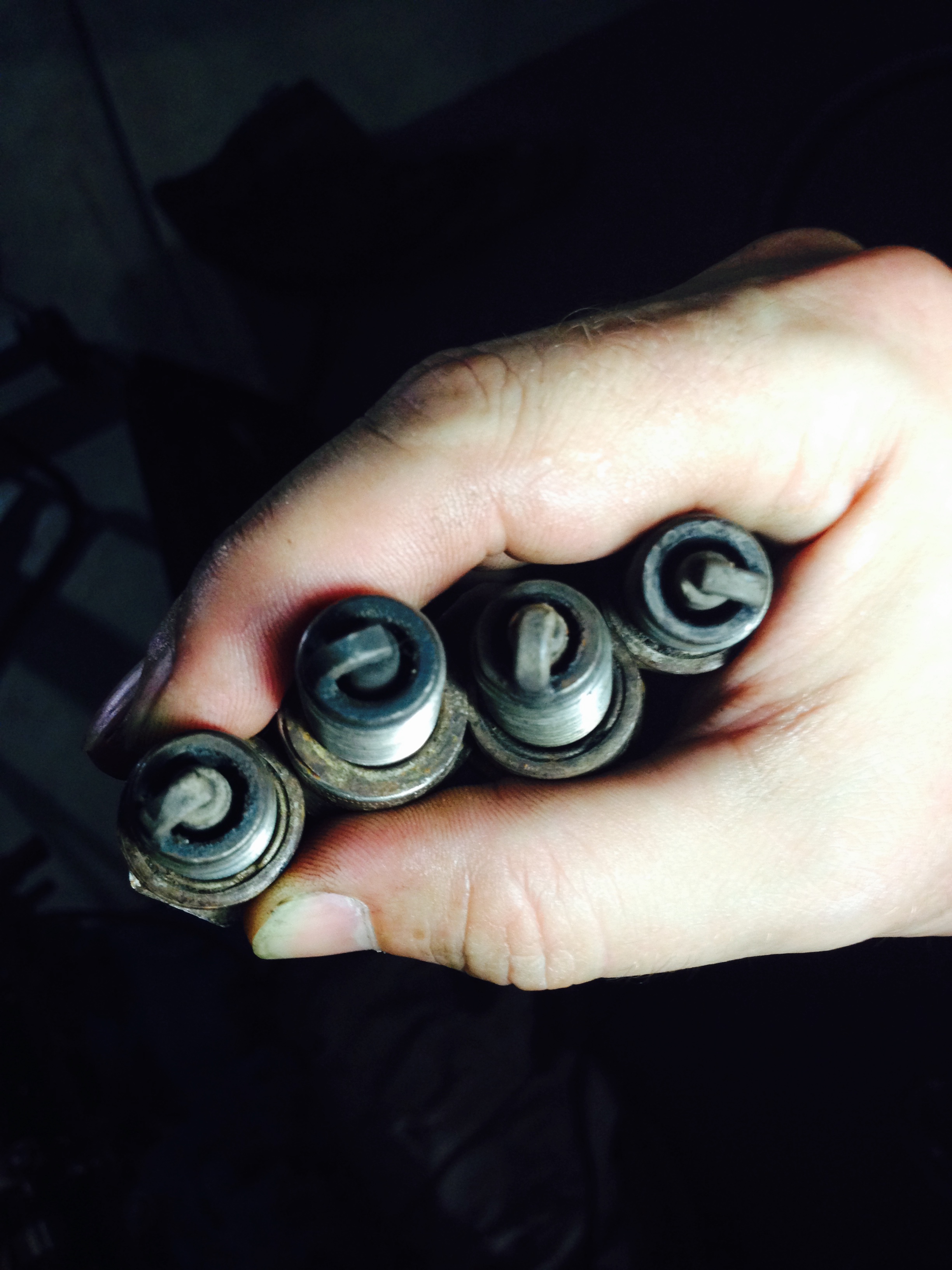

  24. Whereas these were the plugs I pulled when I first got the motor (in 1234 order). They gave me some confidence that the motor had been ok.
