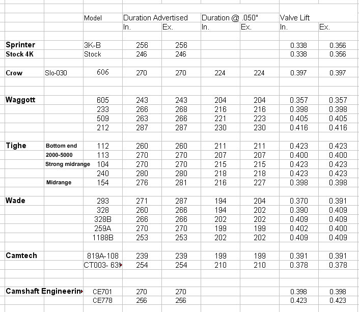

Sump will come off and be modified for ke1x, Cam and lifters removed and sent for a grind and head shaved as much as i can on pump 98. Will be getting all accessories off the 4k and probably end up with a 38/38 weber hidden underneath the factory 1k air cleaner just to look as stock as it can on the roadside
