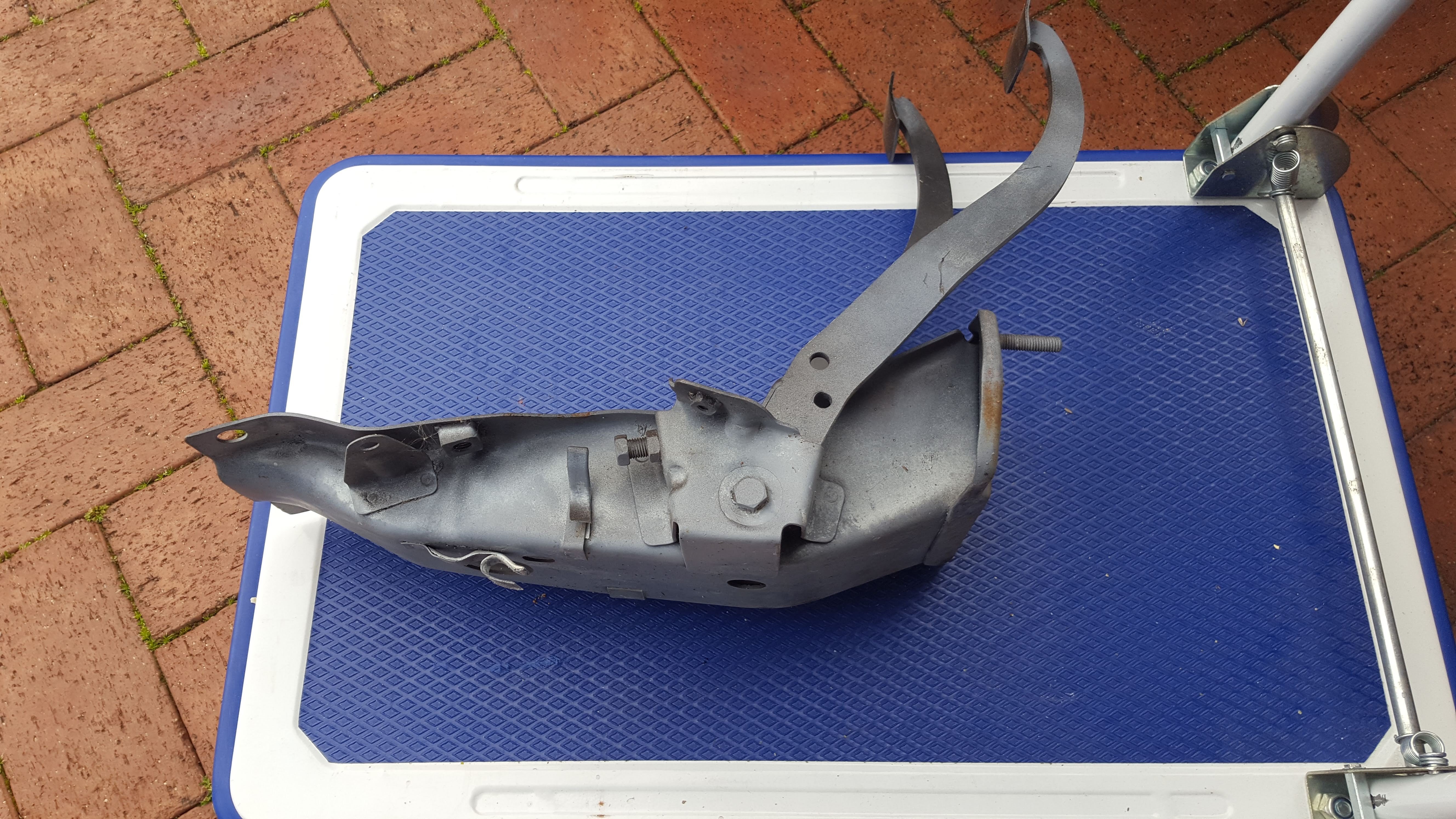

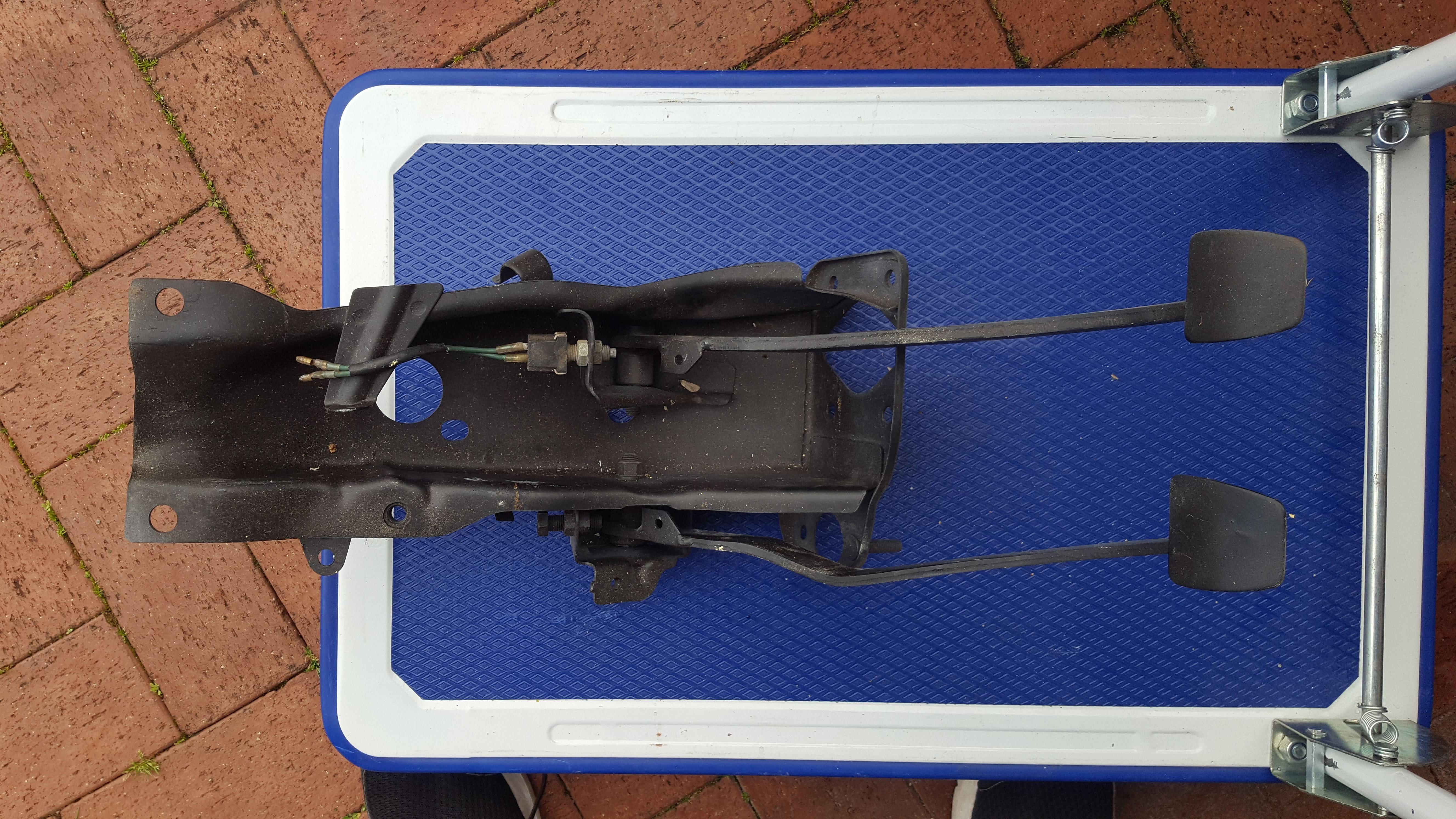

  1. I bought this pedal box a few years ago and was told it was for a ke30. It seems it might not be. Is anyone able to identify it? Maybe another ke? Thanks.
  2. The reason the eBay one is so expensive is that they don't make this one any more. (pbr) Buy a rebuild kit and have a go. Mine was leaking the same as yours. My skill level is very basic and I managed to make it work it again. I have one for sale on gumtree if you're desperate, but I think you'll be fine with the one you have.
