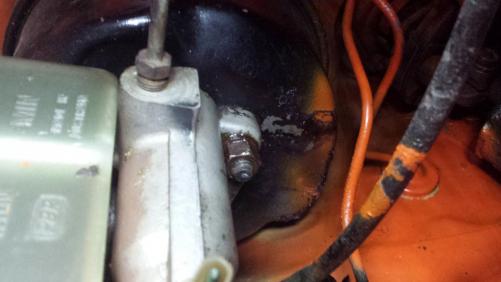

  22. The other day, I replaced the front brake hoses and bled the brakes. When I was finished, I had a bad fluid leak from the bolt at the back of the servo. It leaked when the pedal was pressed. I've tightened the bolt and I think the leak is fixed. Should there be any fluid there anyway or is this a sign of a bigger problem? Thanks
