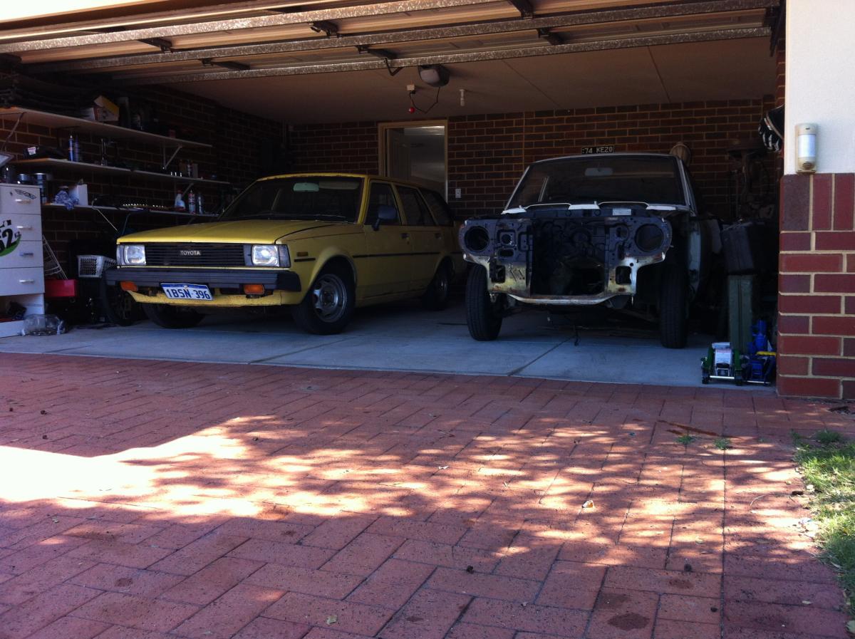

  6. Bit of a update made use of the long weekend and with a bit of spare time. I believe I had a pretty successful time. Motor is out gear box and all of front end (guards bumper ect.....)
