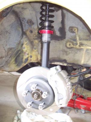

    12

  5. coilover sleeve kit is 299 and the tops are 299...not installed... tops have to be machined down and drilled to suit and the strut has to have the spring seats ground off and new sleeves welded on..

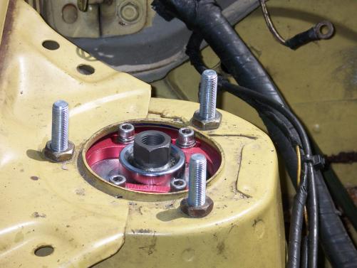

  8. this is whats on my ke26, got an otomoto sleeve kit, with adjustable camber tops aswell

  17. i just finished putting the sleeve kit and camber tops onto my ke26 struts, pretty much done whats said above...origional spring seat cut off, and the new coilover threaded sleeve welded on..... just gotta trim the studs down now
  18. if you want to go that bit extra, heres a pic of my brakes + struts....hopper stoppers brake conversion and otomoto sleeve kit onto the standard ke26 struts
