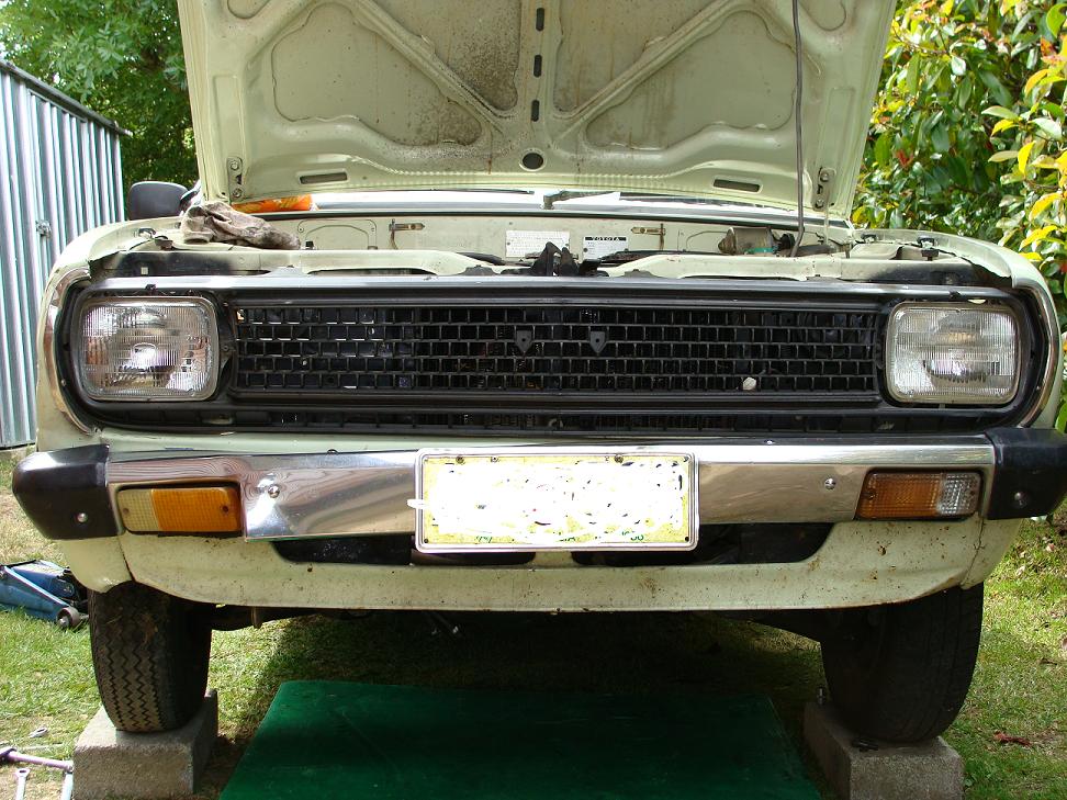

Thanks guy's for your comments :y: My other plans are to get rid of the stock 13inch steelies and put on some bigger mags, which should set it off nicely. :yes: I will also be getting the front drivers guard straightened out and also put a straight front bumper on her. There will most likely be more things happening to her once I get her registered, and then it will be no stopping me. :yes: :dance: It will be used as my daily, so I won't be going all out. :P Cheers, Mark. :wink:

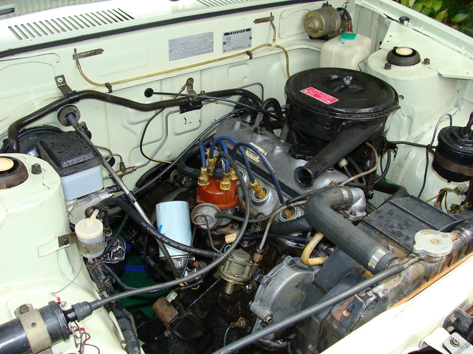

Just a bit of an update on my ke55 project. I have found another 5-speed from a ke70 which I needed for the extension housing to bolt onto my ke55 5-speed as it has the shifter position a little further back and it lines up with the original hole in the floor where the auto selector came through. Everthing is bolted up except for the tailishaft and the gearbox cross-member, as I will be getting the manual and auto cross-member welded together as there is no holes in the floor to bolt in a manual one. Oh and once that is done all I have to do is wire up the reverse switch and put the centre console back in, fill the box up with oil and all should be good. :( :( :y: It's been a while, but the 5-speed manual should be better then the slug-o-matic auto that was in her. :y: I also gave the engine bay a degrease, and now you have to put on your sunnies when ever you lift the bonnet. ;) :wink:

Have just removed the rolla GMH TRIMATIC auto :P So I should hopefully have the 5-speed in by the weekend. :P Here's some pics of today's progress. :lmao:

G'day all, this is my new project which I have only had for a couple of days. It's a stock 1980 ke55 SE sedan 4k Auto (slug-o-matic) which I picked up for $350 unregistered. My plans are to put in a 5-speed box and fix a couple of minor issues, such as the drivers guard has had a small hit and the front bumper needs to be straightened slightly. Other then that it's quite a tidy example of this model. Anway I know your all dying to see some pics so here she is. :)
