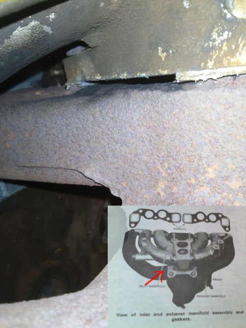

  7. Hi all,was hoping to get some advice on a problem with what appears to be a gasket that goes between the inlet and exhaust manifolds which is partly missing (see photo). I have heard that you can get some exhaust repair paste that could potentially be a quick fix, but thought i would see if anyone else has had issues with this before (i haven't been able to find much info on this gasket, even the workshop manual i have doesn't seem to mention it in the inlet/exhaust manifold section). Thanks in advance

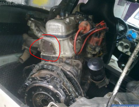

  10. Despite Banjos words of caution, and my best efforts, the bolt heads snapped off. The head is now off. I guess I will need to get the stuck bolts taken out, but what else should I be doing/replacing before it goes back together (keep in mind it has overheated, but the head gasket looks fine)? I will be looking to get my hands on a Gregorys/Haynes manual as well.
  11. Thanks Jeff, Rone an Banjo for the helpful advice. It's good to know this is a common issue with these motors, I will clean it up and put it back with some sealant (the plate itself seemed in good nick) and hopefully that should solve the issue. Thanks again for the useful info.
