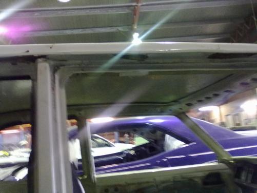

OK, late update. dropped the laptop. Busted the screen. It's now in the shop so I had to set up the old PC and get a wireless adapter so I could get online.... The rust in the 20 is bad, really bad.... The arse end is finished and the moved on to the sides where they found rust from the start of the weather channel near the windscreen all the way back and around to the front of the rear quarter glass. Both sides, hidden by about 50 tins of bog. I have decided to move on with the project though the estimate another 2k on body work.... there goes the budget. The engine is under way. Got and ACL rebuild kit and holden lifters. Took the block and conrods into the recon shop for the cam bearing and gudgeon bearing change. Also took the head and valves in for a pressure test, shave and valve regrind and reseat. The 3k-b manifold is also in for a beadblast and to have the throats milled out. Taking the cam so they can get the regrind and possibly the flywheel if they can shave it for me. Using the 4k pushrods, rocker gear and valves in the 4k head but with 5k springs. My old man is going to rework the 4k pushrods for me as they'll stand almost 20mm to long with the solid lifters. I'll try and get some photos up tomorrow...... PEACE
