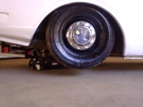

Beer, bbq, breaker bars & bitches. ;) That's how today unfolded..... minus the bitches. It just sounds better that way. Would like to start out with a few big thankyou's to the pit crew, Chris (Undertaker), Keiron, Nick, Ryan (bbqist) & JP (CA_ROLLA). You guys rock. Also I final thankyou to Jen for staying home with the kids. :) :) ;) A lesson for those who want a low low ride. Don't flip your leaf springs. It shears nuts and bends U-bolts. :bash: Managed to flip them back though missing nuts off the left rear spring mount, a left side U-bolt and a couple of bolts off the front right spring mount. Took a good few hours but managed to get the arse back to grandma spec. BIG. Pulled the tailshaft while I was under there. JP started on his 70, which you'll see a build thread soon but stopped to help us work the gearstick out. Meanwhile the crew started under the hood. Or so we thought, removed the radiator and mount, the beaver panel and anything else that was in the way. Had a problem with a gearbox mount bolt but Dad helped us out with the impact driver and breaker bar. Pulled the donk & Ryan blew an O-ring. :blinks:... The 3k and 4 speed is now for sale. Spot it in the sales forum. :rock: Here's the pics....
