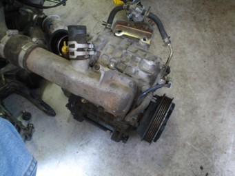

Hi,
I'm just wanting information on the super charges that were straped to the 4agze motor or any other toyota super charger.
The purpose is that I need about 200 CFM at about 1-2 PSI to start my jet engine minimum. I have researched some SC and found they will do this easily but I want something compact so I instantly though about the toyota one. So if anyone can shed some light on how much air one of these babies can push what is the max pressure etc it would be much appreciated.

Ive herd of sc12's (4agze model sc) holding 13 psi for a few years.
SC14's (1ggze model sc)pump more air and turn slower than the SC12 so inturn are better. correct me if I'm wrong.

well the SC12 has 1.2L internal capacity.. and assume 70% efficiency if that helps?

close, 1.4l actually :ninja:

My jet kart at idle will be flowing ~200 cubic ft per minute ( 0.25 lbs/sec ).
If I used a supercharger supplying that 200 cu ft/m and running at a poor 50% efficiency and say 2 psi output pressure , I'd have a 20 deg C temp rise through the blower and would need ~13 bhp to drive it .
But I'll only be needing <1psi (lowest possible will be about 0.5 PSI), that will cut the power requirement to ~6 bhp and say a 10 deg rise , and at such low pressures hopefully the leakages and efficiency would be better so maybe only a 7or 8 deg C rise and only ~4 bhp needed .
So I'm thinking a decent sized truck starter motor driving my supercharger for starts which will be measured in seconds , and your trusty leafblower for those longer cooldowns of the engine as when they are sut off jets need to becooled :-))

An SC12 should easily provide 200cfm at anything up to 14psi. The pressure is only a measurement of resistance to airflow.
A leaf blower might be capable of providing 200cfm+ with no opposition to flow but that wont help you much.
You'll need one hell of a drive ratio to use a truck starter motor to drive an SC12. Truck starter motors are generally built for torque not RPM
Have you got any shaft drive options for starting?
Also just a cautionary note, TGT readings of 1500deg are rather abnormal and dangerous.
